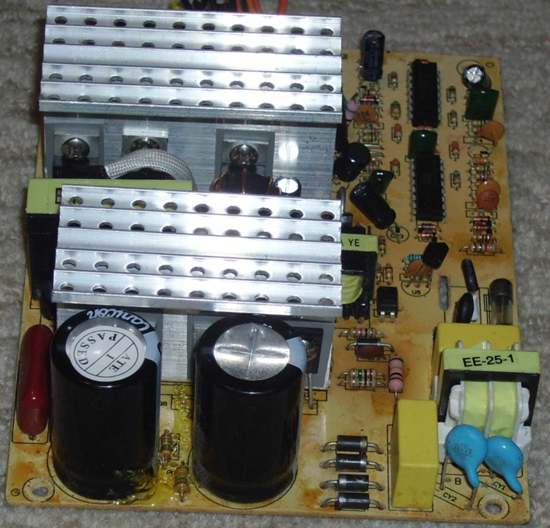

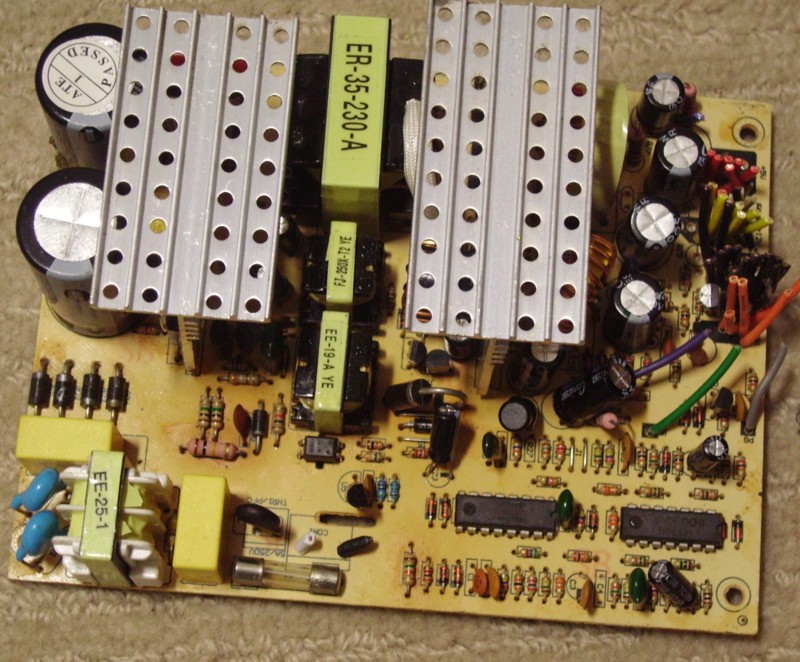

                            I started messing with this one, harvesting parts from other busted PSUs and such. I have a question about the transformer behind YC1 & YC2. What would one call that piece in order to find a similar unit on Digikey? I pulled on off another PSU, but unfortunately it was a little too big (pins didn't line up with the holes). And what kind of capacitors should I be looking for to populate YC1-YC4?
                            and that's what the primary side filtering is supposed to look like..

                              I think it's a line filter rather than a transformer.
                              If the holes don't line up exactly you can probably enlarge them or drill new ones. The pads should be large enough to allow for this.

                                On Digikey, look under "Common Mode Chokes" in the "Filters" category. There's a couple thousand to choose from.
                                For the Y capacitors, search for "Y1" or "Y2", and then look in the Ceramic or Film Capacitor categories. Most important thing to worry about here is the lead spacing too.

                                  I am in the ballpark for the coil. I found ones that are somewhat similar looking. But for ~$5, I might look around for some more old PSUs. I guess I can see why they would leave them off to increase the bottom line.
                                  Here is one that I am thinking might work: http://search.digikey.com/scripts/Dk...ame=PLK1324-ND
                                  As for the capacitors there are about 32 different choices that fall under the category 250V/High Voltage/Safety. The pF rating goes from 15pF to 4700pF. Is there any value that I should shoot for here?

                                    Not sure, but from what I noticed most PSUs will use 1nF to 3.3nF (1000pF to 3300pF).
                                    As for the choke - you're probably better off finding some old junk PSUs like you said. They'll likely have the safety X/Y caps too.

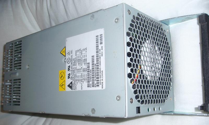

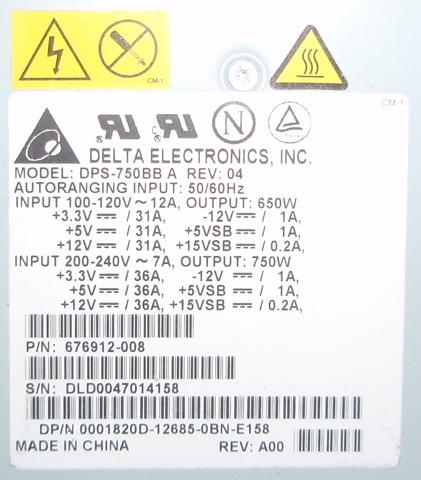

                                      Anyone want to see the guts of these?
                                      And maybe a Tagan ITZ 700W (1 of 4 that I'm willing to open, seen in blue box on left side of picture) and a monster DPS-750 (220v) out of an 8-way PIII Xeon server for dessert!

                                          only the bad ones, this is not build quality pictorial, this is the hall of shame. server power supplies that are not blown up do not count (they are very nice actually)
                                          in pic #1, i'd try the black one and column 1 2nd from the top. the latter has thin wire (it has to be gutless!) and the black one looks like a gamer wannabe unit...
                                          i see a hipro built one, it has a blue "void if broken" sticker, those are very well built.
