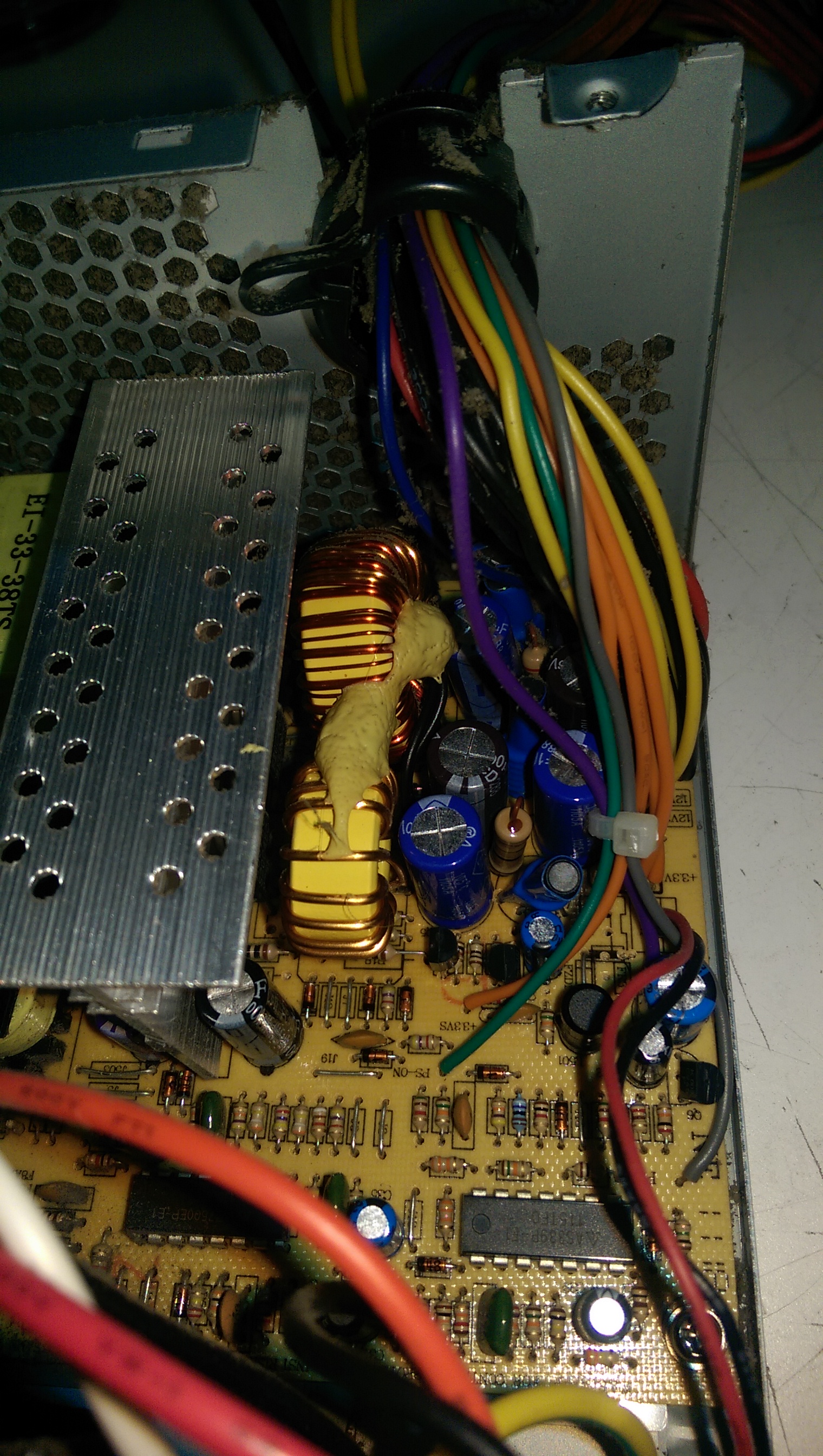

                Here's the worst PSU I've had in my hands, an Ishaya 330U rated at 480W...hum yeah let's see that :
                First thing you'll notice, the size of the case :
                The amps are completely ridiculous.
                Inside, no protection, no PFC of course, just a typical very cheap PSU design
                I'm surprised they bothered adding two Y caps and a thermistor. The fuse is still good.
                That is fried, all the caps are bulged, aside from the two primary caps and the small ones. Yes there are jumpers where there should be coils, and caps as well. The caps are a mix of Canicon, Fuhjjyu and Jun Fu, top notch quality. The soldering is atrocious.
                A couple of 13007 as usual :
                Oh and that thing weighs approximately 300g I'd say. It was in a cheap case, powering a very basic 2005 computer : Sempron 2600+ socket 754, AsRock K8NF4G-SATA2, a 250Gb HDD, and a couple of optical drives.

                  Looking at the heatsinks, I was thinking 300W-350W. But the O/P transformer, the MJE13007-clone switch transistors, and those I/P rectifiers position it more in the 200W-250W range.
                  Is it a trick of the lighting, or is that O/P inductor as toasty as those vented O/P caps?

                    Yeah he wrote it is fried, I expect that goes for the black inductor

                      Yes, it does look burnt, but it's not leaving any residue or burnt plastic smell so I'm not entirely sure. They're generally red/orange so I guess it is. The PCB is darker all around the coil.

                        It's black as coal and the same goes for the board beneath it, complete toast.

                          The chances that the magnetic properties of that core have been seriously degraded is pretty much a certainty, IMO.
