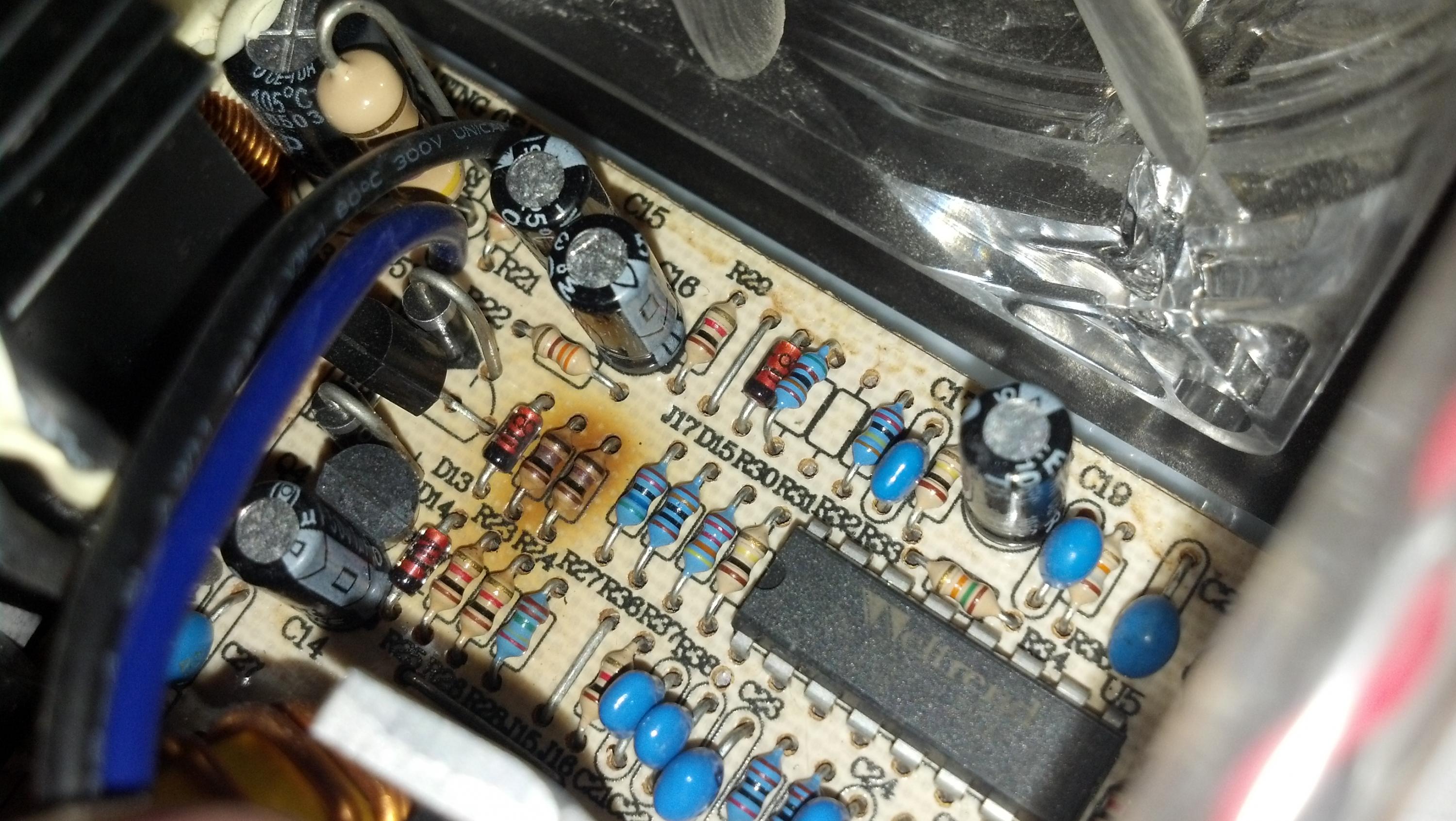

This thing has potential. Obviously horribly overrated from the label but not bad after some upgrades...it has two 2SC2625 transistors, 30A schottky for 5V, 20A fast recovery for 3.3V and 20A schottky for 12V. Not a bad transformer. Filtering is terrible but that's cause of all those tiny Jenpo caps, primary's are 470uF Teapo, definitely in need of being increased. On the secondary side it has room for big sized schottky's, thinking of putting a 30A part for the 3.3V and 12V
