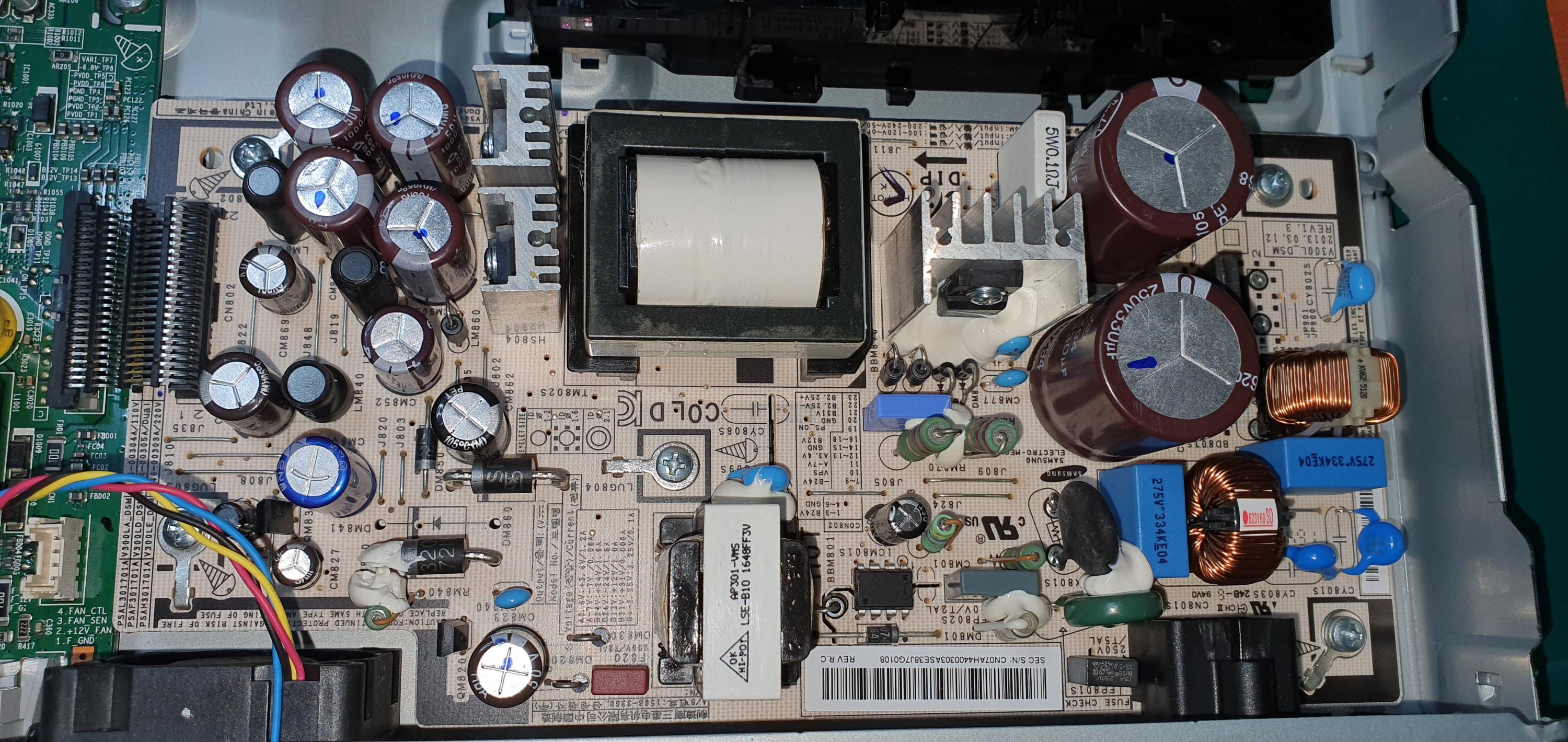

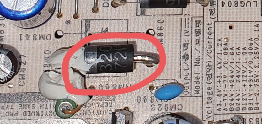

    Hi guys, i have a power supply with a shorted SR320 schottky diodes which is in parallel. Only 1 shorted while another is ok. So i removed the faulty one, the power supply is working fine now. SR320 is 3A 20V. I was thinking can i remove both diodes and replace SR340 as 1 diode as it is 3A 40V? Because i dont have SR320. Or can i replace both with SR340?

    Re: replacing schottky diodes on a AV power supply
    neither, your going to need 6A at 20v, not 3A at 40v
    parallel diodes double the current, not the voltage
    if you check my Ryobi charger thread, i replace a couple of diodes with a 25A to220 package part
      6A 20V, noted, will try that. Cause i fitted the 3A 40V diodes, no power at all. When i fit back the single 3A 20V, its working again.
        higher voltage is fine - infact with schottky's you really want 10x the running voltage.
              I tried the following.
              1 piece of SR340
              2 piece of SR340
              1 piece of SR320 and 1 piece of SR340
              None works. If i pull all and put only 1 piece of SR320, it works. Sighs
                  Originally posted by budm
                  What happen if you test the SR340 and compared to the SR320 with you meter?
                  SR320 - 15.33v
                  SR340 - 5.56v
                  No wonder theres no power when i put SR340. I wonder why
                      i dont understand where you got the numbers,
                      test the diodes with your diode-test on the meter - both directions.
                      test on V mode while power on.
                      while take off from board, these are the reading on diode mode
                      sr320 - 0.343v
                      sr340 - 0.164v
                        • 31289
                        the sr320 looks fucked for a schottky - thats far too much voltdrop
                        probably damaged - just not as much as the other one.
                                This is the section. Output is 12V.
                                  So when you install SR340 you say you no longer get the switched B12V?
                                  When that happens, what Voltage do you get at the Cathode of SR340 with ref to circuit ground?
                                  Is switched B31V present when that happen?
                                  Can you also provide the full PDF of the service manual?
