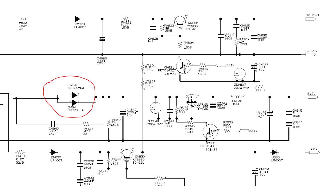

Re: replacing schottky diodes on a AV power supply
Tested the unit, everything works perfectly fine with the new original diodes.
replacing schottky diodes on a AV power supply
Re: replacing schottky diodes on a AV power supply
Already tested, its just some cheap Chinese diodes thats not even accurate. Well, the luck was just not there. Ive returned back those diodes and request for originals.Well, if you want to get an answer for that, or at least get a clue, do the test I suggested above with the old rectifiers and the power adapter. If they test bad, then we know. And if they don't, then they weren't the issue and probably something else happened that you didn't realize was happening.Leave a comment:
Re: replacing schottky diodes on a AV power supply
Well, if you want to get an answer for that, or at least get a clue, do the test I suggested above with the old rectifiers and the power adapter. If they test bad, then we know. And if they don't, then they weren't the issue and probably something else happened that you didn't realize was happening.Leave a comment:
Re: replacing schottky diodes on a AV power supply
Thanks guys for the inputs. Ive been away for quite a while now. And the parts arrived as well. Fitted in 2 pieces of sr320. Works perfectly. Wonder why the rest didnt work? HmmmmLeave a comment:
Re: replacing schottky diodes on a AV power supply
Why not test those SB340 diodes with power? IMO, no need to waste time and money looking for new diodes if you can't confirm the old one(s) is bad.
Take a 20V laptop adapter and something with a heating element that has about 10 Ohms resistance and connect it as a load on the laptop adapter through the diode. Then measure to see if the diode has proper voltage drop in the forward direction. After that, reverse the diode and test again. It should block current from going to the heating element. If you can confirm this, then your SB340 diode(s) are not bad and maybe there was another anomaly that happened at the time when you tested the PSU.Last edited by momaka; 09-01-2020, 11:41 AM.Leave a comment:
Re: replacing schottky diodes on a AV power supply
just check any scrap psu's you have for a TO220 package schottky.Leave a comment:
Re: replacing schottky diodes on a AV power supply
Do you have any broken boards that you can find some similar diodes that you can try?Leave a comment:
Re: replacing schottky diodes on a AV power supply
Fake? That i could suspect. The supplier said its a chinese company made. Sighs. Looks like i need to reorder a good quality ones againLeave a comment:
Re: replacing schottky diodes on a AV power supply
Bad or faked SR340?Leave a comment:
Re: replacing schottky diodes on a AV power supply
Agreed.
Either the SB340's were bad ad STJ suggested or connected backwards.
-OR MAYBE-
PSU had a hickup by coincidence when the SB340's were installed and somehow voltages were off only then.
Best way to know is to repeat the experiment. Better yet, test the SB340 diodes outside first - not just with a multimeter, but rather pass 12V DC through one and feed a dummy load. Then reverse the diode and try again. In the reverse direction, the diode should be blocking any current from flowing. If it's partially shorted (i.e. shorted with high resistance), it will pass current in both directions.Leave a comment:
Re: replacing schottky diodes on a AV power supply
maybe the 340's are badLeave a comment:
Re: replacing schottky diodes on a AV power supply
SR340 - 5v plus
SR320 - 12v plus
B31V presentLeave a comment:
Re: replacing schottky diodes on a AV power supply
Sorry, heres the PDF fileAttached Filesif you find these attachements useful please consider making a small donation to the site
Leave a comment:
Re: replacing schottky diodes on a AV power supply
Heres the pdf file.Leave a comment:
Re: replacing schottky diodes on a AV power supply
So when you install SR340 you say you no longer get the switched B12V?
When that happens, what Voltage do you get at the Cathode of SR340 with ref to circuit ground?
Is switched B31V present when that happen?
Can you also provide the full PDF of the service manual?Leave a comment:
Re: replacing schottky diodes on a AV power supply
Theoretically that's correct.
However, if the diodes are not built on the same physical die (as is the case here, where O/P has two separate diodes wired in parallel on the PCB), then one diode will run hotter than the other. When that happens, the forward voltage of the hotter diode will drop further, making the the circuit "prefer" to push more current through that diode, which will in turn heat up the diode even more. If this continues, thermal runaway may eventually kill the diode if the circuit has the capacity to push a sufficiently large current through it.
Because of that, I agree with what STJ suggested: use a single 6 Amp (or higher) diode/rectifier (and preferably Schottky type for lower losses.)
That's the maximum expected voltage drop at the rated current of the diode (3 Amps). Most multimeters push much much less than that when testing components (typically in the order of a few uA to maybe a fraction of a mA max.) As such, the Vf will appear much lower. Figure 3 in the above datasheet shows Vf for any given current from 0.1 Amps to rated surge current. You can see that for 0.1 Amps of current, the Vf is around 0.2V for SR320-340. So with a multimeter, the Vf should likely show even lower value... though depending on multimeter quality/design, that may not always be the case.both should be vf 0.55
https://cdn.badcaps-static.com/pdfs/...5f72338fd7.pdfLast edited by momaka; 08-29-2020, 12:50 PM.Leave a comment:
Re: replacing schottky diodes on a AV power supply
that's at max current, they generally meter at about 0.18 on a meterLeave a comment:
Re: replacing schottky diodes on a AV power supply
both should be vf 0.55
https://cdn.badcaps-static.com/pdfs/...5f72338fd7.pdfLast edited by petehall347; 08-29-2020, 10:34 AM.Leave a comment:
by sam_sam_samI have wanting to do this project for quite sometime now and I finally found a switching power supply that will work on this desoldering gun station ZD-915 that the original switching power supply took a shit and just was not worth trying to fix it because this switching power is not quite big enough to handle the heater element and the vacuum pump
One note when I tested the switching power supply and the voltage control board I noticed that this desoldering gun heat up much faster than the original switching power supply which I was really surprised by to the point that I might buy... -
by caspianDear members,
I have a linear variable power supply with unknown brand name that I used for voltage injection.
Then it failed. I discovered that its transistors (Q1 and Q2) are shorted.
In addition, I discovered that its zener diodes are defective.
I can replace the burned transistors.
But I do not know the model of the zener diodes. the model number is not marked on the zener diodes.
Therefore, I cannot replace the zener diodes.
I do not want to test the zener diodes in a test circuit to discover their model or value.
no schematics are available... -
Vizio e601i-A3 - Has Sound and Display, But No Backlight - Bad Power Supply Board or Bad LED Bulbs ?by Tynan DillI was given this TV from my great uncle. He said it just wouldn't turn on one day out of nowhere, replaced the TV, and gave it to me to possibly fix and use for myself.
Assuming...7 Photos -
by sam_sam_samI have been working on this concept for quite some time now with limited success but recently I found a switching power supply that is setup for the voltage that this soldering station needs to operate at however it also needs part of the secondary circuit from the original switching power because you need several voltage rails
I once tried to get a ZD-915 desoldering station to work on a 18 volt battery power supply but unfortunately things did not go well but I did find a work around but I might try this idea again but going at a little differently more about this another time... -
by shamsudeenHi all, I just need to know that, can i use SMPS type power supply to test and short circuit detection on a laptop motherboard?
I saw 95% of repair guys are using only Linear bench power supply. linear bench power supply is pricy, thats why i planned to get one SMPS supply.
i know that in linear power supply the noise will be very low comparing to SMPS supply.... - Loading...
- No more items.
Leave a comment:
