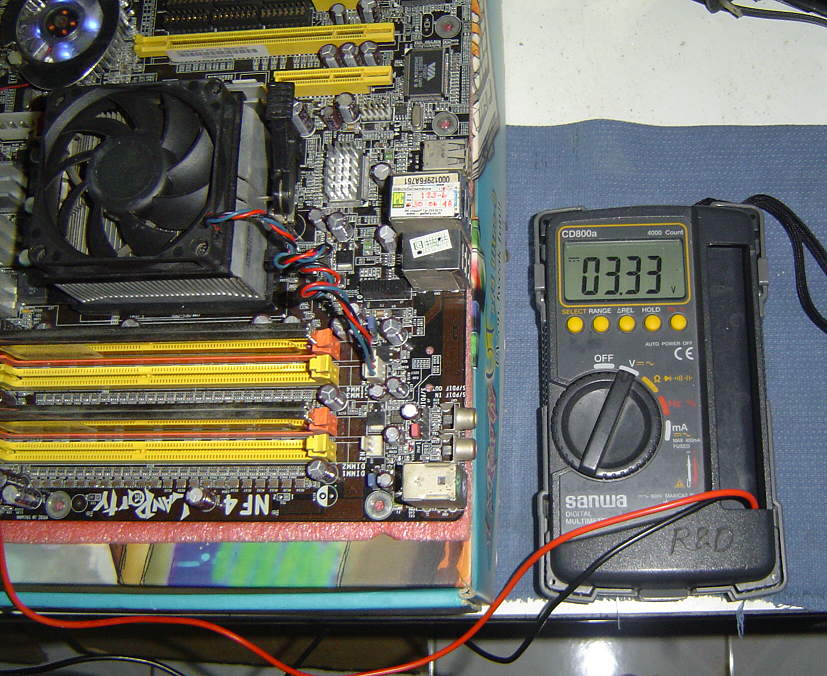

      voltages with small loads are 4.95(5Vsb), 4.90(5V), 3.32(3.3V), 11.78(12V) ???
      Any suggestions?

        The 5v and 12v are "group regulated" and are supplied through the same toroid (the one to the right). Because of the co-mingling in that toroid, they are both off by the same percentage: -2%.
        The 3.3v is independently regulated and goes through the smaller one to the left.
        Load the 5v and 12v with 5A and 6A respectively and put 6A on the 3.3v. Then see how it runs.
        12v and 6v Headlight bulbs make good loads.

                OK Toasty - I'll take a shot at it!
                First I would like to say that most of my work with the Bestec power supplies was problems in the 5vsb circuit. My solution to the Bestec ATX-250 12E was a bit extreme, but it worked. As for the other Bestec models - I have not seen the same kind of 5vsb failures due to the pwm chip in the later models. Most of these failures have been bad caps - just like the other brand power supplies.
                The Bestec ATX-300 12Z we are discussing here does not appear to have a 5vsb problem. One more piece of proof that the later models are indeed good power supplies when recapped.
                The problem here is that both 5v and 12v rails are low. They are both regulated by the same regulator chip IC3 which is a AZ431 (or equivalent). The resistor from the 12v rail to the reference pin is R57 which is 24K. The resistor from the 5v rail to the reference pin is R61 which is 5.1K. The resistor from reference pin to ground is a parallel combination of R59 and R60. R59 is 3.00K and R60 is 27.0K. This parallel combination calculates to 2.70K.
                So why two resistors in parallel between reference pin and ground? As a cost savings, rather than putting in a variable resistor to set the 5v and 12v voltage values, they put in a higher resistance than what is needed (in this case R59 which is 3.00K). Then they bridge a parallel resistance to bring the voltages into spec. So if you play with the R60 value, you will probably be able to put those voltages where you want them.
                These resistors are surface mount resistors on the bottom of the pc board. You may or may not want to attempt changing them. Also, the R60 value on your board may or may not be 27.0K. The R59 value probably is 3.00K.

                  Oh, very great regulator circuit descriptions.
                  I understand if I've changed R60 up/down I can get more/less 5V and 12V, right?
                  Thankyou very much everell, This is exactly answer I waiting for.
                  The R60 is very small (I think it's 0603 chip resister), but I will try.
                  Thankyou again for every suggestions.

                    If you want to try it.............remove R60. Solder a 27K resistor and 20K potentiometer in series (or a 27K resistor and 10K potentiometer in series). Adjust this series resistance to about 27K. Solder this series combination where R60 was. Apply power to the psu. Adjust the potentiometer to the voltages you want. Turn off psu. Remove the series combination and measure its resistance. That's the value you need. Now just find itty bitty small SOT resistor with that value resistance, solder it in R60 location, and you should have what you want.
                    Notice that R60 value on my psu and on your psu is different. I expected this....it is being used for calibrating the 5v and 12v rails.
                    Have fun .... be EXTRA careful .... always wear safety glasses when working with these power supplies.

                      Yeah, I was changed R60 to 33K (from an old PCI card), then I've got 12.02V finally and 5.06V and 3.33V while loading with same test system.
                      Thankyou very much to everyone especially everell.
                      I didn't take a picture of the replaced R60 because hurry put the PCB back for test, but here are some pictures of voltages measurment.
