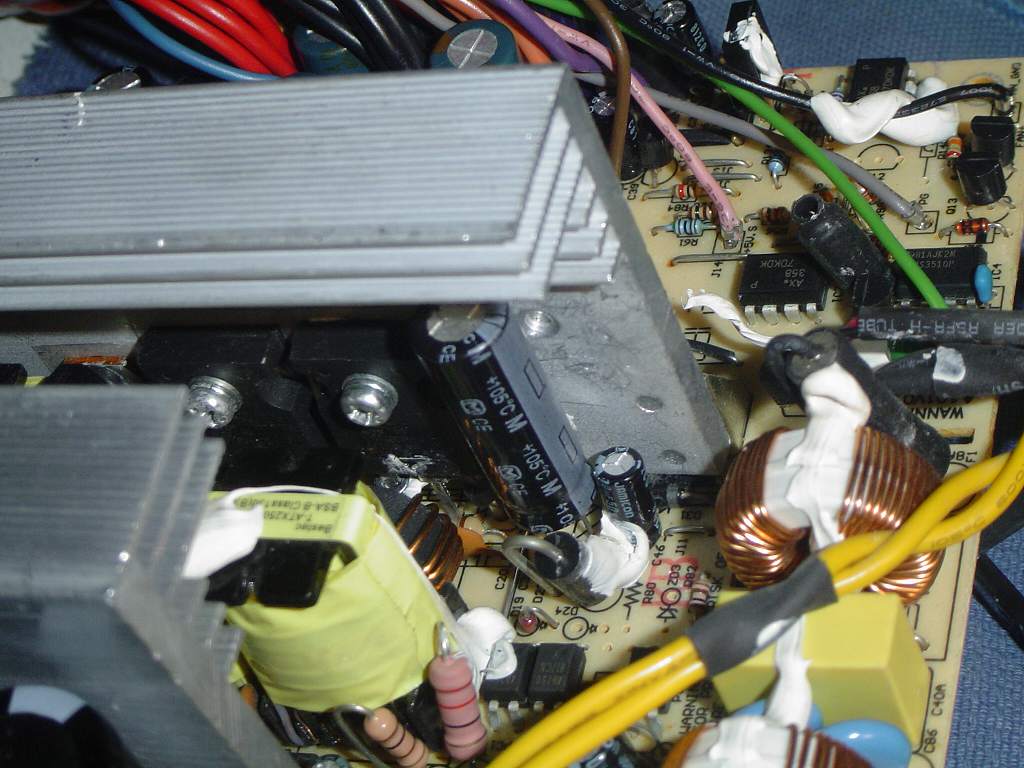

          I have seen this problem also. On the ATX-250-12Z and ATX-300-12Z, this capacitor is sitting next to a large diode. If the computer is left plugged in and 110vac power applied, this diode is constantly conducting and is a heat generator - a good explanation as to why the capacitor is getting cooked. Bestec has a proclivity to place aluminum electrolytic capacitors next to heat generators! Rather than just replacing the capaacitor, I would recommend installing it such that you can bend the capacitor away from this diode to avoid the cooking effect.
          The suspect capacitor is C36. Capacitors C36 and C37 along with a coil form a PI filter for the 5vsb. I have seen several of the C36 fail, but never a C37 fail. There has to be an explanation as to why C36 fails but C37 does not. My only theory is capacitor C36 is being cooked by the large diode next to it. Remember - when the computer is OFF, the 5vsb is still ON. That means the diode is generating heat but the fan is OFF and not providing any cooling effect to take away that heat.
          On the ATX-300 12E the same capacitor C36 is next to a power resistor - also a heat source. Had one of them bulging. Replaced the capacitor with extra lead length so that I could bend it away from the heat generating resistor.
          Due to catastrophic failures - I won't even talk about the ATX-250 12E!

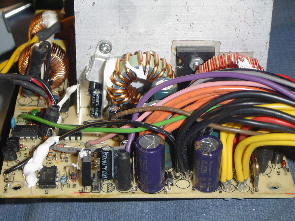

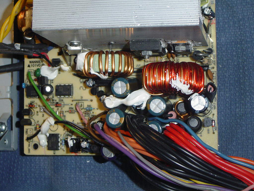

            The EarthWatts EA-500 reviewed by HardwareSecrets.com is not the same as the EA-500D Delta unit. Big differences.
            http://www.hardwaresecrets.com/article/526/2
            Photos of mine attached.
            EDIT - 2nd photo shows a few of the caps that PC was talking about.

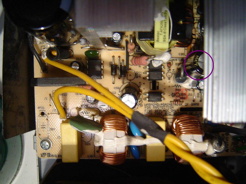

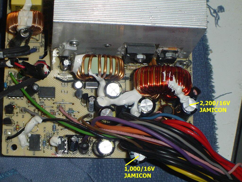

            • POM_MJ
              • Aug 2009
              • 228
              Re: Bestec ATX-300-12Z REV.EHR
              I've replaced both output caps for 12V rails with 2,200/16V SANYO WX-series,
              loaded with the same test system, 12V still supply 11.80V.
              picture before replaced.
              Originally posted by Toasty
              @POM_MJ -
              Check for a cap around 2200uF near the 5vsb transformer. It will be on the other side of the 2nd heat sink in about the same position as the green output coil. That's a common failure also.
              Toast
              C36 this one?
              Ok, I will replace it, and also C50 100/50V look like bulged.
              after that, I will post the result later.

                Yes - that is the correct capacitor (C36) that we are talking about. If the leads on the diode to the left of the capacitor are long enough, bend it away from the capacitor slightly. That diode is a heat generator.
                Capacitor C50 is the filter for the DC voltage going to the pwm chip UC3842. If you see any bulge - replace it.

                  • POM_MJ
                    • Aug 2009
                    • 228
                    #29
                    Originally posted by 370forlife
                    All the ones that I see in that picture with the X top are OST. I only see one jamicon, and one tk.
                    I don't know the age or "hours-in-use" of this supply. You may want to investigate those output caps. OST's are known crap and could be weak allowing the 12v to sag.
                    Toast
                    Sorry, I was wrong. I've recheck again and found the X top caps are OST like 370forlife said exactly and C36 is OST's 2,200/16V also.
                    The others on 3.3V rails and 5V rails are OST's 2,200/10V.
                    Now, I have no caps rated 10V left and 100/50V too, I will goto buy on Saturday.
                    After recaps, I will post the test results later.
                    Thankyou everyone for your advise.

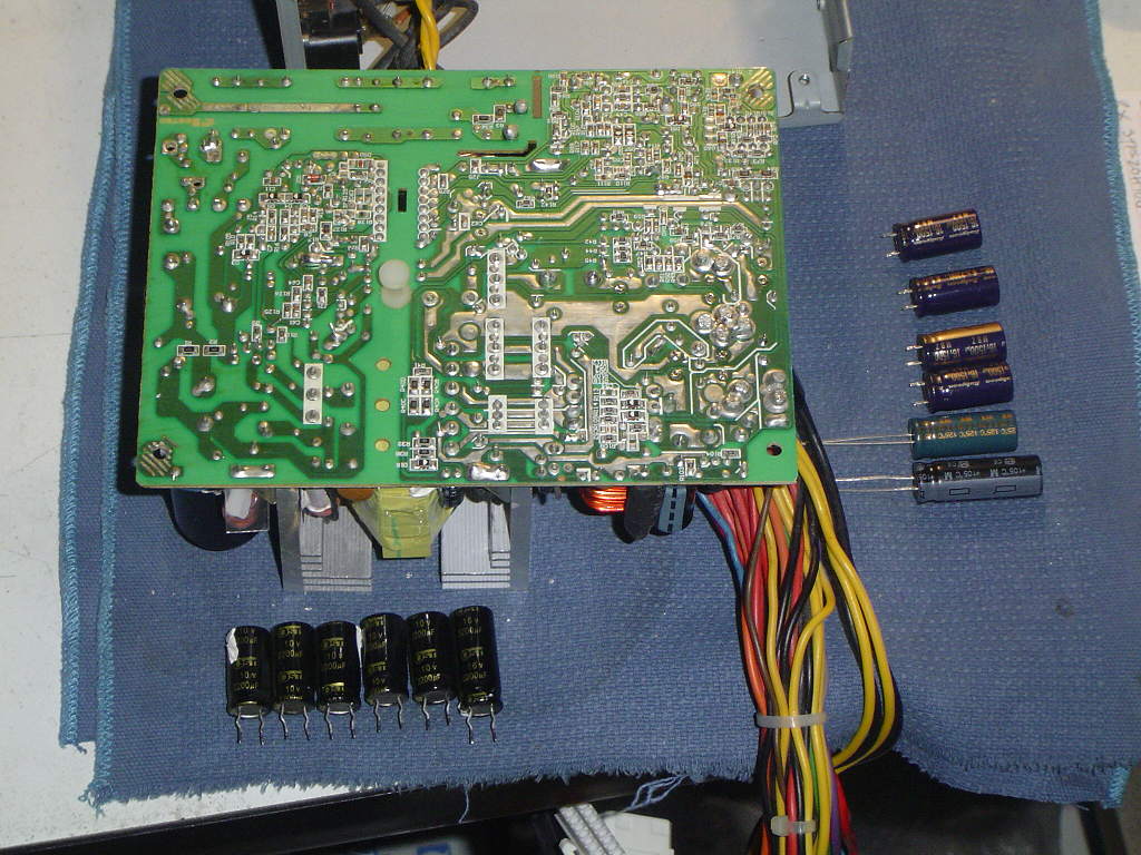

                        #31
                        I've got some caps to replace the OST's caps.
                        They're Rubycon, Sanyo and Panasonic? (not sure)
                        My DMM is not right here, I will measure voltages and post the result tomorrow.
                        | AMD Phenom II X2 550BE | GIGABYTE GA-MA790FXT-UD5P | GeIL DDR3 Ultra 2x2GB 1600C7 |
                        | XFX GTS250 DDR3 512MB | Dell H525EF-00 | Lancool PC-K62 Black | Samsung 2232GW |
                        | 2xWD7500AYYS | 2xHD322GJ Raid0 |

                          • 370forlife
                            Large Marge
                            • Aug 2008
                            • 3112
                            #33
                            Wait a tick, what are those green X topped ones you put in?
                            Last I remembered, sanyo's vent is a K.
                            And that vent on that panasonic is the same as hermei/jamicon!
                            • Toasty
                              • Jul 2007
                              • 4171
                              #34
                              Yup. DAMMIT! Fakes.
                              veritas odium parit
                                    Panasonic = Capital "T" with ends of top curved up
                                    Sanyo = Capital "K" with the "leg" intersecting the "arm" about 1/3 of the way out. Look closely and also note that the 2 intersections have smooth and rounded corners.
                                    Nichicon = A "+" mark. Many others use this. Likely THE most common marking.
                                    Rubycon = Capital "K" mark where both arms/legs meet at the center of the vertical line. Very fine and clean lines.
                                    United Chemi-con = A "Y" that has equal spacing between each leg and is centered . Think of a pie cut into 3 equal slices. - Note: others use this mark, notably Fuhjyyu
                                    See these threads for some good pics of vent marks:
                                    https://www.badcaps.net/forum/showth...?t=4193&page=2
                                    https://www.badcaps.net/forum/showthread.php?t=2701
                                    Sorry but it seems like you might have been ripped! If the dealer is reputable, I would question him. If he's fair, he'll give you your money back.
                                    Toast
                                    veritas odium parit
