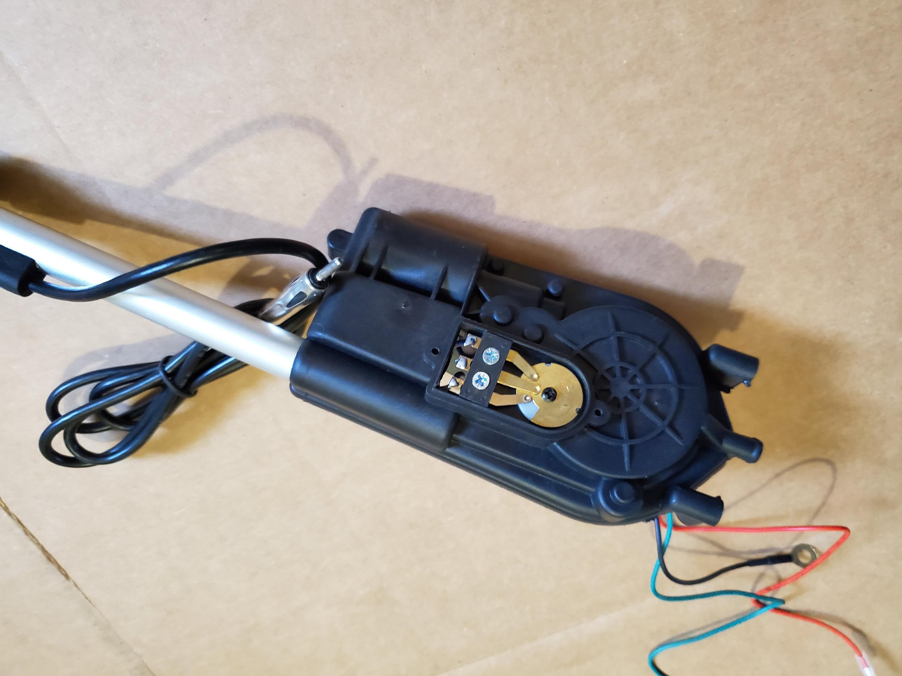

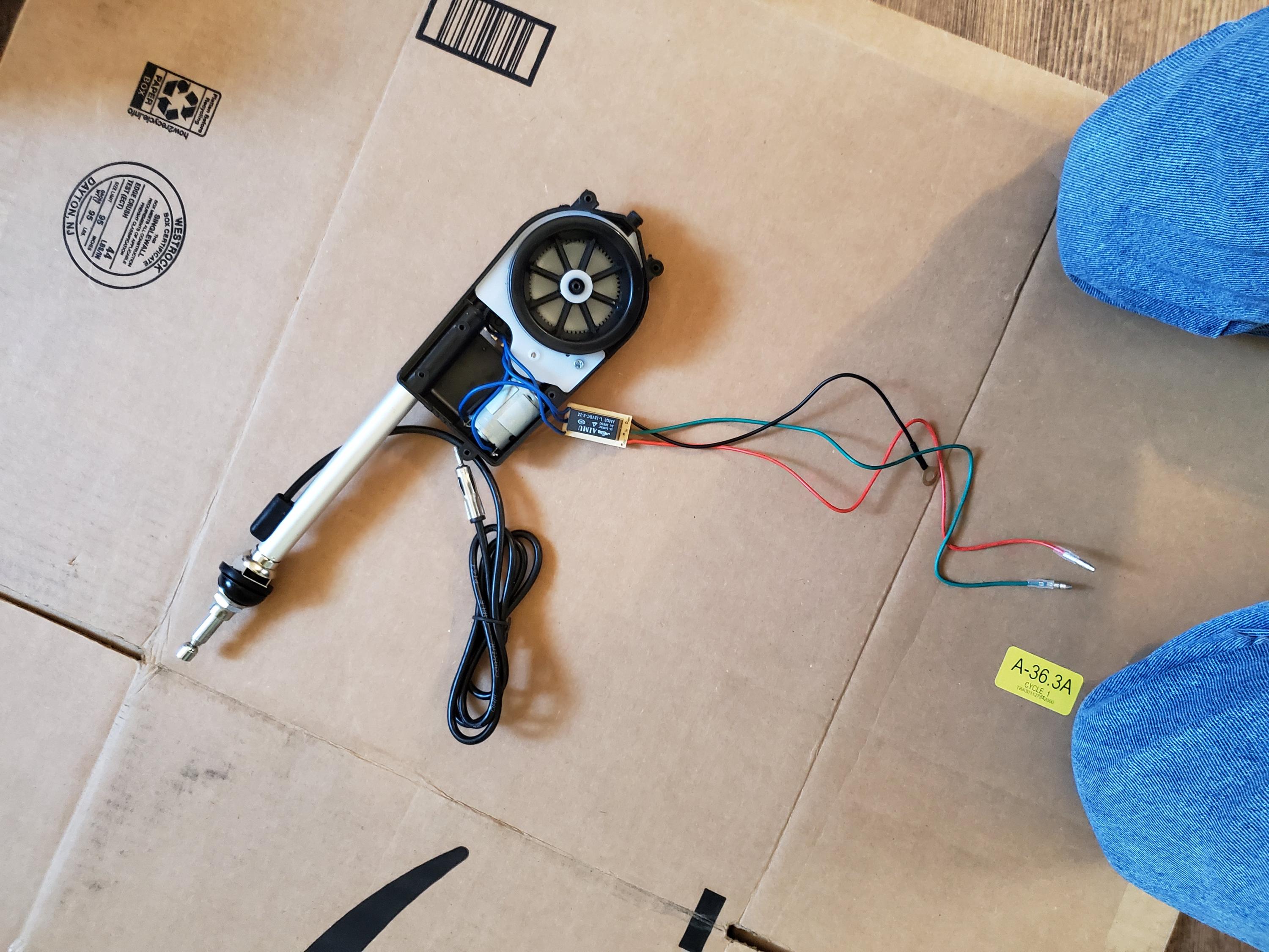

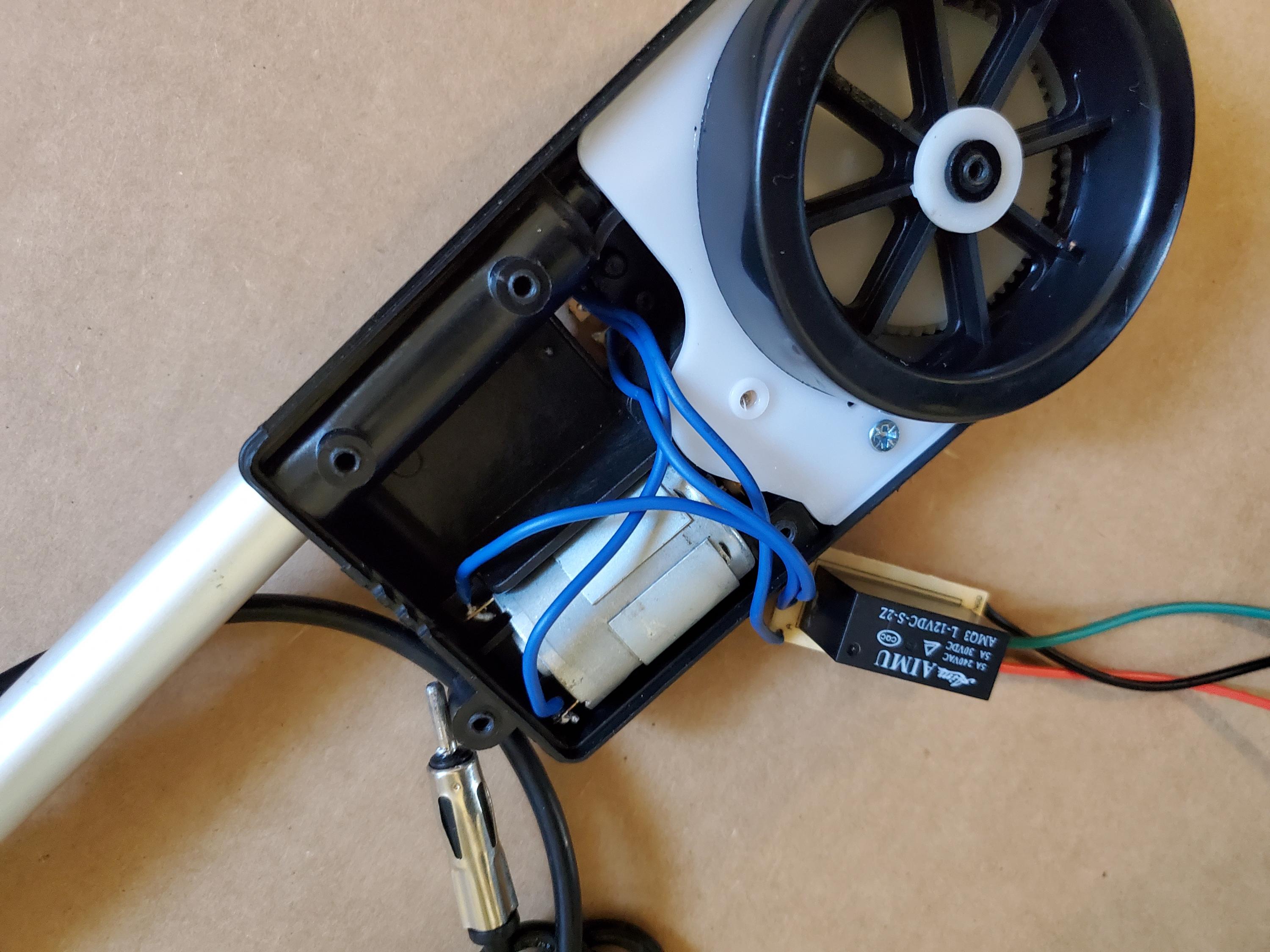

      Question1: What is the "thing" on the printed circuit board that is a rectangular greyish like box?
      Question2: Why is it that when the green wire is "removed" from the + voltage of the battery that the antenna has "power" to move?

        box is a relay, a magnetic switch.
        the relay reverses the motor wiring to change direction, and the motor stops at the ends because of limit switches.

            where do you think the diodes might be? all i see is this thing (see picture)

                i cant find any diodes any where. I did try flipping the wires to the motor but this did not seem to work.
                also, i noticed that the "gold" circular thingy in my previous post turns every so often when the antenna is going "out/up". Once fully up it stops turning. When i remove power from the green wire gold thingy turns more and then finally stops. I some how thing its this gold thingy that is "switching" the voltage but i am not sure how.
                anyone know how this thing is supposed to work?

                  The gold thing is the switch, it is a rotary switch. Because of the gear setup, simply reversing the motor won't work because it will try and run against the mechanical end of the travel.

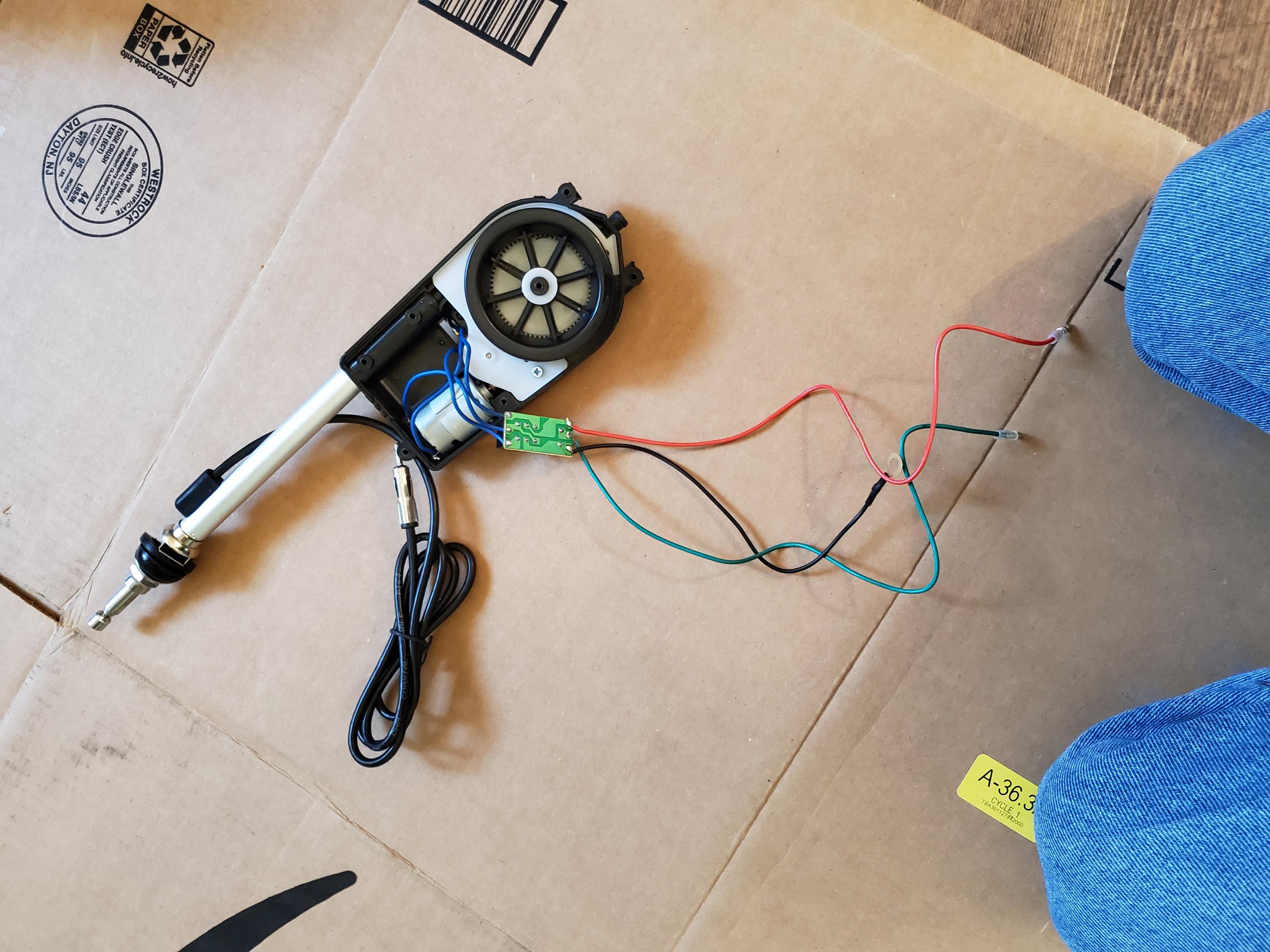

                    post a pic of relay wiring .

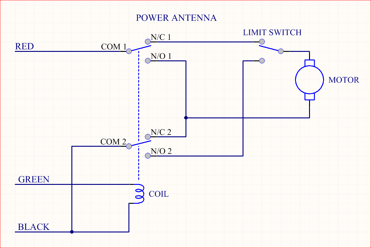

                            The limit switch is what latches power and keeps the motor running until it reaches an endstop. Not SPDT but it shorts the two ends until an endpoint. No need for diodes then.
                            Schematic might look like this, I assume a PTC is stashed in there too.

                              Also, redwire can you explain the picutre you sent. Not sure i understand it.
                                Originally posted by Welchs101
                                switched red and black keeping black wire on negative terminal and red on positive terminal. touching green wire to negative terminal does make motor turn to "lower" the antenna. However, when i remove green wire motor does not turn to "raise" antenna.
                                If your drawing is correct then that would explain what you are seeking
                                you would have to run the motor to end of travel before you can get it to travel in other direction to change the status of the limit switch
                                • redwire
                                  • Dec 2010
                                  • 3900
                                  Re: Powering up a Car Antenna a "different" way
                                  With nothing to the relay coil (green), see the diagram- it shows power can flow to the motor until the antenna-down limit-switch upper contact opens and disconnects the motor power.
                                  With the limit-switch now at one end (its upper contact open and lower one closed), the only way the motor can get power is if the relay is pulled in (with power on green wire). This gives reverse polarity power to the motor, so the antenna can go up.
                                  If power to the relay (green wire) is removed too soon, i.e. the antenna only made it half way up, the motor reverses and continues to move the antenna down.
                                  So the green wire seems to be an "antenna up" wire that needs power for the whole time the motor is going up. The limit-switch always disconnects power to the motor at either end.
                                  You want to flip this "My friend wants this operation to change. Instead of going up he wants the antenna to come down when i touch green to positive terminal. "
                                  You'd have to rewire the relay contacts so defaults to moving the antenna up, not down. I'll have to draw it later but I think 4-wires to move - swapping the NC and NO connections?

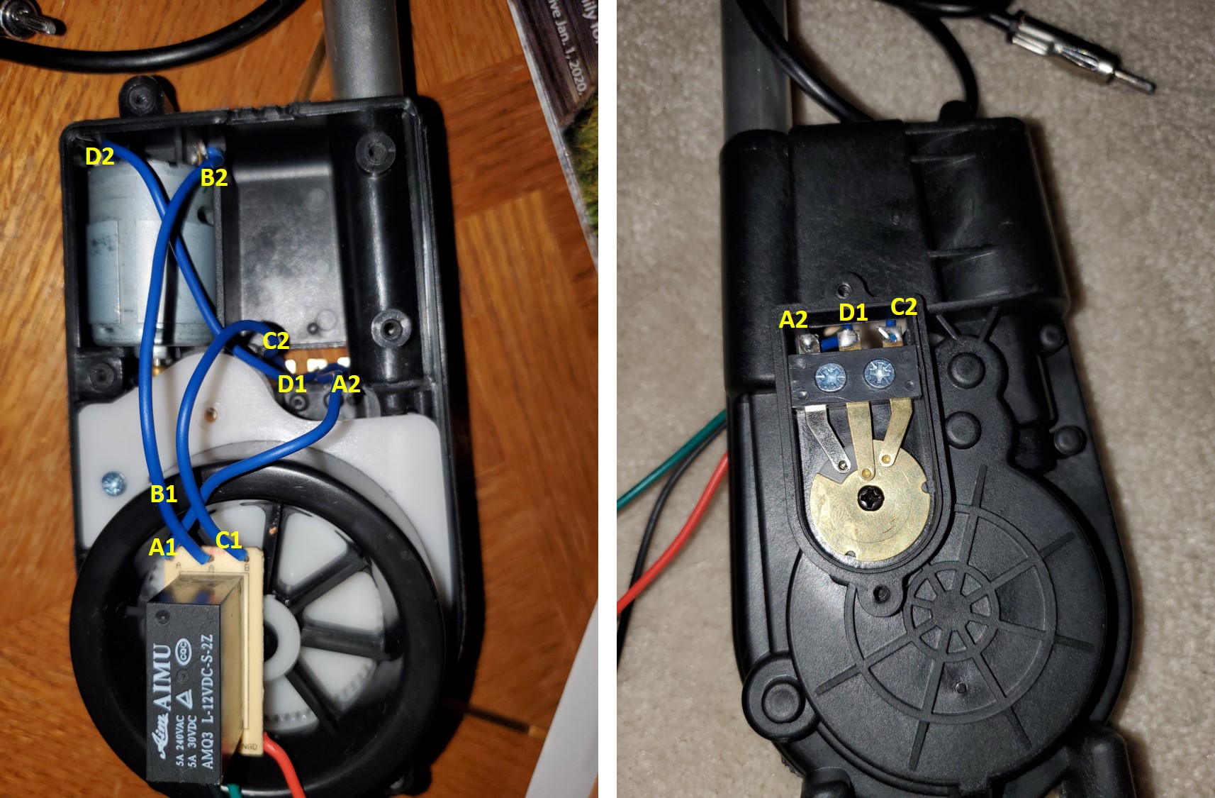

                                      i am enclosing the front and back views of the antenna showing how the wires are connected.

                                        Really sorry but i guess i just dont understand the drawing. For example, com1 and com2. They are switches and they appear to be somehow involved/connected with the blue dotted line........what does this mean?
                                        What are N/C and N/O?
