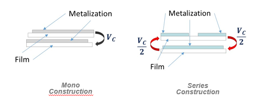

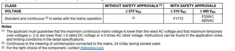

    Vishay calls it (capacitive dropper) "series impedance applications" and attributes the stress due to overvoltage spikes, 2.5kV for Cat. II. Safety is not so much an issue because a circuit has a fuse/fusible resistor present.
    App note AC Film Capacitors in Connection with the Mains
    X-capacitors have a series-plate construction. Example F1772-2 series is "extended" metalized film with internal series design:
    Ripple current is extremely high which is why I think the caps age fast. There is no datasheet spec for this. The aluminium deposition is only 0.02-0.1 µm thick and I imagine it cracks, giving low capacitance.
    I get long life if I have a series resistor say 100R with the cap, it lowers ripple current (and lowers cap transient voltage according to Vishay) but this resistor sees very high peak power pulses, and tends to burn up before a fuse blows.

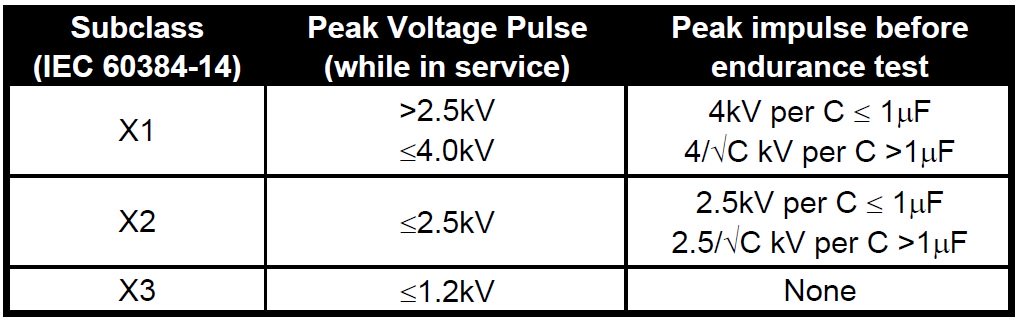

              What's the original cap rating, as in X1 or X2 and VAC? over 2.2uF? Size?
              X-caps have thicker dielectric for higher withstand voltage on mains transients. So they are naturally huge. If there is a MOV upstream to lower the spikes- then you can use a smaller ordinary film capacitor. Perhaps this technique was used by ELKO? The TVS I did not quite understand and wonder if has gone open.
              The (fusible) resistor limits current the cap and zener will see. 1uF is 120mApk at 240VAC.

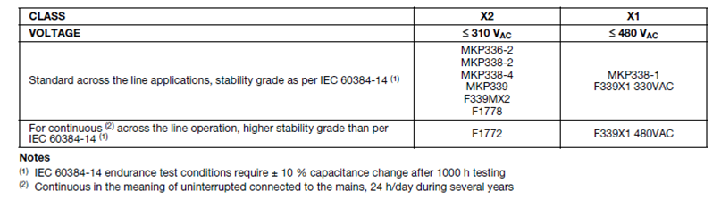

                  Response from Vishay Film Capacitors Division:
                  "It is because of Corona effect.
                  Corona effect is electrical discharge (partial breakdown) which results from ionization of air on the surface or between the capacitor plates in AC voltage applications or in rapid changing DC voltages (pulses). However, film capacitor has the feature called self-healing. After one discharge, one self-healing. As a result, loss increase and capacitance decrease.
                  When there is too many corona effect accumulated, the capacitor will be failed.
                  Therefore, if we make internal 'series construction', we can make the voltage between capacitor plates half. It will be much lower than corona start voltage, in order to avoid corona effect.
                  F1772 is internal series construction.
                  At last, I suggest you also read our attached application note.
                  Please note two tables in it.
                  We recommend that for continuous across line application and in series with the mains application, internal series construction capacitor should be used."
                  *Notice the X-cap's standard has a +/-10% over 1,000hours - much shorter than continuous use and I would say X-caps are also degrading/aging the same way but it's not noticed.

                    Re: Capacitive dropper supplies not lasting
                    Yes, this is the document I based my initial post on.
                    Sorry I forgot to attach it then.
