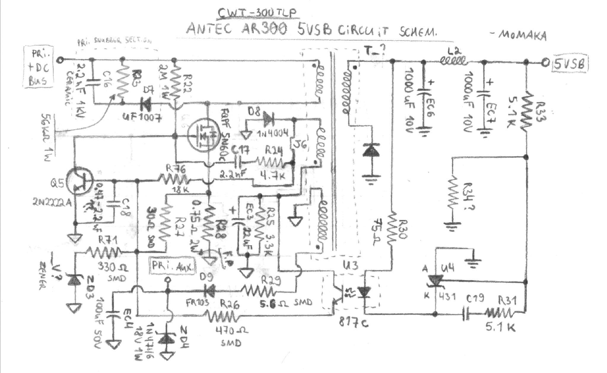

                        Re: Antec AR300 psu, loud squeal, no power
                        Hi Jon and welcome to BCN!
                        Given this thread has last had a reply in 2011 (12 years ago), there's probably a slim chance anyone still participating here would have this PSU... but who knows, of course.
                        Do you have a multimeter at your disposal? If yes, we may be able to deduce the value of C18 simply by knowing how it's connected in the circuit. Looking at pictures earlier in the thread and also this one, C18 appears to be on the primary side, connected to the optocoupler through resistor R26 (470 Ohms) and then goes through a few resistors and connects either to small transistor Q5 or the Gate/Base of the larger transistor on the heatsink (it's a bit hard to tell from the pictures from other posts... so if you could provide further pictures, that would be very helpful. Just please attach them to the forum using the built-in attachment feature, so the images are hosted here and not on an external website.)
                        With your multimeter, can you verify if one side of C18 connects to primary-side ground (the negative lead of the big capacitor on the primary side)?
                        If yes, I suspect C18 may not be entirely critical (probably there for when the 5VSB circuit is running completely unloaded.)
                        This PSU appears to be made by Channel Well Technology (CWT), but the 2-transistors 5VSB self-oscillating circuit they used here does not seem too similar to their ISO -line designs. However, looking at my collection of 5VSB schematics, the closest that might resemble something like your 5VSB circuit is from a HEC Orion HP585d I posted here:
                        https://www.badcaps.net/forum/attach...1&d=1578459617
                        ^ On that one, your C18 would likely correspond to the 0.47 nF ceramic capacitor connected to the Base of the smaller PN2222A transistor in the above schematic.
                        Now, I also have a Deer DR-250ATX PSU's 5VSB schematic (that I have not posted on BCN yet), which also appears very similar to the HEC Orion HP585d 5VSB circuit. On that one, the capacitor has a value of 2.2 nF... but the series resistor corresponding to R26 is only 100 Ohms. So I suspect the higher capacitance used in the DR-250ATX 5VSB is due to the lower series resistance (100 Ohms) after the optocoupler... whereas on the HP585d, it's the same 470 Ohms as your R26.
                        That being said, I think there's a good chance a value of 0.47nF to 1 nF should work OK... or maybe even up to 2.2 nF.
                        Either way, just beware that if everything is not perfectly right with these 2-transistor 5VSB circuits, they tend to blow up a lot of parts. So double-check all of the other parts in the circuit before powering it up. I'm sure you probably already found many other parts bad. The main take-away is to make sure the output capacitors on the secondary side of the 5VSB (EC6 & EC7), as well as the "startup" / "critical" capacitor (EC4) are all good.
                        And even if everything checks out OK, it would still be a good idea to use a series incandescent light bulb in series with the PSU's AC Live to limit the current / power going into the primary side, in case there is still something wrong with the 5VSB circuit. This could save you from blowing up fuses and many other parts.
                        The series incandescent bulb "trick" is detailed here:
                        https://www.badcaps.net/forum/showpo...51&postcount=6
                        and here:
                        https://www.badcaps.net/forum/showpo...4&postcount=70
                        Use 40-60 Watt bulb at first... and if needed, then maybe jump to 100 Watts.
                        Since incandescent bulbs can be hard to find above 40 Watts, you could also use something like a 60-72 Watt Halogen... or 2x 35W halogen bulbs in parallel (equivalent to a 70W Halogen)... OR, 2x 40W appliance incandescents in parallel (equivalent to 80 Watts incandescent.)
                        Let us know what you find.

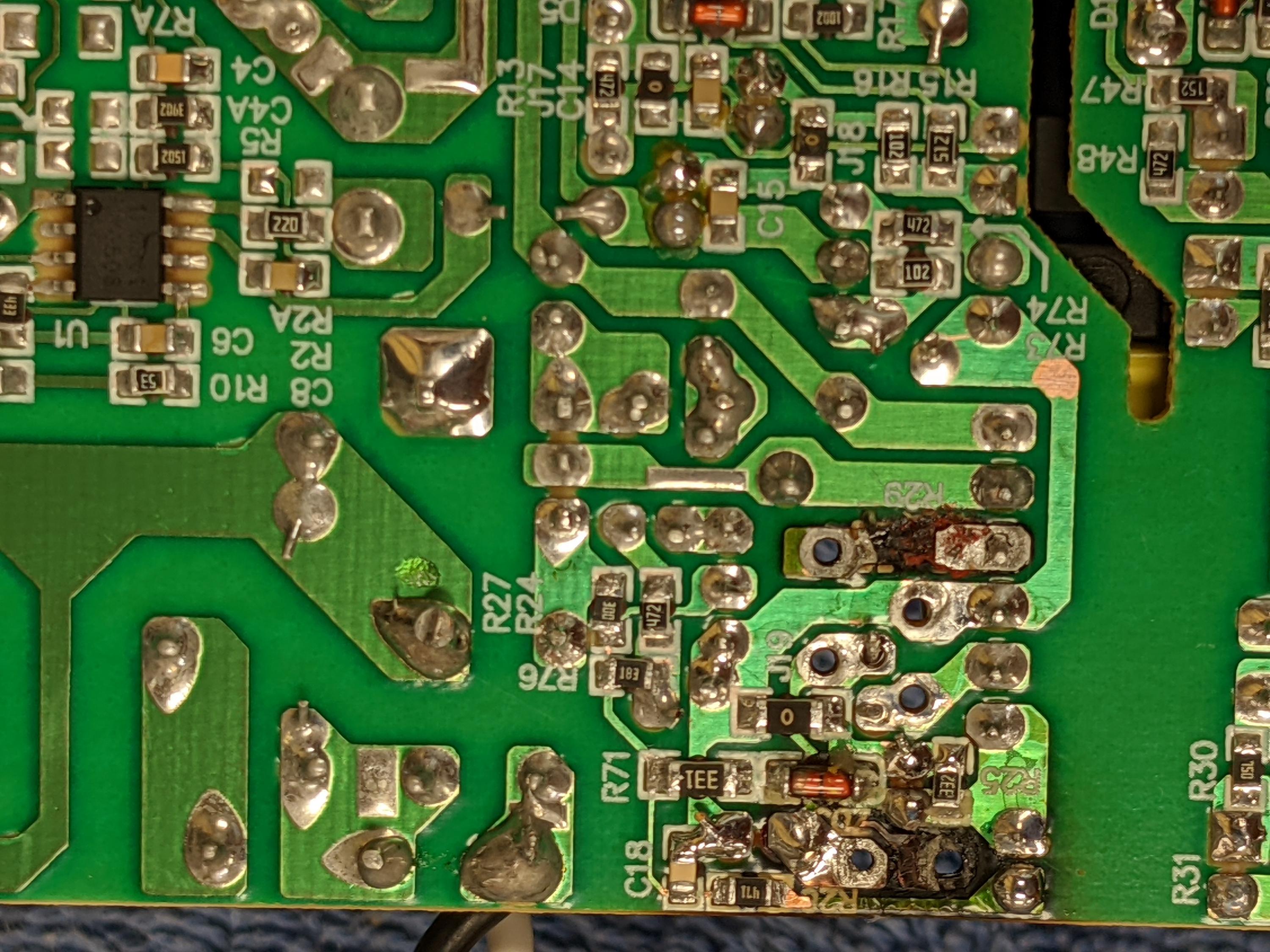

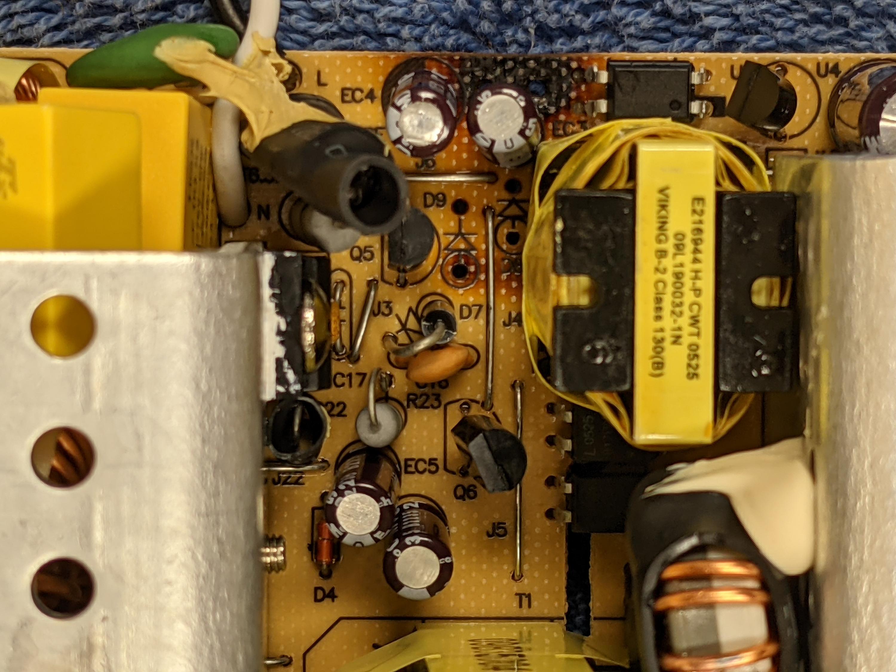

                          Hi momaka, thanks for all of the help/information. I would like to answer your questions with some confidence; so I am looking at the pcb and trying to see exactly how c18 fits into the picture. I will get back when that work is done. Jon
                          • need_info
                            • Mar 2020
                            • 9
                            #33
                            hi,
                            Took a couple of photos. Not sure what you were looking for so ask away.
                            The two missing diodes are: D9 FR103, D8 1N4004. Some other components have not been replaced yet. Most of the ECnn have been replaced.
                            Jon
                              Hi Jon,
                              Thanks for the good quality pictures, they really help trace the circuit out.
                              Give me a day or two, and I'll try to draw out a schematic for this 5VSB circuit, based on your pictures. Hopefully that might make it easier to understand some of the values.
                              But in any case, it looks like C18 is indeed a low-value capacitor, somewhere in the low nF range (again, 0.47 to 2.2 nF likely.)
                              R29 also seems to have obliterated, taking the trace along with it. But I think the 5VSB can be tested without R29 and D9 for now, as it appears these are for the primary side aux. supply (which provides power to the main PS PWM controller on the primary side.)
                              D8 and the burned Zener diode next to EC3 need to be replaced, though.

                                        #39
                                        Awesome!
                                        Below is a schematic of the Antec AR300 5VSB circuit I was able to draw from the pictures provided so far.
                                        To anyone reading, please note that I don't have this PSU in front of me, so don't assume the schematics are 100% accurate. If anything, I drew the secondary side in a rush, so some components may not be placed right (R34, R31, C19.) The primary side should be mostly right, though. It seems to resemble the circuit of the HEC Orion PSU I linked to earlier in post #31 and some other 5VSB circuits I've drawn before.
                                        Some interesting observations:
                                        This 5VSB circuit has two (2) primary-side auxiliary outputs - one for its own feedback loop (generated by D8 and filtered by EC3), and one for the PWM controller of the main PS (generated by D9 and filtered by EC4, with ZD4 serving as OV protection), which I labeled "Pri. Aux." on the above schematic.
                                        Note that you don't need to have the Pri. Aux. circuit working to have the 5VSB working. In other words, for anyone troubleshooting this PSU's 5VSB, you can still get 5VSB output, even if R29 & D9 are completely removed from the circuit. In fact, it's preferable to have those components removed while troubleshooting the 5VSB. Once 5VSB operations has been successfully restored, then R29 and D9 can be replaced back in the circuit.
                                        Regardless of the repair steps taken, make sure EC3, EC6, and EC7 are in GOOD HEALTH before powering on the 5VSB circuit. EC3 is the startup & "critical" cap of the 5VSB circuit. If it goes high ESR, the voltage on the output may start rising... or alternatively, ZD4 may get burned out, along with resistor R29.
                                        As always, I recommend to use an incandescent / halogen bulb in series with the PSU's live AC input to prevent component damage if something was missed and/or not replaced by mistake.
