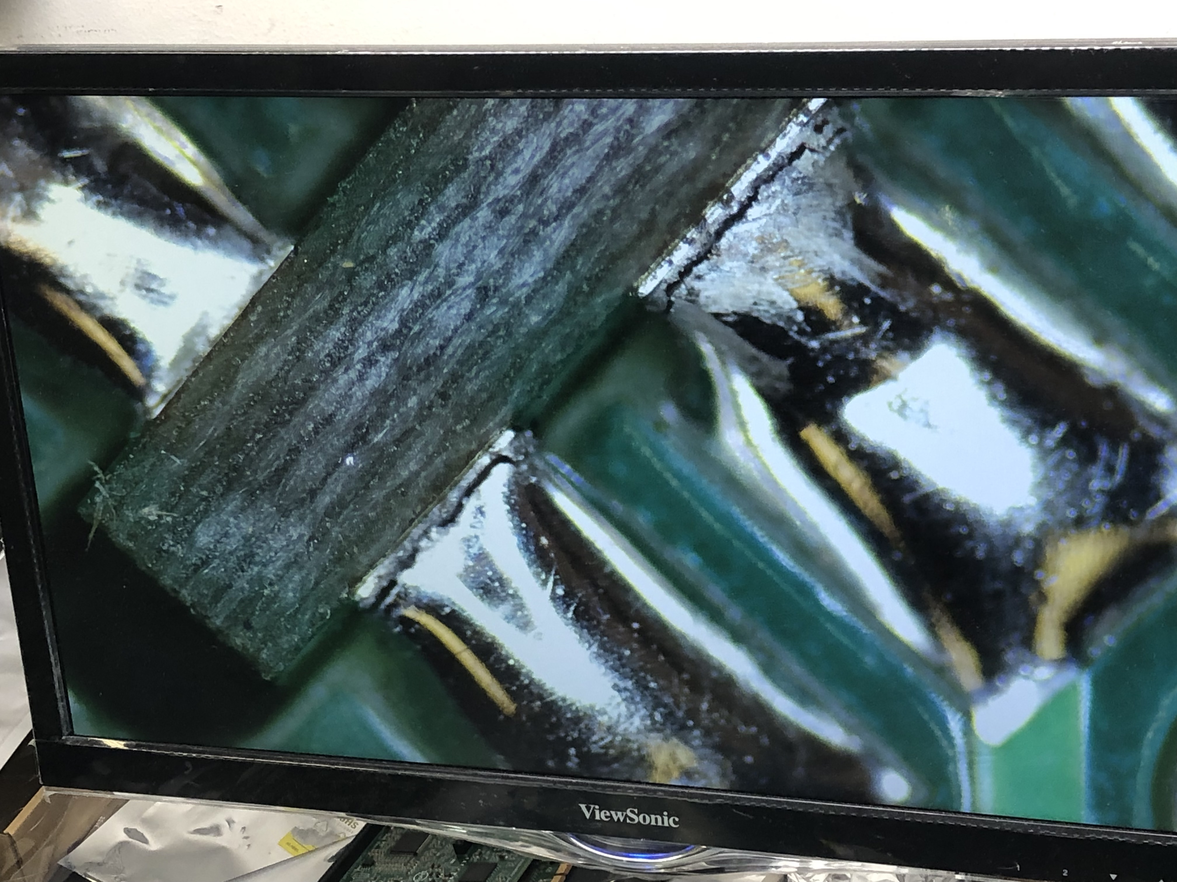

                Power supply rails appear to be stable. +-40 is ~38v. +-16v is ~16v. After assorted permutations to open this beast, our 1khz injected tone appears to be clean at the output. Soldered back the darlington output transistors and mated the speakers - still clean. When brought in, the noise was unbearable out of the speakers. Loose connections? Will keep testing.
                  • 31246
                  maybe cracked solder joints.
                  • mon2
                    • Dec 2019
                    • 14657
                    Indeed on the DSP board. See attached. Soldered them back but still no activity on the LEDs.

                      Plugged in a guitar which works fine with our attempt to play music but there is a background high pitch tone (much like the 1khz we were injecting from our scope). This is when the guitar is plugged in and sitting idle. If the 1/4" plug is disconnected, then there is still this tone (corrected update).
                      Will post a new audio of the tone.
                      Is this normal to have this background (annoying) tone? Still trying to validate if the DSP is working or not - all of the LEDs on this DSP board are dark.

                          • 31246
                          focus on the dsp board i think
                          • mon2
                            • Dec 2019
                            • 14657
                            Yeah - the DSP board appears to be dead and was purchased this way. Will search for the DSP component but not sure if there is firmware involved or not. A royal pain to probe at the awkward angles for this vertical mounted PCB that is like an oreo sandwich inside of the cut slot. No connectors - just raw PCB pads being soldered to mate with the 90 degree main board.
                            • CapLeaker
                              Leaking Member
                              • Dec 2014
                              • 8339
                              I guess they use the DSP board for the delay, reverb etc. If the reverb isn’t working the DSP is dead. Verify if it is getting any power.
                              These kind of speakers have a hard life. Being tossed and kicked around, stored in a wet basement, spillage, etc… perfect recipe for cracked solders and other damages.

                                Have verified that the DSP is indeed receiving 3v3 via the +10v rail then a local LDO. However, no led is being driven. Will investigate the 2N2907 that is onboard the add-on board with the bank of leds.
                                Yes, found about 4 screws that are rusted but otherwise, very clean solder joints under the PCBA. The unit is working much better than when it was brought in but a bit baffled as to how it 'cured itself'. Perhaps the handling of the assorted cabling / pcbs. So far, unable to see any bad solder joints other than on the DSP board (which is still not working).
