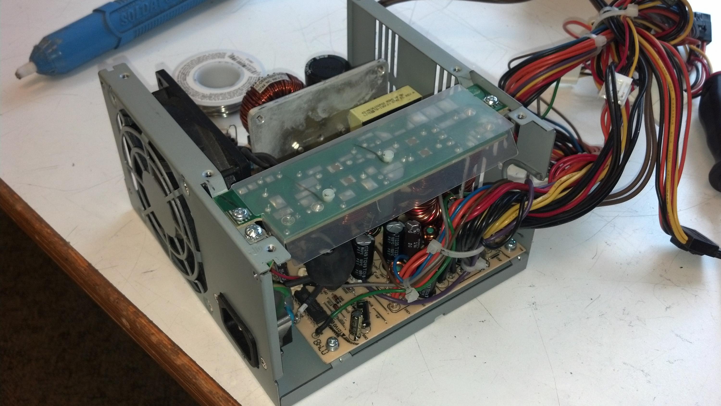

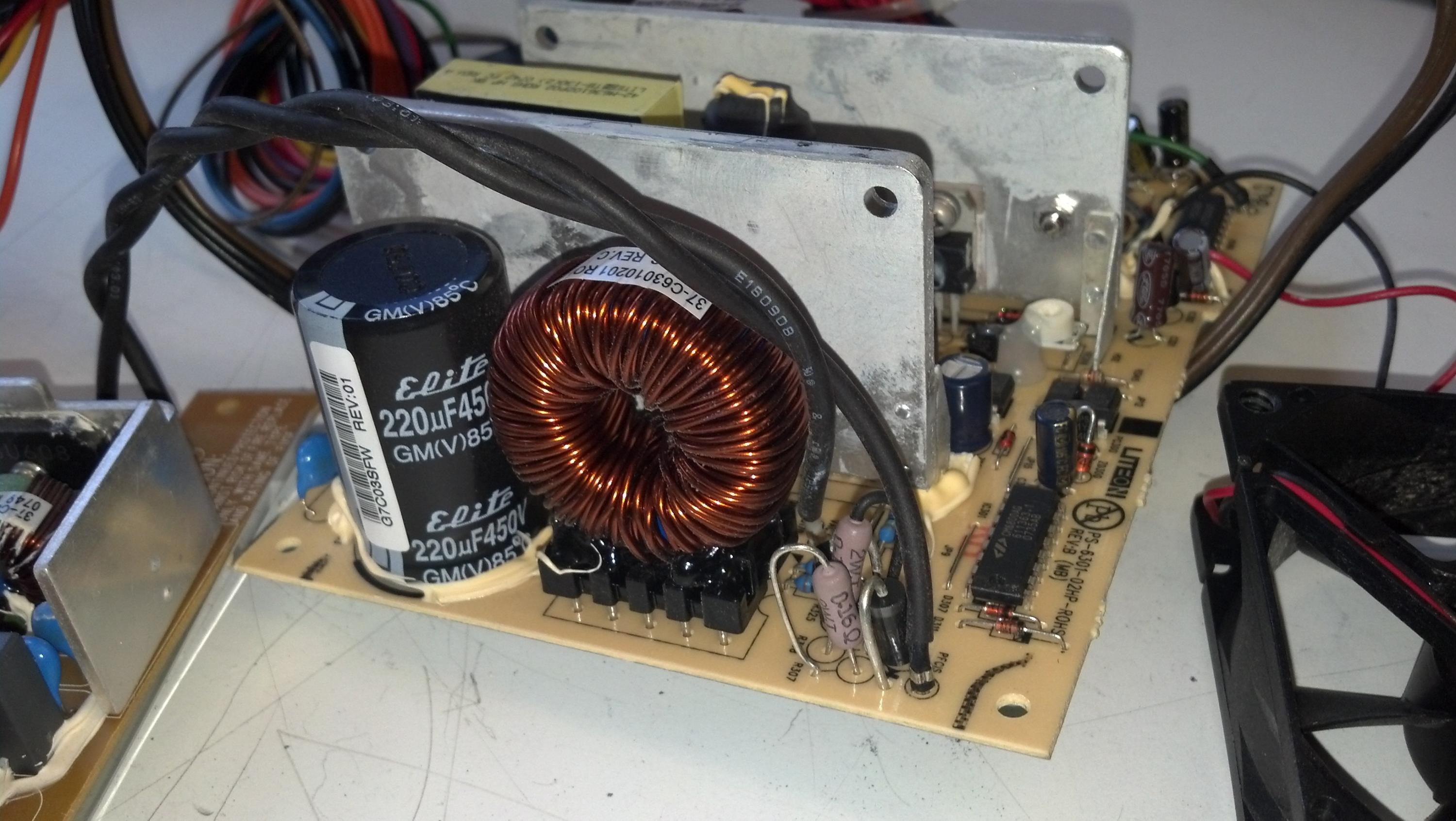

      Got a decent little PSU here, well, after I modified it.... not sure who the OEM is
      Originally had 560uF input caps, replaced with 820uF. Added a heatsink to the 8A bridge rectifier. Notice how it has a Viper22A for 5VSB I forgot the model of the MOSFETS, but it has 2 on that primary heatsink rated at 14A
      Replaced all the capacitors of course, using some 3300uF 16V Samxon RS caps from behemot Originally, ALL of the caps were Asia-X.
      I replaced the two 20A schottky's on the 12V with two 30A schottky's. This thing does indeed have dual 12V rails.
      How many watts do you think this is good for? It likes to hang around 79% efficiency. I really need to get a load tester...

        I think it ExplodeGen or the other crap, looks very similar to different EuroCase PSUs on my market which also uses Asia-X. The transformer does not seem that big so I think some 400 W safe?

          No way Codegen could make something like this Although yes 400W seems about right because of the transformer. When loaded to around 300W, the secondary heatsink got to around 50C so the fan kicked up to an audible level, but the primary heatsink was hardly warm at all

            They actually can. I have seen a couple of half-decent Codegens out there before. That said, I doubt they're behind that unit. I think it should do somewhere between 300 and 400W, depending on the switchers.

                If it has 15A (continuous) switcher, like 2SC3320s, then 400W should be OK. With 12A switchers, (13009, D209L), then I wouldn't want to push it harder than 350W.

                    Unless the fan(s) are almost sufficient for that P/S to hover, I'd agree with ~400W. Decent heatsinks, for that power level. Kind of wimpy O/P inductors - the cores, which are also -26 material rather than -52 (which would have lower losses, especially if the switching frequency is >50KHz). With those very uprated I/P lytics and 400W load you would have very decent hold-up and ride-through times for a 400W P/S. 560uF for 600W?

                      I wish that the primary and secondary heatsinks were swapped. The secondary heatsink is a little small in my opinion to have four TO-247 rectifiers attached to it. The output inductors are indeed pretty tiny. At least it has one for each 12V rail. I might swap them out for bigger ones, I just thought it was getting a little cramped in there on the secondary.
                      When you say "26 material cores" are you referring to the toroid coils?

                        Micrometals powdered iron core materials
                        -26 and -52 material have the same permeability and the same inductance for a given number of turns, but -52 material is newer, has lower core losses above 50KHz, and costs a little more.

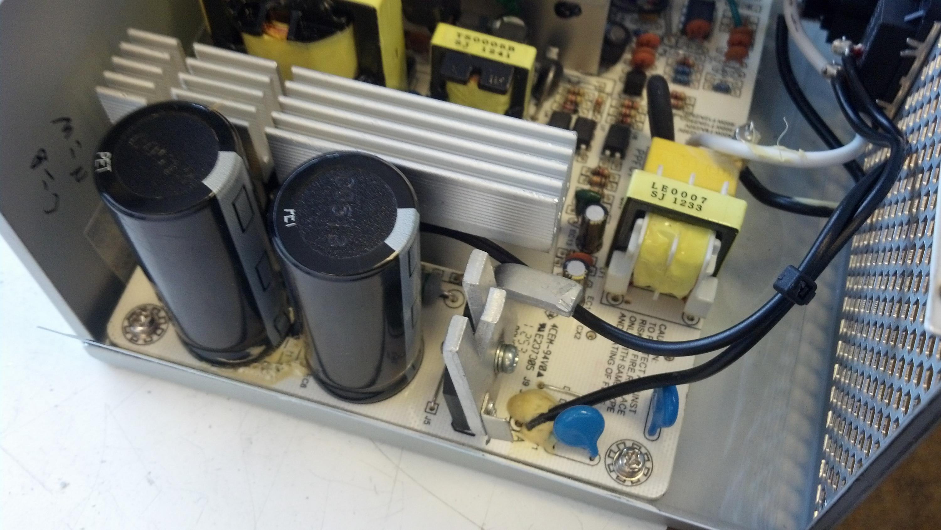

                              Nice Liteon unit...Very well built for 300W. Replaced most of the caps of course.

                                Those finless heatsinks are somewhat disappointing, but that probably means it's an 80+ unit of sorts. The ADDA sleeve bearing fan probably will eventually fail if it hasn't been preemptively lubed. Lite-on PSUs are pretty well built, though. Their older units said on the label that they would sustain their labeled rating up to 50*C ambient. Definitely true from the way they were overbuilt inside.

                                  True, I do not like that style of heatsink either. Yeah that thing looks like it could handle some heat. Impressive to see a 6A bridge with a heatsink in a 300W PSU. And a 220uF input cap for a 300W is pretty impressive, I've seen single 220uF in 400W PSU's (That could actually do their wattage)

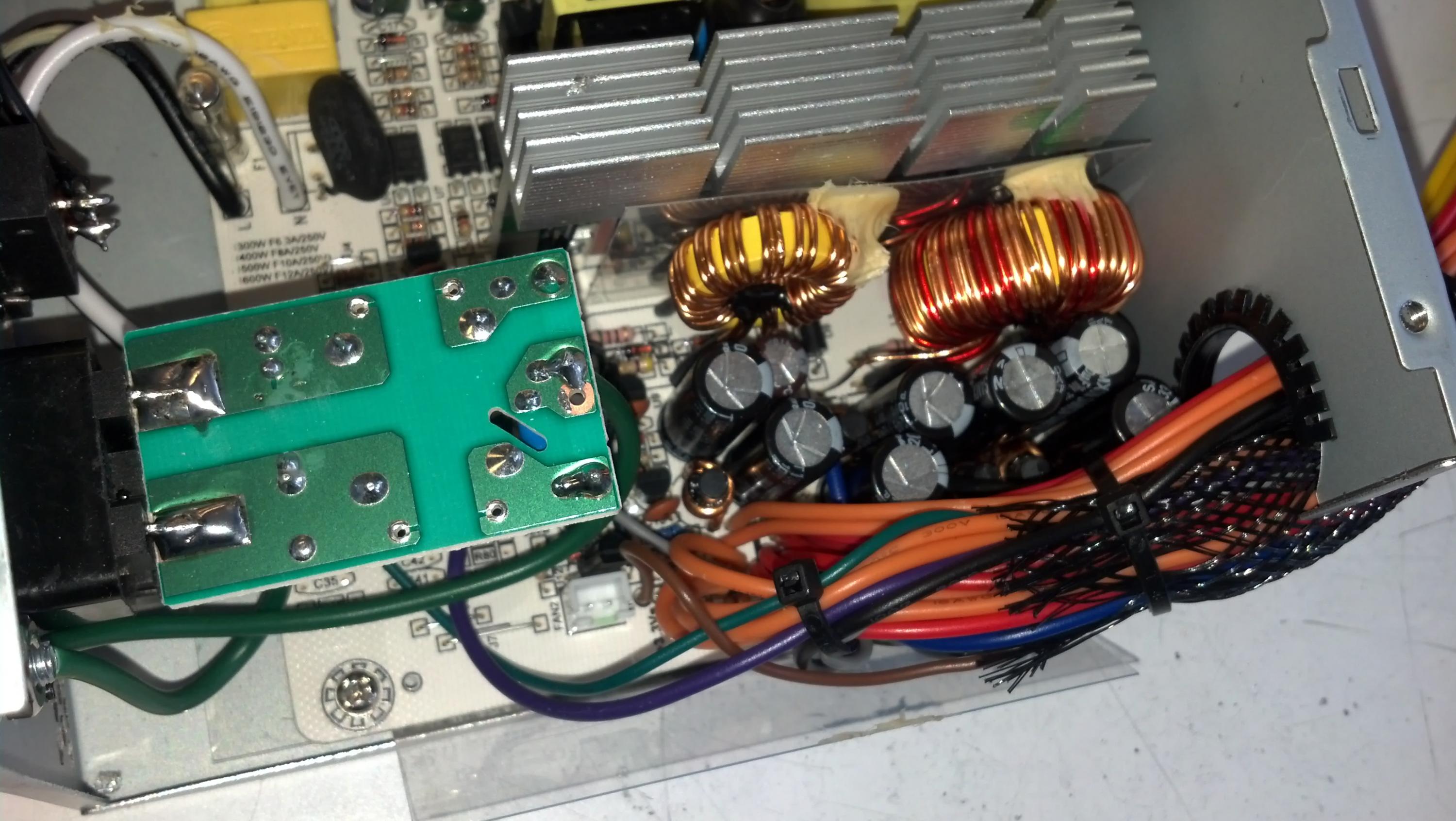

                                    Linkworld AT psu with maximum out___put of 150W.
                                    Every single electrolytic cap in this unit are Fuhjyyu, none appear to be bulging though and the PSU still works fine.
                                    Input caps are 220uf 200V Fuhjyyu with Teapo style vents?

                                        I would say that thing looks horrible, but for being made in Dec. 1996, it looks pretty good! Minus the caps of course. They look fine but they're probably dried out or out of spec. Interesting, the Teapo style vent on those input caps...And it has a bridge rectifier, wow! How many amps is it?
                                        Looks like it'd do its rated wattage, although I think 220uF input caps are pretty wimpy even for a 150W PSU
