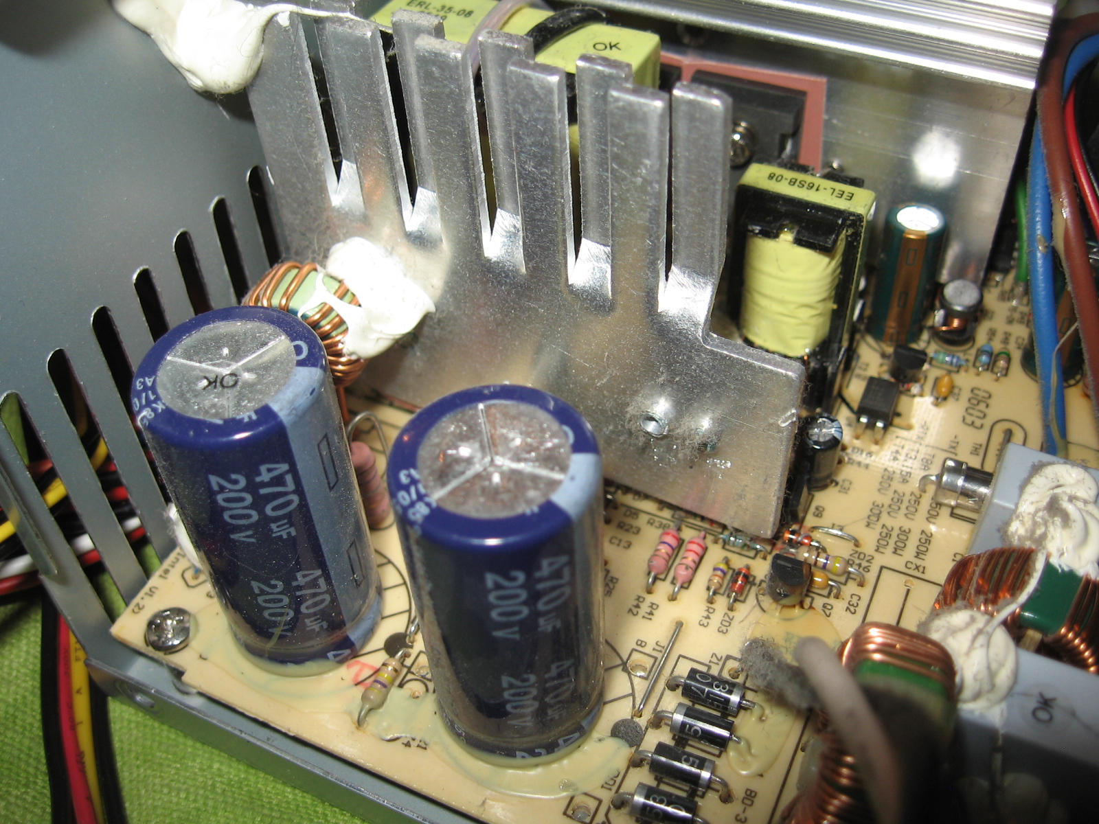

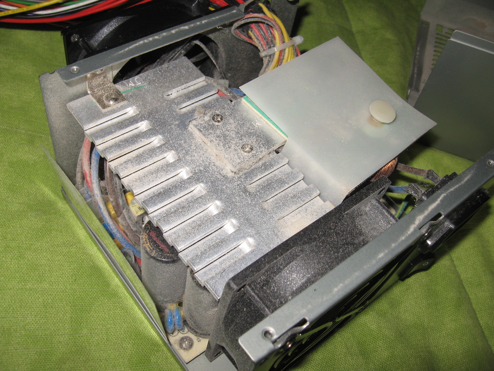

    This was a interesting unit IMO. Dual fans and huge heatsink covering almost whole PCB.
    However, after opening the unit, the truth came out... 2x 820uF JEE caps on the primary, Fuhjuyy on the secondary.
    And a lot of dust, probably thanks to the intake fan.

        The Altis label layout is similar to this:
        https://www.badcaps.net/forum/attach...3&d=1289081146
        https://www.badcaps.net/forum/showthread.php?t=11930
        The psu should be HEC. They make decent power supplies, after recap.

                    It's a Wintech built unit, the single heatsink gives it away.
                    • c_hegge
                      • Sep 2009
                      • 5219
                      #650
                      Yup. The Deltaco looks like a Huntkey, The silver power is a wintech, and the other one is HEC/Compucase.

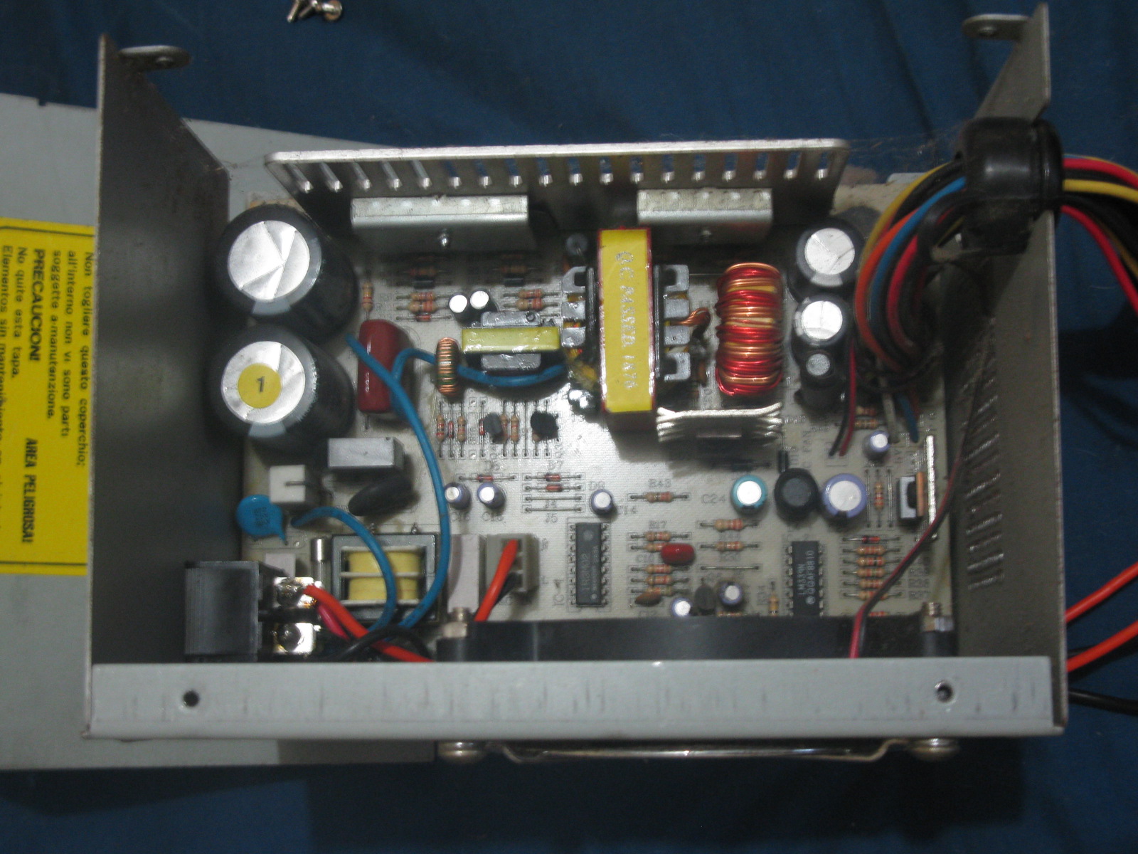

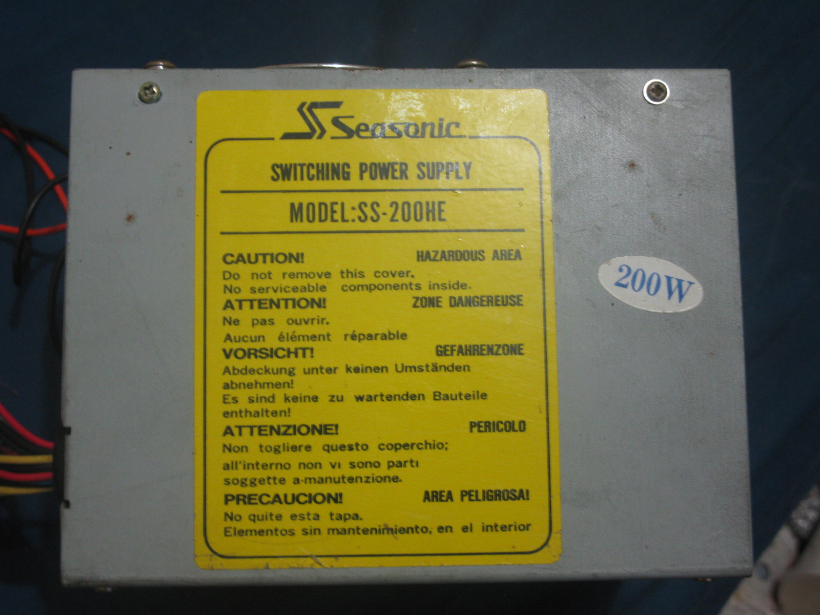

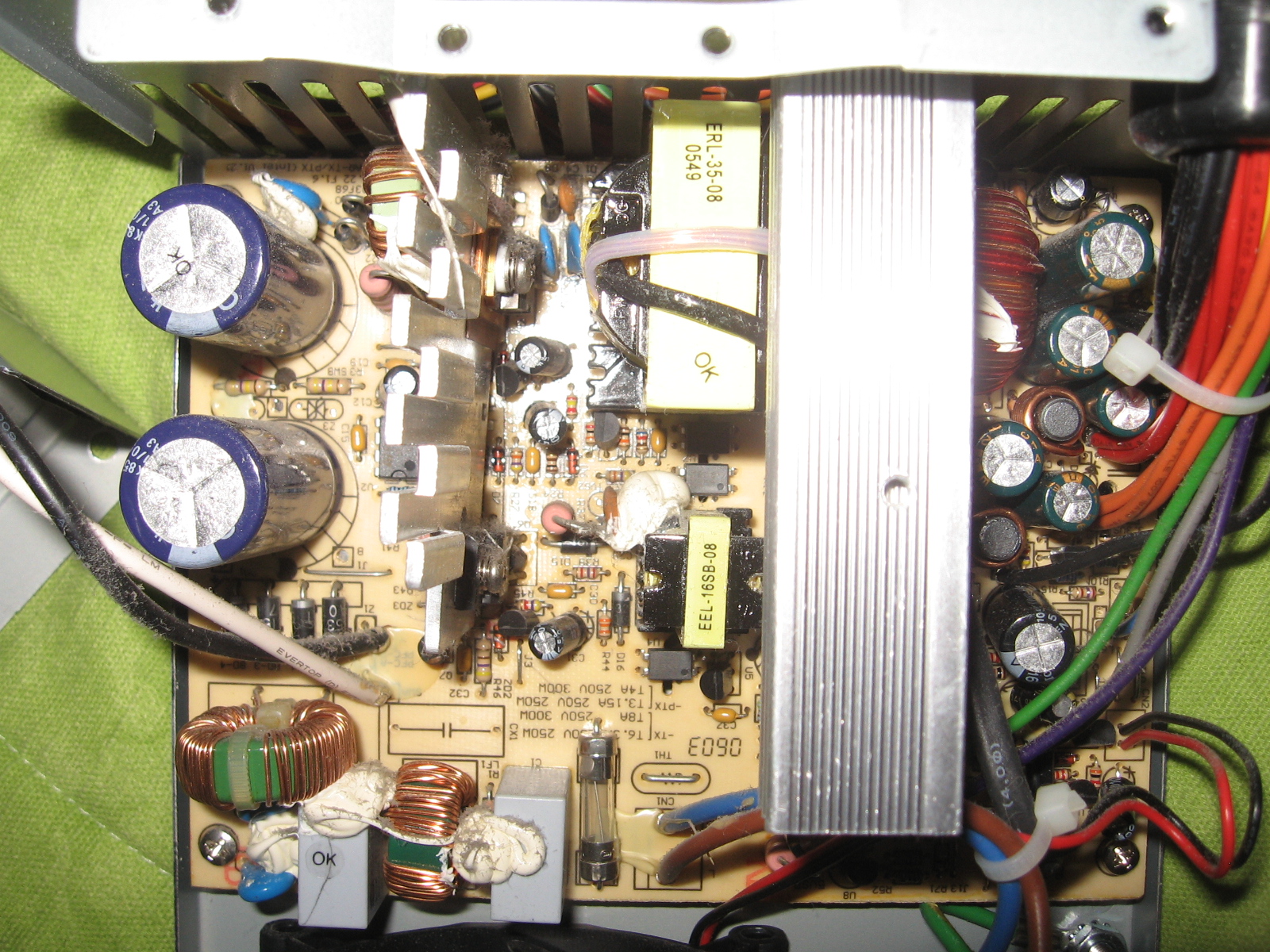

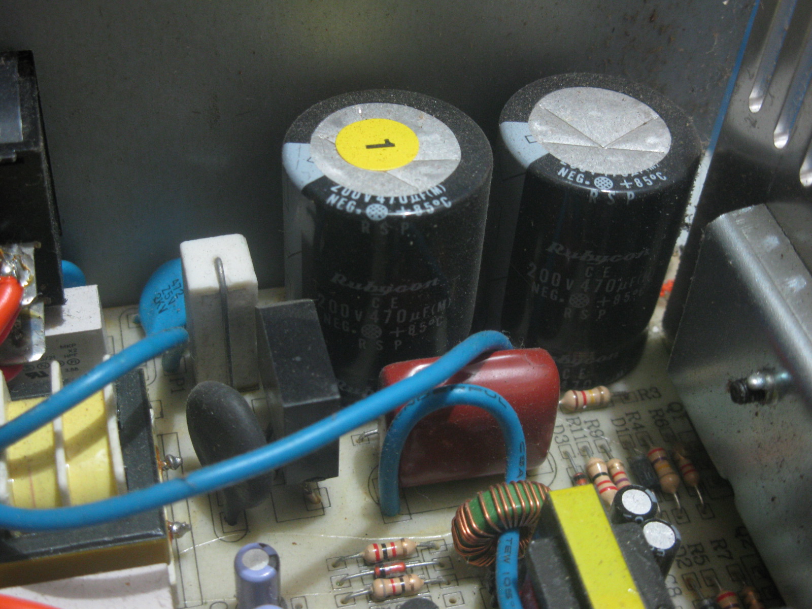

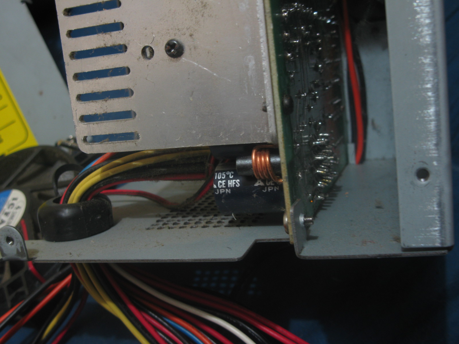

                                        Blast from the past: A Seasonic SS-200HE from around 1989. The PCB is dated April 12 1988.
                                        Wiring is all 18AWG, and there are only four Molex connectors - two on the same cable and two on separate cables (most likely for 5.25" A: and B: drives; there are no 3.5" floppy connectors).
                                        There is a good 1-1.5 inches of blank space underneath the PCB, with only a small amount of wiring for the AC/ground connectors, and cobwebs, making use if it. There is one solitary resistor on the solder side as well.
                                        C5: Rubycon CE RSP 470uF 200V 85°C 8954W
                                        C6: Rubycon CE RSP 470uF 200V 85°C 8954W
                                        C7: Cehtr 1uF 50V 85°C
                                        C8: Cehtr 1uF 50V 85°C
                                        C13: S.I. 2.2 uF 50V 85°C (under fan)
                                        C14: S.I. 4.7uF 50V 85°C
                                        C15: S.I. 1uF 50V 85°C
                                        C16: S.I. 4.7uF 50V 85°C
                                        C17: S.I. 10uF 25V 85°C
                                        C21: Matsushita CE HFS 2200uF 10V 105°C
                                        C22: Matsushita CE HFS 2200uF 10V 105°C
                                        C23: Matsushita CE HFS 1000uF 16V 105°C
                                        C24: TREC 47uF 50V 85°C (no temp rating)
                                        C25: S.I. 470uF 16V 85°C
                                        C26: S.I. 47uF 16V 85°C
                                        C27: S.I. 1uF 50V 85°C
