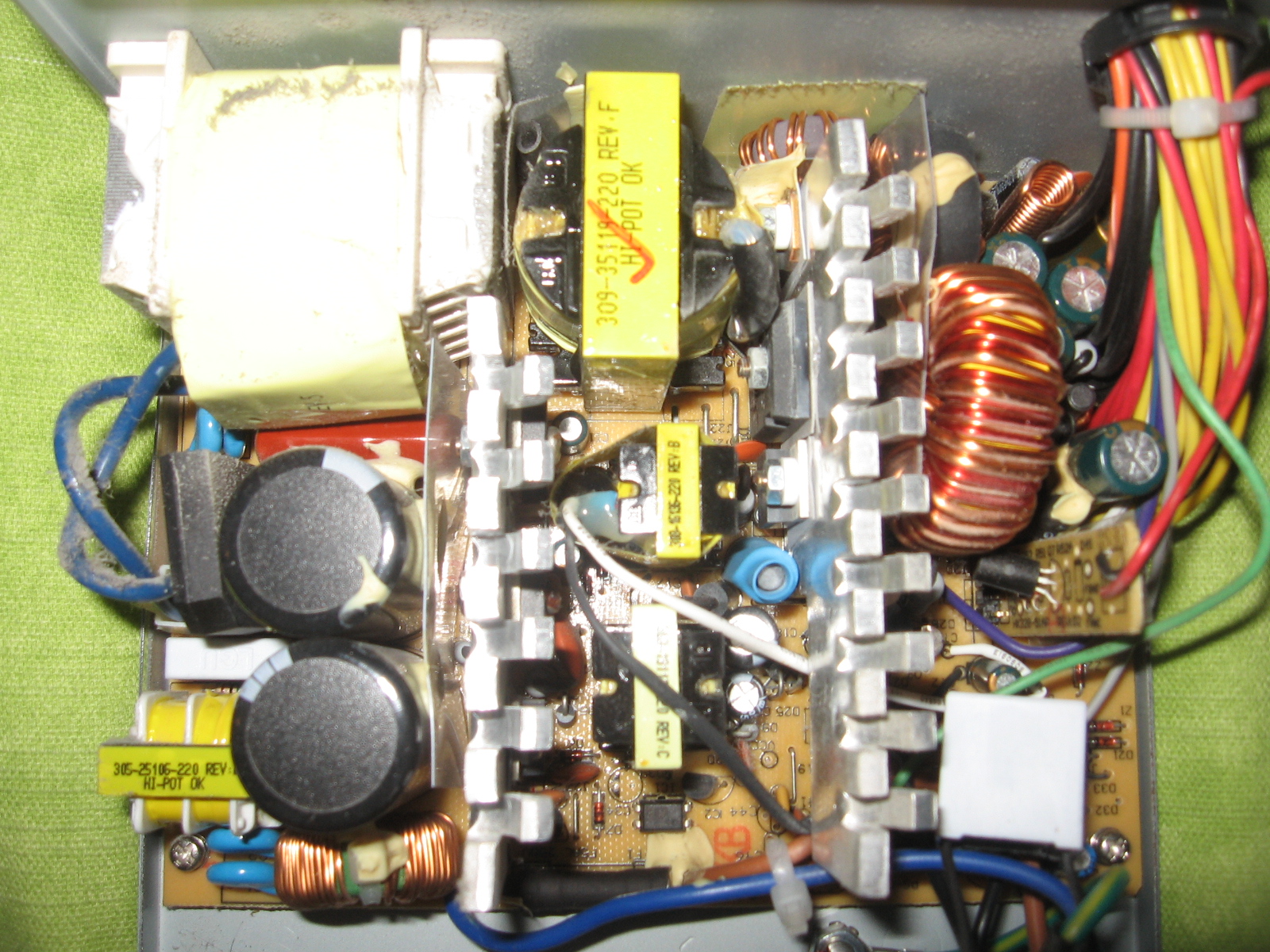

                                        Providing pictures of three random / unknown brand 350W PSU's in the next three following posts. These are always interesting IMO...
                                        The models of the PSU's:
                                        1. Deltaco PSU-215 350W
                                        2. SilverPower SP-350PSF
                                        3. Altis ATX-350-PT (EC)
                                        • Jooo
                                          • Oct 2011
                                          • 222
                                          • Finland
                                          #640
                                          First off, the Deltaco PSU-215. Caps were mostly Teapo. Nothing too interesting here...
