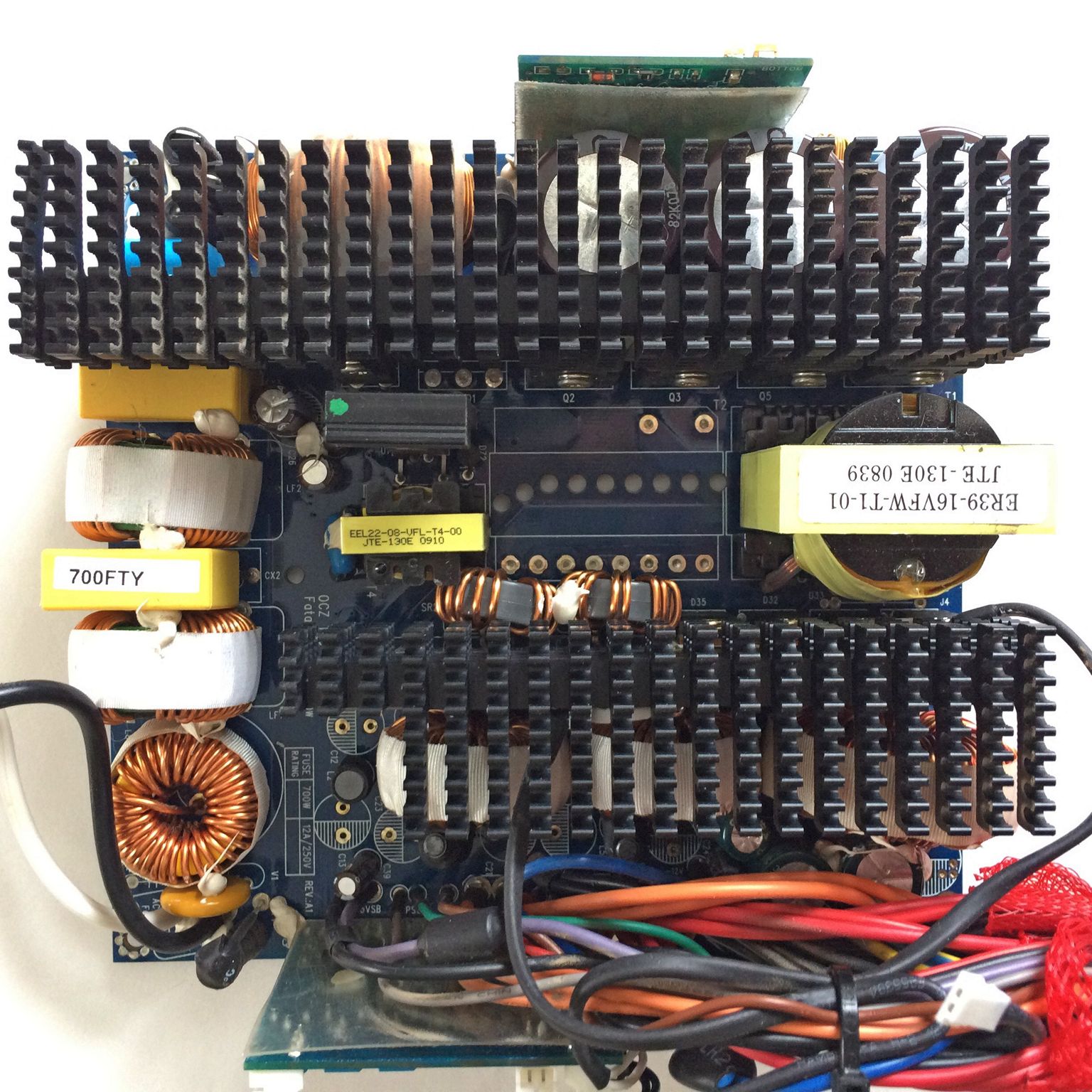

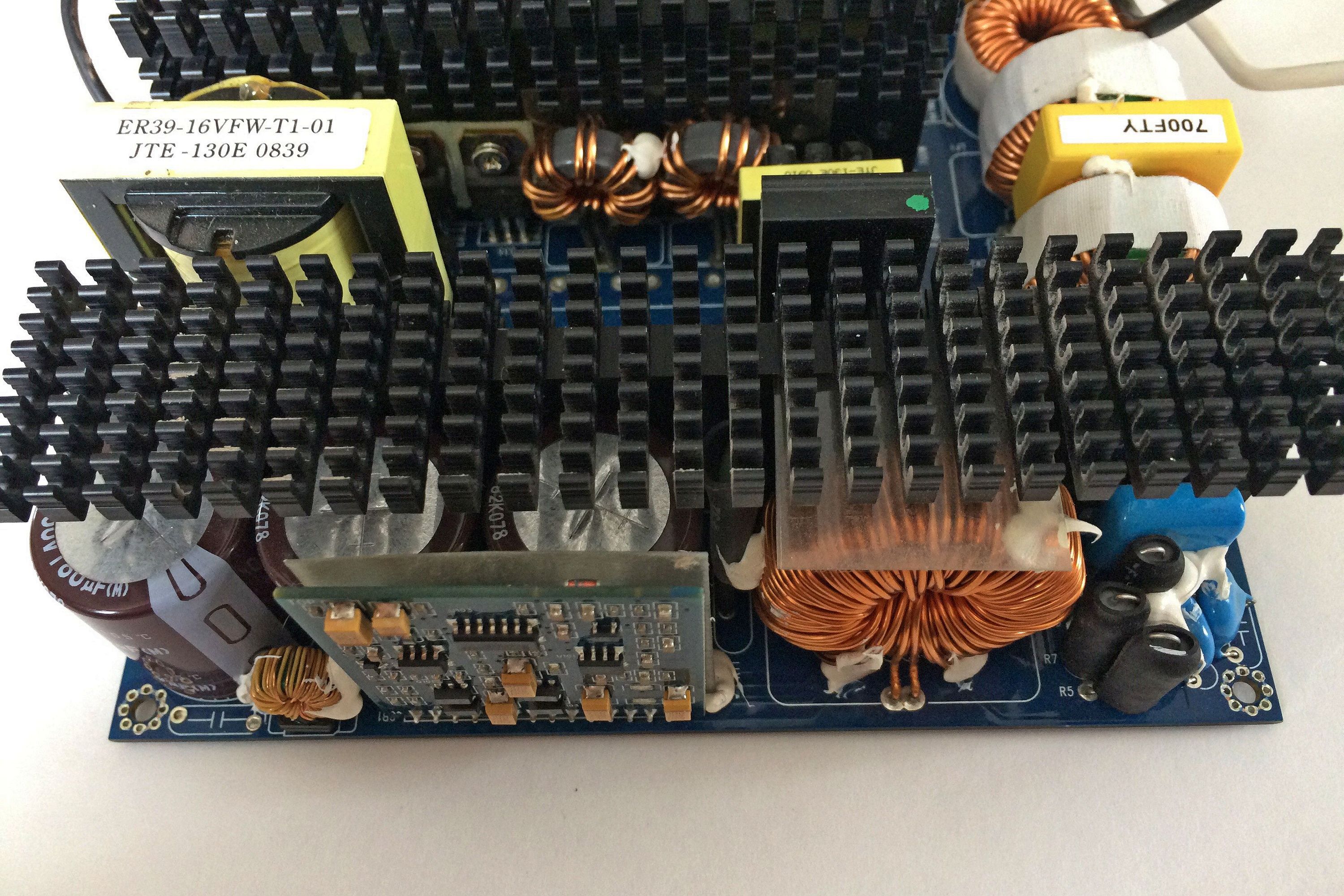

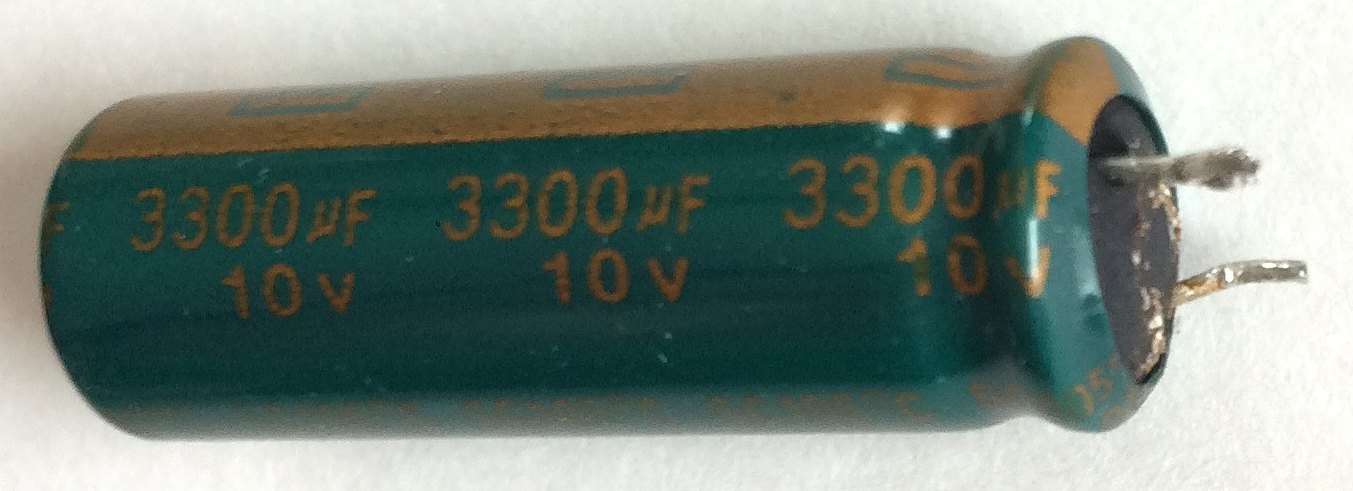

    Looking to re-cap the above flaky PSU. I pulled the caps that were visibly bulged and disgustingly, they're Teapos (SC series). The damaged ones seem to be 3300uf/10V . Looking around at Digikey, I see that Panasonic have some 3300uf ones but they're all 12.5mm in diameter; the Teapos were 10mm. Doubt I'll have the room to get anything bigger in there. The largest 10mm caps that Panasonic has are 2700uf (FS Series).
    Another fly in the ointment, I pulled 5 caps (all from the same location) that appeared physically identical without realizing one was a 2200uf/16V. Now I'm not sure which position on the board it sat in. How big of an issue is that?

    Re: OCZ Fatality 700w PSU Repair Help
    Member Behemot here has caps of the right type afaik.
    As for the 16v cap that is easy: just measure to the 12v leads from where the caps are.
    The 16v cap will have a low ohm path to 12v output...
      Thanks Per Hansson, I tested the resistance between the cap locations to the 12V rails and I'm not seeing low ohm readings; all 5 measure roughly the same (4 measured 105 Ohms and one was 110 Ohms). To compare, I measured from one of the adjacent 25V caps and it measured 0.11 Ohms. Maybe I just don't know what I'm looking for.

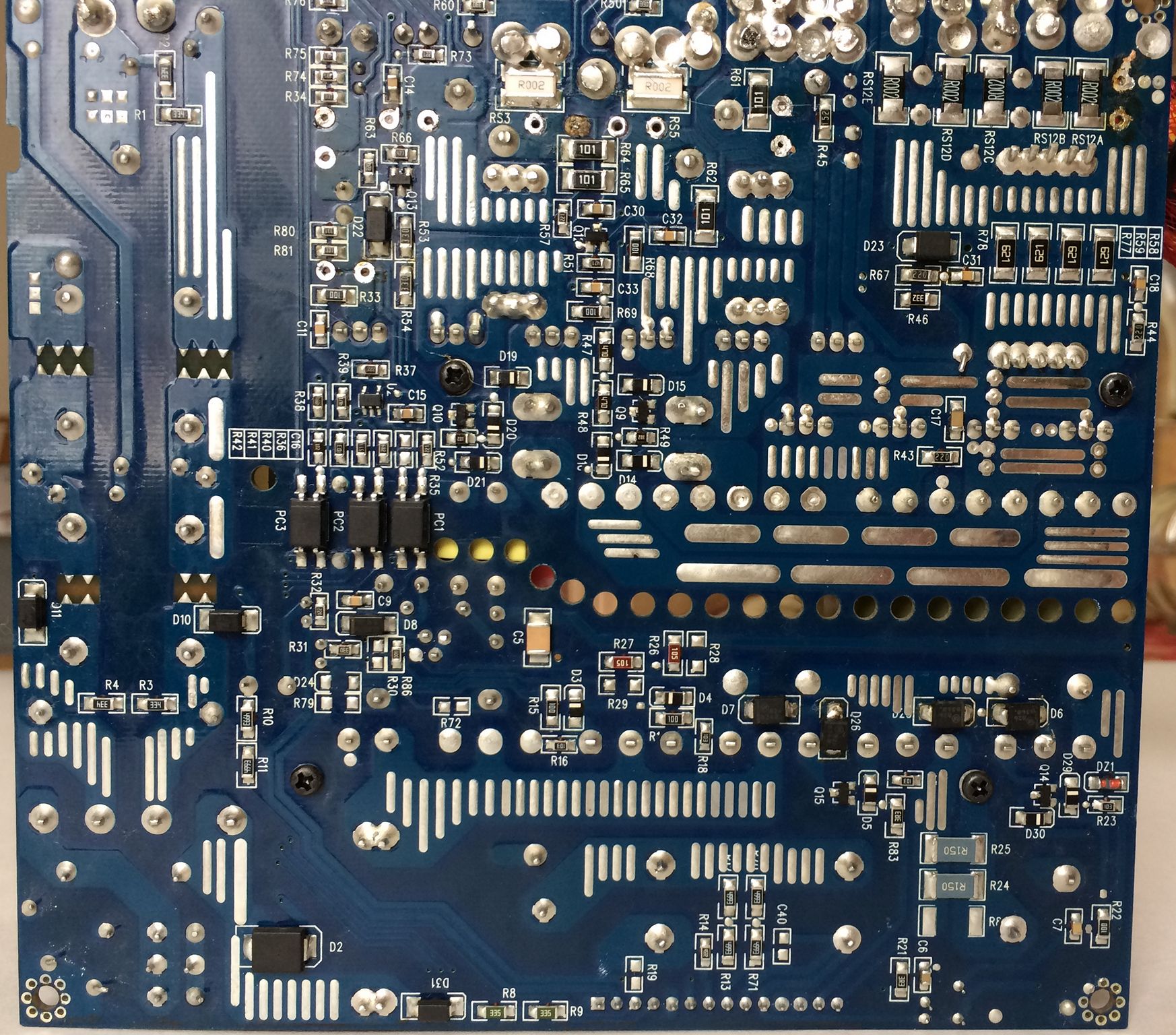

          Originally posted by momaka
          That said, still make sure to double and tripple check that none of the caps you removed have their (+) leads connected to the 12V rail.
          I'm fairly new at all this but I did a continuity check between the positive hole of each capacitor location to the 12V rail and got no response. Is that what I was supposed to do?
          Also check if that 16V cap wasn't for the -12V rail - if it is, its positive (+) lead will be connected to ground (i.e. low resistance to ground on + side.)
          Did a continuity check to GND from the positive legs for all the locations and again, got nothing.
          Pain in the ass that I misplaced the sheet of paper that I had recorded the locations but I was able to figure out 4 of the 6 caps by matching up the white silicone adhesive still attached to the sides of the caps and the components they were glued to inside the PSU. The result is I'm left with one location that has continuity to a lead labelled 5VS+ and the other one connected to a lead labelled 5VSB. Interestingly, this latter spot has a neighbor that is also connected to this lead and houses a 16V 1000uf cap. Could that be a hint as to where the 2200uf 16V cap belongs?
            Yes.
            Furthermore, you can also check continuity (or preferably the resistance, actually) between each positive hole and each PSU rail. So as an example, if you're trying to figure out, say capacitor C12345, you check resistance to 12V rail, then to 5V rail, then to 3.3V rail, then 5VSB, and then -12V rail. Whichever one of these readings shows a resistance of 1 Ohm or less (i.e. same as when you have multimeter probes shorted together in resistance mode on lowest resistance scale), that's likely the rail to which the cap is connected to.
            Which leads me to this:
            There you go, you figured this out for yourself. This is exactly what I meant with the above example.
            That means one cap is for the 5VSB rail. As for the cap connected to 5VS+.... not sure if that's part of the 5V rail, or some internal IC/chip supply rail. But if it's for small cap (i.e. less than 470 uF), it's probably an internal rail of some sort.

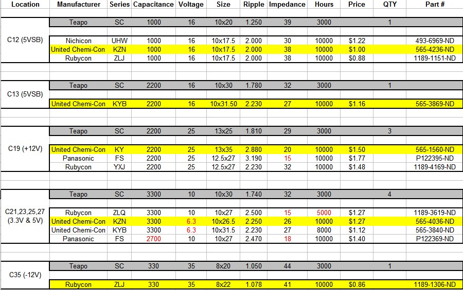

                In my last post, I indicated that ESR and ripple have me stumped but I guess you can add impedance to that list as well. So for example, if I want to replace a Teapo SC cap with the following specs:
                - 2200uf 25V (1.810A ripple @ 100KHz, 29 mOhms impedance)
                Looking at DigiKey and grabbing a few samples, I found one somewhat close:
                Rubycon YXJ: 2.23A @ 100kHz, 32 mOhms
                Then a bunch more with specs similar to these that seem way off:
                Panasonic FR: 3.63A @ 100kHz, 13 mOhms
                Nichicon UHW: 3.2A @ 100kHz, 15 mOhms

                  Okay, so capacitance and voltage I get but ESR and ripple current, I'm way out of my league.
                  Don't worry, it's still pretty simple. You just need to find the datasheet of the original capacitors (looking for "Teapo SC" should produce some results on just about any sane search engine) and then compare to the datasheet of the new caps.
                  The way to do it:
                  - ESR of new capacitors should be the same or lower value than the original capacitors. In general, typically anywhere from 25% higher to 150% lower ESR should be OK. In some circuits, even 200-300% lower will be OK... but try to avoid that, if possible, unless you really have no other choice (after all, even a cap with "inappropriate" specs will usually be better than a failed cap that is completely out of spec.)
                  - RC (ripple current) of new capacitors should be the same or higher than the originals. Again, this figure can go from 20% lower than the original value to any value that is higher than the originals (i.e. there is no upper limit on how high you go for RC.) RC simply indicates how much "AC stress" the cap can handle before it starts to overheat internally. So the higher the RC, the less the cap will heat up internally when performing in the circuit.
                  There you go, you got this!
                  That Rubycon YXJ cap is a very close match for the Teapo SC, despite its ESR (impedance) being rated slightly higher at 32 mOhms. (remember, ESR should be the same or lower, if possible... though in this case, it's within 20% of the original, so this cap will work just fine.)

                    Thanks again momaka; learnin' lots. From the bit of prior searching I did, I had an inkling that ESR being too low could be a possibility but the PDFs that hinted at that were way over my head and I had no idea that impedance was a good metric to use.
                    As for ripple current, nothing I found really explained that the value in the spec sheet is the maximum spec'd for the cap so you cleared that up. Makes sense now.
                    So based on my newly minted knowledge, I spent way too much time (actually I kinda enjoy perusing specs) on DigiKey and this is what I've come up with so far: (pic attached, yellow are my prelim picks). I did manage to find one 3300uf 10V cap but it's impedance is a bit low at 15 mOhm.
