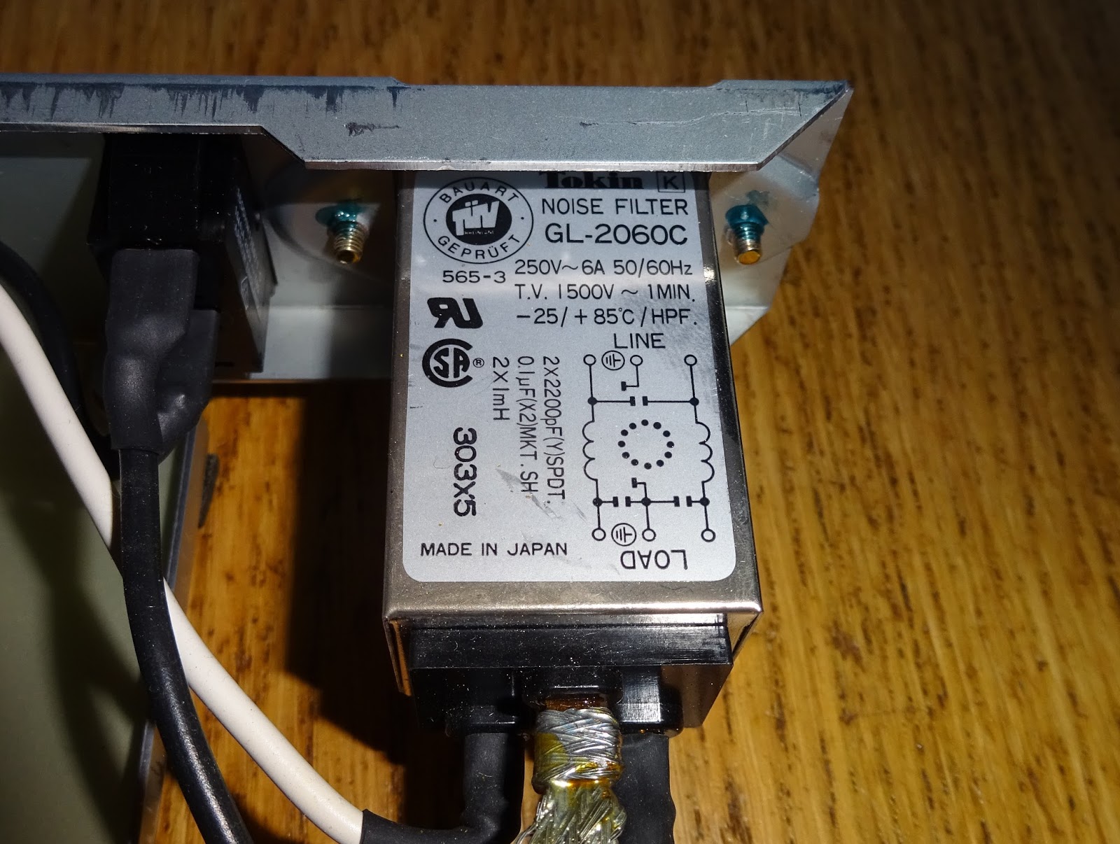

    I need a bit of help. I'd like to replace a power socket with built-in filtering caps. I've been told that I could go without it because there are filters in the PSU itself but not sure I want to go there. What do you guys think?
    Anyway, the original was the same spec as the attached pic. Locally I can get this YB06T1 (see attachment). Would this be a good match?

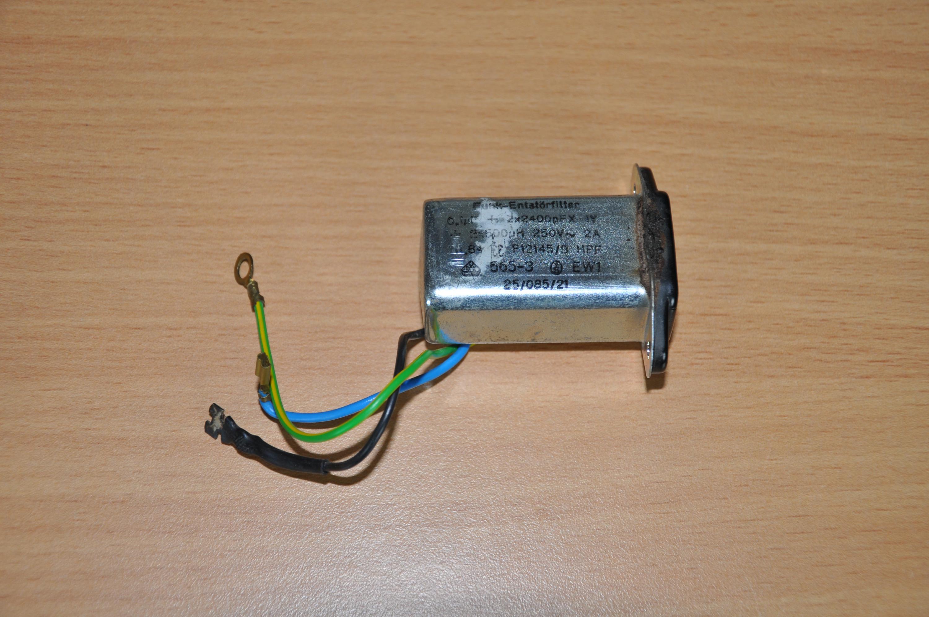

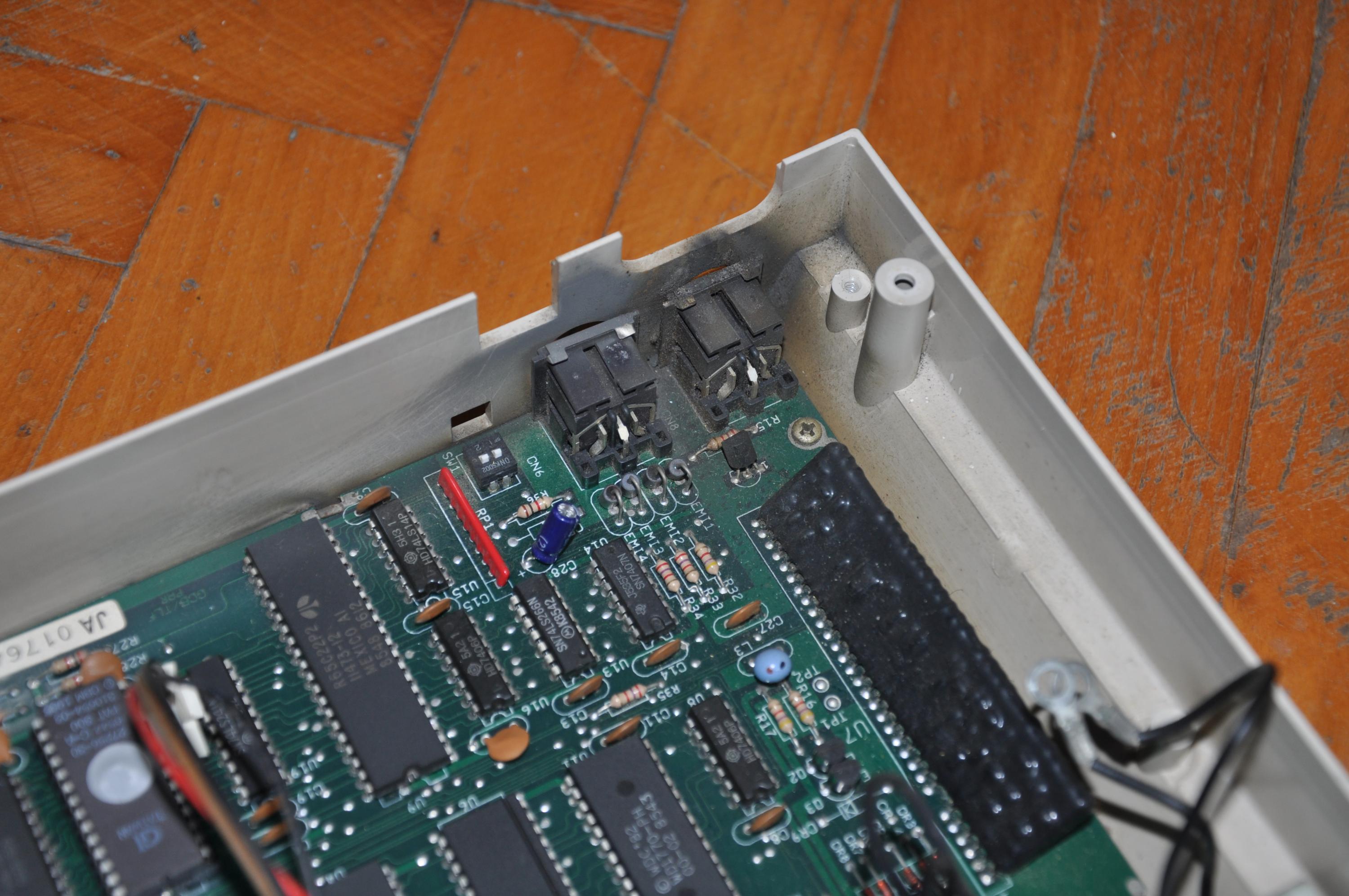

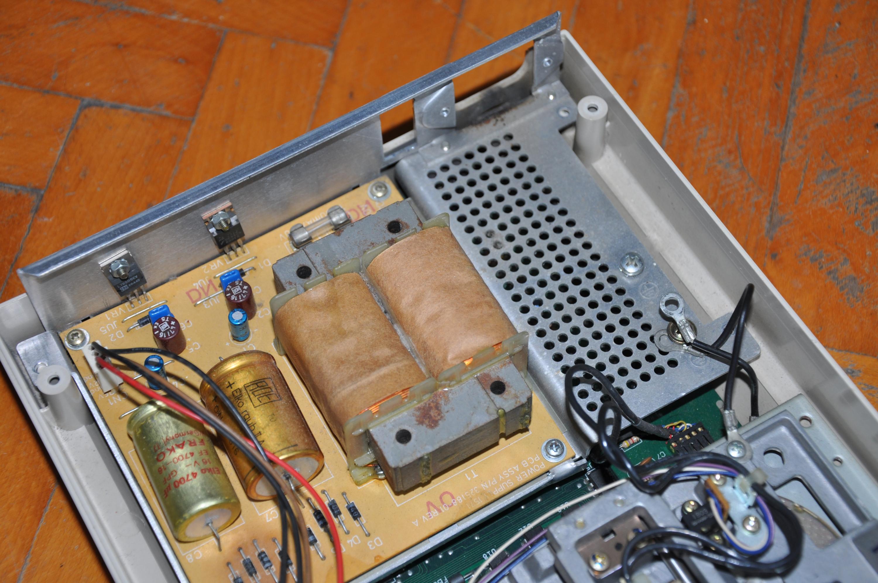

              Lots of stinky grey smoke. It went off immediately after I plugged in the power cable. Main fuse is okay. The socket blew on the underside causing the DIN serial connector and the plastic around it to go black. By looking at the text on the socket I see it's actually different than the one in the first post.
              See photos in attachment.
              Could I go without the filtering caps in the socket?
                • 30983
                Re: IEC socket w/ caps replacement
                it's not just the caps, it's the 500uH choke.

                        well your original is:
                        2a
                        500uH filter
                        .1uf + (2x) 2400pf caps.
                        so this is close:
                        http://uk.farnell.com/corcom-te-conn...vac/dp/2474396
