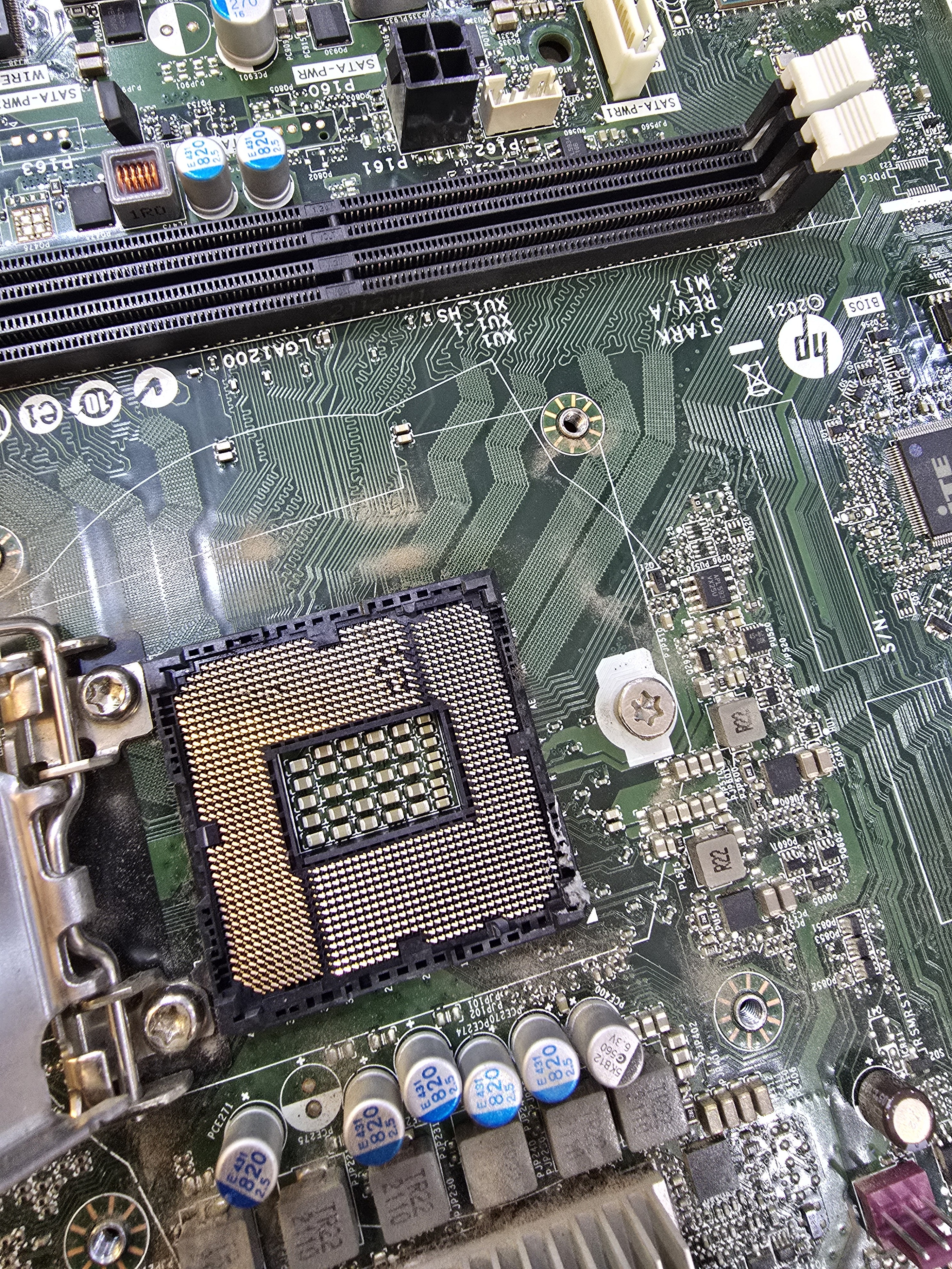

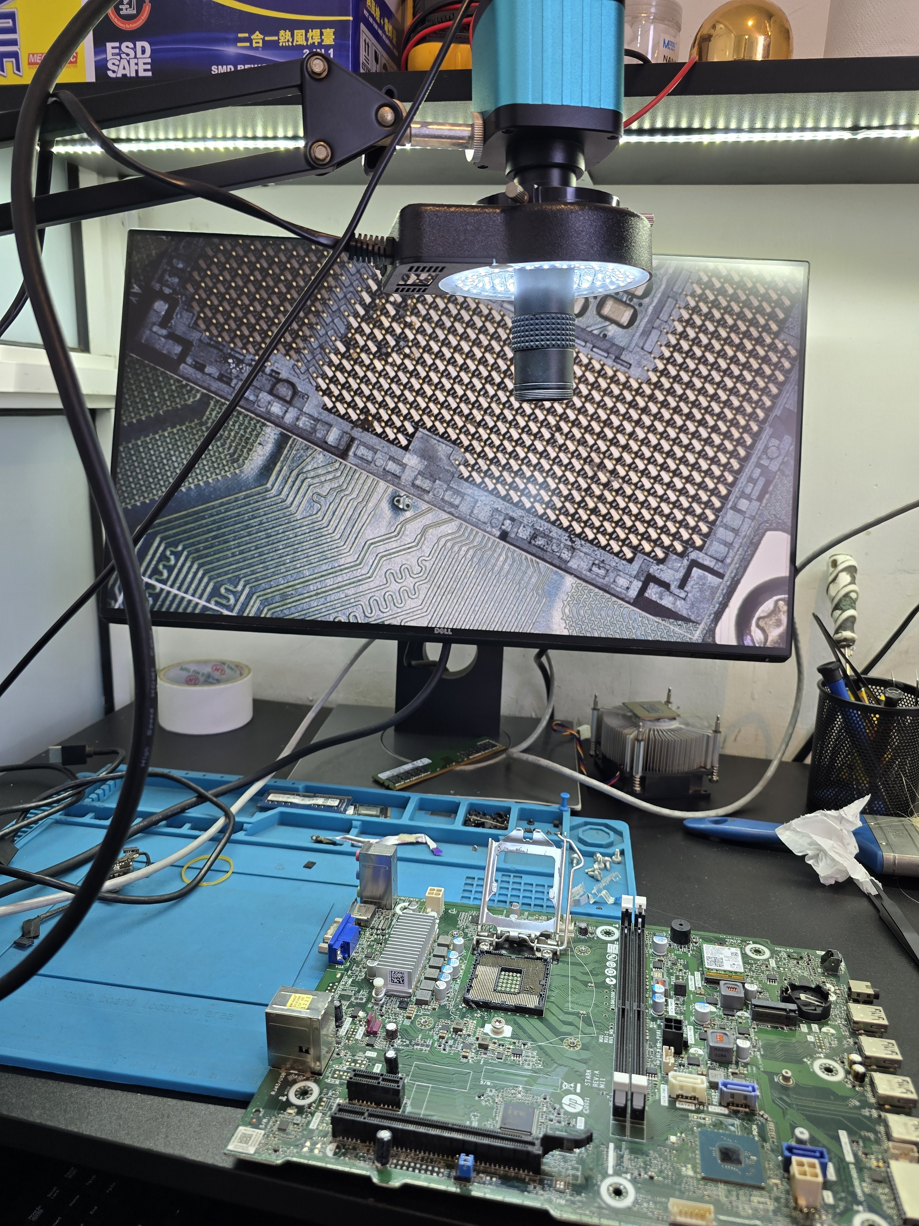

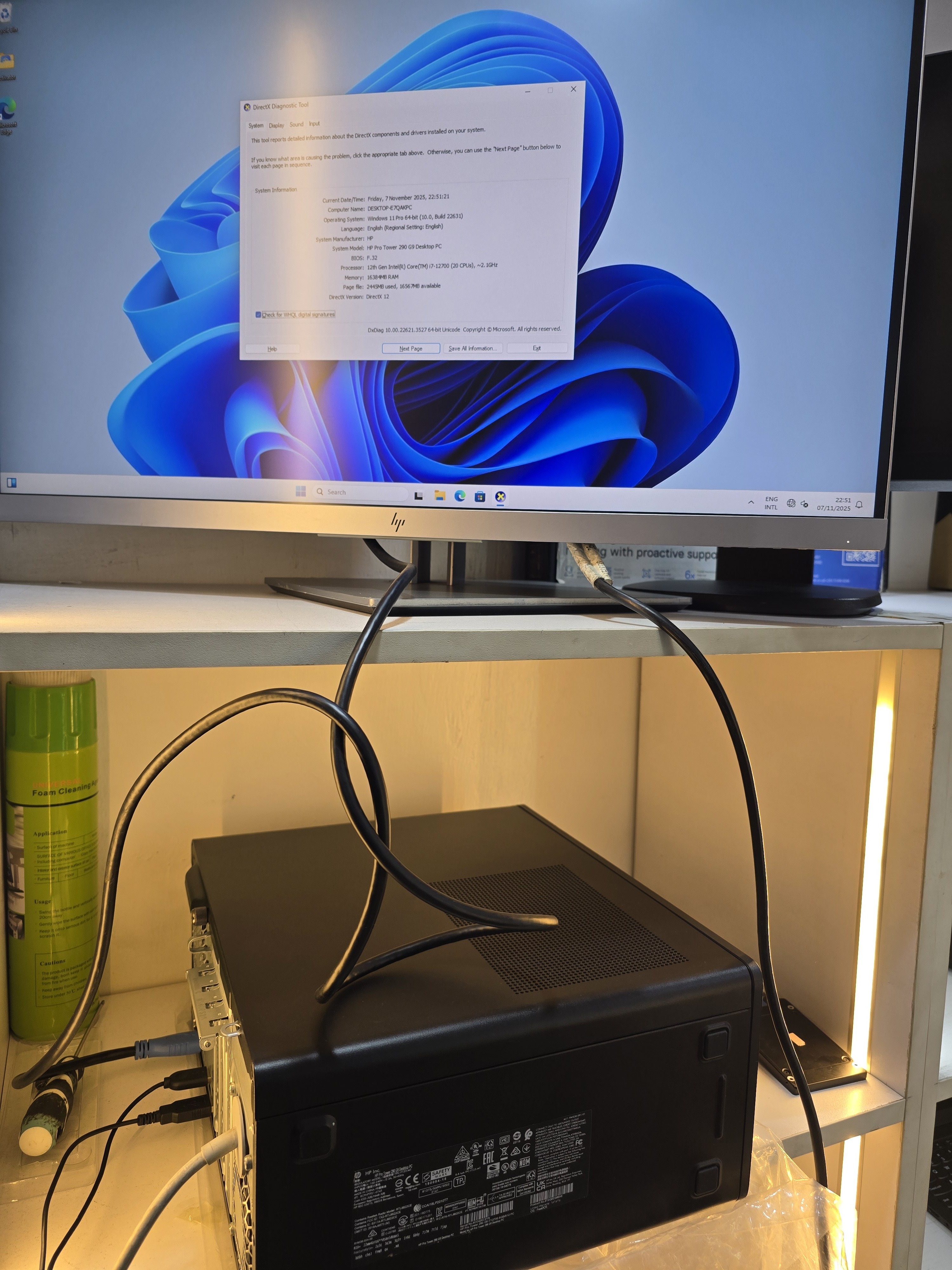

                      Cheap 4K camera from AliExpress saves the Day!
                      Success fixing with badly damages cpu socket pins for HP Pavilion Gaming Desktop.
                      This came in from a fellow repair shop, board would turn on but no display. On disassembly we discovered cpu socket pins were messed up, don't know it's history but it was obvious this was the issue. I have fixed such sockets before but this had more than 10pins extremely damaged and was not sure I could pull it off without breaking some&for sire broke like 3 at pin ends.
                      But determination paid when I placed the i7-12700K back and voila display was back!
                      Went further to do a cpu burnin stress test&everything was stable as nothing had happened so probably still has a lot of life left.
                      Happy customer, happy me.
