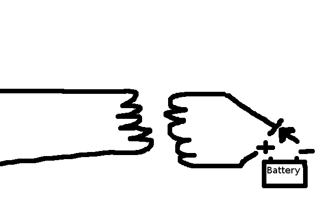

          Re: I'm not sure it gets more gutless than this
          Hello evilkitty,
          If we are going for vintage wouldn't original working order be better? as opposed to adding a pcb with a few components in it?
          to my understanding it just needs to ~$0.50 diode to be vintage
          now if wanted to upgrade this design i could slap a few caps in this thing and rewire it, but then it would not be original in its design, all of the components are on the ground side of the circuit
          You have to remember that when people restore vintage radios and other appliances, its extremely rare that they can get original parts again. Therefore they have to use modern components to do their repairs.
          Some actually hide the modern component inside the original by hollowing it out. Paper capacitors were a favorite. But inevitably they have to replace some parts that stick out like dogs balls in regards to being modern.
          You are correct though, the restoration of your charger would suffice with a diode inserted and no caps or other components.
          Though, with the switch, you should be able to get one that is very similar to the original. You could also try spraying the switch with CRC 2-26 in hopes that it will be able to slide and actually make a proper contact with the 6 volt side of it.
              Would the anode (+) or the cathode (-) of the diode go to the battery ground terminal?
              having 2 power sources is messing with my head
                lets use my mspait skills... ok i used gimp cause i don't run windows, but...
                That would be right for charging a battery right, cause we do not want the battery to discharge
                i checked the voltage and got 25vdc but it shows 12v AC
                is this correct?
                  if you mean the diode's anode connects to the negative battery terminal, yeah that looks right. Should always test in DC mode, and ensure that you get a negative voltage when you reverse connections. The ripple from the halfwave rectifier will happily read weird voltages for non-true RMS voltmeters...
