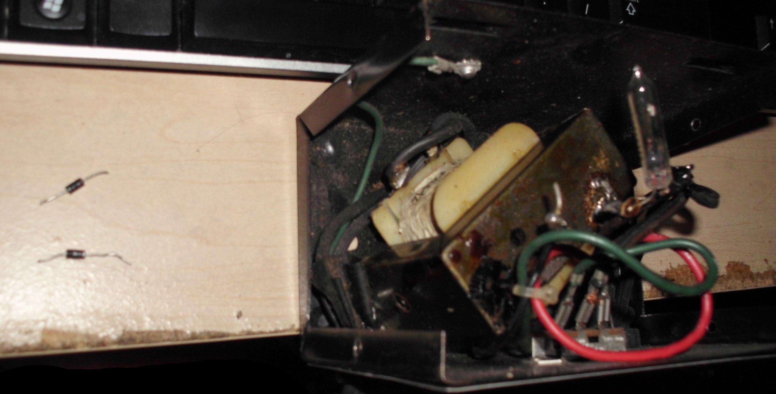

    I'm not sure it gets more gutless than this
    When my dad asked me to 'fix' his battery maintainer he knew they were fix able cause someone 'fixed' his old one a long time ago, well here i am holding this 'old' one, it belongs in a museum, i assume what few parts are quality ones cause this was from the days when people used quality stuff, i guess quality and design are very different things
    This think has absolutely no regulation
    I found 2 diodes in the bottom of the box just laying there
    This thing appears to have 3 components
    1 diode (assuming 1 is the old one, or the guy just dropped one and did not bother to remove it)
    1 light bulb thingy, looks to be a thermal disconnect to prevent a burning out the transformer
    1 transformer (rated at 3 amp)
    the diode has this on it
    1N
    4001
    I R
    forward voltage is 0.5v

      Typical of its time. Transformer, diodes, and thermal breaker. Nicer ones had an ammeter too.
      Usually, you'd put in bigger diodes, like 1N5401s or 6A10s (3A & 6A respectively), and non-crumbly AC and battery cables. Possibly battery clamps too.
      A common trouble point is that voltage selector switch. Just permanently wire it for 12V out.

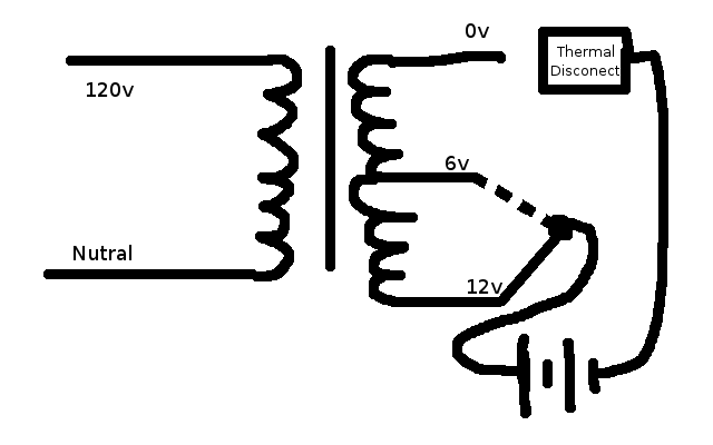

          by drawing skill are lousy but this is how the circuit looks to me
          i am assuming a diode goes between the disconnect and 0v
          i am assuming the one that was there melted the solder and fell out or the soldering was crappy

            Where is your diode or diodes in this drawing ( or a bridge rectifier )
            This is a not a requirement but it might work more efficiently if you put a 47000uf @35 volt cap in it with a bridge rectifier
            Then you would have a one amp power supply that is filtered so use as a batteries charger or a power supply you could also put a switch on the cap if you did not want it filtering the power supply all the time

                        Why do you have D2 in the circuit for? It is half-wave so only one diode is needed.
                        BYW, the output will not be 12V due to the cap will be charged up to the peak of the AC Voltage, it will be higher than 12V.

                          AC output looks to be 13.8v
                          but there are 2 diodes in the circuit so the total Fv would be about 2v
                          we would have 11.8v after that v drop

                            What are the AC Voltage between 0V pin of the transformer and the 6V pin of the transformer, same for the OV pin and the 12V pin of the transformer?
                            Did you actually fins out how the two diodes are connected in the circuit?
                            Do not forget the Voltage you are reading is not pure DC due to no filter cap in the circuit. You meter is trying to measure pulsing DC.
                            Look up rectifier circuit to know what the output wave form will look like without filter cap and how to calculate what the DC Voltage will be.

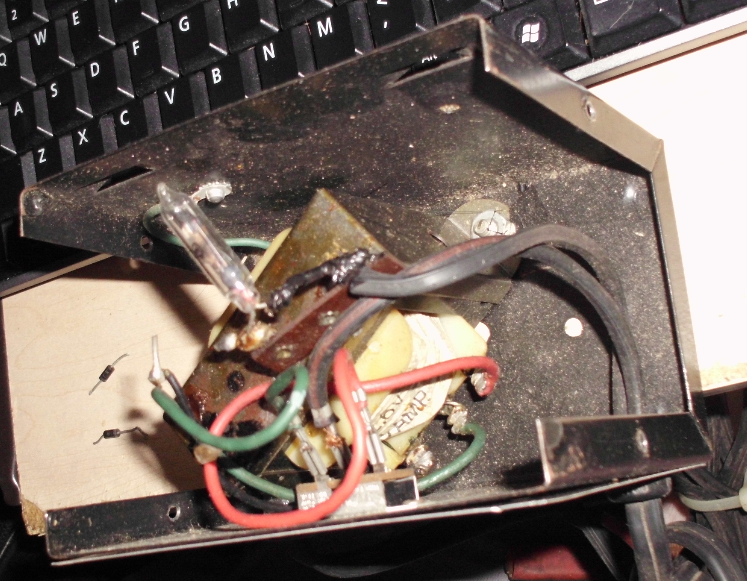

                                definitely not a mercury tube, it looks similar to a blinking bulb in a Christmas tree light string, just looks less cheap
                                it looks to have a spot welded or soldered joint to the top of the transformer
                                this is a metal brace to a non-conductive material that was made to hold 2 components, looks to have been used to hold wires to they do not move and break the disconnect

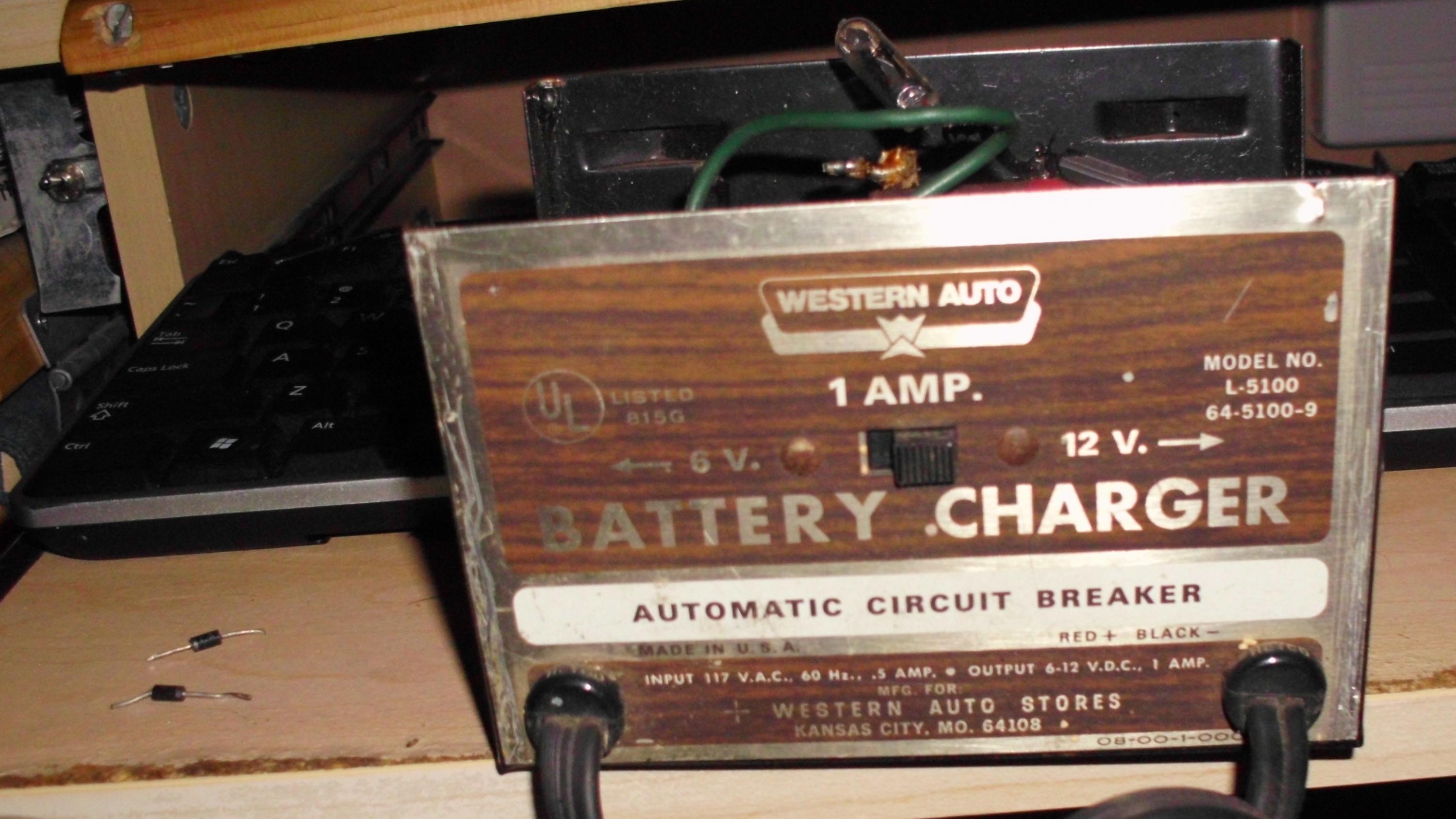

                                      i have the exact unit on my bench.
                                      i use it for long term eq/desulphating.
                                      its not a maintainer.it can hit 16v at light load.
                                      iirc mine has selenium rectifiers.

                                        it looks like 2 of the units he gave we were chargers, one has a bad switch, rewired it to only be 12v
