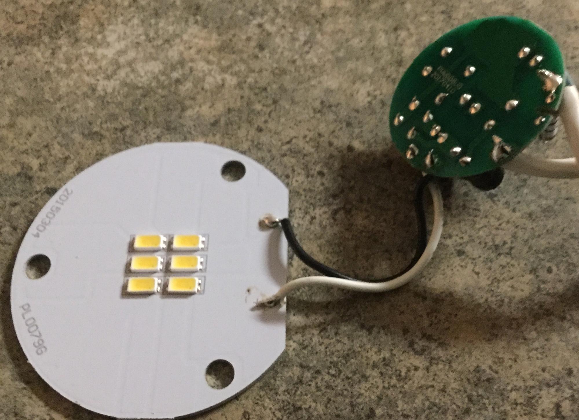

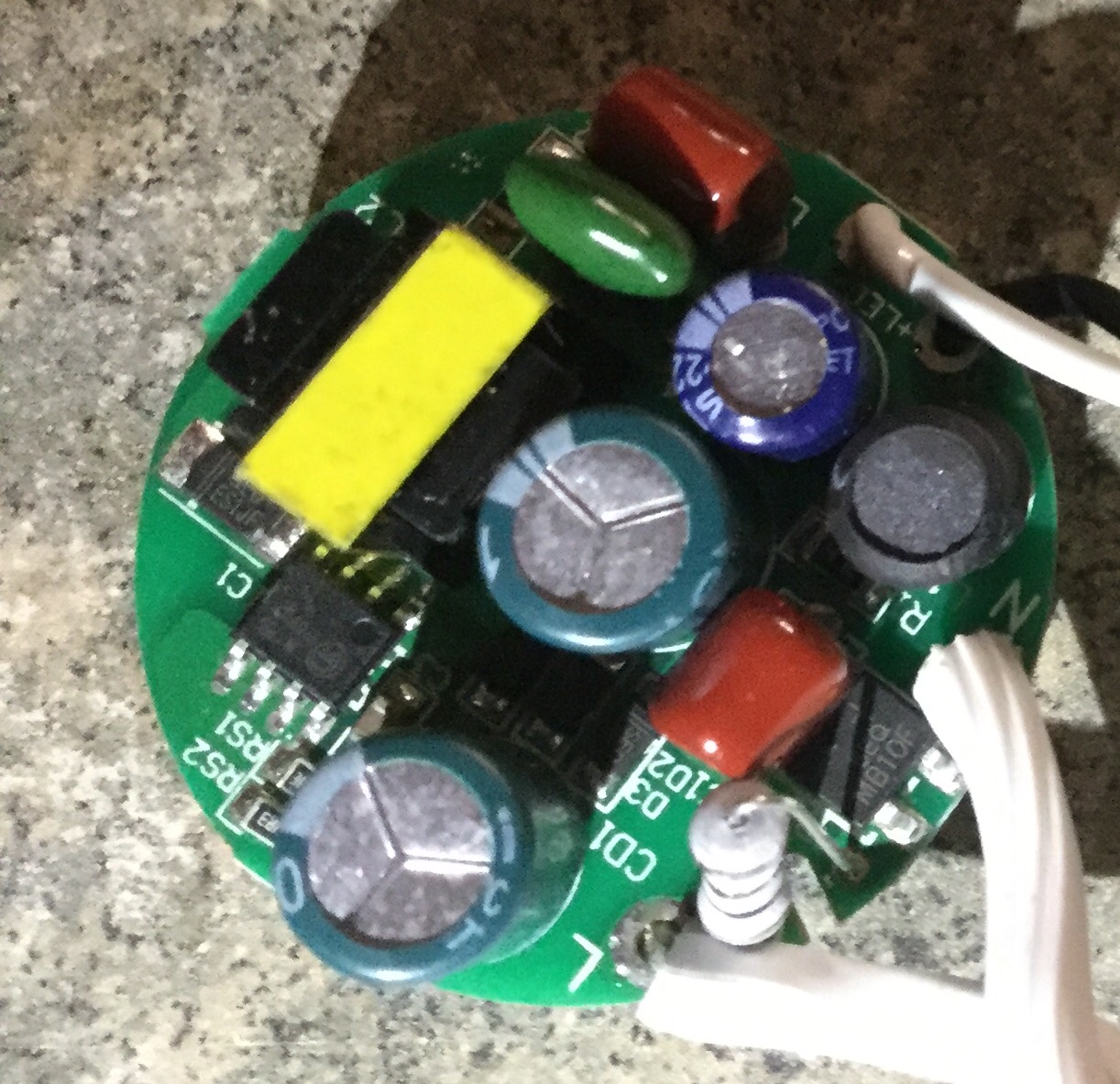

    I bought three of these little lights
    I would like to know what you think of this power supply board

    I am going to hack two so they can run on battery power supply
    Or at least that the plan for now

        Did you measure the Vf of the LED to see if they are 3V or 6V dual-LED?
        Since the LEDs are connected in series then it will be easy to find out what the total Vf of the LED string is.

          I'm surprised you got a transformer... thought that newer cheap non-dimmable LEDs have no transformer, just effectively has a series pass IC regulator like a LM317 in CC mode... ?
          It is tempting to get one to work with low voltage, but with the LEDs usually wired in series, rewiring the heatsink board for parallel sounds no fun...

            That's a non isolated buck converter, is it not?

              watch your fingers, some of those led boards run 70-90v or even higher.
              there are led's with 6 or more dies in series in them specially for mains lamps.

                The voltage is 17 v@50 mill amps I check it while the LEDs were ON then power them use an adjustable power supply set 17 volts it was showing 50 millimeters
                I going to get some voltage/current regulars from eBay very soon and set up the same reading or maybe a little bit lower than that

                I do not like the way that power board is set up for one thing I do not see a fuse on or I have not found one

                  It uses fusible resistor, the gray one right at the AC input feeding the bridge.
                  It does look like non-isolated buck converter, look up the IC next to the inductor.

                    Just get boost converter board that can convert 2V or 3V input to higher Voltage to the feed the current regulator to drive the LEDS.

                        I saw the resistor but do not like that I want a real fuse and a fast acting fuse at that

                          resistors can be faster.
