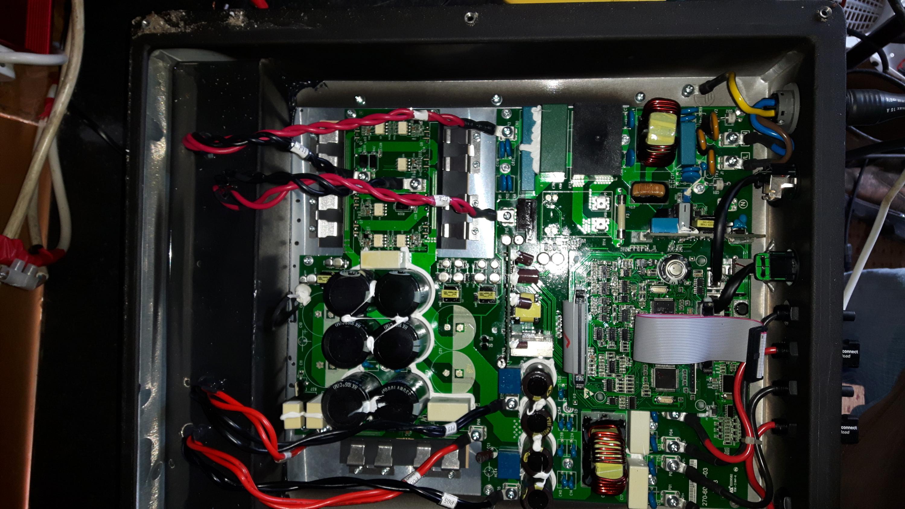

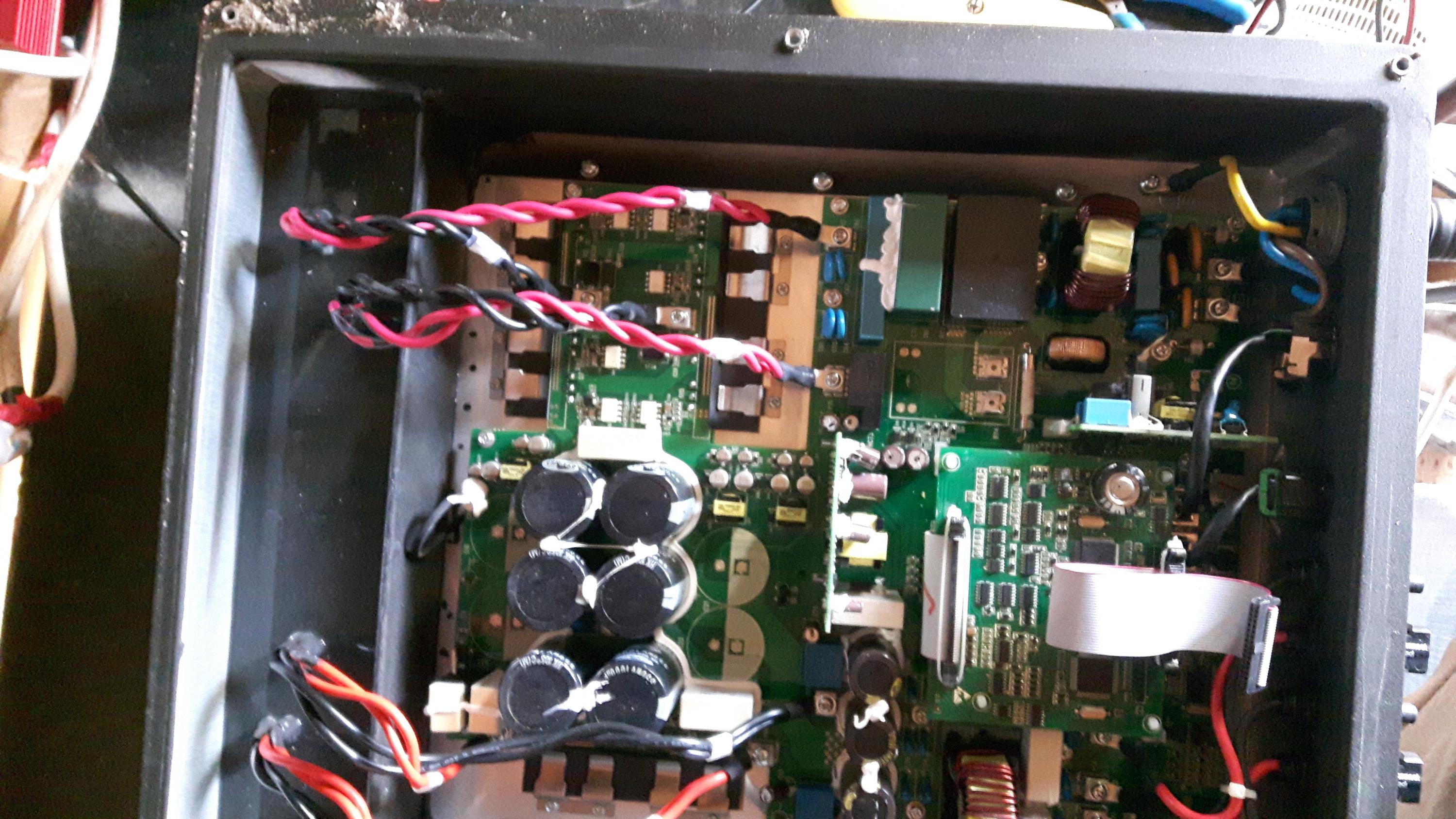

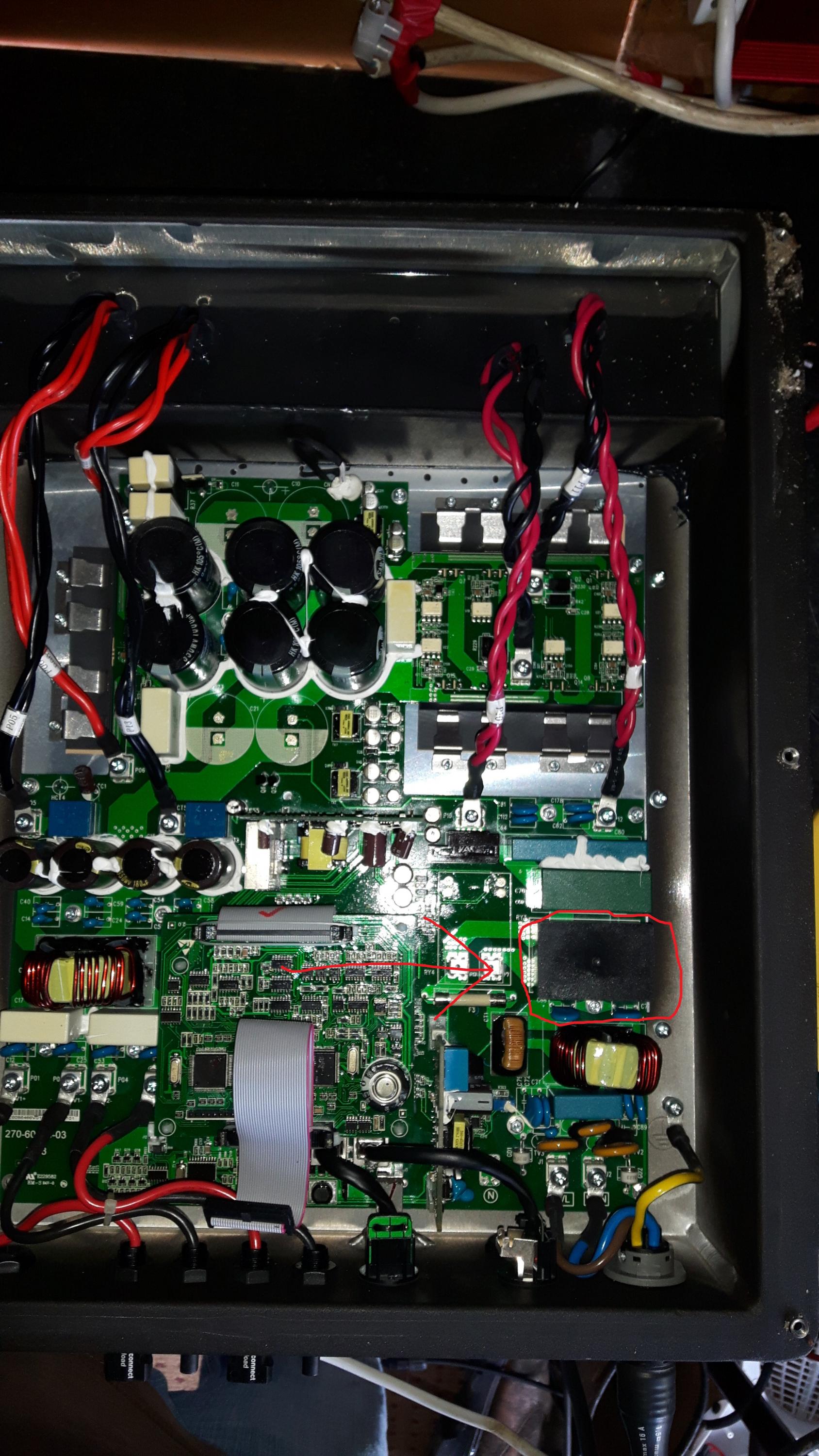

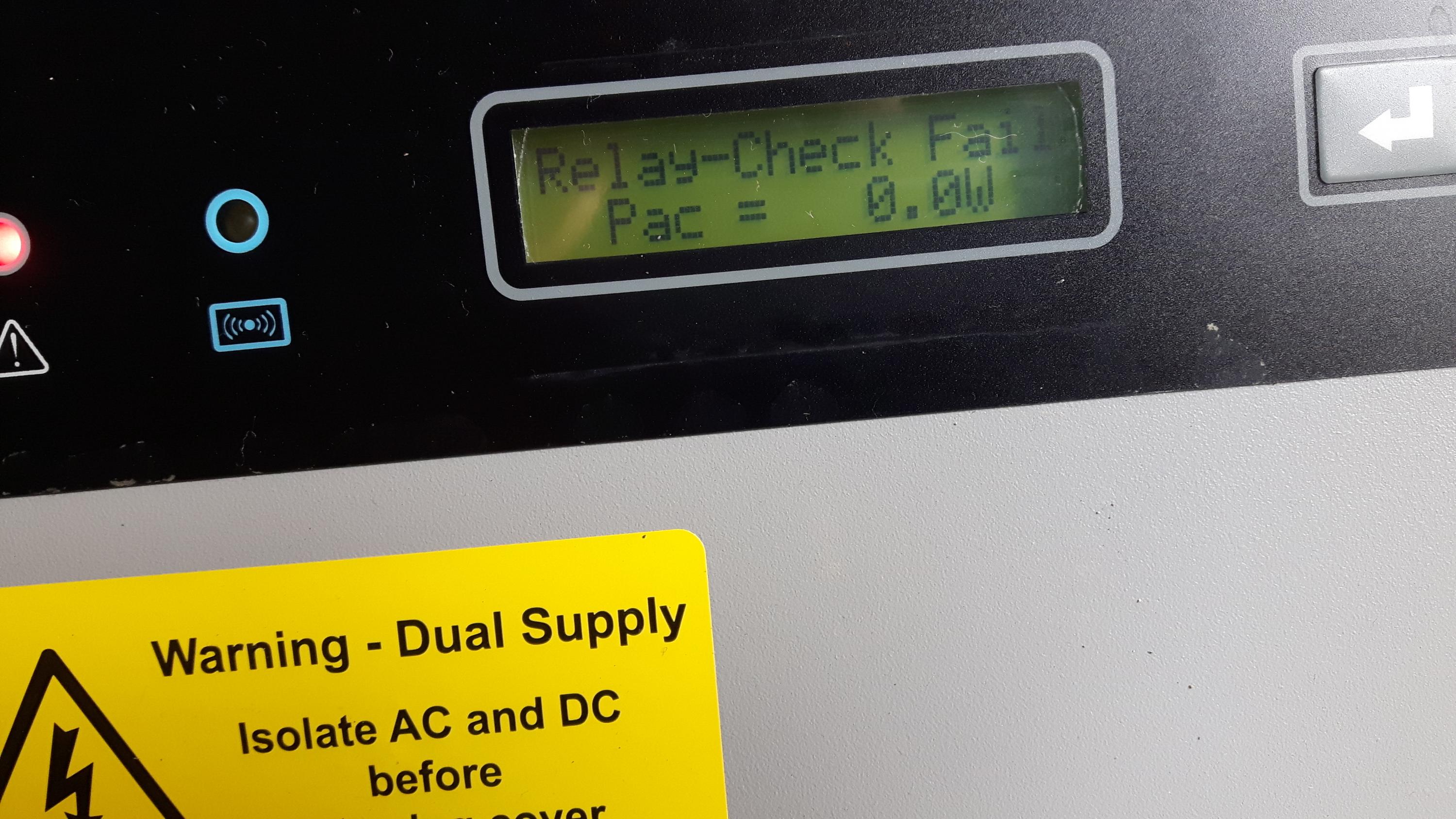

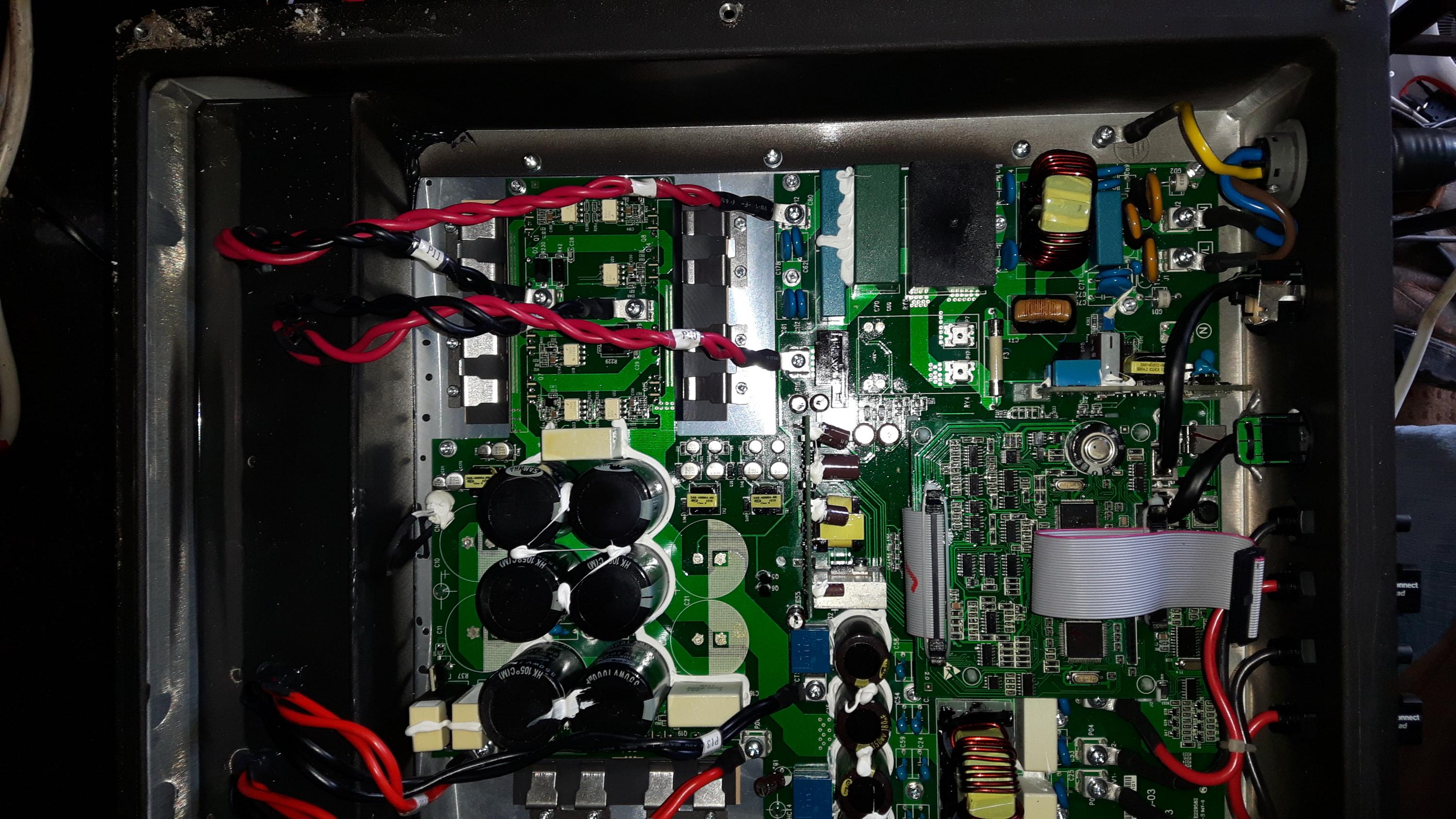

    I found this inverter in the skip and as I cant get my sma sunny boy working I decided to take it home. After opening it up to make sure it's safe to power up I plugged in the 240ac and 270dc and it started running self diagnostic, after 30 secs it displayed relay-check fail. Would this be as simple as sucking out a relay and replacing it with a new one.
    Got some pics if anyone got any idea's
    Thanks.

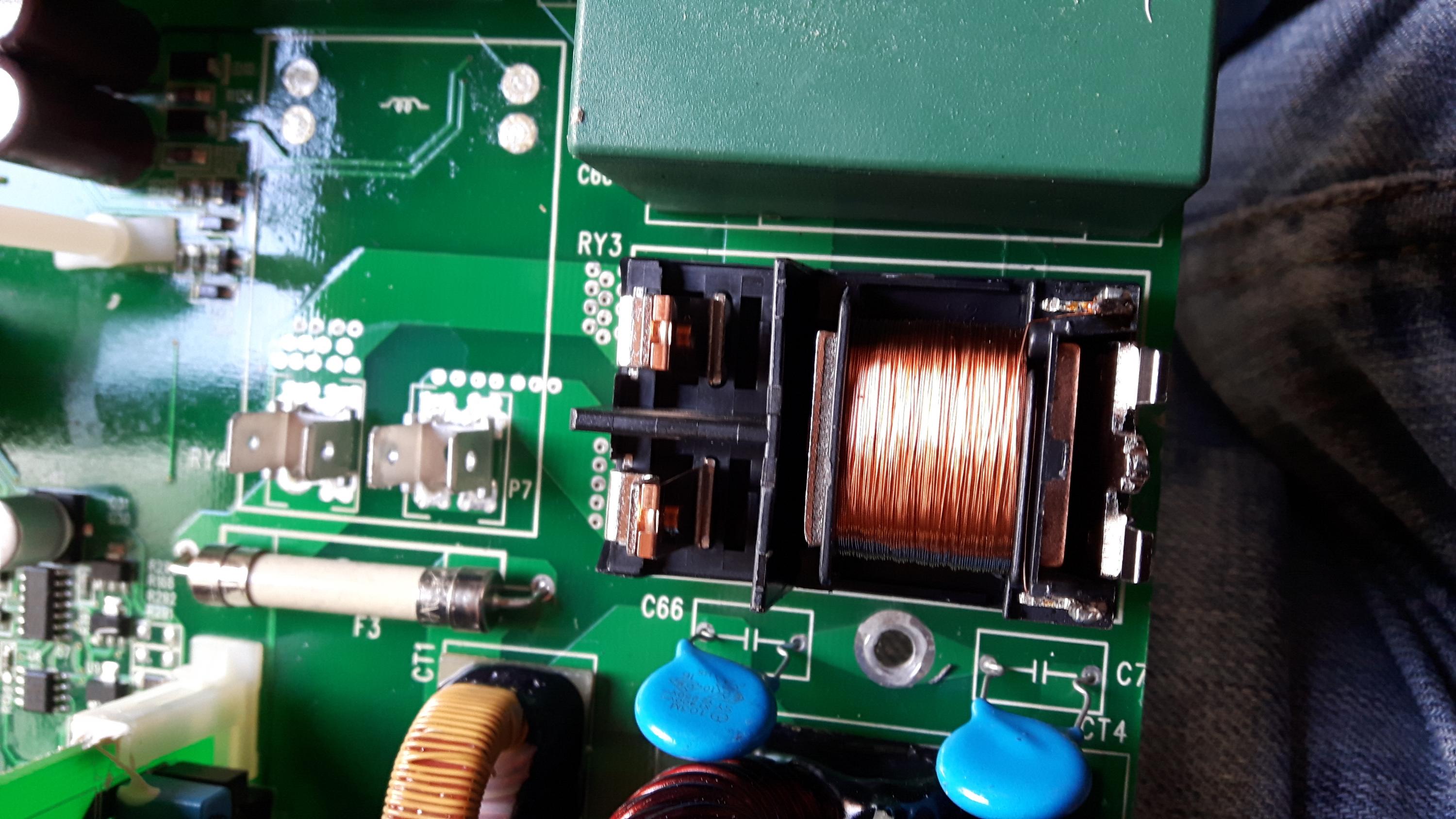

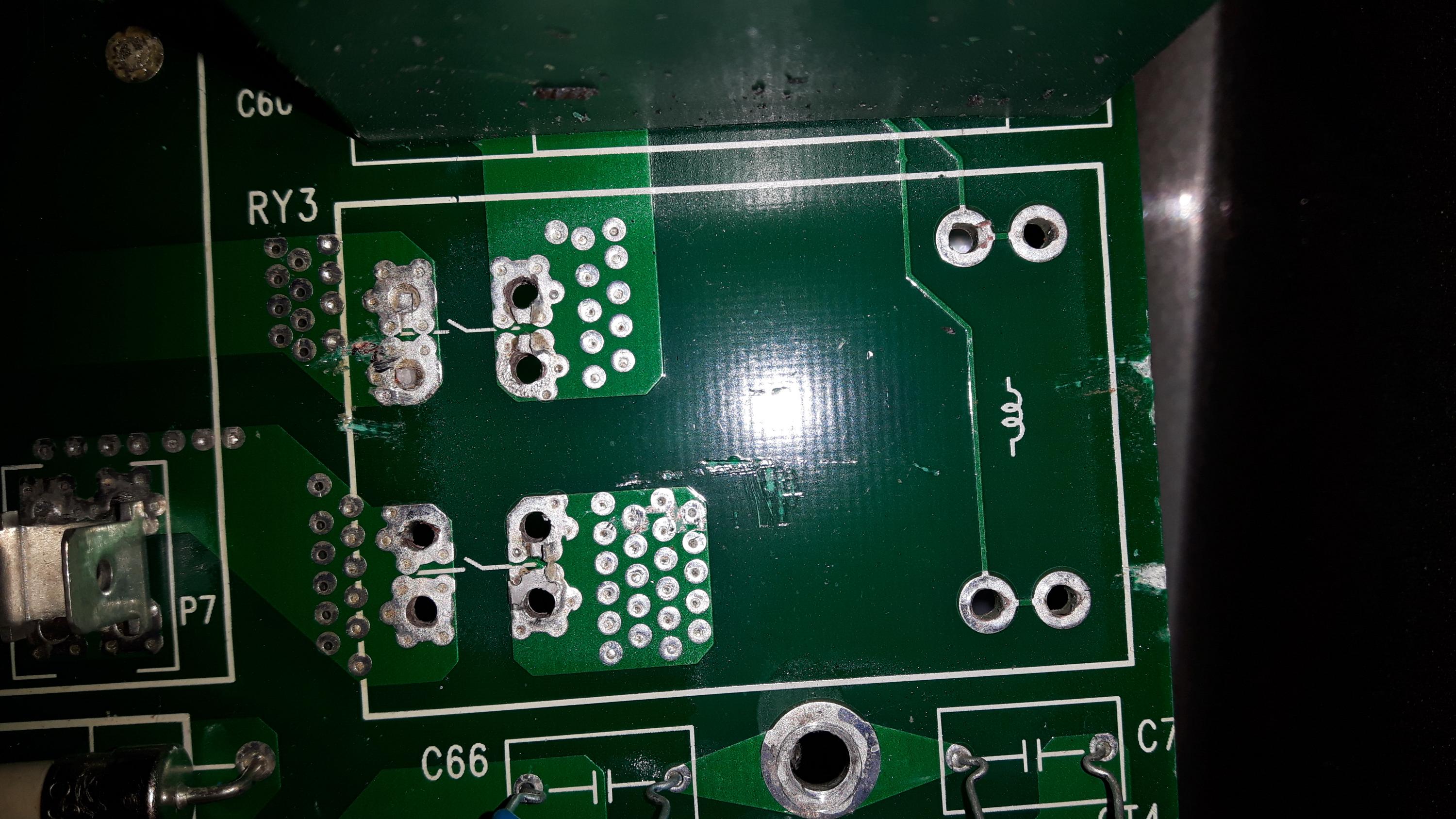

        is there a relay missing in that foto?
        • snipersquad100
          • Nov 2013
          • 297
          • uk
          Re: evershine TL3000-10 inverter problem
          I dont think so, just looks like its unpopulated.

            what is the relay for ?

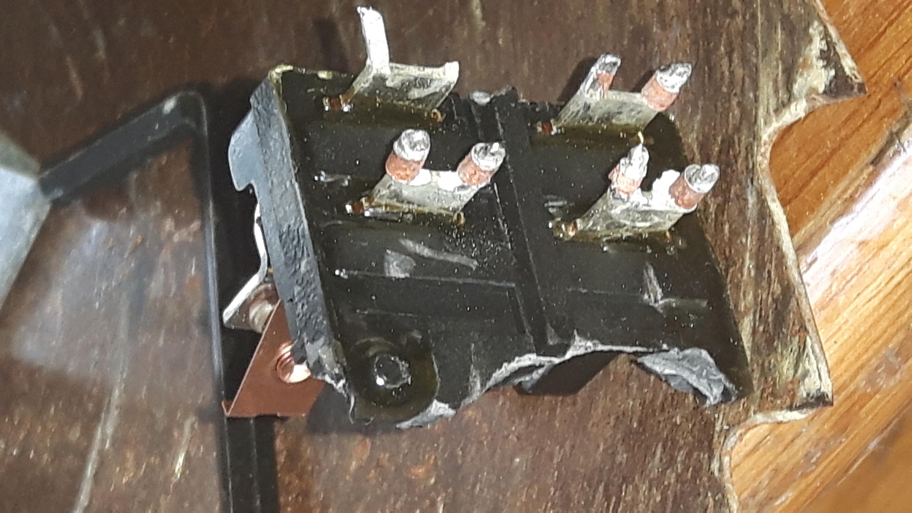

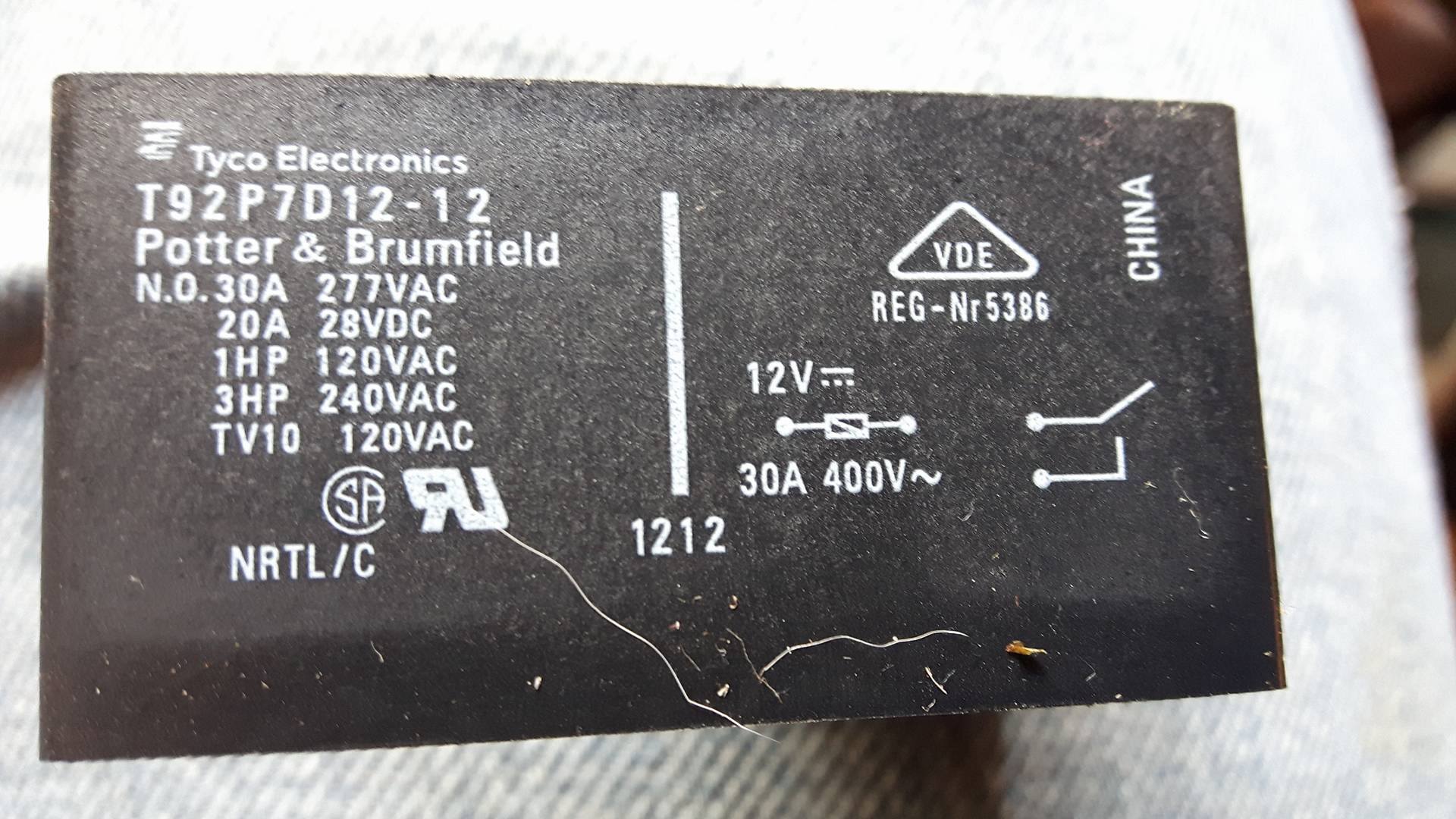

              I have found a fault with this Relay, even thou the coil was ticking when I give it 12v the mains side was not switching.
              This relay was a real pain in the butt to suck out, I lifted 2 pads up so ended up cutting it open and pulling the pins one by one.
              I cant find a replacement relay in the uk and digikey wants $12 and $10 postage so going to have to look for an alternative.
                So you applied 12VDC to the coil and the contacts moved but still not closing the contacts (0 Ohm reading between Common and N.O. pins of the relay)?
                • snipersquad100
                  • Nov 2013
                  • 297
                  • uk
                  There was OL on the ohms setting on the mains side with the coil energised or not.

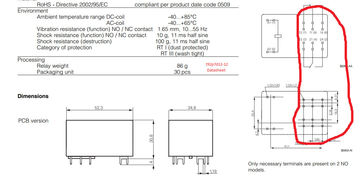

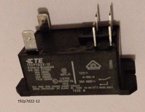

                          Found something a bit strange about the relay I pulled out of this unit. The package say it's a T92P7D12-12 which had 4 pins on the mains side. The Data sheet shows it to have 6 pins on the mains side. I found a relay T92P7D22-12 which is the same rating as the T92P7D12-12 but only has the 4 pins on the mains side which matches the one I took out of my unit. Could this relay I took out be a T92P7D22-12 with a T92P7D12-12 case on it???? Would they do that.
                          Also the T92P7D22-12 is less than half the price.
                            The one in your unit is DPST (Double Pole Single Throw) which has two Common (C) contacts and two Normally Open (N.O.) contacts and 2 pins for the coil and it use the case form factor for the DPDT (Double Pole Double Throw) version which has 2 Common (C) contacts, 2 Normally Closed (N.C.), 2 Normally Open (N.O.) contacts, and 2 pins for the coil.
                            So you just have to look at the P/N closely which will show what the contacts configuration will be.
                              Thamks budm, I'll order the T92P7D22-12, Whats the worst that can happen.
