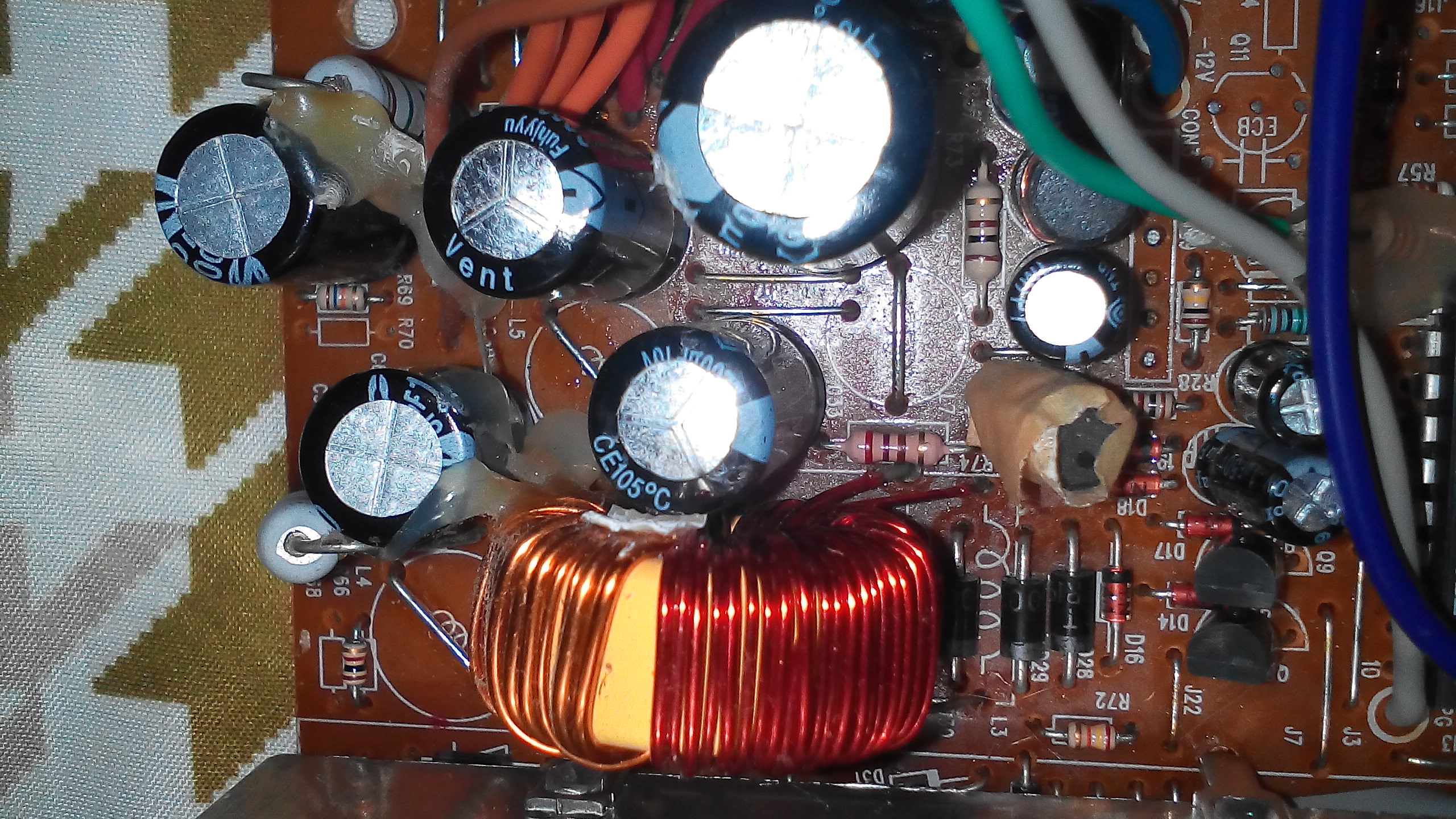

                Re: VStanby (V SB) question ?
                Photo of the PCB, I 've taken out the secondary rectifier...
                PCB serial code :
                LEC-011
                REV:1.2
                Any ideas for the schematic ?
                    Those two black caps near the top of the board, near the small transformer - are they Fuhjyyu? Either way, if the 5VSB is low, those would be my first suspects.
                      are you talking about these caps ?

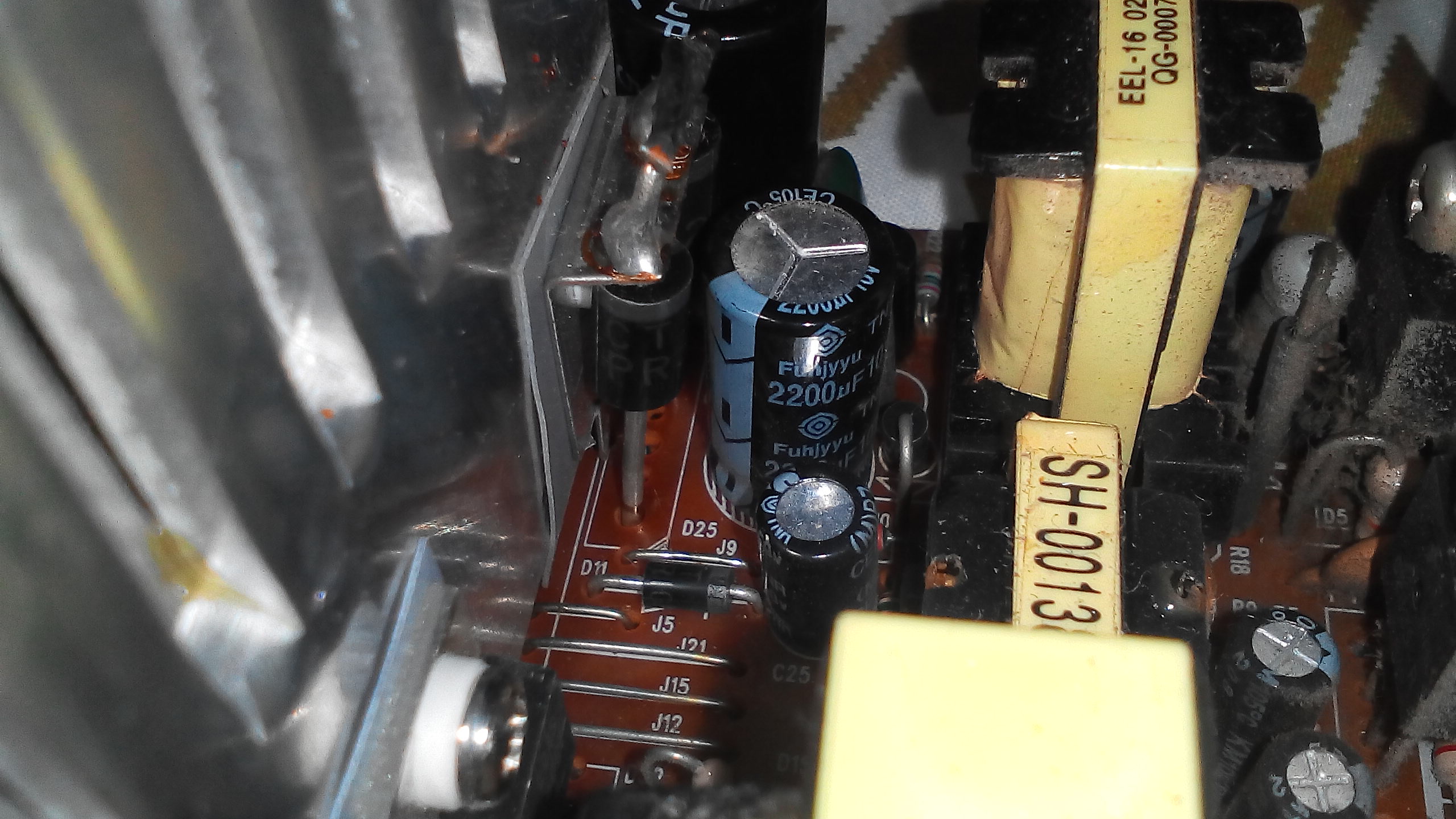

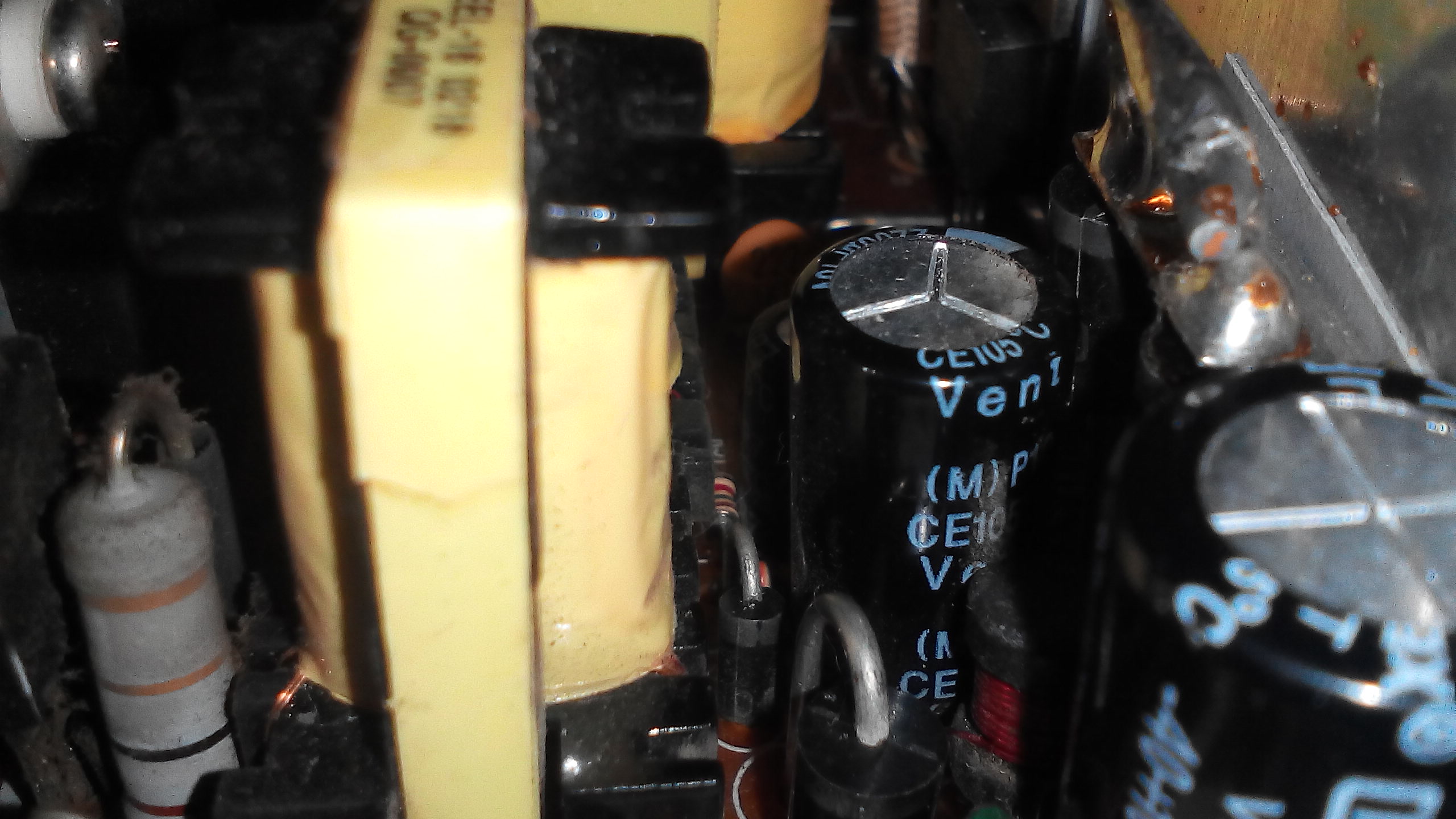

                        Let me take close up picture so you can see what exactly it is...
                        • bianchi77
                          • Jun 2016
                          • 1121
                          Capacitor photos
                            You have already found two bad caps with bulging top, you might as well replace the whole set of the caps since bad caps may not show any sign of bulging on top, otherwise you need to check the Capacitance and the ESR of the caps.
