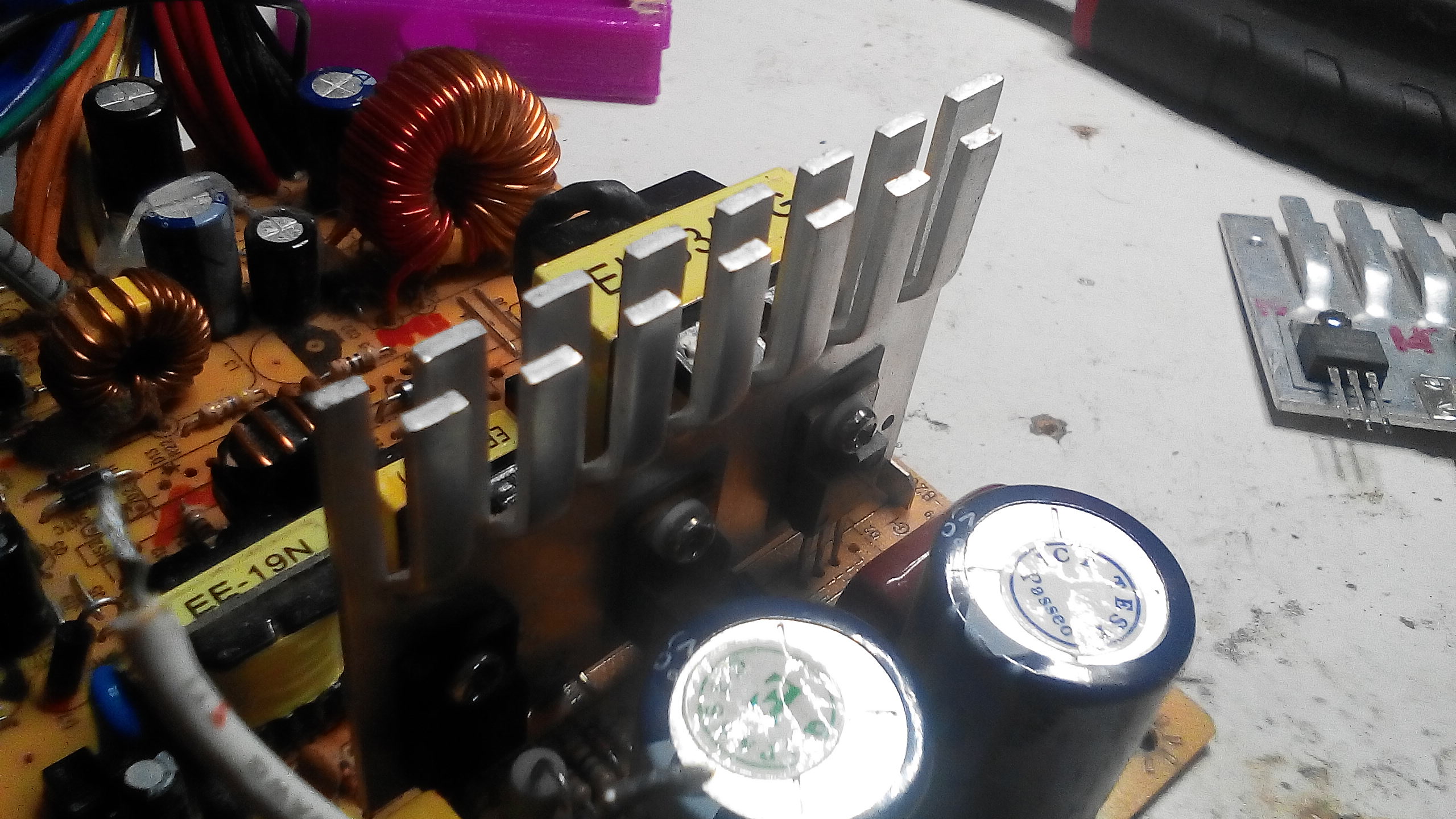

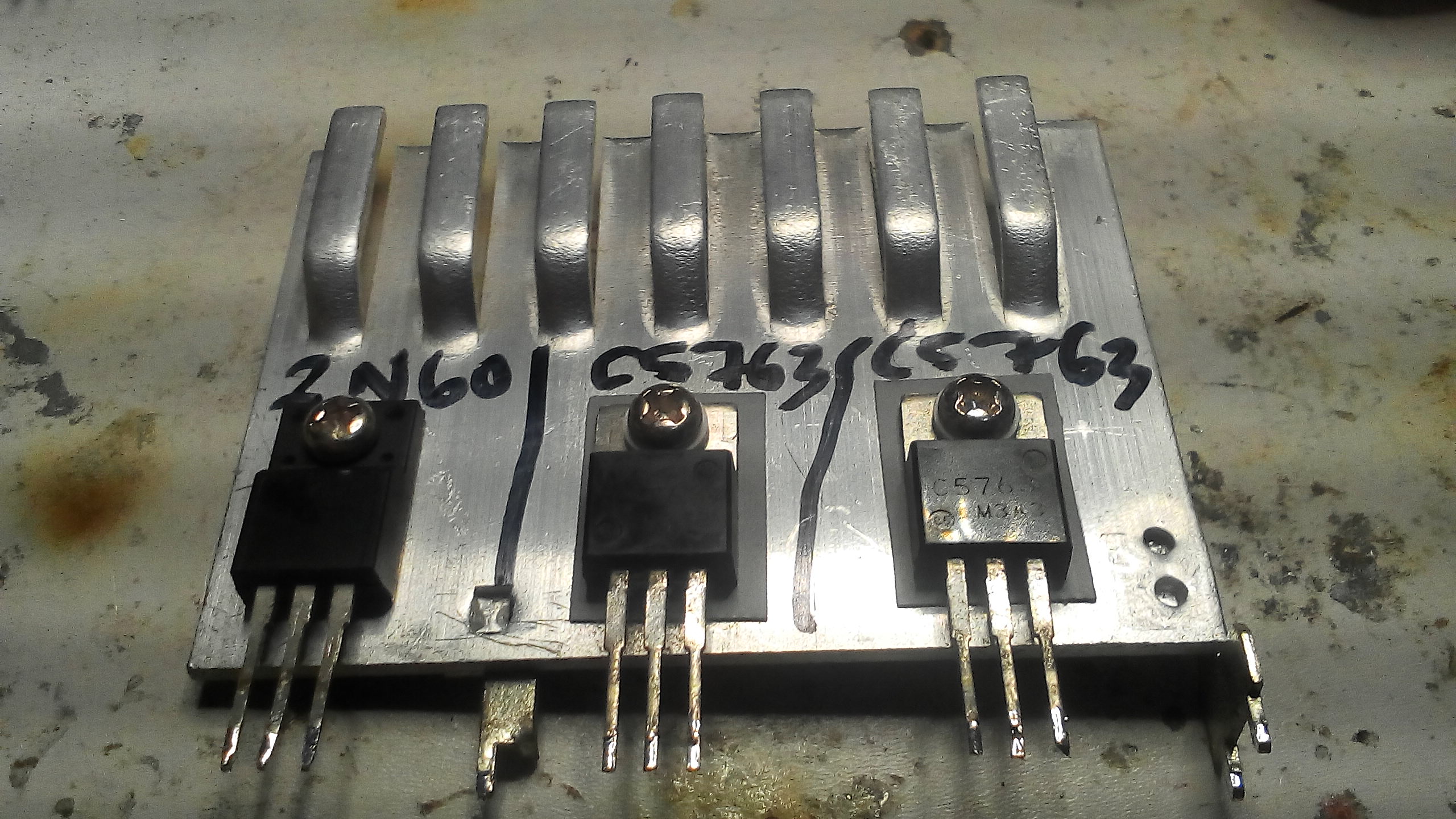

                      Ok, thanks for the diagram....doesn't matter for me if I need to learn over 100 posts....
                      I'll have a checked on 3 primary transistors and show you the photos later on....
                      Let's see what we get here...and go from there....

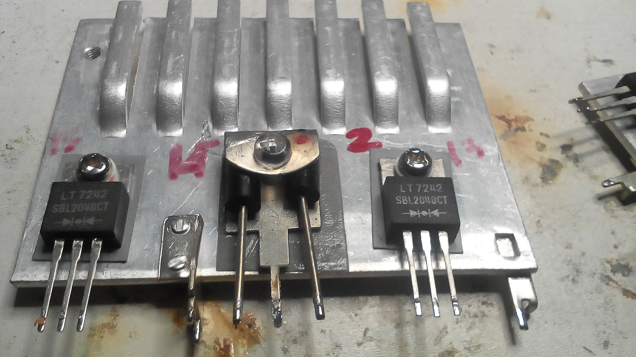

                      I have unsoldered the 3 primary secondary rectifyiers as well...so we can see the result as well...and tell me what you think ?

                          "primary secondary rectifyiers" What the heck is that? you have rectifiers in the Primary (HOT) side and rectifiers in the secondary (COLD) side.
                          Beside, the rectifiers for the SB power supply or the Other power supply?
                            Re: 12V rail is not on ?
                            sorry...mistype...secondary rectifier...

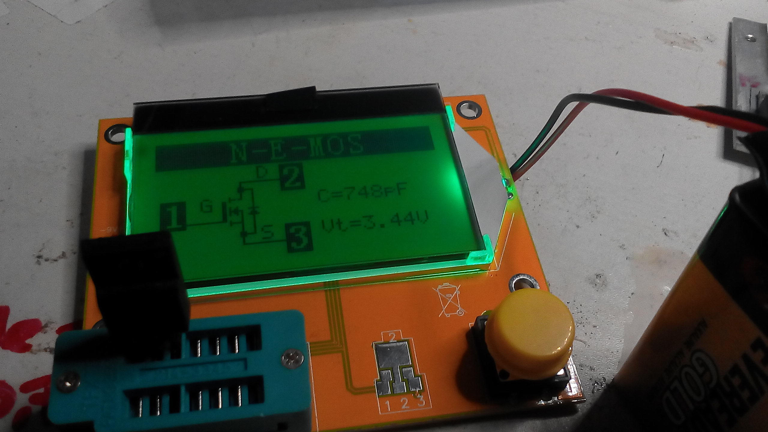

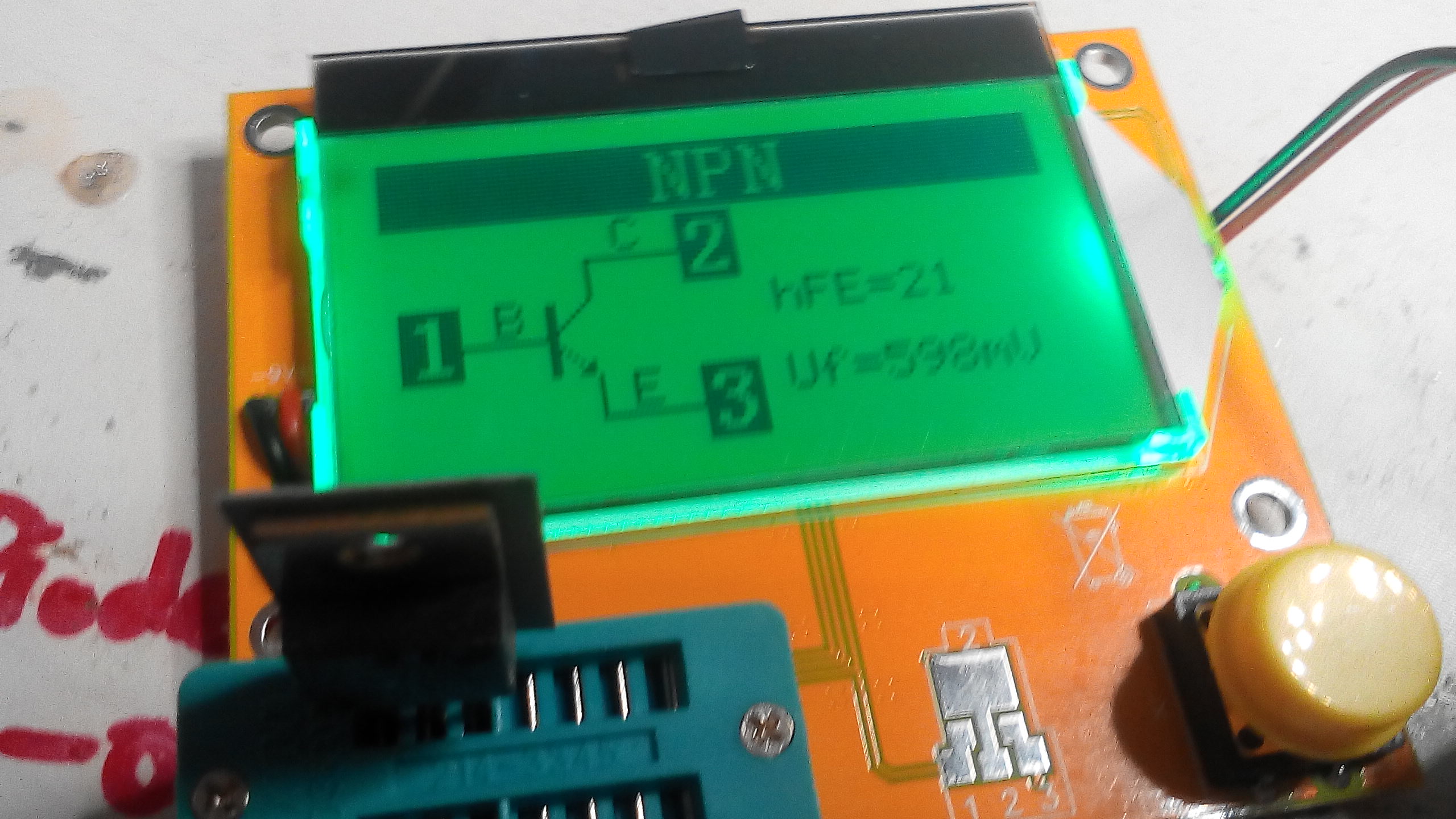

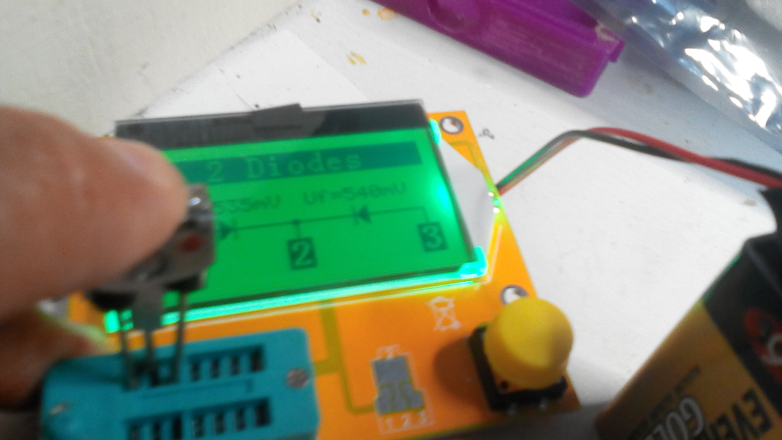

                              here's the test from primary transistors...how do you reckon ?

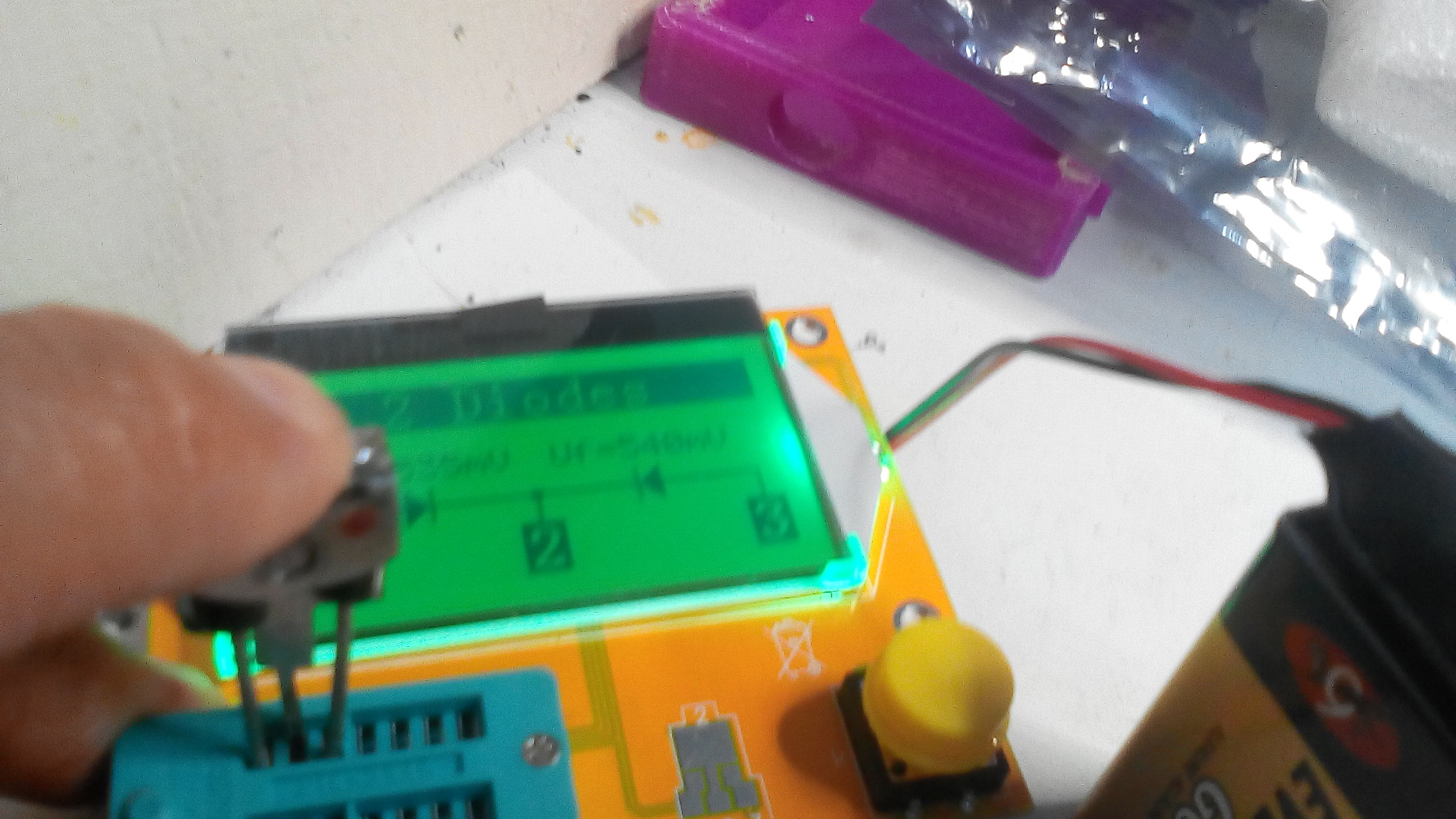

                                I'm going to test the secondary rectifier and show you the result...give me a moment...

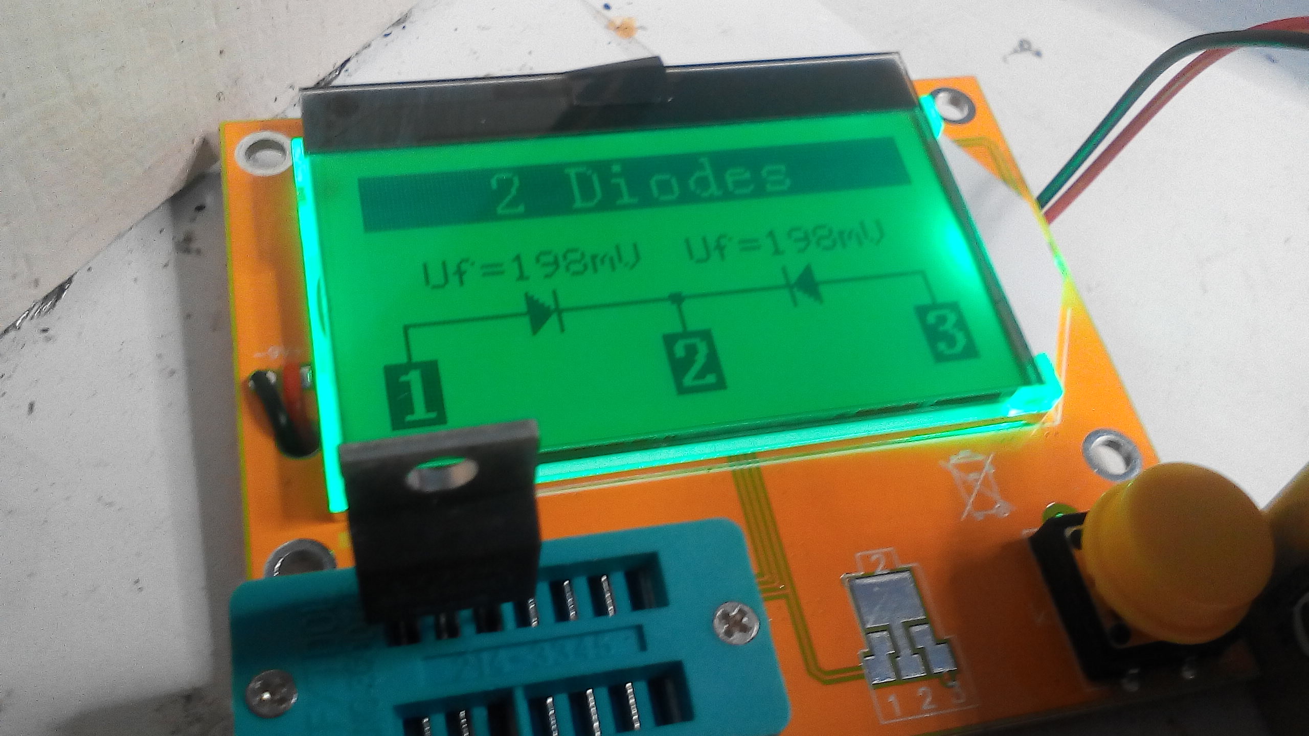

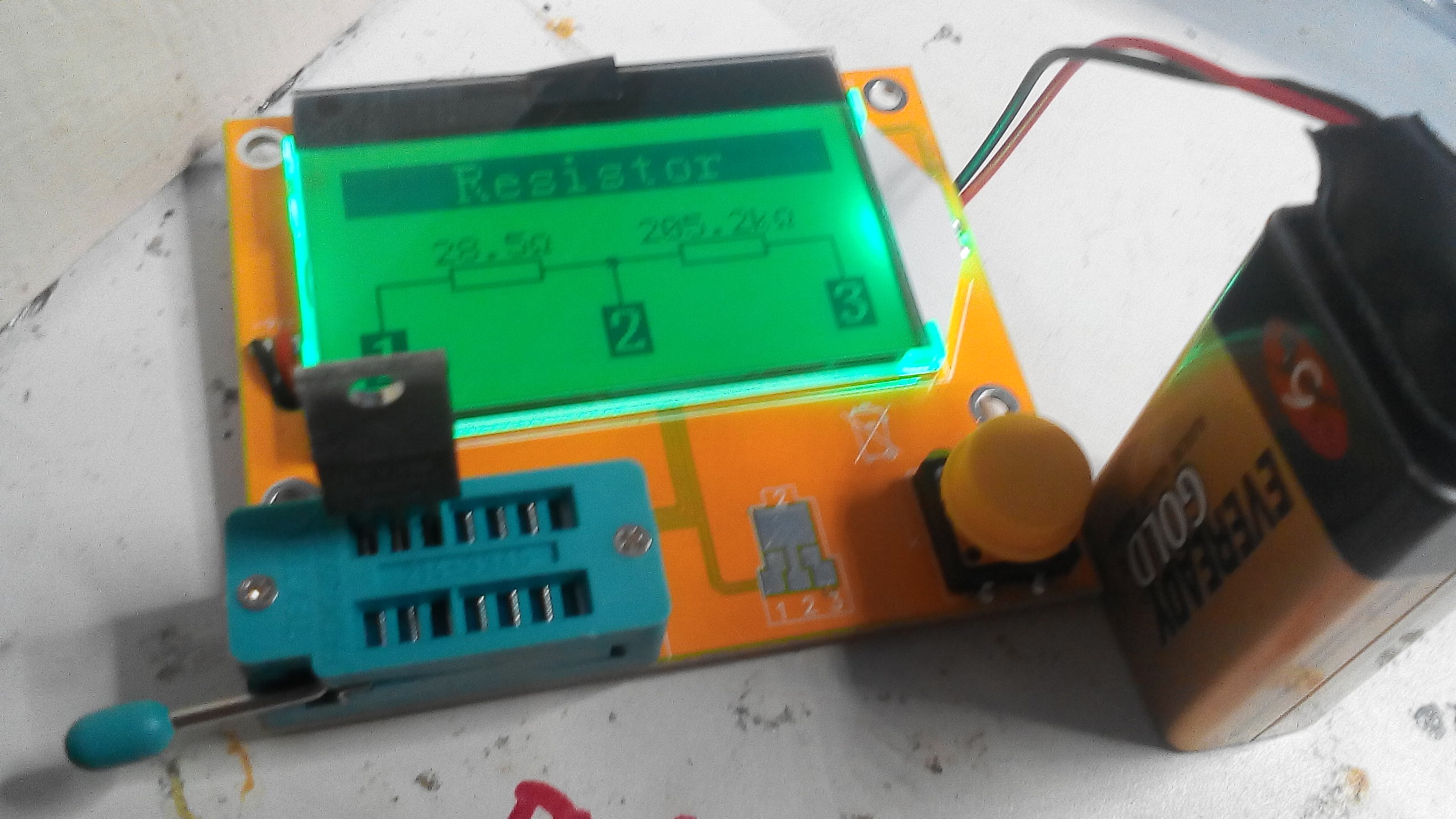

                                    Here's the secondary rectifier result.....3.3V rail is not good result it's showing resistor result 28 ohm and 205K result...it was brand new before I tested it in circuit...
                                    Brand new from the tray 198 mV and 198 mV
                                      How do you reckon from the test result ? talking about diagram, here's the pcb code :

                                          Just now, I saw two burned resistors....near to 3.3V rectifier....I'll show the pictures...hold on...I'll take picture of them...that's why I saw a smoke yesterday, and it was resistor burn smell yesterday, but haven't seen it yet until now...R33 and R34
