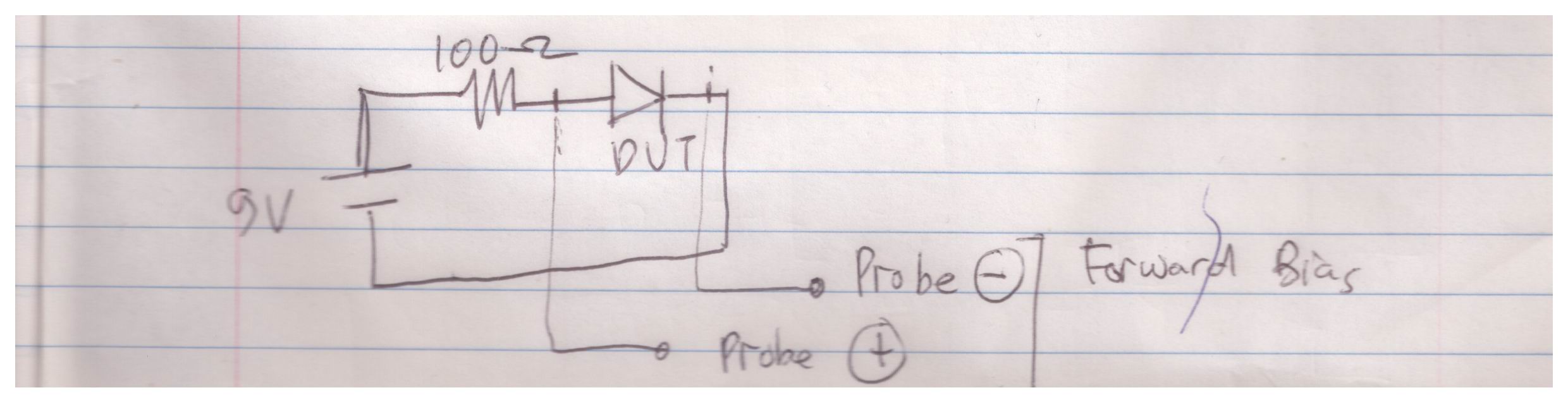

          This is the small test that I had done...please correct me if I'm wrong...
          That's for forward bias....how about reverse bias ? swap the probe minus to plus and plus to minus with DMM in diode test ?

            if you check with the 9V and 100 Ohms resistor in reverse, does it show 9V across in reverse bias, it should if it is good diode.
            How can I do that ? do you have a schematic ? cheers
              #86
              Re: 12V rail is not on ?
              Originally posted by bianchi77 View Post
              This is the small that I had done...please correct me if I'm wrong...
              All you have to do is to flip the diode around then you will see that the DCV across the diode will be at 9V.

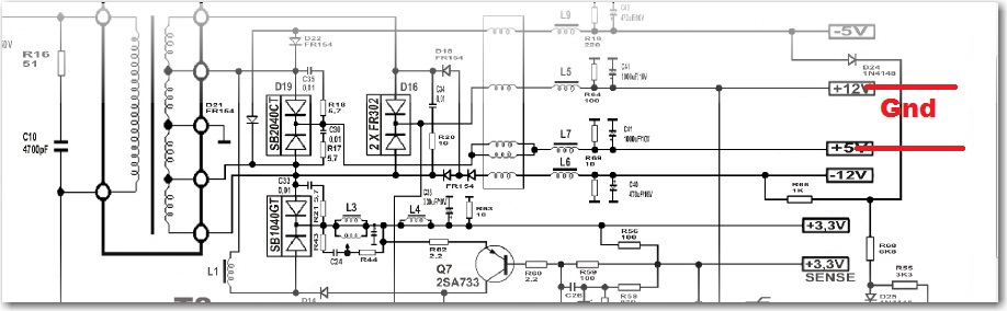

                            What happened if the 5V or 12V diode sunk to the ground ....
                            I reckon the diode will get over current....how much current will it be in that 5V and 12V loop ?
                            I gave a surge current for those SBL1040....but I have no idea how much ?
                            Is it related with Maximum rating in datasheet :
                            Peak repetitive reverse surge current per diode at tp = 2.0 μs, 1 kHz == IRRM == 1.0 A
                            It will die instanly if the limit is only 1 A
