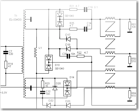

      I can see 2N60 on the PCB, I unsoldered it, but can't find it in the schematic ??
        It's in the schematic. Q3. That wouldn't be it anyway, because it isn't blowing fuses.

          Ok...so most likely SB1040 because I tested on diode mode only 0.1V...too low...
          I'll change three of 'em anyway to SB3040....
          Meanwhile I'll check other transistor..
          I'll keep posted..

            I have checked all the transistors and diodes, they are in a good condition...
            so only these three diodes are under the normal condition...
            how do you reckon guys...?
            No problem with the capacitor as well ?
            How about the chip ? U1,U2,U3 ?

              and D7 is weak only 0.2V

                  D7 should be the same as D9. I don't see any U3. The IC's you cant test most of the time. They either work or don't. An oscilloscope comes in handy with that.

                          Why do you think the PWM is bad? you got any voltage on the secondary's besides STBY power, when you jump STBY to PSon?
                          • bianchi77
                            • Jun 2016
                            • 1121
                            #53
                            Re: 12V rail is not on ?
                            I can't check the voltage because I unsoldered the rectifier for them...
                            I suspect 2 SBL1040 are bad....0.1V only on diode test...
                              Change those. The SBL1040 should have a voltage drop of 0.6 on your diode test. Does it show shorted too when you reverse the leads?

                                Not shorted...and the diode for 12V rectifier is only 0.4V so I need to replace it as well....
                                waiting for replacement, I want to replace them all with SBL3040..

                                  I test D22,D20,D17,D18 in circuit with 9V and LED,1K ohm....something is not normal...
                                  It's on a both side of test reverse and forward bias...
                                  Are they all bad ?
                                  or to be sure must be off circuit ?
                                  PCB code Y-B200 ATX Ver 2.6...and they are on 12V and 5V rail...
                                    Are they all bad ?
                                    Test them OFF the board!

                                      https://www.badcaps.net/forum/attach...4&d=1469140301
                                      Look at the diagram, you have load resistors in the circuit, all you have to do is looking at how the current will flow when you hook up your 9V, 1K, and LED to the Diode you are testing then you will understand why the TEST LED will light up in both directions.

                                          I've taken the four diodes of the circuit test it with LED and they are normal...must be something else....could it be PWM chip 2003 ?
