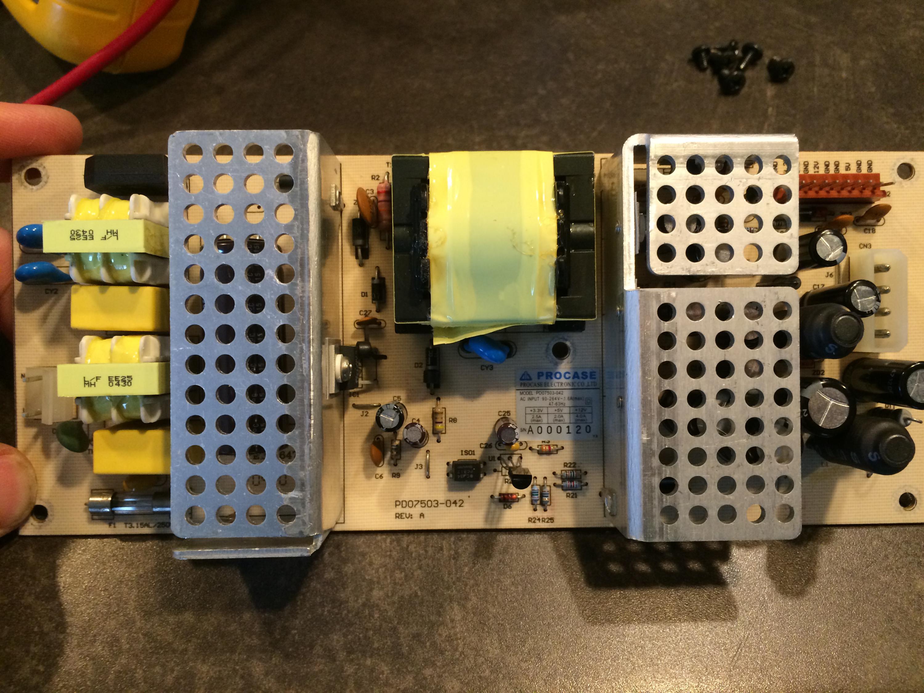

When recapping a switching power supply, space permitting, what are the pros & cons of increasing the capacitance of the output filtering caps?

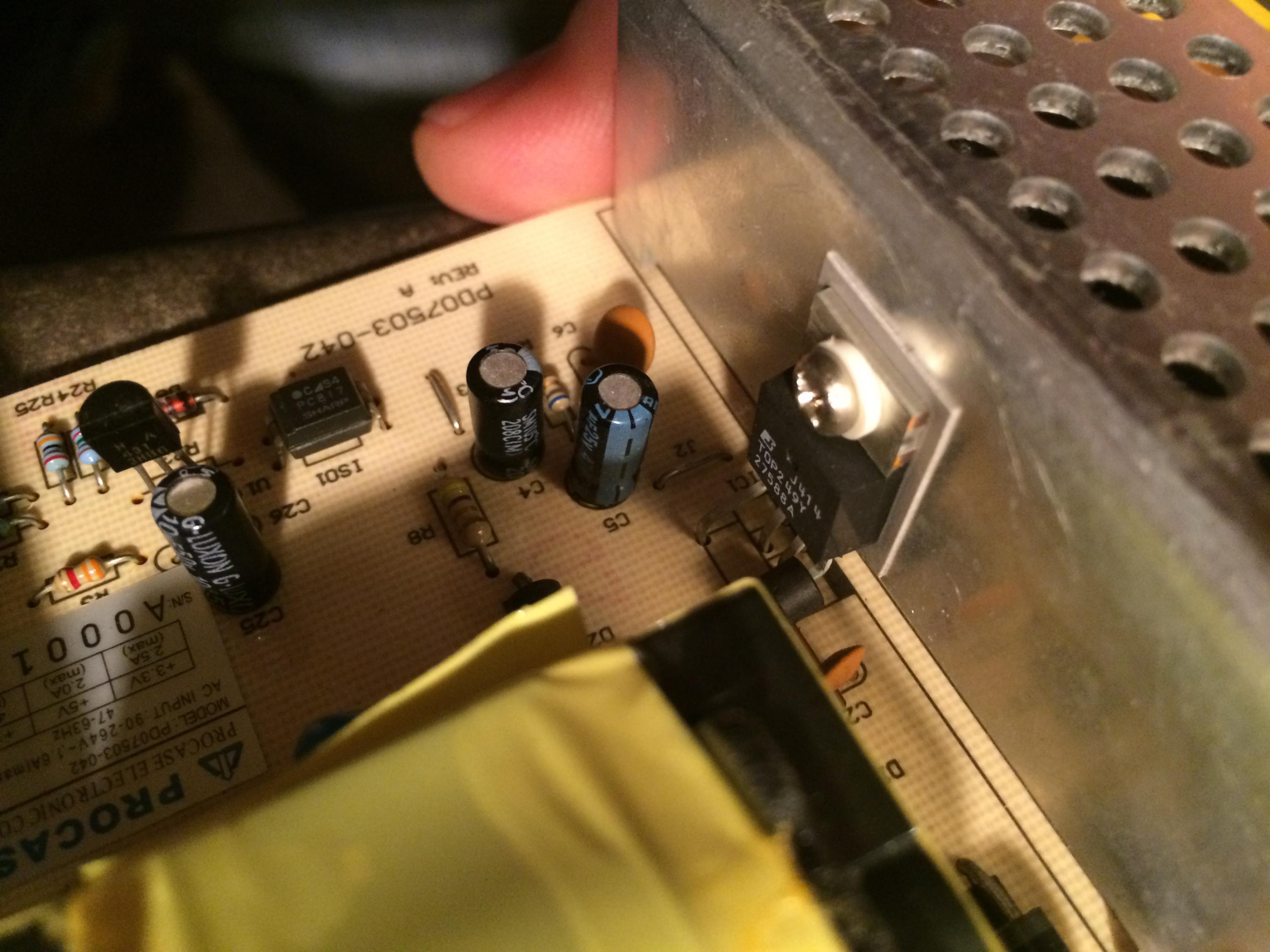

It was a general question on switching power supplies vs linear mainly, but also came up when I recently recapped my McIntosh MS300 power supply with Panasonic FR's and a few Nichicons. It's a TOP249Y based 66 watt switcher powering an IBM PowerPC motherboard, a HD and a CD ROM. I resisted increasing the capacitance since ESR would be already be lower with the same size Pannys, and I know ESR can influence feedback/regulation. I figured I could always add caps to the 4-pin molex connectors going to the drives and to the 20-pin ATC connector later on if the pros outweighed the cons.
(the second pic with the switcher is before the recap)Last edited by Cohibaman; 01-30-2015, 06:41 PM.Comment

Yeah FR have too low ESR, Chemi-Con KYA are much better suited for these old PSUs as they have high capacitance while reasonable ESR. That's why I have went for them. But as I do not work on such old stuff anymore, I am taking KYB next with slightly lower ESR.
Adding caps to cables (where you do not drain power from) is not a good idea, than the power will flow forwards and backwards, basically making oscillator. Filtration caps should always be as close to rectifier as possible with minimum ESR (but it must be of level which the circuitry accepts).Less jewellery, more gold into electrotech industry!Half of the computer problems is caused by bad contacts

In regular PC PSUs and those that don't use a flyback topology, it's best to not go much lower in ESR. But choosing between staying with the same ESR or same capacitance, always choose same capacitance (or higher). In other words, never lower the capacitance just to match the ESR. PSUs are like the exact opposite of motherboards, where the ESR is more important.Comment
