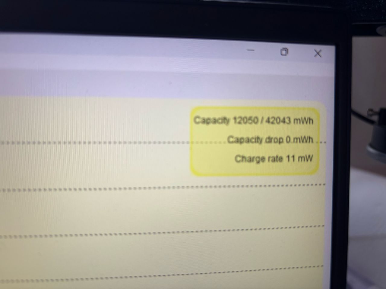

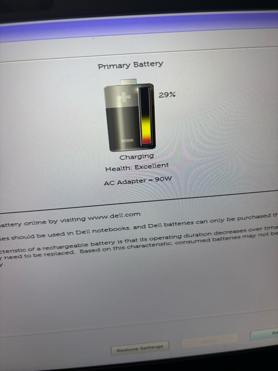

    board number LA-F312P ....laptop charging but not increasing percentage...charge rate very low on BATMON ....i try use another battery also same result...but when i try this battery and adapter to another laptop (dell latitude 7300) its charging normally and charge rate goes to 19k-20k mW
