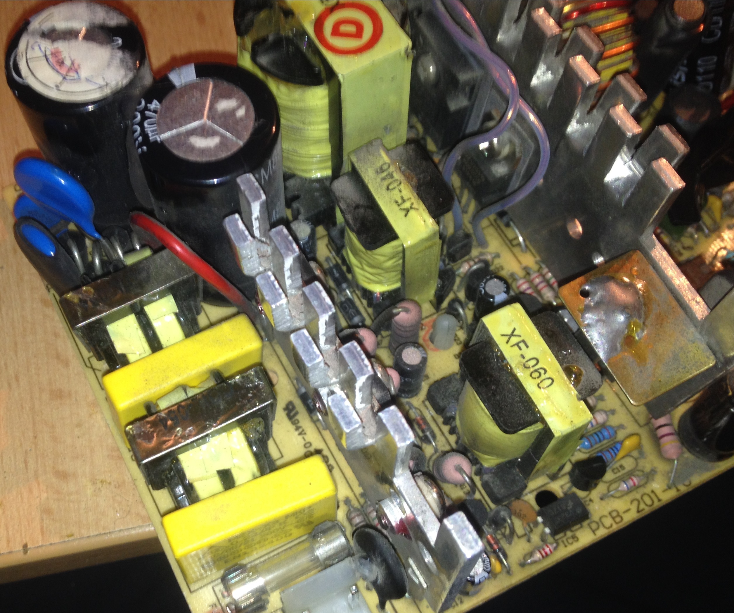

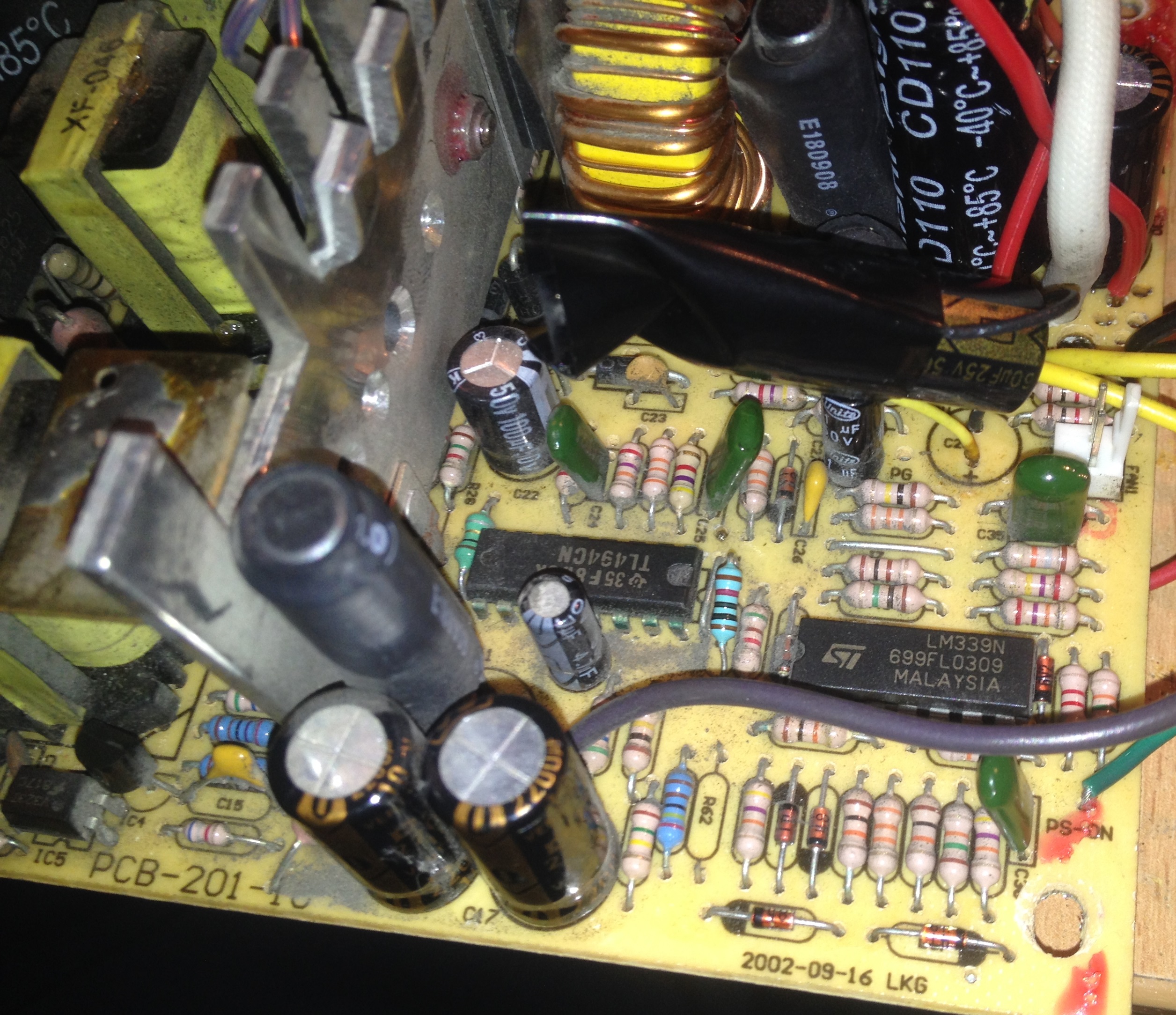

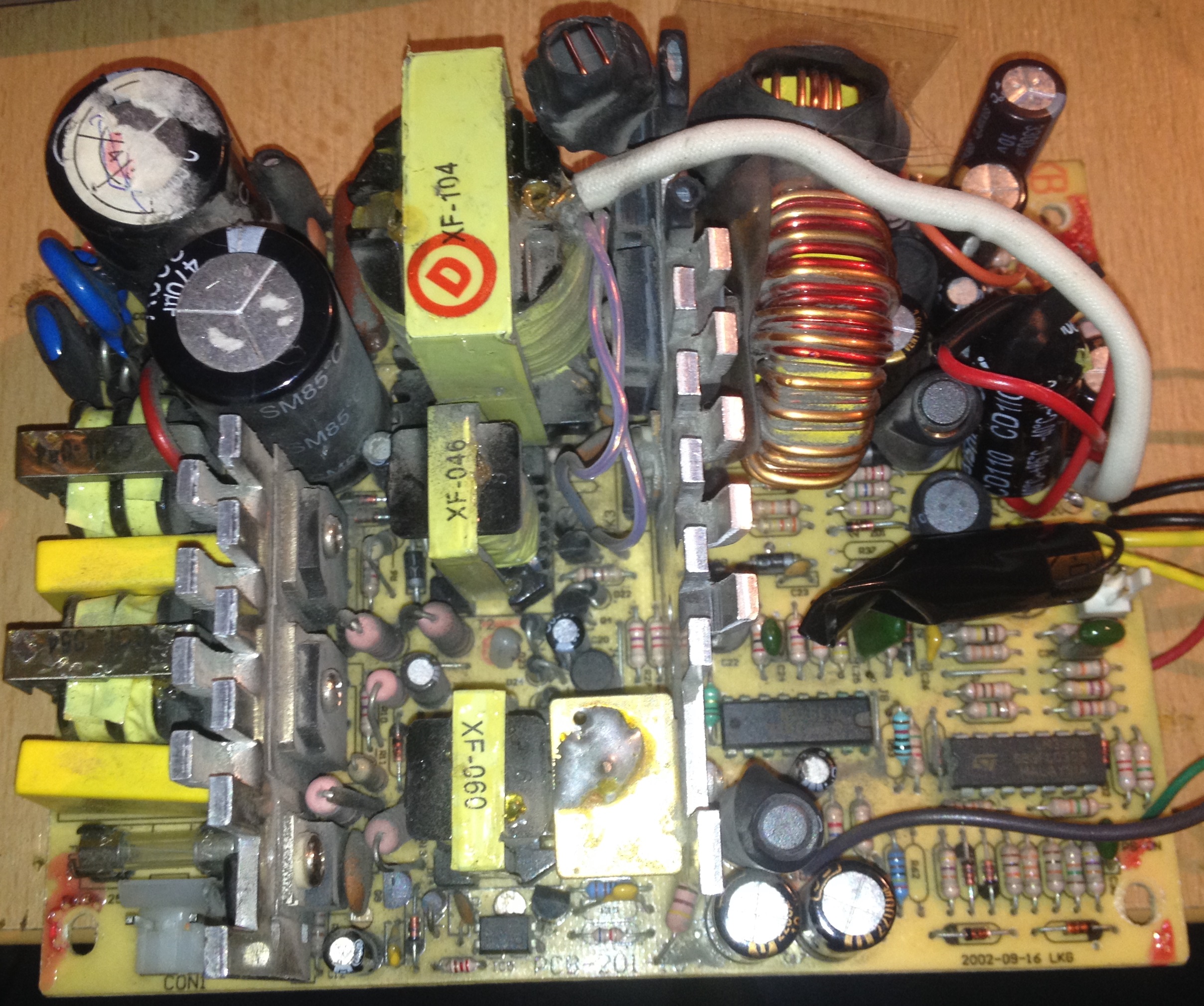

    Hi, before i start i just want to

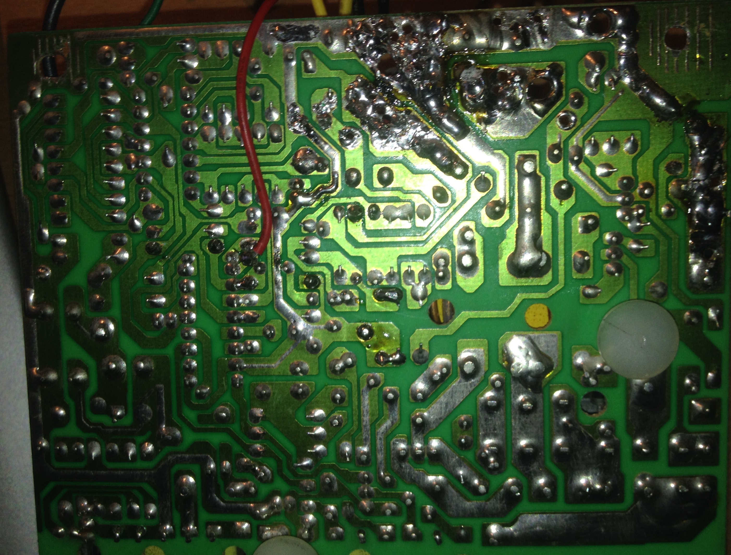

    since unmodified ATX psu pretty much sucks as a lab supply, I decided to make it into one. Internet is full of "tutorials" how to do such thing but all of them are just useless bull**it because they only show you how to put a linear regulator or whatever into it. So i made one on my own by disconnecting pins 1 and 2 of TL494 and connecting them so pin 2 is around 1,5V (voltage divider from VREF on tl494) and pin 1 is connected to gnd with one resistor and to 12v with potentiometer. It works really great but i have one problem - protections. On old crappy supply i had i just desoldered 8 pin protection chip and grounded some pins but then it lost short circuit protection and i "accidentaly" fried it (love that burnt semiconductor smell). Now i got myself some really nice psu - lots of imput filtering, high current everything(transistors, rectifiers,...), lots of output filtering as well, good quality output caps, etc. It has protections probably somehow made through lm339. I wouldnt mind them - still works from 1,5 to 17 volts with high currents but i would like to remove all unnecesary coils, caps, etc from other outputs since i dont plan to use them. Problem is that i cant. Even when i removed output cap from -12 volts the damn thing refused to start. I guess I can just remove all "unneeded" circuitry but i really want short circuit protection on this thing.
    Is there anyone who would like to help me with this?
    Some photos: http://imgur.com/a/rZbAZ

                        I was through a simmilar project recently. I followed the tutorial for the first part (converting atx to 13.8v p/s) where you really throw everything out you don't need, keep 12v rail only. The control chip was DR0183, and according to tutorial one would fake +3.3 and +5 voltage input to chip by routing +5vstby to them with according voltage dividers to keep the controller chip happy.
                        As I have moded the atx to 2.5 to 25V p/s, I had to keep the OV protection but removing the UV protection. The problem was that it had 1 pin monitoring both things, and the limit was broad for chip iself - 3 to 5 V to make it happy. So I have made an adjustable voltage divider with diode to that pin adjusted to trigger OV protection @ 24.6V but the problem was that this would trigger UV protection @ 10 or so volts. So I have added another diode from 5vstby rail to keep the pin at 4.3v (5Vstby - diode vdrop) no matter what, and another adjustable resistor network to increase voltage at the pin to trigger the respective OV voltage adjusted to 24.5V. I did this in case feedback reg. potentiometer wires are damaged which will result in skyrocketing voltage. Did not fiddle with short circuit / oc protection though - wasn't even sure how it worked, so I added automotive fuse. but this was not needed, as the protection was still there.
                        Just play around with pins going to lm 339 from 12v rail, and in case you want to remove +3 and +5 V rails you might need to fake few lm339 outputs, but I would advice making a diagram first.
