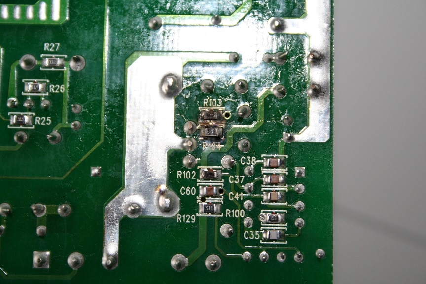

                                          hello, found this forum after searching. my PP1500swt4 popped after plugging back into the wall from replacing the battery. I've found this
                                          thermistor repair possible/ costly?
                                          Unit works except it won't keep a charge. it charges up and a day later it's dead.
                                          tia,
                                          parker
