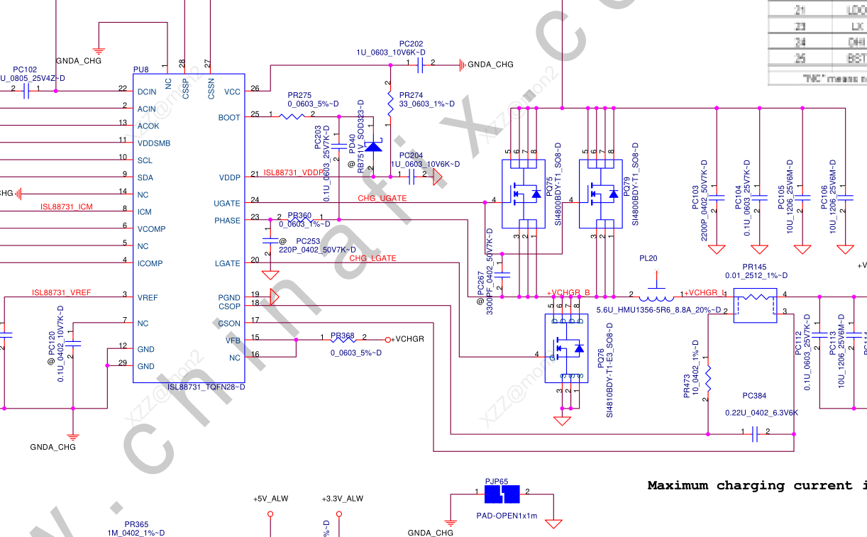

    Hi guys I have this dell that with the battery charged it turns on correctly, but if I connect the charger I get the charging symbol but it doesn't charge the battery.
    I found the shorted charger PU4401 ISL9538h that had pins 14 and 15 shorted and I replaced it. but it still doesn't charge.
    I noticed 2 things:
    1) without the battery connected if I connect the power supply, on the SDA and SCL pins of the battery I have 0V I measured the resistance with ground and it is very high, if I connect the battery I have 3v on the 2 lines.
    2) if I try to turn it on without the battery the notebook doesn't turn on.
    I checked the mosfets but they seem good.
    On PR4401 I have 19V and on ISL9538h pins I have this:
    Pin 17=19V
    Pin 18=5.1V
    Pin 19=3.2V
    Pin 20=0
    Pin 21=0.8
    Pin 22=0.8
    Pin 23=0
    Pin 24=3.2V
    What can I check?

      my charger is a ISL9538h here is a demo photo of the pins

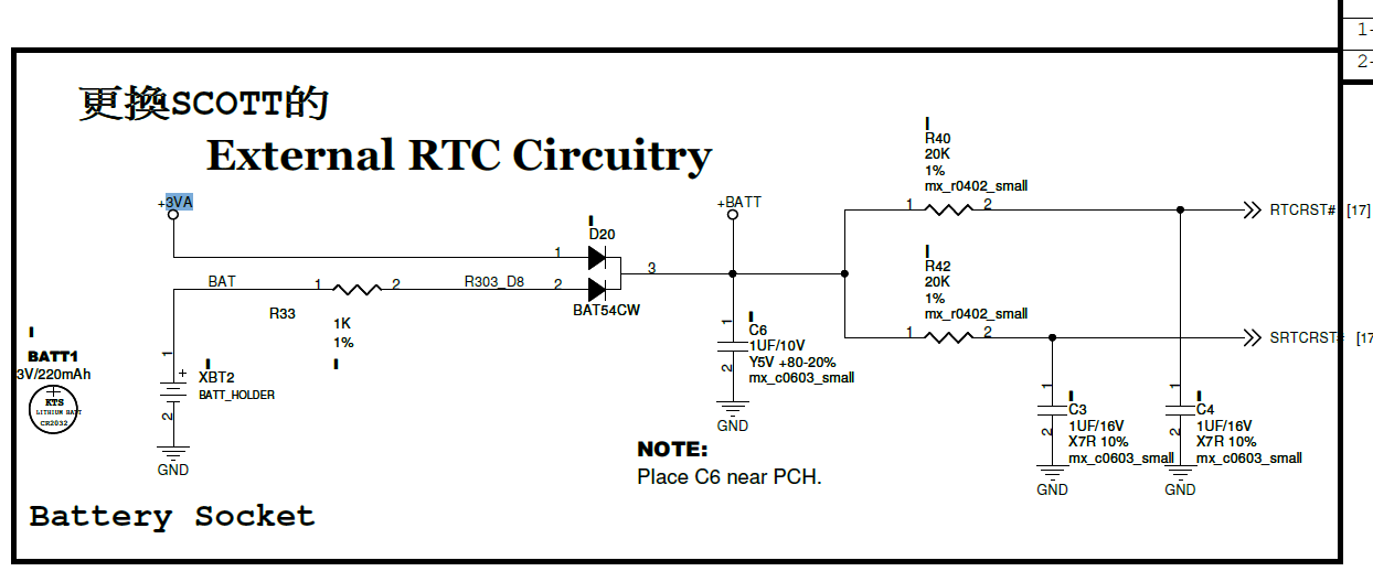

                Check the dual diode @ D20.
                Remove all power. Meter in diode mode. Red meter probe on pin # 1; black meter probe on pin # 3. Meter should conduct. Reverse the meter probes, the meter should block = OL.
                Repeat with pins # 2 & # 3. Post all measurements.
