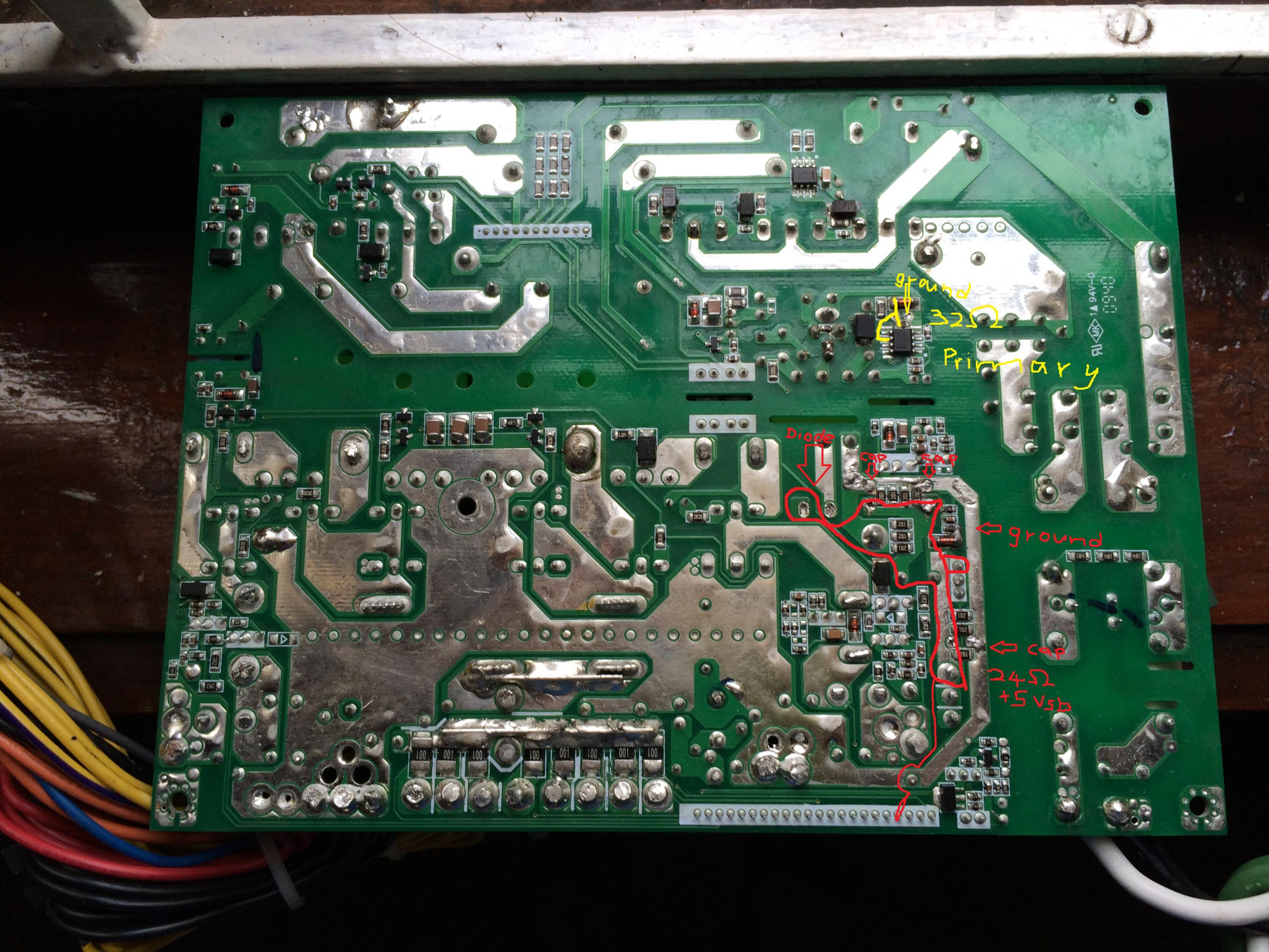

    Hello everyone , I have some problems with my psu.
    The psu is not powering on (no green light or fan not spinning)
    I opened the psu and found short on +5Vsb , I removed all caps in that line and still short is there (its not a full short , its a lil short like 23ohms not 1 or 2 ohms)
    Also I found another short in primary circuit its also about 34ohms .
    I examined all components and didnt find any blown caps or blown diodes.
    Board has zero burn marks its fresh . Also this psu has a short circuit protection , when it finds a short it will shutdown and wont come up until short is gone .
    please tell me where I can start my testing procedure from now ?
    Thanks for your help!!!

          Re: Silverstone ST1500 (+5Vsb shorted)
          I have marked the shorted points . other than those places I dont find any short .
          il upload more pics later , it takes alot of time to upload.
          ps: the short goes up to the small secondary board (the one I have showed in single line red , which has many pins in a straight line ) .
          How can you check if the load resistance in gone ? I checked the resister that is connected between live and neutral wire , it has about 200kohms , also there are two filter caps connected to it ( all these stuff are out of the board ) these are present near the power socket.
            you see all those resistors that say "201"?
            those are 200ohm and they are in parallel - that's your 25ohm
            your actual problem is something else - maybe startup capacitors.
            what small 4.7 to 47uf caps are on the top?

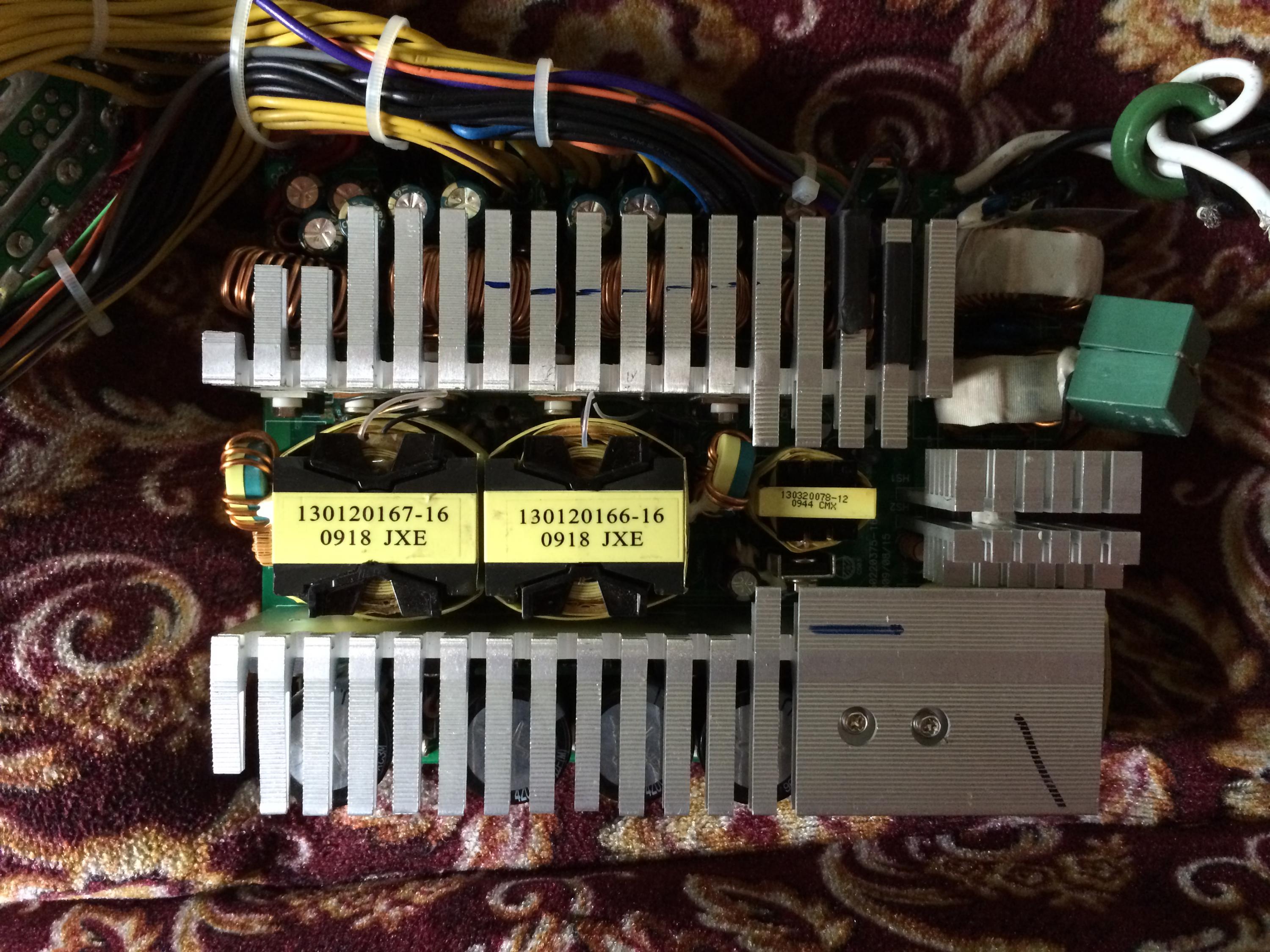

              Picture from the top straight on and acouple from each side?
                @stj thanks for clearing my big problem , I thought that line was fully short .
                so 10 200ohms resisters in parallel is about 20ohms that makes it correct ( because the multi would read some what higher than real ) .

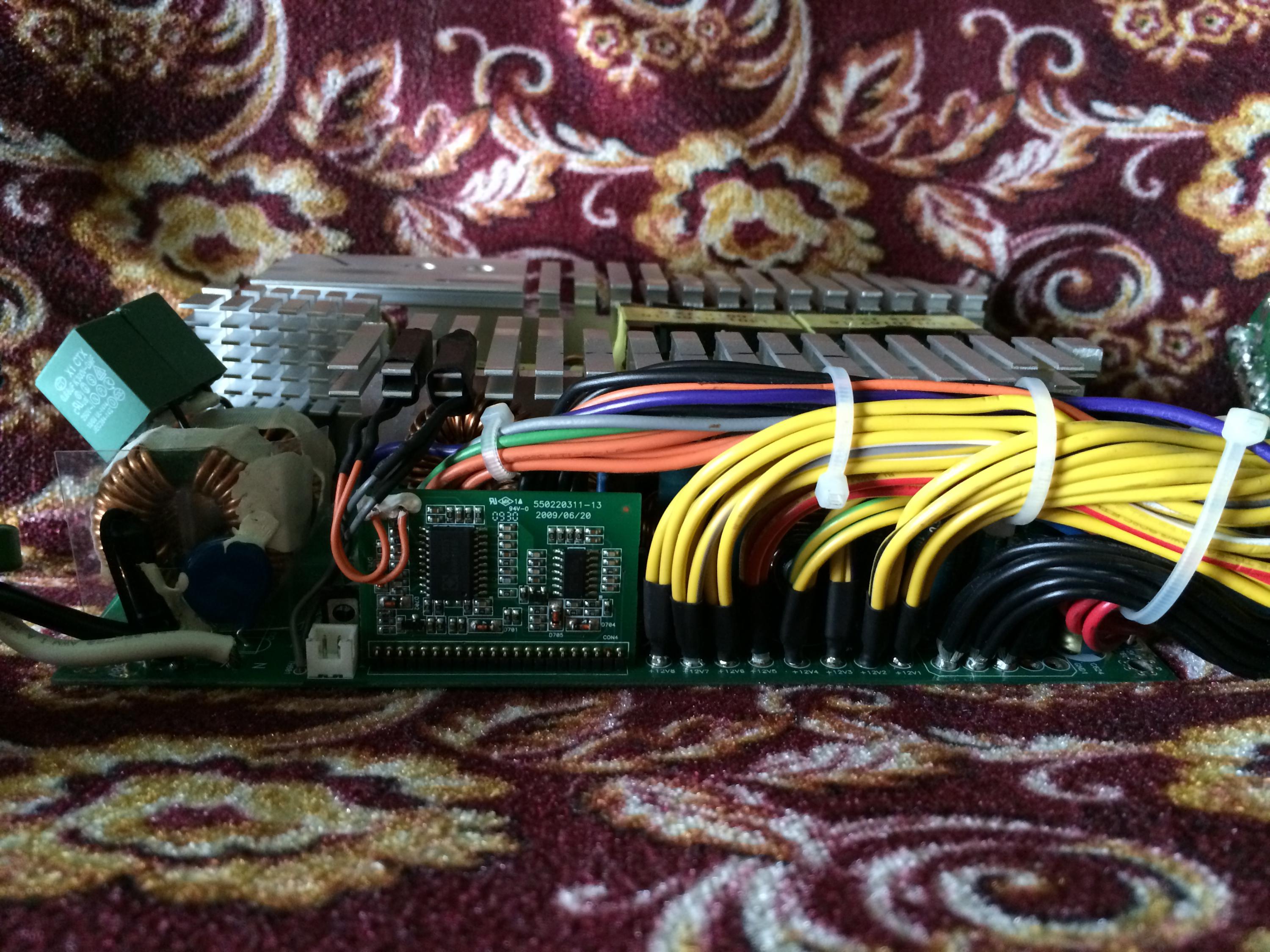

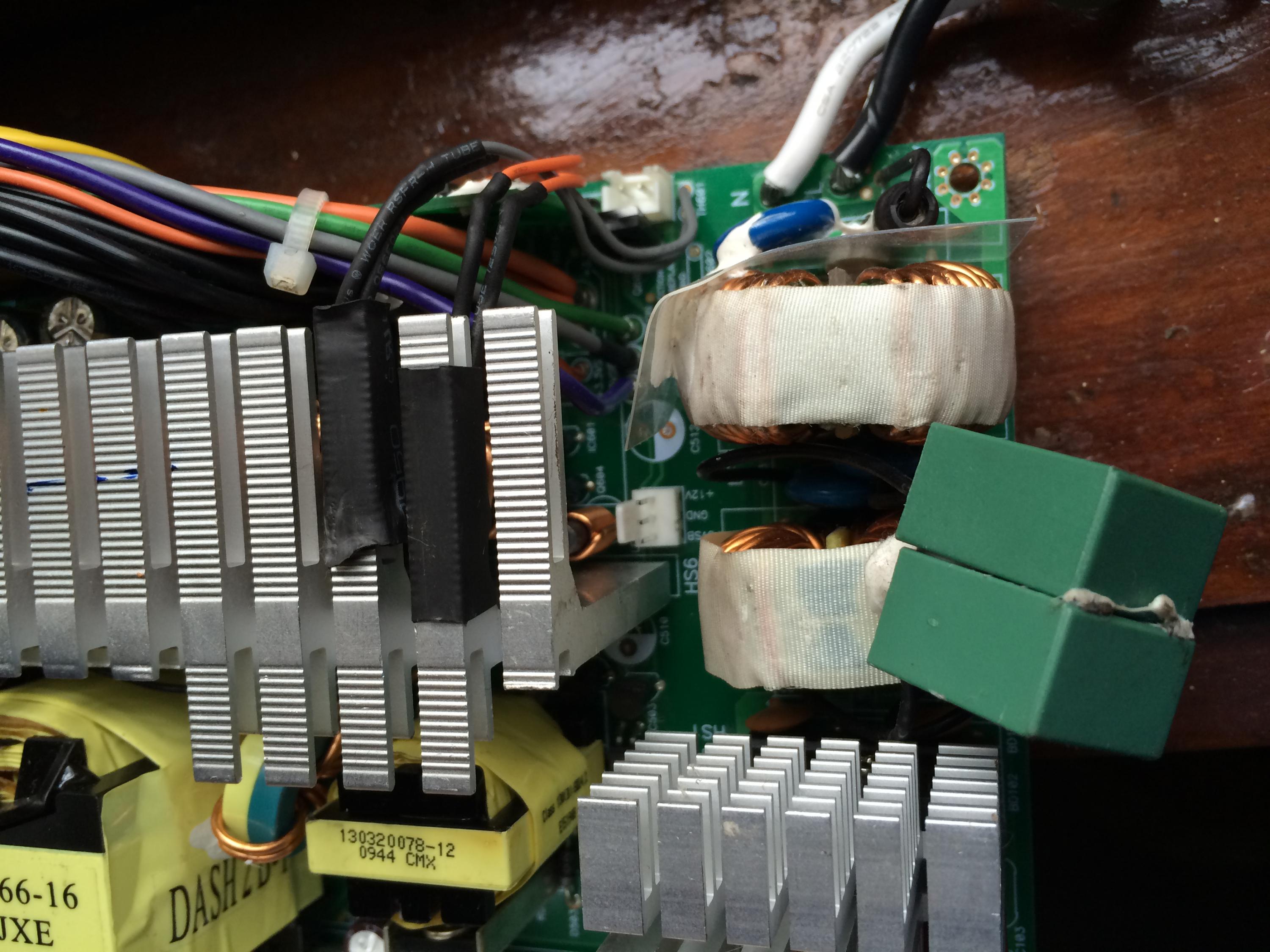

                    here they are !!!
                    @sji : can it be the short thats on the primary circuit that I have shown in yellow ? I checked the rectifier and I didnt find a problem with it .
                    Can I suspect any transistors ?
                    Also In the primary circuit I found two resistors shorted ( fully short )
                        that's packed in so tight i cant see anything!
