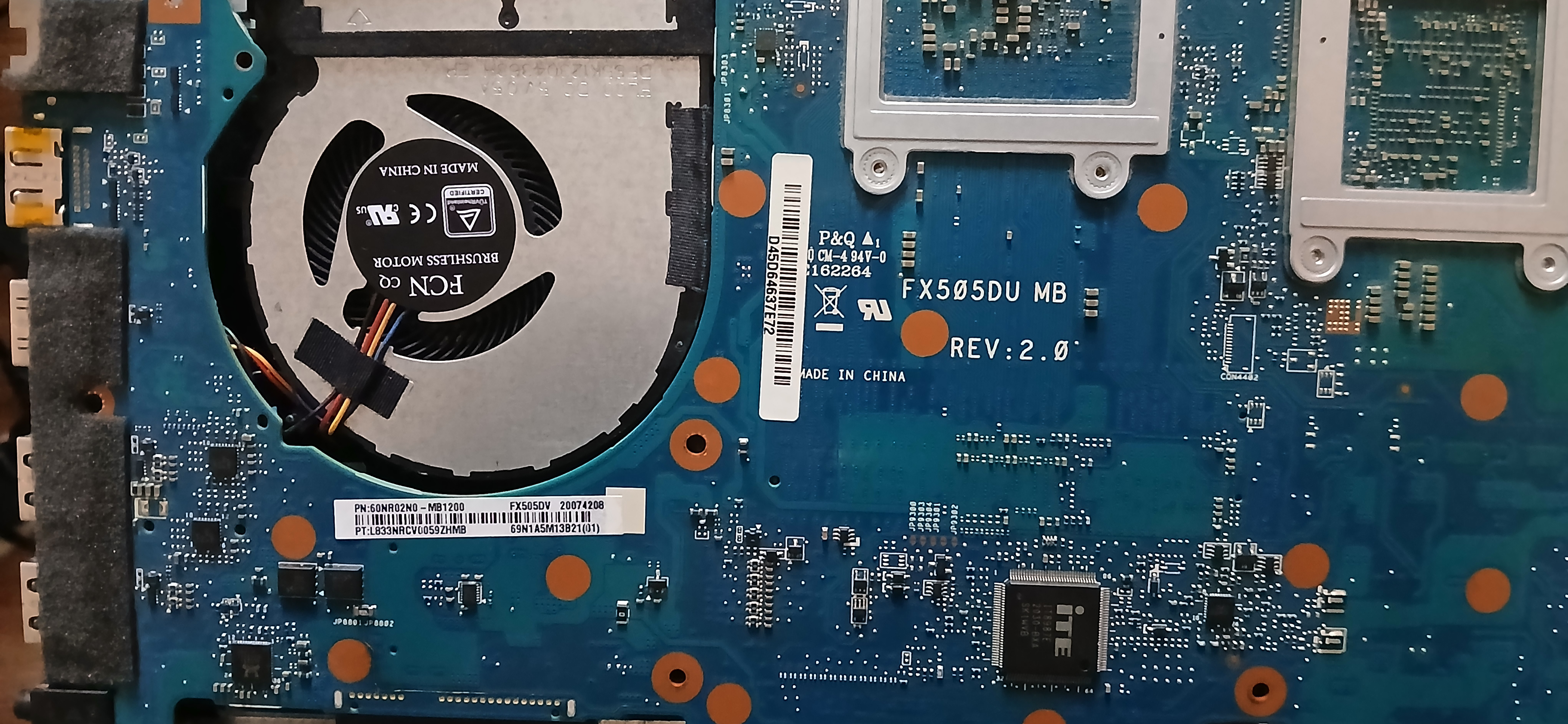

    ASUS FX505DV no power shorted at PWM controller Pin 3 VREG3 TPS51225C, need pinpointing of the short.
    (If anyone has a functional boardview file of FX505DV/DU that would be helpful)
    (Had 3 problems, now just 1)
    I have no experience or knowledge and usage of tools to repair devices besides the entire past 12-10 days of researching, watching YouTube repair videos and troubleshooting this laptop motherboard. ChatGPT was used as a guide to ask questions.
    I used boardviews of mostly FX505GD-M, and some FX505DU, FX505DD. Used schematics of FX505DU.

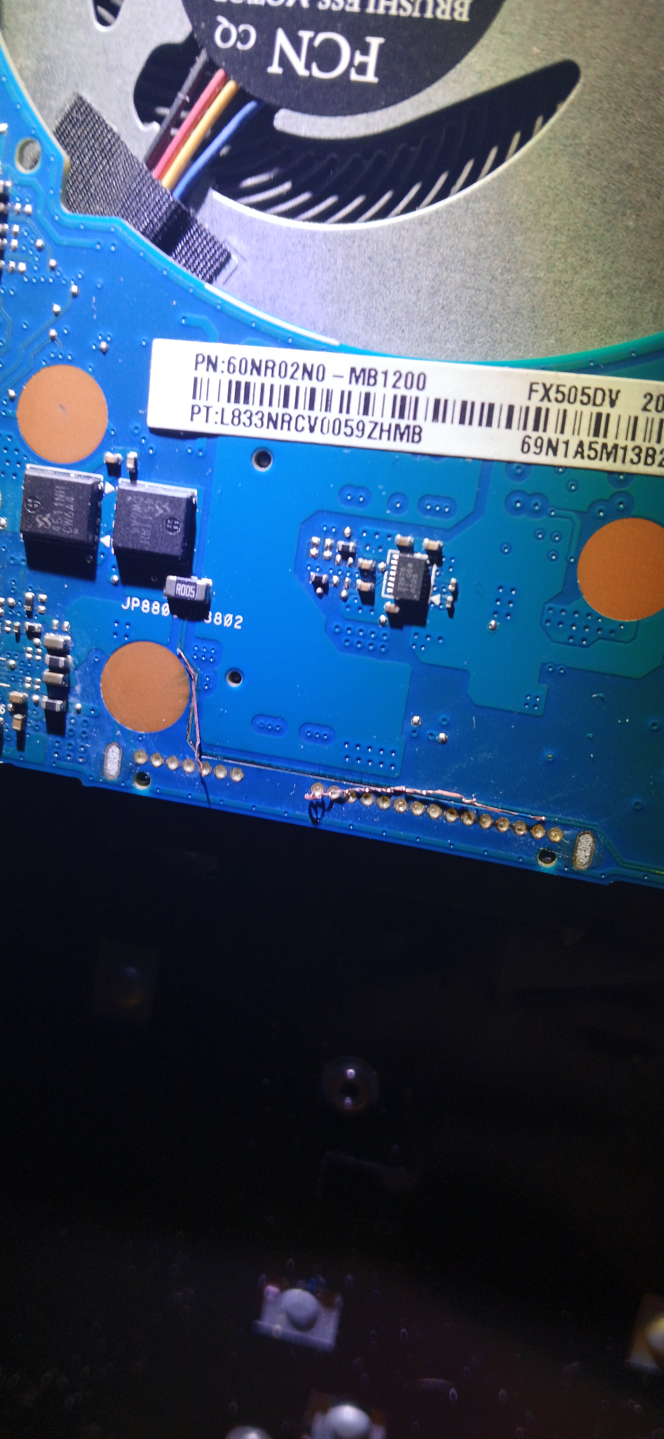

    I had originally intended to replace the BQ24780s first (due to previous battery removal while benchmarking) but I failed to notice the barely lifted trace of a white outline and the smell (sweet metallic smell, only noticeable when I placed my nose basically on the board (don't ask why)); just marked it down to being previously worked on and due to lack of knowledge; thinking it was normal minor motherboard defect.
ID:	3618850 Click image for larger version
    Then the laptop would not power on which led to quick inspection and discovery of the destroyed trace, I soldered a jumper cable reconnecting JP8801 (It measures 20v on both ends once I replaced the Charger IC).
    When I installed the battery, the PWM controller IC instantly heated up, which led me to probing, discovering pin 3 shorted, tried replacing and measuring for shorts on the 2 capacitors (on 1st contacts to +RTC_POWER on both was shorted).
    Didn't work, pin 3 trace was still shorted, removing the IC and measuring the trace still detected the short. Placed the IC back. I am waiting for the replacement PWM IC to arrive and confirming if a faulty IC is the case.
    When the motherboard is plugged into the charger, it produces a high-pitched sound, no obvious signs of heat. This sound does not show up when battery is plugged in.
    Currently I'm stumped to where I can find the short as I'm assuming R8151 (0 OHM resistor) ends up being a bead of solder at the end of 3rd pin trace.(This measures short as well) And unsure where to start from 3VA / RTC_POWER and then towards the general 3V power rail to find the short.

    Originally posted by OOF DIO
    Correction: JP8801 measures 0.2v.
    Which means, even your Main Power Rail is not present right now.
    The floating track is most likely ACN or ACP, so for current sensing. If this track has touched another circuit, for example a 3.3V line, then it would explain what you are challenging right now.
    At least a shorted 3V LDO and from what i read still something wrong around the charging controller, so multiple issues.
    To blindly remove components is a very naive approach though. You need to inject voltage with a adjustable bench top power supply into this track. What is shorted will heat up then. Typical suspect is the embedded controller.
    I suggest to figure this first before continuing with the charging controller, since the damage could be already lethal for the motherboard.

      It's also shorted at +3VA_EC overall, pin 121 of the embedded controller sounds the short.
