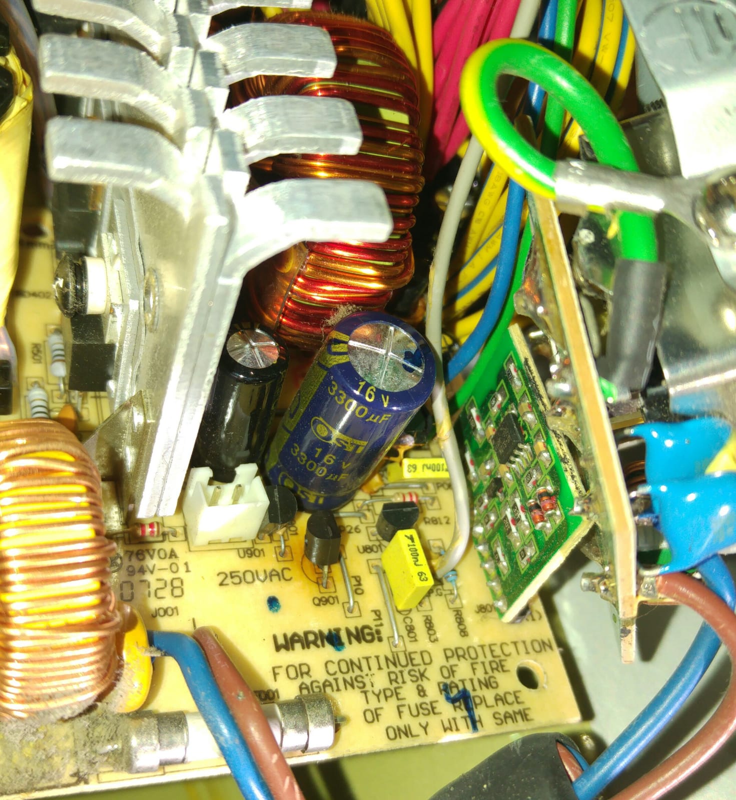

    Maybe that was the this one at the other end of the board?
    http://www.hardwaresecrets.com/fullimage.php?image=9108
    Picture from hardware secrets
    This is the end you want but I cant make it out - perhaps you can or you can
    compare it with the old caps you have?
    http://www.hardwaresecrets.com/imageview.php?image=9109

        Re: Antec Earthwatts EA-500 500w PSU
        Originally posted by selldoor
        Everall says his 3300uf was 16v??
        Yes that's the one on the 12 volt line (opposite end of PCB), this circuit employs a mix of...
        1000uF 10v
        1000uF 16v
        2200uF 10v
        3300uF 10v
        3300uF 16v
        330uF 400v
        In an effort to cut down on units ordered I used 16v rated (low ESR) units for all the 1000uF capacitors, using a DMM I was able to determine with 100% accuracy the 12v line (capacitor locations), so as I said earlier I'm down to the last 3 capacitors, the one the right is for the 5v line but it's the capacitance I'm looking to confirm on the left 2... although the picture pretty much confirms the larger 3300uF capacitor is behind the smaller 2200uF.

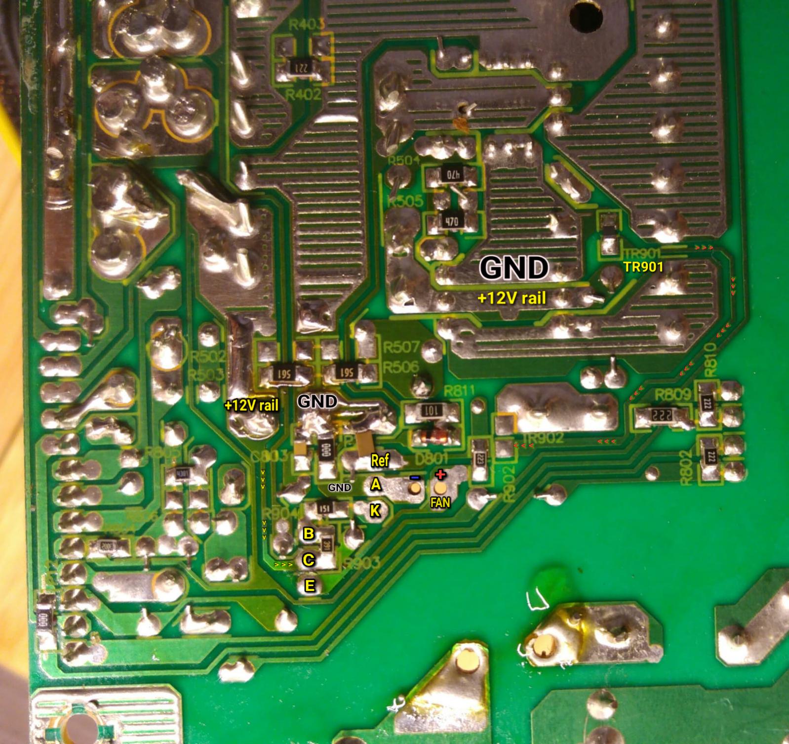

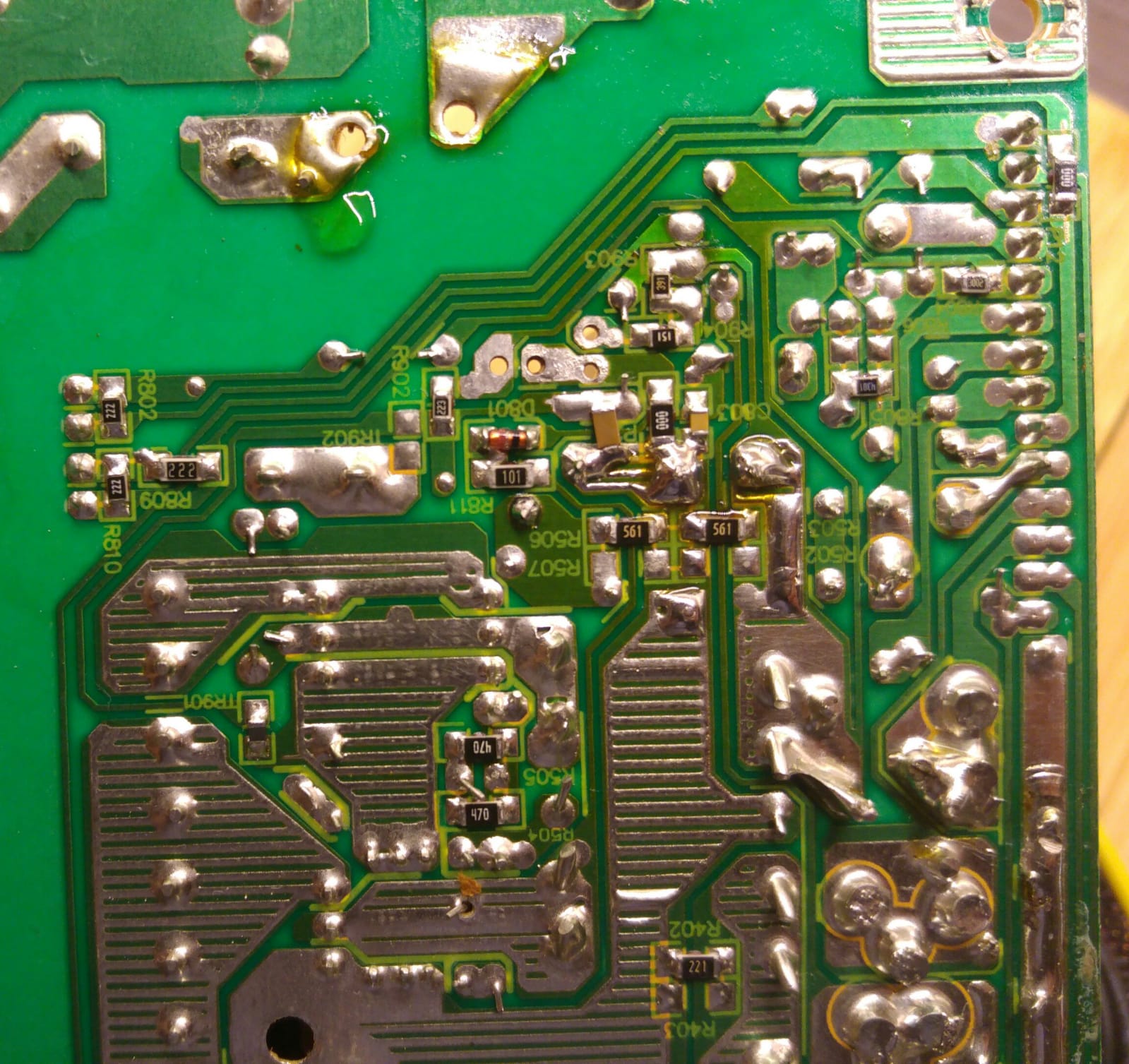

                              Originally posted by everell
                              So where is the heat sensor on the EA-500???????????
                              Did I miss something in the schematic?
                              HardwareSecrets (February 18, 2008)
                              << This power supply uses a semiconductor thermal sensor, which is very small and installed on the solder side of the printed circuit board, between the transformer and the +12 V rectifiers. This sensor is used to control the fan speed according to the power supply internal temperature. >>
                              https://www.hardwaresecrets.com/ante...pply-review/5/
                              I can confirm this. It seems it is a NTC.
                              On the PCB the code is TR901 and on my EA-500 PS has around 4.5k resistance at room temperature (it may be a false measurement because was not removed from the circuit).
                              So the speed of the FAN is controlled by the PCB temperature from that area.
                              I marked up main components on PCB side. I will try to complete the drawing developed by everell in post #8.
                              https://www.badcaps.net/forum/showpo...15&postcount=8

                                #35
                                Indeed it is.
                                And that NTC is connected to the same ground pad as the 12V rail's rectifiers. Since this is a more modern PSU meant for 12V-based PC, obviously the fan is made to be controlled by the rail that draws the most load... which is indeed the 12V rail. Hence the location of the NTC.

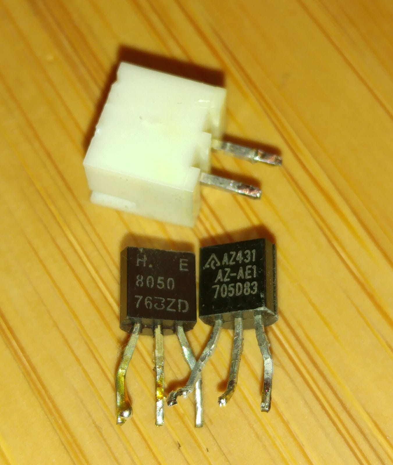

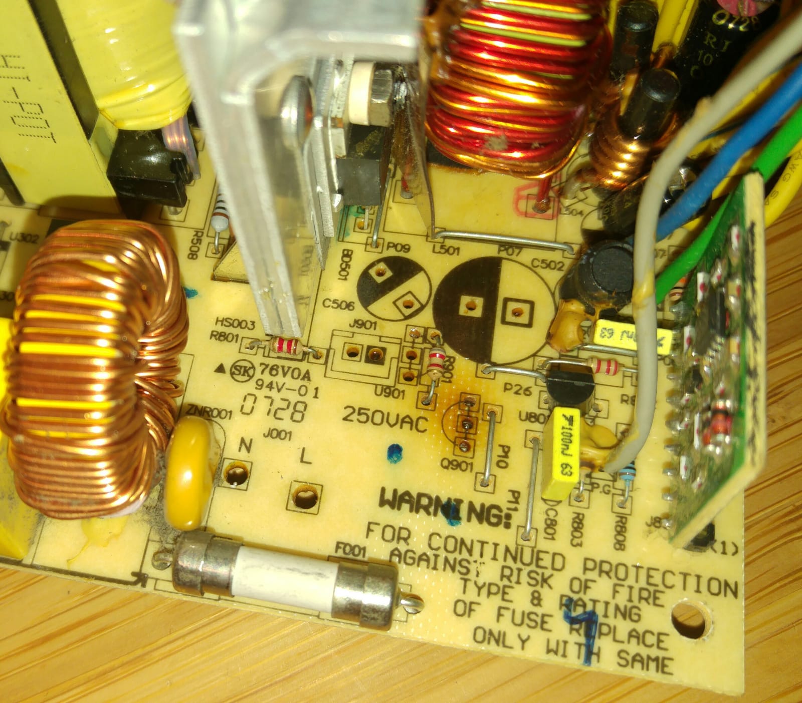

                                  I just had to open up my EA-500 because the fan wasn't spinning. I don't think the power supply was overheating, but I was pretty sure the fan used to spin all the time. I guess some intermittent fault happened in the transistor or its solder joints because it runs so hot. I replaced the transistor with a 2N3053, which is in a metal can case that can dissipate heat better. Now, a few comments about the circuit.
                                  The fan is obviously supposed to spin all the time. The 390 ohm and 150 ohm resistors connected to the transistor base form a voltage divider, so even if the AZ431 tries to pull the base down there is sufficient voltage to spin the fan. (If you want to calculate voltages, consider effects of base current, Vbe, and how the AZ431 can't pull its cathode all the way to ground.)
                                  The Vref terminal and the combination of thermistor and resistors there determine the transition from low to high speed. Both the slope and where the speedup starts can be altered there. I suggest playing with it in a circuit simulator like LTspice if you want to examine changes. Note that R901 connects Vref to +12 V and there's also a 22 kohm surface mount resistor (labelled 223) which connects to fan positive voltage.
                                  The general intent of the design seems to be that the fan usually spins at a low, quiet, constant speed, as determined by the resistors connected to transistor base. It speeds up with a steep slope if the thermistor area gets very hot. So probably during normal usage you'll only see the low constant speed. At https://www.jonnyguru.com/blog/2007/...ower-supply/2/ you can see that the fan was not audible until 415.9W and reached full speed 517.5W, both in the hot box.
                                  Before I fully understood the circuit I made the mistake of adding a 2.4 kohm resistor from Vref to ground to speed up the constant speed a bit. But that meant the ramp to full speed happened just above ambient, and after a few minutes there was an annoying loud hum from the fan spinning fast. Right now it's running with no modifications except the transistor replacement.

                                        I'm currentlly in the process of trying my first power supply repair (really my first soldering project) and have some questions with regard to which capacitors to replace the bad ones.
                                        The power supply is an Antec Smart Power SL300S ATX12V 300 watt.
                                        I have successfully desoldered every capacitor from the board without destroying anything (I think) and I am currently in the process of choosing which caps to order. This is where I'd like a little community wisdom.
                                        Now the capacitors inside are mostly Fuhjyyus (a forum favorite) with 1...
