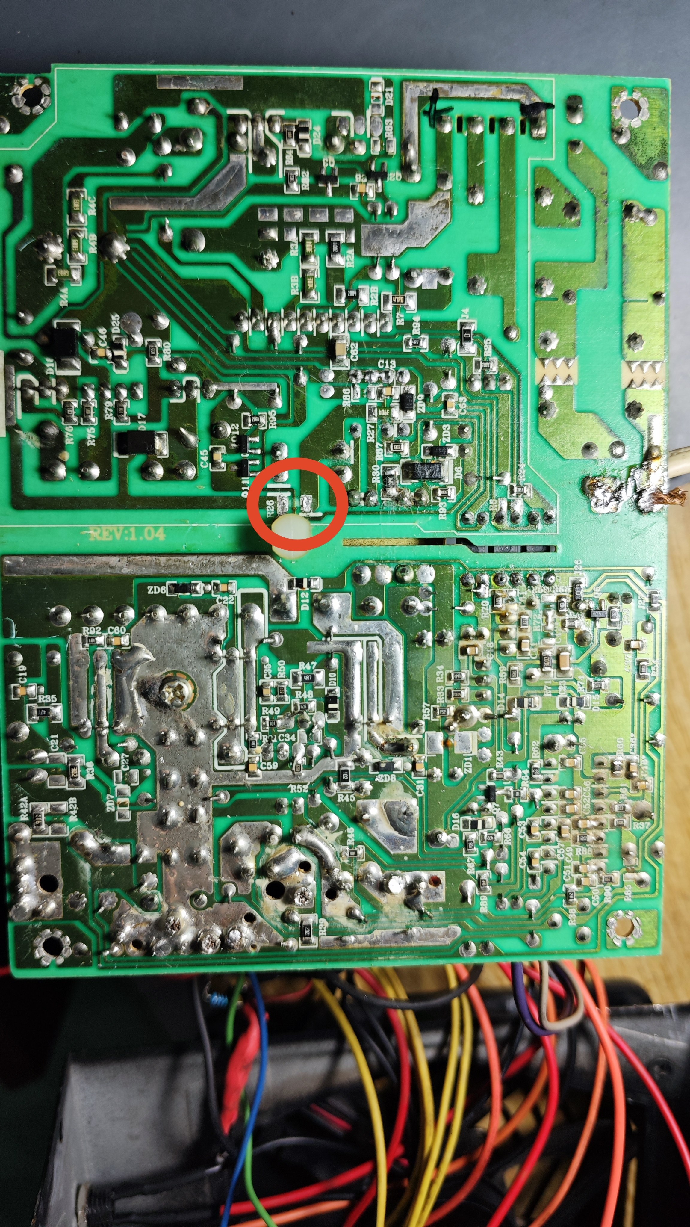

    My ATX FSP HEXA 500W was broken, lost 5vol stand by , ic TNY 277PN is broken, and R26, but i dont know what is R26. Help me

    It looks like R26 is connected between the main filter capacitor positive and the Drain of the tny277pn, so it is likely a low resistance like 1 Ohm or less that is acting like a fuse.

      Thanks, i think so, but i am scared to use low resistor, can it explode ?

        Already posted the answer in this thread here:
        https://www.badcaps.net/forum/troubl...0w#post3654312
        TLDR (if link doesn't work for whatever reason): it's a 2 -Ohm fusible resistor. Use metal film type. Probably 1/2 Watt rating or more. Can use through-hole instead of SMD if that's all you have.
        I don't think the resistance rating is too important, though. Probably anything in the range of 1 to 4.7 Ohms will work, I think.
