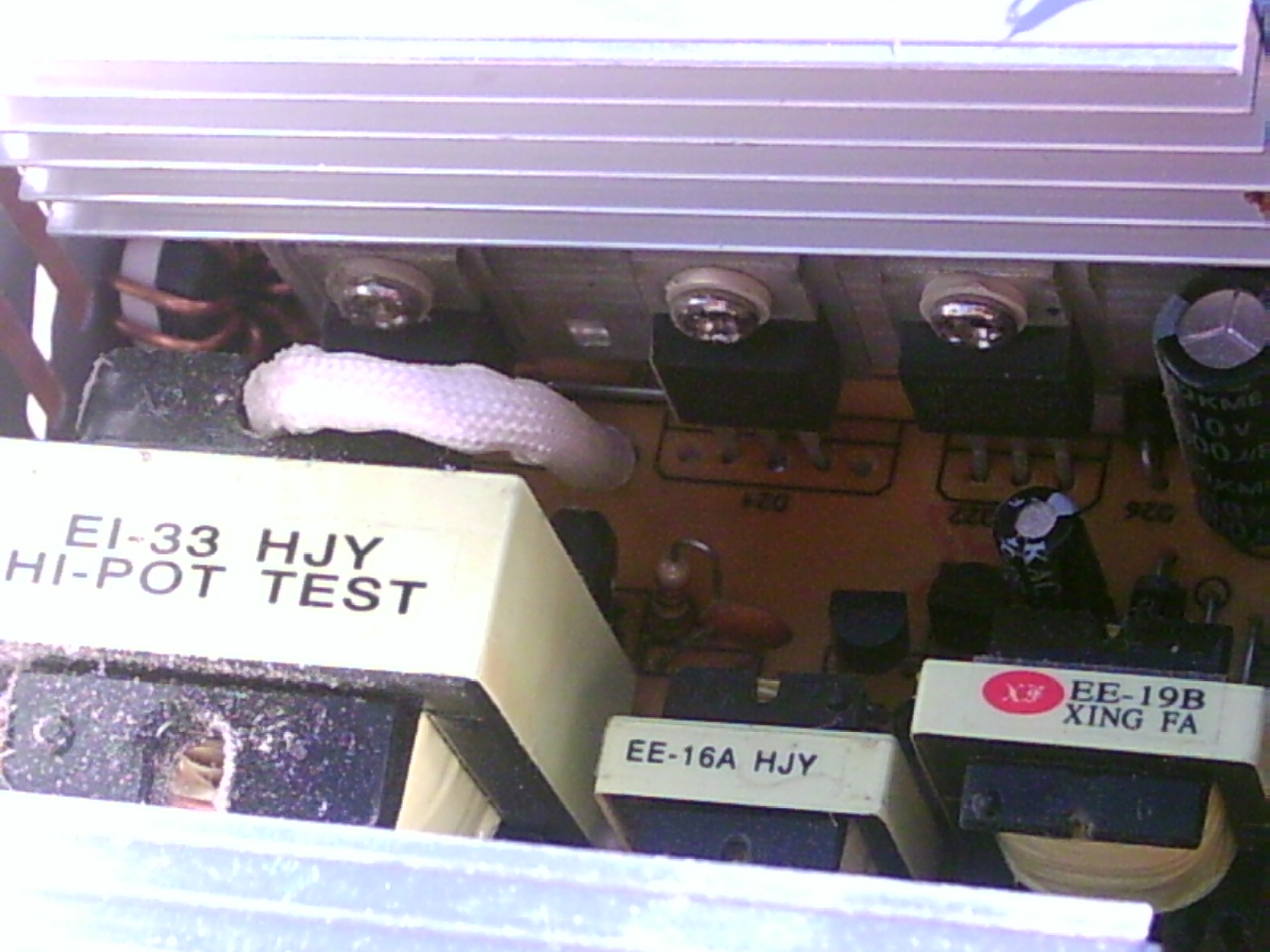

    I recently collected enough components to build yet another A64 PC, the only items retained were the PSU & case (offerings from Honli), after sorting out a dud DDR stick the system has run happily till yesterday when it began shutting down (of it's own accord)
    System Specifications
    Athlon64 3000+ s754
    Asus K8V/X-SE
    512Mb Transcend DDR-333 (limited manually in BIOS)
    Geforce4 Ti4200 64Mb
    LG CD/RW
    Generic 40x CD-rom
    80Gb IDE
    Realtek 10/100 NIC
    4 x USB expansion card

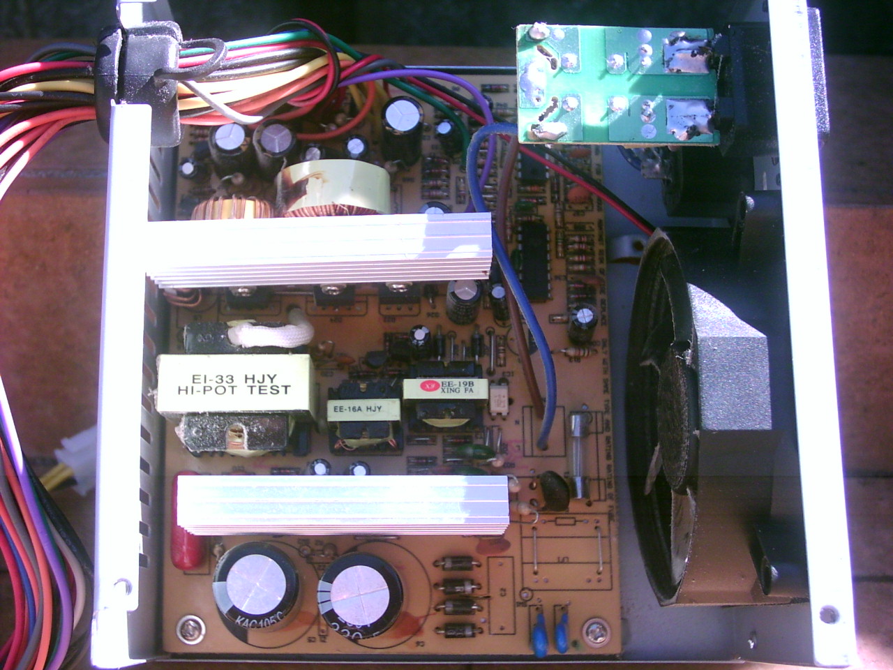

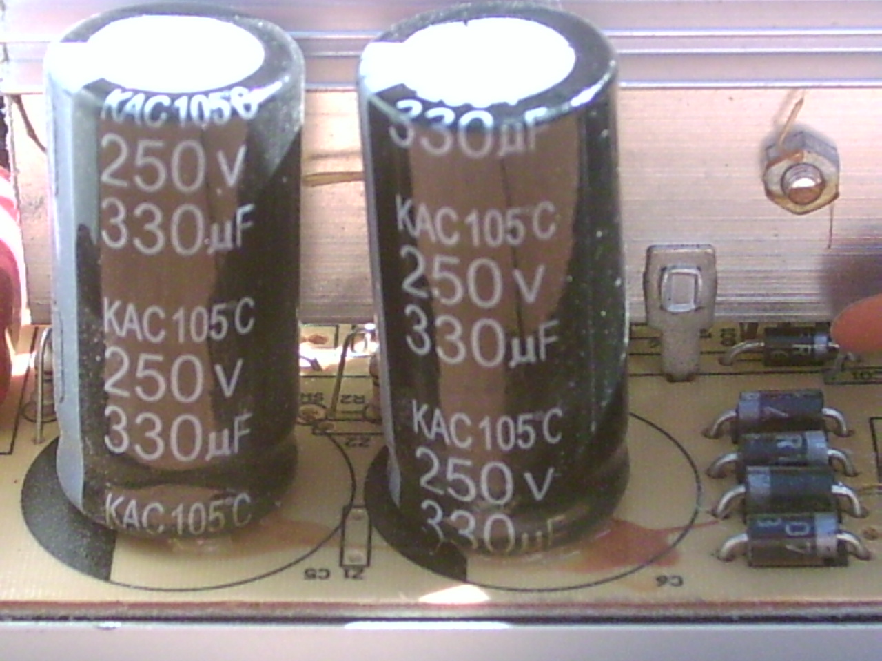

    Now to get it to attempt a power up, I needed to pull the AC mains cord out & reattach, powering up has really been a hit 'n' miss affair, with the BIOS hardware monitoring feature indicating a 11.985 ~ 12.305v fluctuating variance, with all other voltages remaining within 10% -/+ of tolerance, my trusty UNI-T multimeter is showing a variance but only of 12.06 ~ 12.32v measured @ the P4 motherboard connector.
    So far the symptoms seem to indicate poor capacitance somewhere and as the motherboard is a brand-spanking-new Asus K8V/X - SE populated with what appear to be Panasonics, Rubycons & KZG caps... I'm leaning towards this being a PSU issue (despite the apparent perfect [see below] appearance of the caps )

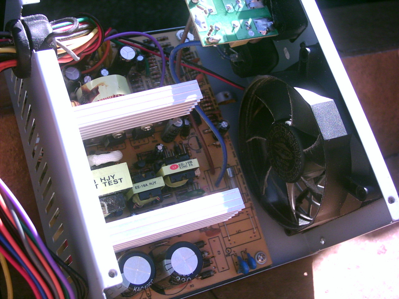

    Additionally, are those input capacitors (2 x KAC 250v 330uF) enough for a supposed 480w PSU? even the 'sinks' look a little light on in the mass dept. especially when compared to either my 430w Antec or 550w Codegen PSU's, would replacing them with my spare pair of Rubycons @ 250v 470uF have any real world benefit?
    Any feedback would be appreciated, I know virtually zip about this PSU's specifications let alone whether it has any PFC componentry, I'm in a little over my head when it comes to PSU design/function/layout though I can identify most of the components
    Thanks in advance!

    Re: Honli 480w PSU?.. yeah sure it is!
    It's crap. 250W PSUs use 330uF caps. Better 300W PSUs use 680uF... This is no way 480W.

        yeah caps....Humm well from my way NOT Expert opinion I cant see why not if you really want to put the rubys in
        but as has been pointed out here the bridge rectifier or diodes used will be under more current stress, as in higher peak current as the caps charge
        it is after all just an anolgue psu at the front mains end...
        (yeah ok a bit more to it now days)
        So you might want to check the diode specs,
        In short just a slightly bigger bucket for the psu to pull from which itsn't such a bad idea...I think anyway
        I would be looking for possible dry joints, I would check all the caps/replace around the chip too
        Resistors do fail or go high and even if they look ok

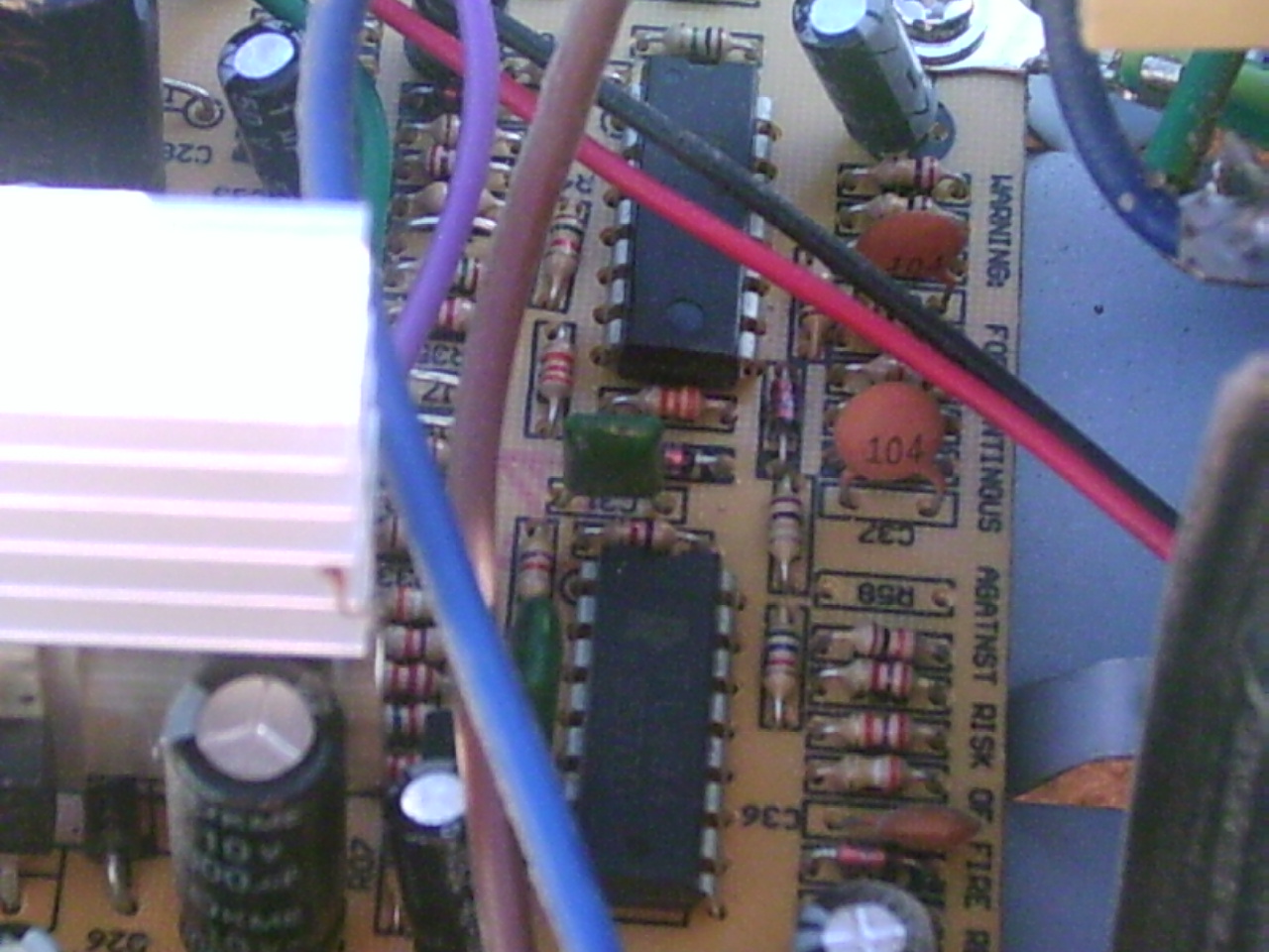

        From your pics it looks to be the standard type el cheapo that they throw half the components away with but not the expert on this
        Maybe check Pete S and the others FAQ's on it
        This link although a bit older psu may give you some ideas
        here
        Anyway sure some of the more experienced will give you better info
        Cheers mate...... not of much help I know
        Looks like its a TL494 controller chip but hard to tell

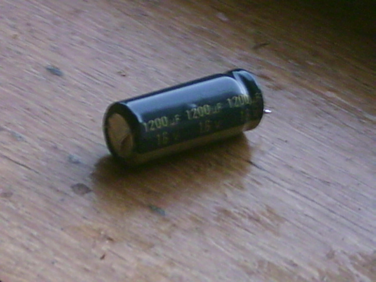

          Yes I agree it's a steaming pile of processed foodstuff! but will upgrading the twin input caps increase performance, reliability, voltage stability etc? currently it's holding steady on 12.31v @ idle & 12.13v @ 100% load
          I replaced the 1000uF KAC's with some SamXon 1200uF 10v's & a panasonic 1200uF 16v I had lying around... actually I killed one of the panny's as I was domestically distracted briefly, installing it reversed to it's polarity so during the power up test it went BOOM! (see pic below)
          Stuff this...
          During bench testing the PC rebooted... so in went the (formerly recapped) Antec TruePower380w... the difference was immediately obvious, 12.07v idle ~ 12.04v 100% load!
          Back to running Prime95!

            If a PSu has Sb power up problems, from my experience the 1000uF KAC's if there are the first i replace.
            In many cases, this fixed all the problems. (but anyway, i usuak´lly changed both KAC).
            My theory is, that the Topswitch will have problems to regulate it`s output voltage, thus it permanently keeps traped in an power on off loop (powering on, voltage to high or other problems due to to high ESR of first pi filter cap, shuting down and again).
            Most PSu take the Vdd for the SMPS controler IC from the 5v Sb line. Thus the psu won`t start up.
            Those KAC caps are very common in many psu, not only from the grey market vendors (e.g. Seasonic OEM SS300Fs -SS400FS, LC-Power nearly all series, etc.).

              If it's an EI-33 main transformer, it's not likely to be over 150W-180W max. - this unit is similar to a Deer or Powmax variant.
              You can probably use it in a non-critical P1/P2 class machine after upgrading all the large secondary caps. The primary caps don't usually fail - there's not too much point in upgrading them, and it sometimes makes things worse, because the power factor worsens with a large capacitive load and higher peak/inrush currents may trigger overload shutdown on a UPS.

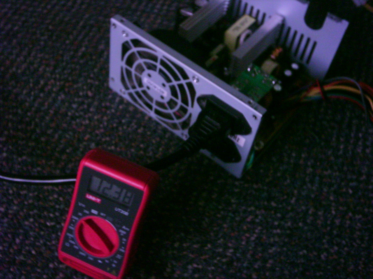

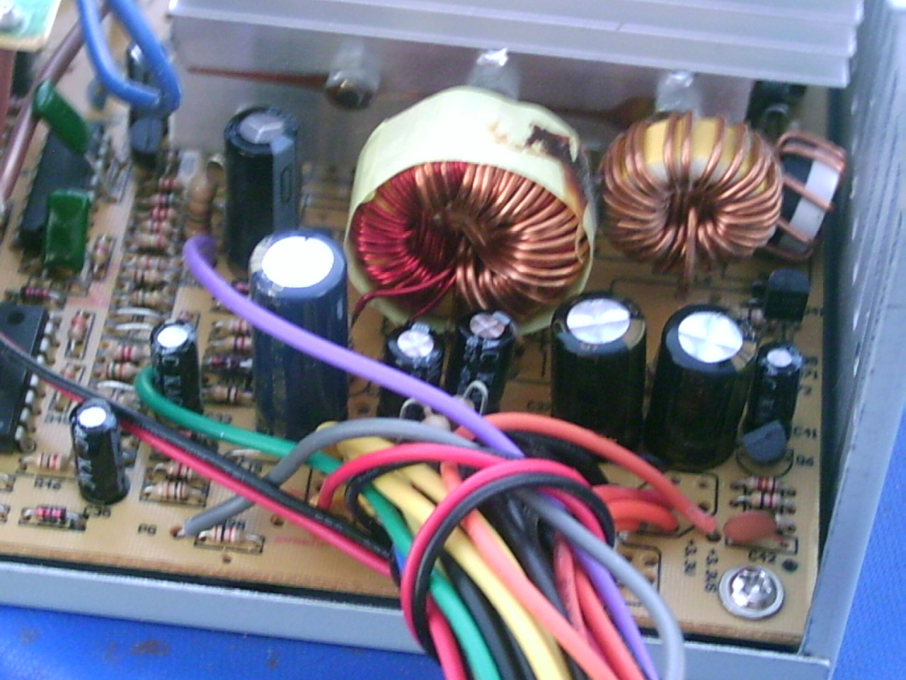

                Thanks for all the technical information, but I have yet another question now... sitting out of the case (powered up) it hovers on 12.38v or there abouts, but once I fitted it into my RAID0 server the 12v line exceeded 13.0v at times, what gives with that? is it because I used 1200uF capacitors in place of the original 1000uF units? or because the previous system power requirements dragged the guts out of it?
                I think I'll just 'gut' this PSU for it's fan & connectors (reclaiming my capacitors too!) 13.0v is just a little too high for my liking
                  Probably means that the +5v is overloaded, dropping it to (say) +4.5v. The regulation loop will compensate by increasing the +12v - the cross-regulation is usually not very good on these units.
                  The other possibility is that the rectifier on +12v is on its way out - these are usually a pair of FR302 3A units, but run at higher currents (and forward drops) than the rated maximum. One or both may eventually short out on high loads.
