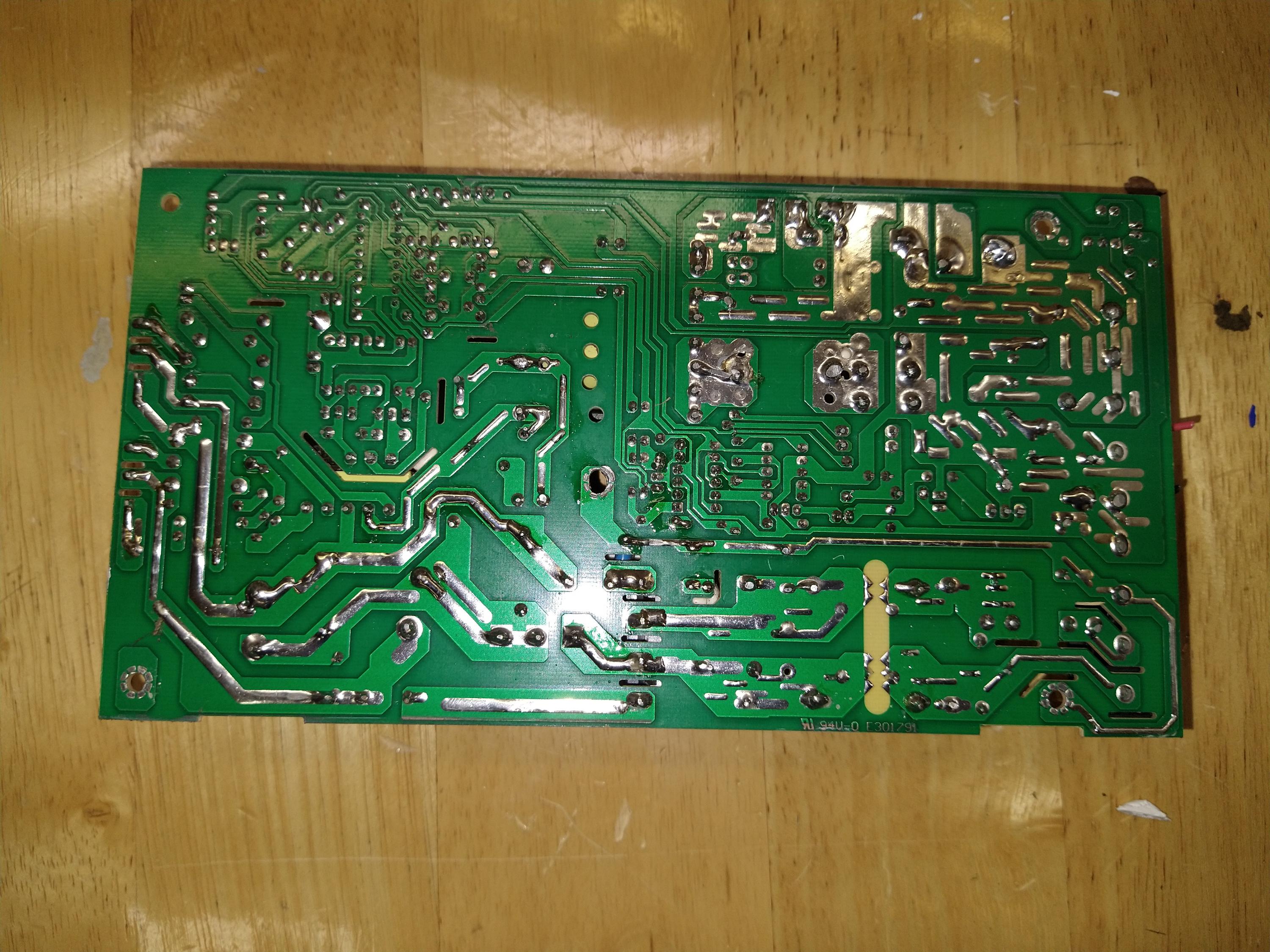

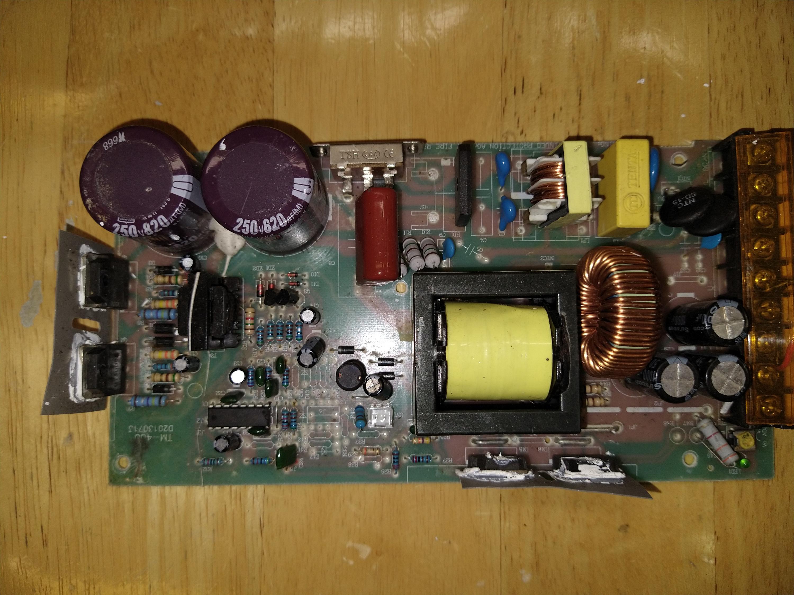

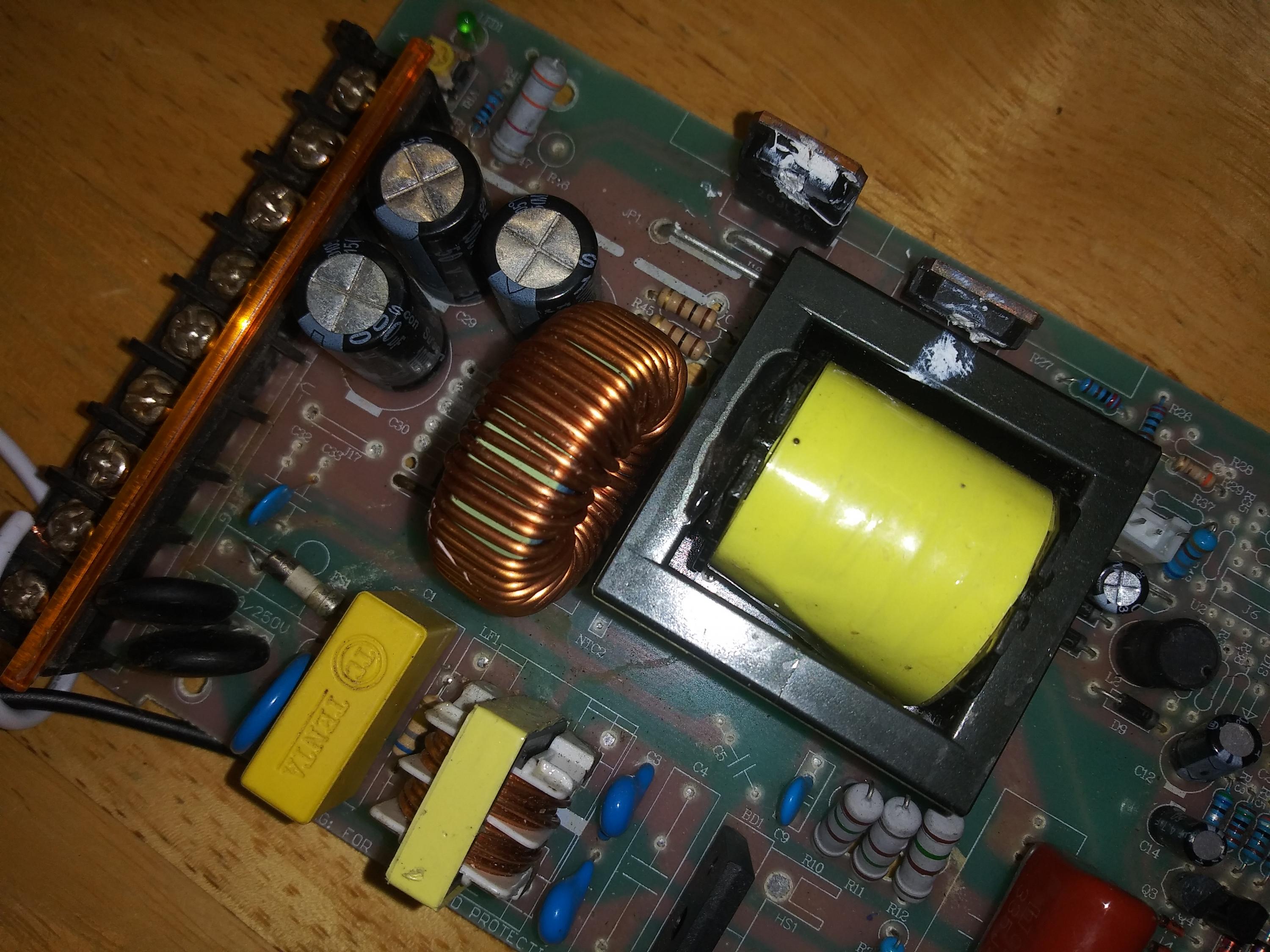

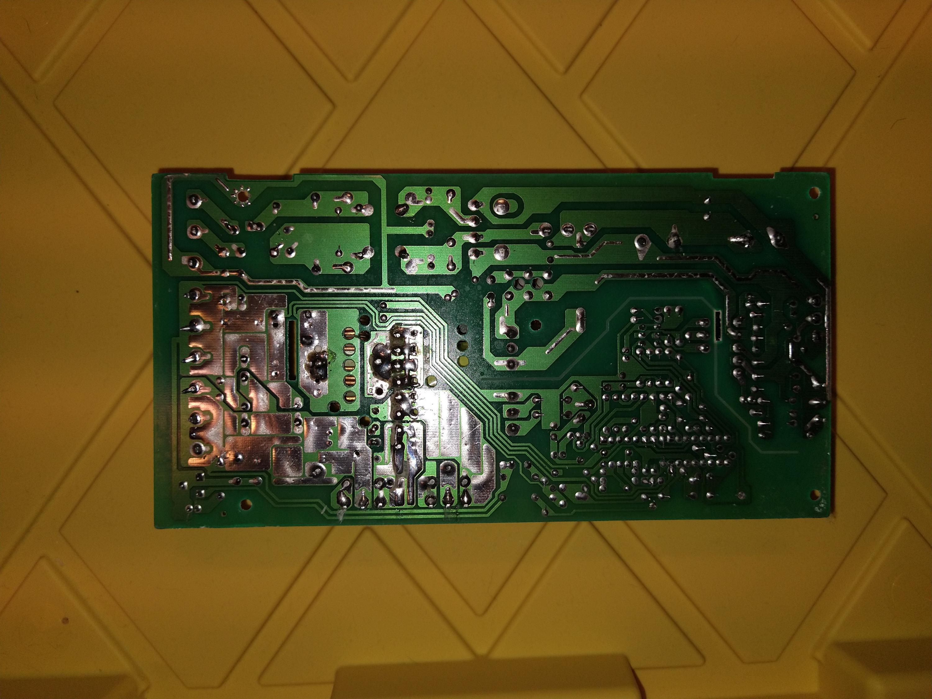

    Hello again, this might be a bit of a far-fetched question, but is it possible to modify a 36v and a 48v power supplies to output 12v? Both power supplies appear to use the same topology, they both also have a dedicated 12v winding wired to the control chips, meaning that as soon as i change it so the main output is 12v, then the dedicated windings will not be able to output 12v, meaning it will not start up. However, if i were to then take the main output and tie it to where the dedicated 12v output would go, then it should be able to run fine?
    Anyway here is a quick overview of both PSUs, the first PSU is a Genssi model S-350-36 rated 36V, 9.7A.
    The main switching transistors are two J13009
    The primary capacitors are two real-looking NCC CE 680uf, 230v
    The control chip is a TL494CN with a LM358 op-amp
    The secondary rectifier is a ESAD92-02S
    The (main) secondary capacitors are two Samyong NHA 2200uf, 50v
    The 12v secondary capacitors is one Tocon 47uf, 50v, and one NCC KY 4.7uf, 50v

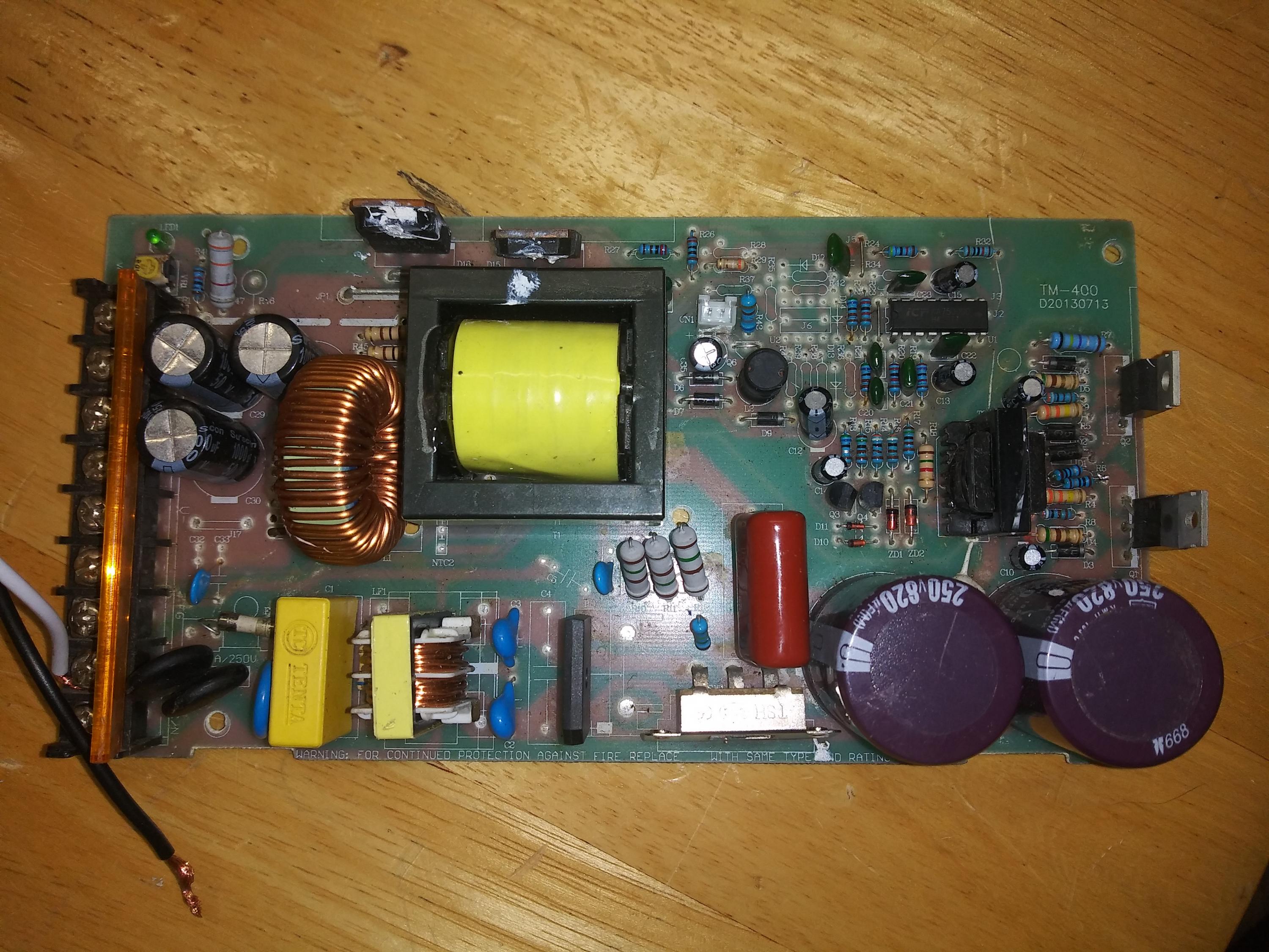

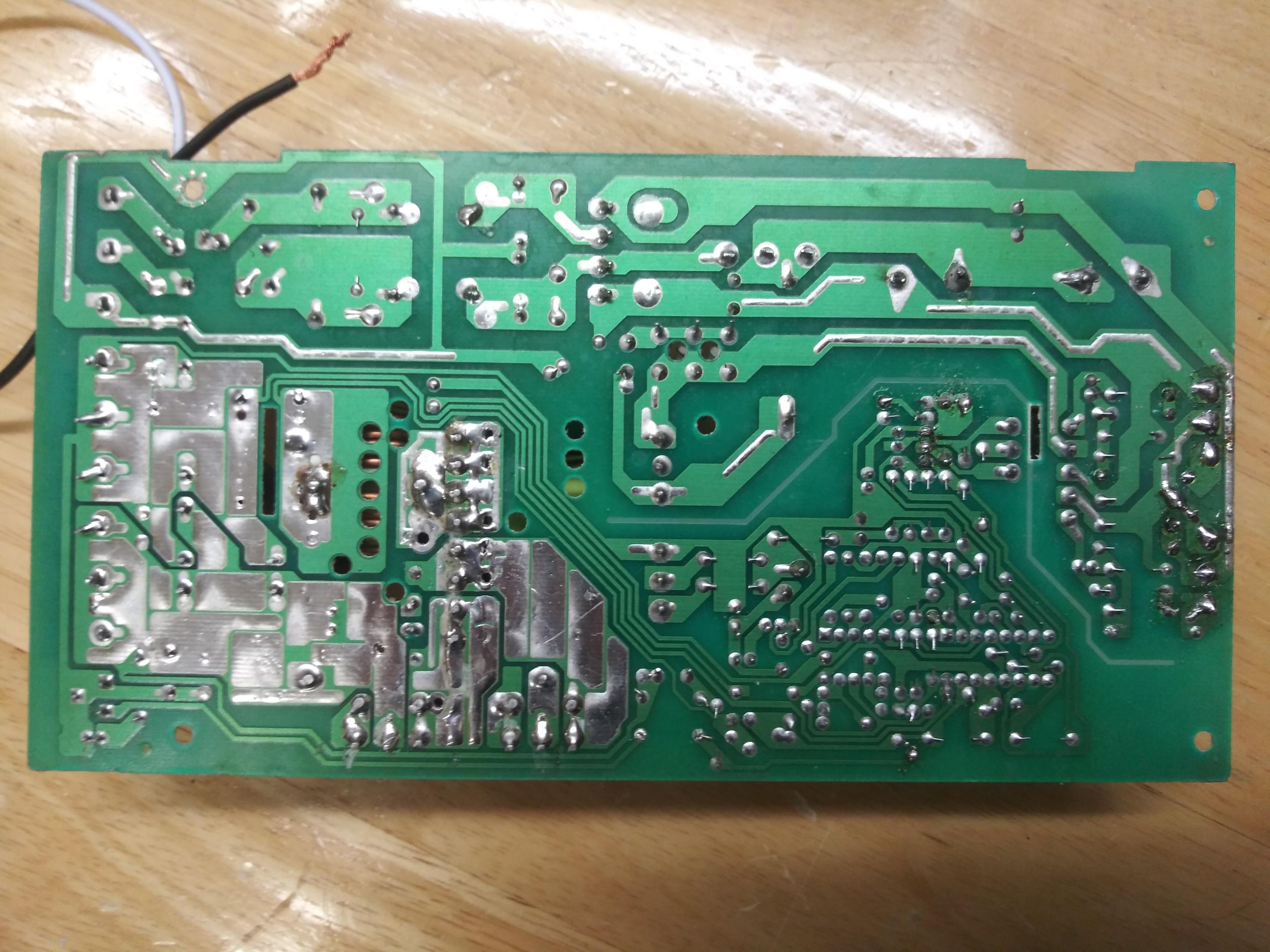

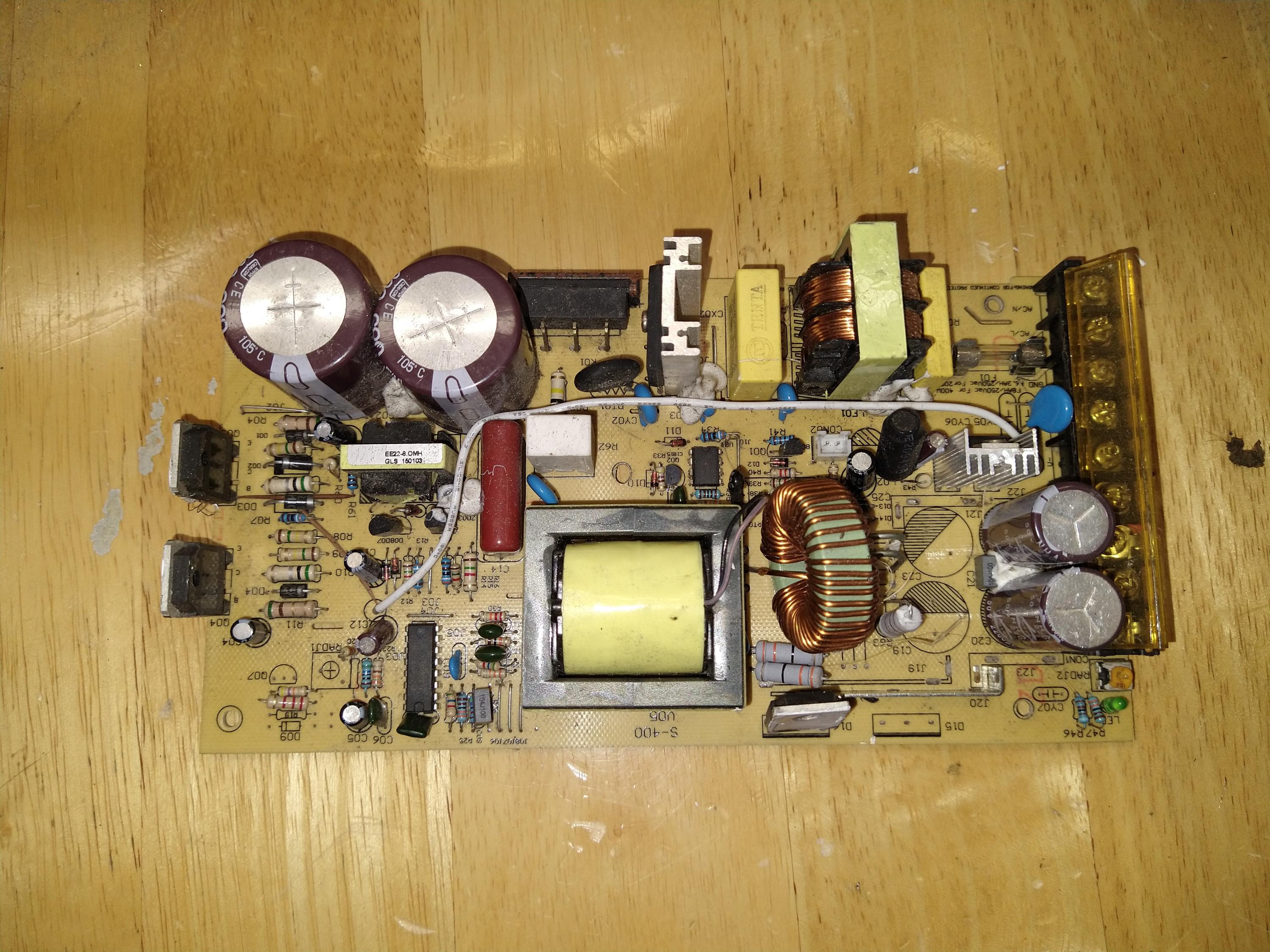

    And the second PSU is a Generic, model T-500-48, rated 48v, 10.5A, but it might be slightly overrated.
    The switching transistors are two D13009K
    The primary capacitors are two fake-looking NCC KMH 820uf 250v (they have a butterfly in the datecode, do i need to say more)
    The control chip is a KA7500BD
    The secondary rectifiers are 2 20JL2C
    The (main) secondary capacitors are three Su'scon SK 1000uf, 50v
    The 12v secondary capacitor is a yw 100uf, 35v
    Any help will be appreciated. And if anyone is wondering why i need two high current 12 PSUs, the reason involves a lot of 12v LED strips.
    And if 12v is too far-fetched, then would 24v work? I can still find most of the parts i need in that voltage.

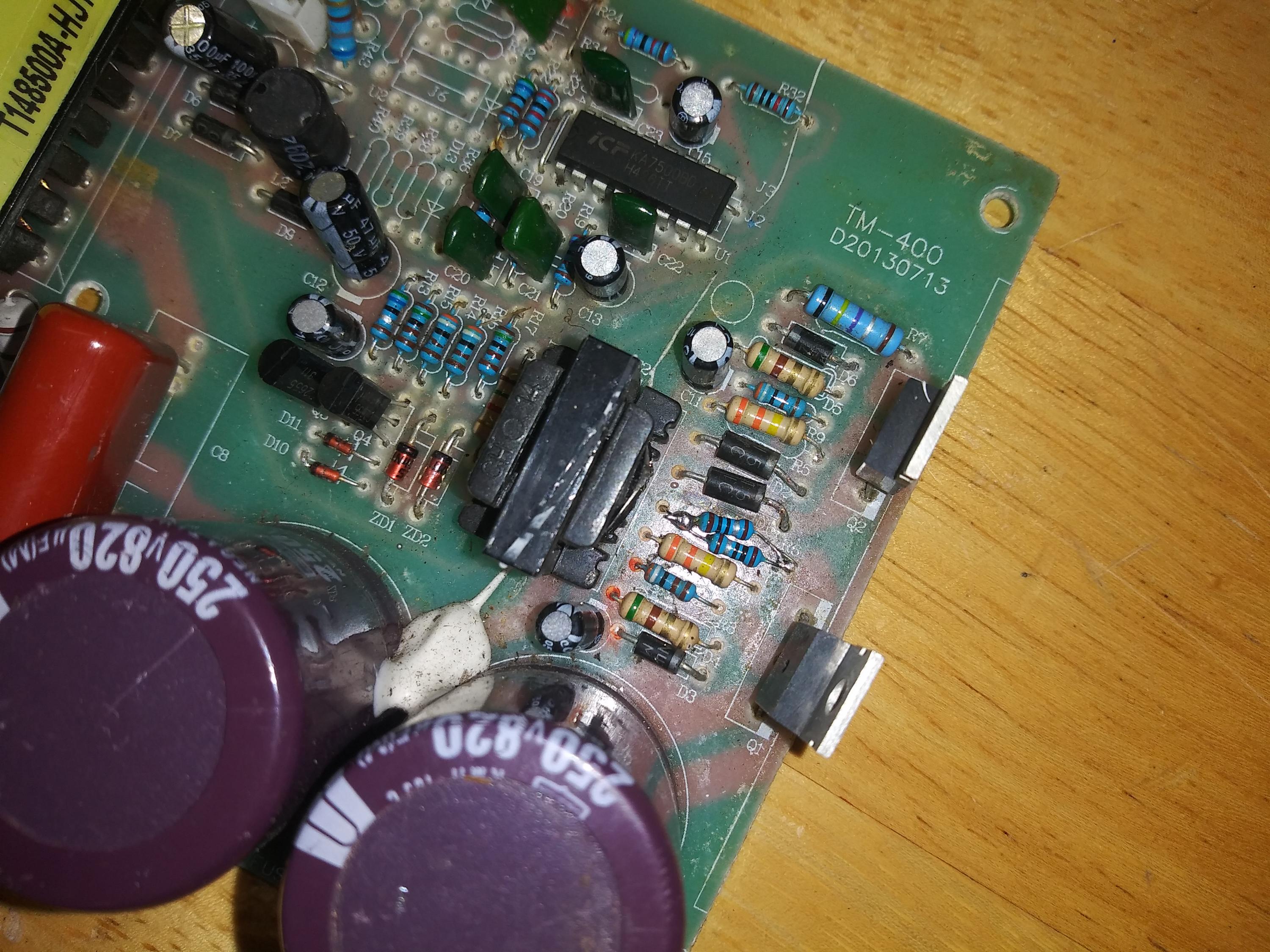

                    So i decided to troubleshoot the 48v PSU a bit more today, and found a dead .47 ohm resistor, so i replaced it with what i had on hand, and now the PSU tries to turn on, but is unable to. The main output manages to hover up to 32v after 15 seconds and the aux output sticks around 2.5v.
                    At this point, i've tested most of the componets between the transistors and the PWM IC, and so i'm starting to think the IC is bad.
                    I'm not sure if i should spit this off into its own thread, but i can do that if necessary.

                      I guess pictures of the PSUs are already here, so we might as well continue. Though on that note, the pictures of the 48V PSU are a little blurry and the solder-side one a little too dark to be able to trace paths. Might need better pictures, if possible.

                        Re: Modding Two PSUs to Output 12V
                        Sorry it's been a while, i did not have a lot of time last week for working on this, and when i finally did, my 2 1/2 month old phone, which i use for taking photos, bricked itself.
                        Anyway, the resistor i replaced was R6, and i replaced it with two 1 ohm resistors in parallel.
                        The secondary transistors and diodes all appear to be in good shape, so i'm not really sure what to check next.
                          "Appear"? Or did you really pull them out and check?
                          If you didn't, remove diodes D10, D11, ZD1, and ZD2 and test them out of circuit on diode test mode. They should conduct one way but not the other. For the Zener diodes, it's even recommended to put a 10k resistor in series with the out of circuit and apply a high-enough voltage (I imagine up to 30V will do) to see what their reverse voltage is. Most likely it should match - especially if they have matching part numbers.
                          Also remove the two TO-92L transistors there - that is Q3(?) and Q4. These are probably NPN BJTs, so again check them for proper diode drops on the BE and BC junctions. They could be open-circuit or partially shorted. All those small resistors in the viscinity of the above diodes and transistors should be checked too. If anything tests off, remove from circuit and test again.
                          Since R6 was open, you need to remove both primary-side BJTs and check them for open-circuit between the BE and BC junctions. Can't do it in circuit - the protection diodes and primary caps will mess with the readings, along with the drive circuit. After you do this, proceed to test all of the resistors close to R6 too. It looks like the PWM controller is working if the PSU is able to pump out any voltage, so most likely that's not the problem. However, if all of the above parts do check out fine, then I guess just swap that PWM controller with another 7500 or 494 part (doesn't matter which - they are pin-compatible) and see if that fixes it.
                          On a different note, I don't see any other small BJTs or protection ICs on the secondary side, so I'm not sure if this PSU even has any protection circuits - certainly no OV and UV, I bet. SC might just be implemented in the form of limiting from the driver transformer... which is far from optimal. Ugh, this is why I dislike these cheapo Chinese designs - can never tell how many corners they cut too much.
