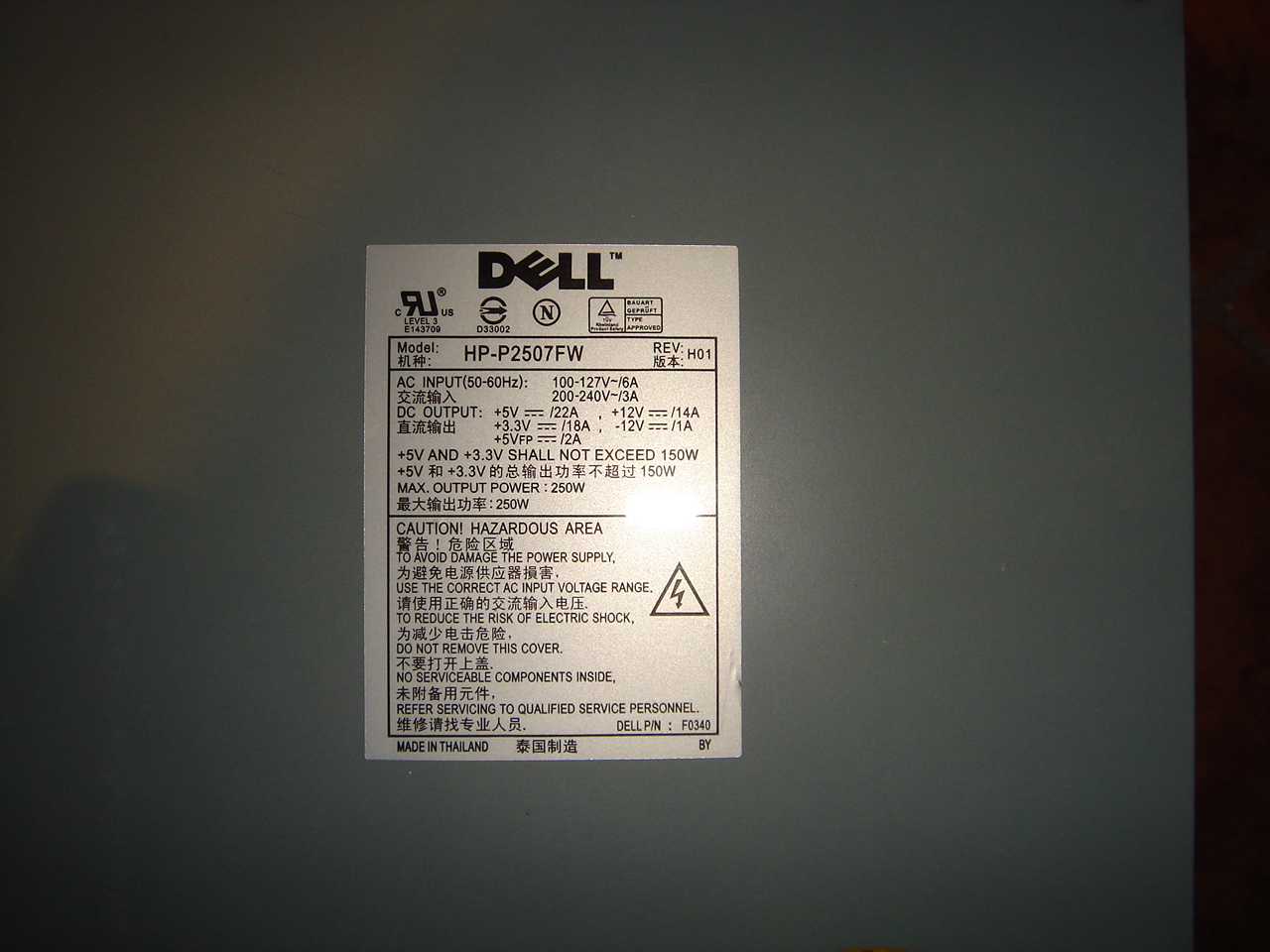

        • stevo1210
          • Oct 2006
          • 4156
          Re: faulty power supply?
          Thanks linuxguru for the quick response,
          Is there some way i can tell if they are Hipro OEM etc.?
          I was wondering since I bought a Dell one for another PC a while back and it had small Ltec caps in it and two big Nichicon caps, as i could see through the vents, but it is still running fine and i havent bothered to recap it since the caps will probably cost more than the $10 the PSU itself cost.
          Thanks.
          Don't find love, let love find you. That's why its called falling in love, because you don't force yourself to fall, you just fall. - Anonymous
          • linuxguru
            • Apr 2005
            • 1564
            I haven't seen an LTEC failure yet, and they're used even by Tier 1 OEMs like AcBel, so I guess the PSU will be OK. However, for added insurance, I generally recap a used PSU before use, except Delta OEM PSUs.
            Delta and AcBel OEM PSUs will be badged accordingly. Hipro is sometimes not badged, but will have a FRU number beginning with HPxx. Sometimes, there will be a custom analog ASIC PWM controller inside Hipro PSUs, with a part number like HP1001 or similar.

                  I gave up on that Deer power supply.... it's probably too crap to even fix up.
                  Instead i purchased a second hand Dell 250W power supply. It's been running flawlessly so far and best of all i cant even hear the fan running.... i can see it spin but i can't hear it, which is great....

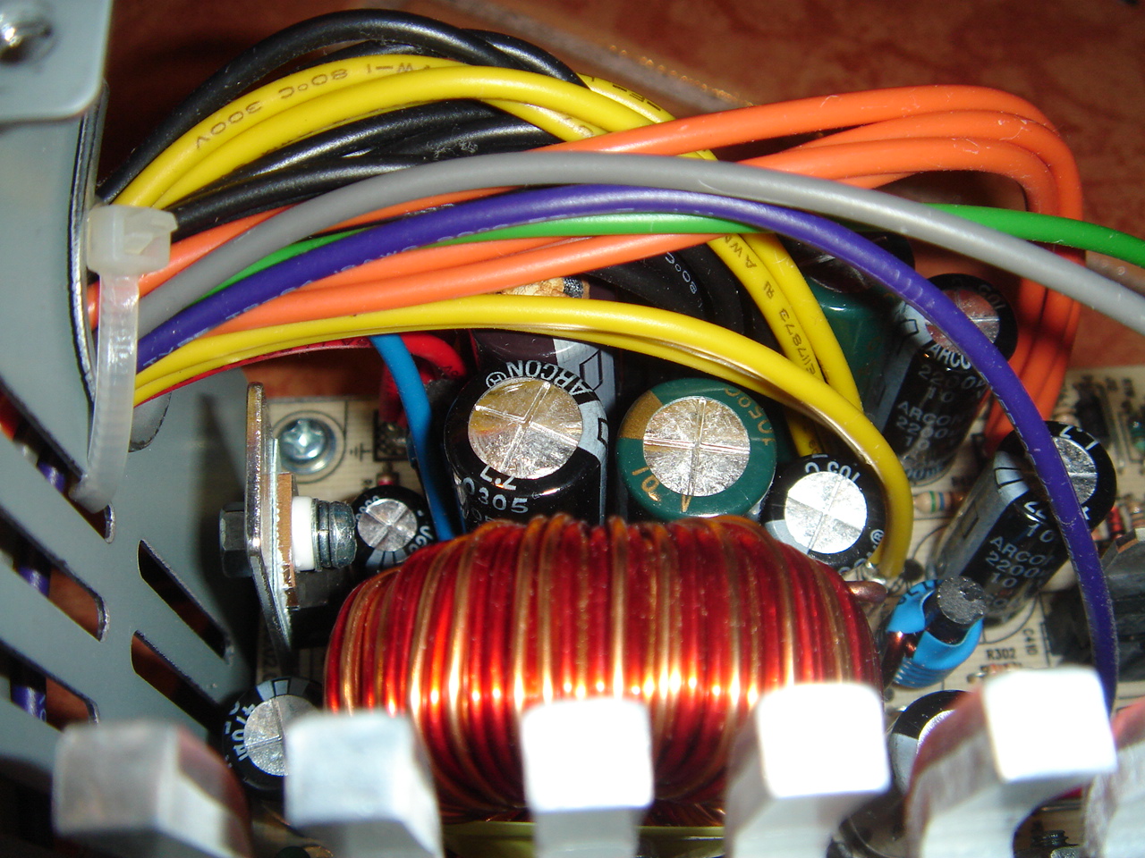

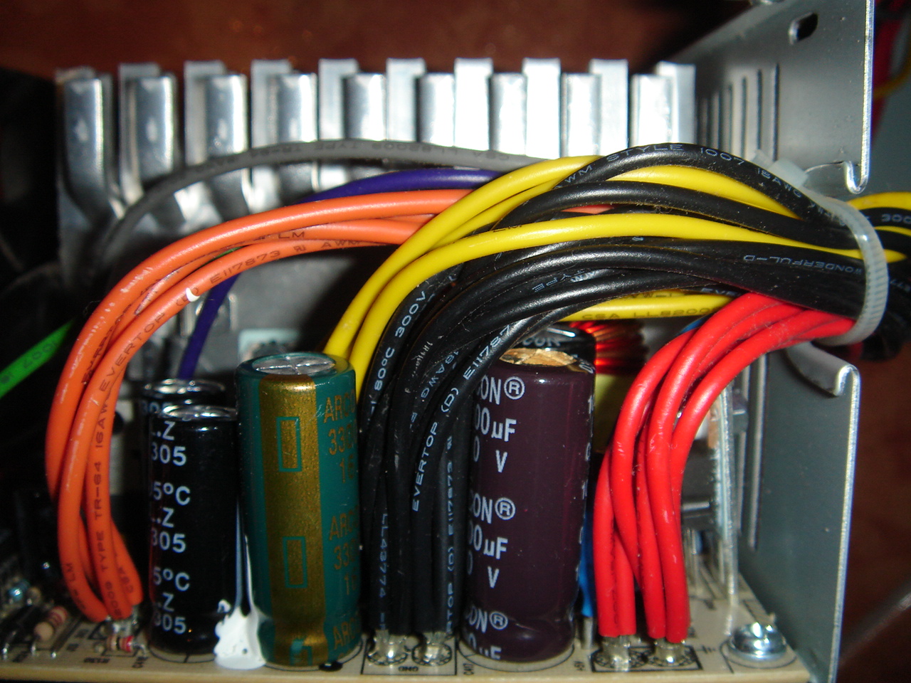

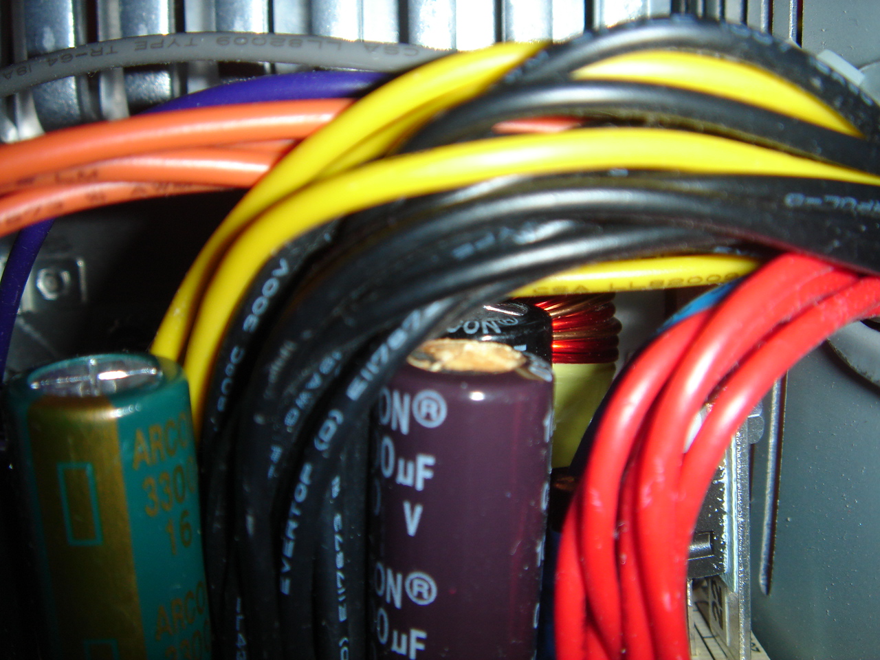

                        >it is a Hipro OEM unit.... and I actually found bulging and leaking Arcon caps in the PSU.... they were 3300uf 10V 12.5mm caps. I have some Hitano EXR series 3300uf 10V caps ready here for recapping
                        Nichicon PW(M) or NCC LXZ 3300uF/10v/12.5mm are near perfect lifetime replacements for the +5v and +3.3v rails. I found Nichicon PW(M) 3300uF/16v/12.5mm and NCC LXF 2200uF/16v/12.5mm for the +12v rail. In a pinch, you can use the Panasonic FF 2200uF/16v/12.5mm for the +12v rail. You can also use a Panasonic FJ 1800uF/16v/10mm or an NCC 1500uF/16v/10mm for the +12v rail in one of the locations which has a 10mm footprint.
                        >but the only problem are the two Panasonic 250V 470uf caps.... Does anyone have any ideas to discharge these caps so I can work safely when recapping this PSU??
                        They should discharge in-circuit in a minute or less, provided the discharge resistors next to them are intact. You can use a 10k, 5W wirewound resistor with the leads bent suitably to discharge each cap in turn, if you're not sure. The RC time constant is ~5 secs, so about 30 secs should be enough to discharge it to a safe voltage.

                          Here are some images of the Arcon caps if that helps at all.
                          Thanks.
