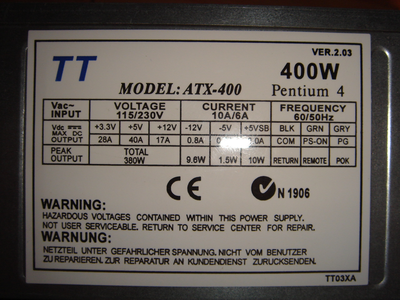

    Hello Everyone,
    I have a generic power supply which is supposedly rated at 400W but i doubt it. Well it works fine, apart from high fan noises, but theres this issue with radio distorsion? when i turn on my radio, i can hear something like a buzzing noise, which is loud and also annoying, especially when im listening to a talk show if i turn off the PC, it goes away.
    The caps are all fine, but has anyone got any ideas to what is causing this? Faulty transformer maybe? My father reckons that the manufacturer probably snitched some copper wire from the transformer to save money (not sure there) so it's causing this distortion. Though he may be right since it gets pretty hot when in use. Anyone got ideas to whats wrong? I have 2 Power units with the same issue, both different brands, theres this "TT" brand 400W PSU and an "N.S" 250W Power supply with the same noise across radio issue.
    Thanks.

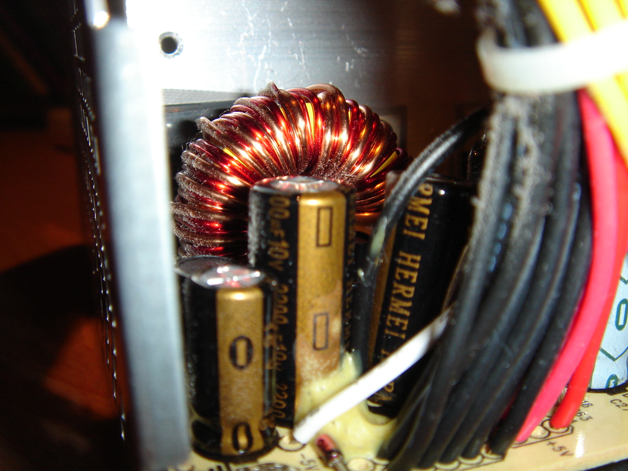

                I got some bad news.... i found Hermei and Koshin caps in there?!

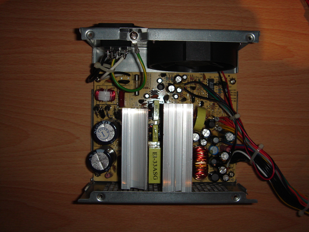

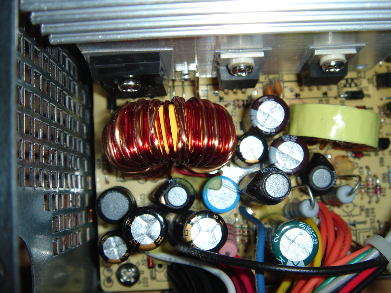

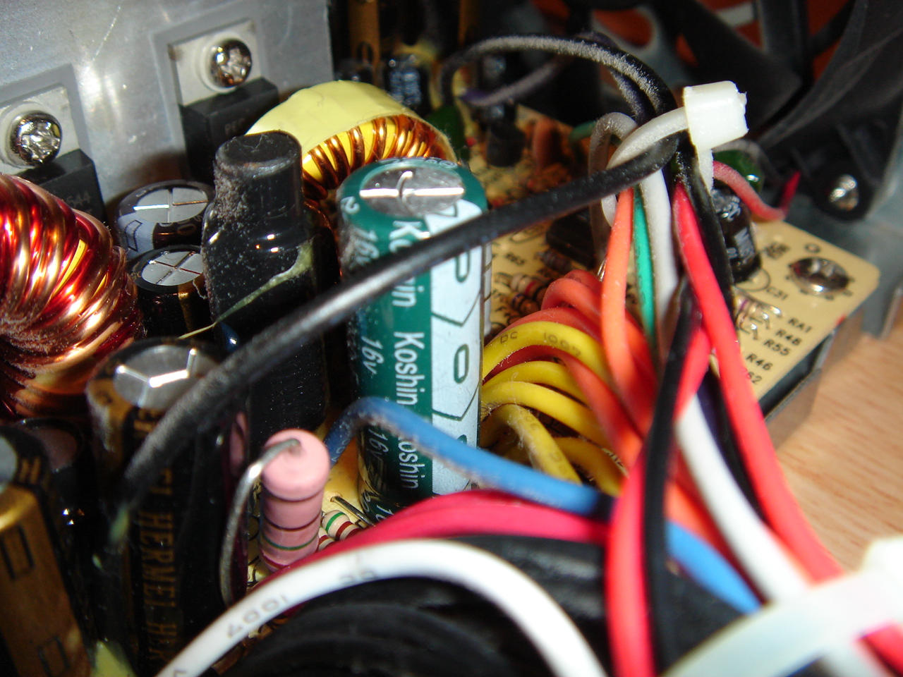

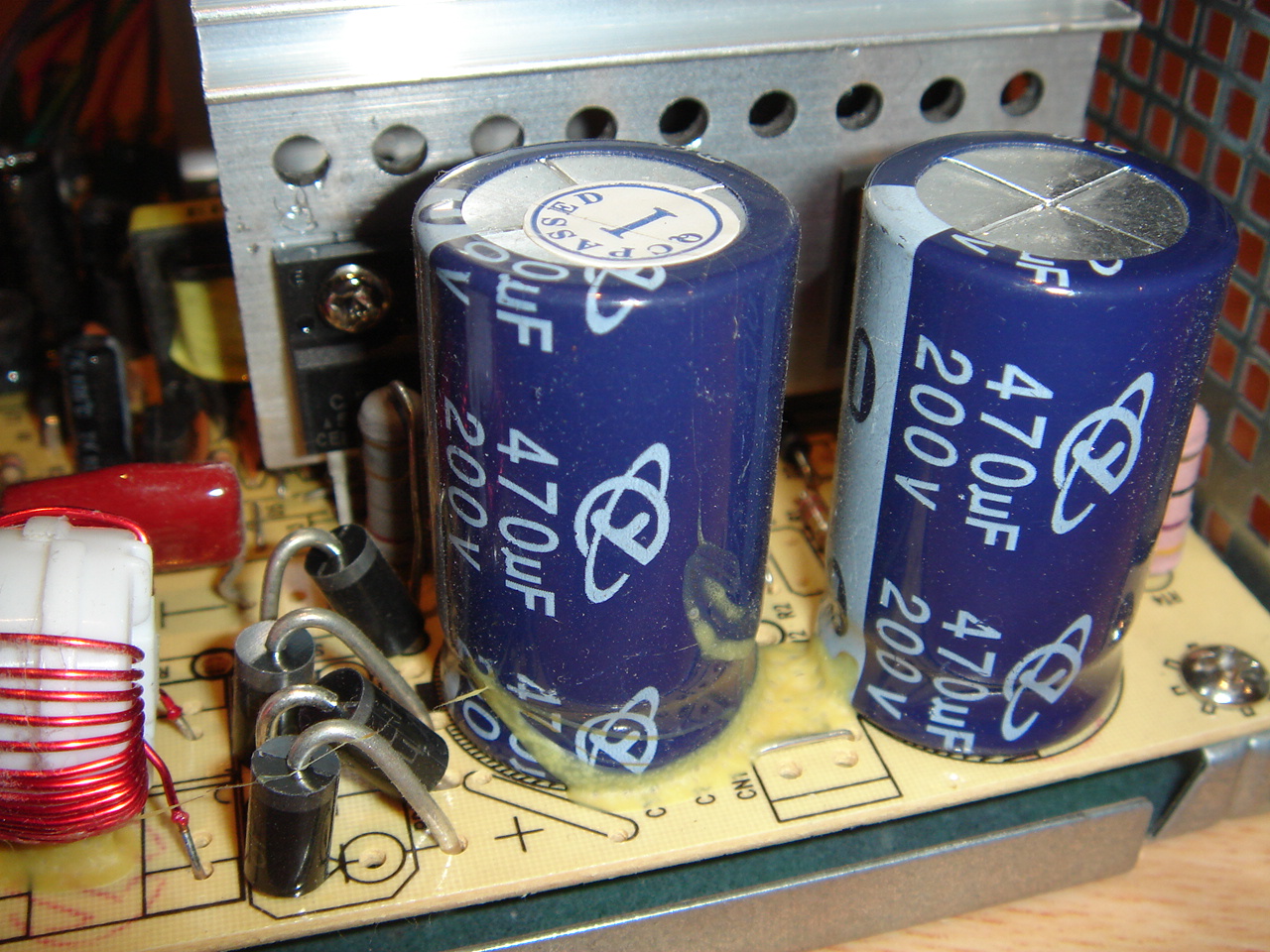

                  Ok, thank you everyone for the advice, i have included some images if that helps at all. I know i shouldnt have opened it when i had just unplugged it, but anyhow, it works still. There are Hermei and Koshin caps in there. There are also 2 470uf 200V caps that dont have a name and only some logo.
                  Can anyone help me on identifiyng the unknown name caps?
                  Any ideas on how to fix this PSU? recapping maybe? but what about those 200V caps? im not game enough to recap those, i think they hold a current somewhere in there.

                    It actually appears to have a AC filter integrated on the PCB right at the AC input, however it does look geniunley crap
                    That is a Deer rebranded PSU, it is not saft to use (and in many countries illegal to even sell)
                    Do yourself, your computer and possibly your houses fire insurance some good by buying a new powersupply (good brand, see recommendations here in Badcaps in other threads)
                    The PSU is in many ways unfit, not only is it just unsafe, it comes no where near to it's rated "400w" output, maybe 200-250 if you are really lucky... The reason it's getting so hot is that it is already being overloaded...
                    Your Pentium4 CPU wants current on the +12v line but this PSU has been made for older computers that pulled mainly from the +5v line.
                    Sorry to be so harsh but it really is a crap PSU and not worth to fix...

                            Well, I can see a common mode inductor (hopefully there's a toroid core inside that plastic outer case). There's a film cap next to it that might be an X-cap, though I doubt it. Don't see any differential mode inductors, though the common mode inductor will contribute some differential mode inductance, due to the way it's wound. And I don't think I see any Y-caps - I'm assuming those dark disc components near the AC wires are thermistors. So it has a little EMI filtering, but nowhere near enough. Switching P/Ss inherently generate EMI, so the presence of interference with your radio is not an indicator of a bad P/S so much as of the lack of EMI filter.
                            PeteS in CA
                              Re: faulty power supply?
                              The coil is rather wimpy, compared with eny cheap psu of a seriouse brand (e.g. FSP 250MDM or Seasonic SS300FS). I doubt that this combination can filter enough RFI to get any cert it should have. I doubth that the enigeners are smarter than those from Delta, FSP & Seasonic and have found a mutch cheaper way to comply with EMI regulations. But any way, there may be are other problems wich can cause RFI problems.

                                The Y-caps are located at the pcb edge, near Ac inlet.
