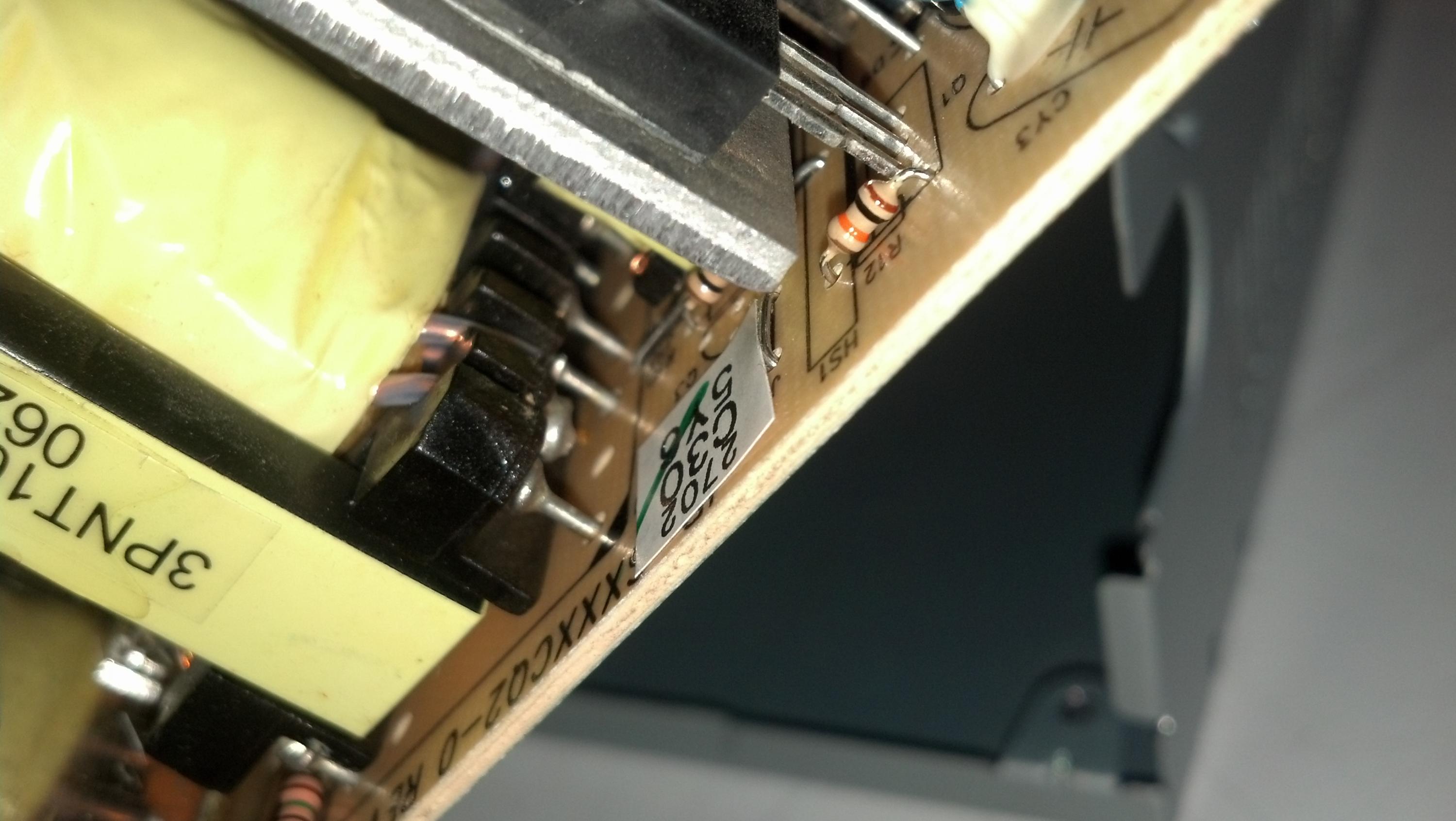

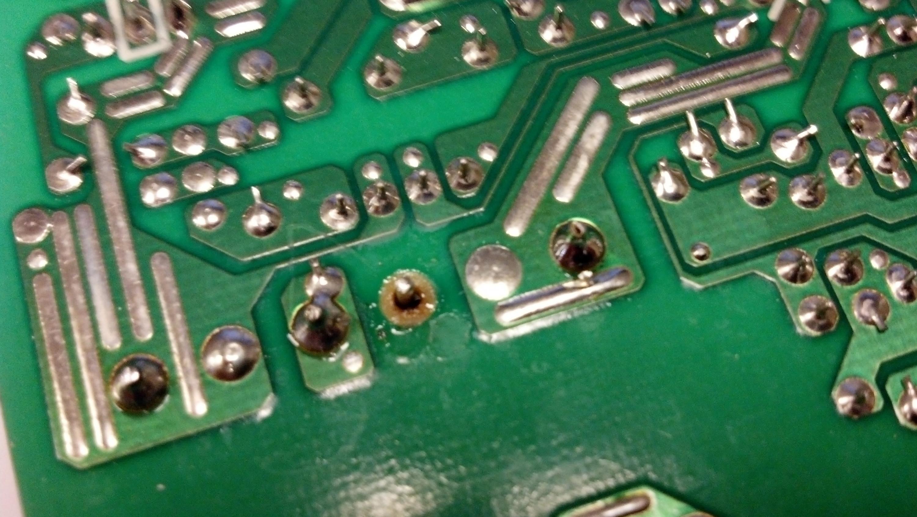

    This came off while desoldering, my mistake How can I fix this?? I tried putting it back on and soldering but it was too damaged

    What is the component - doesnt look like the pad was connected - may just be a blank pin- did you take any pictures before you started.

        Zoom out slightly so we can see where the trace is going. Also show the topside so we have an idea.

          What board is this?

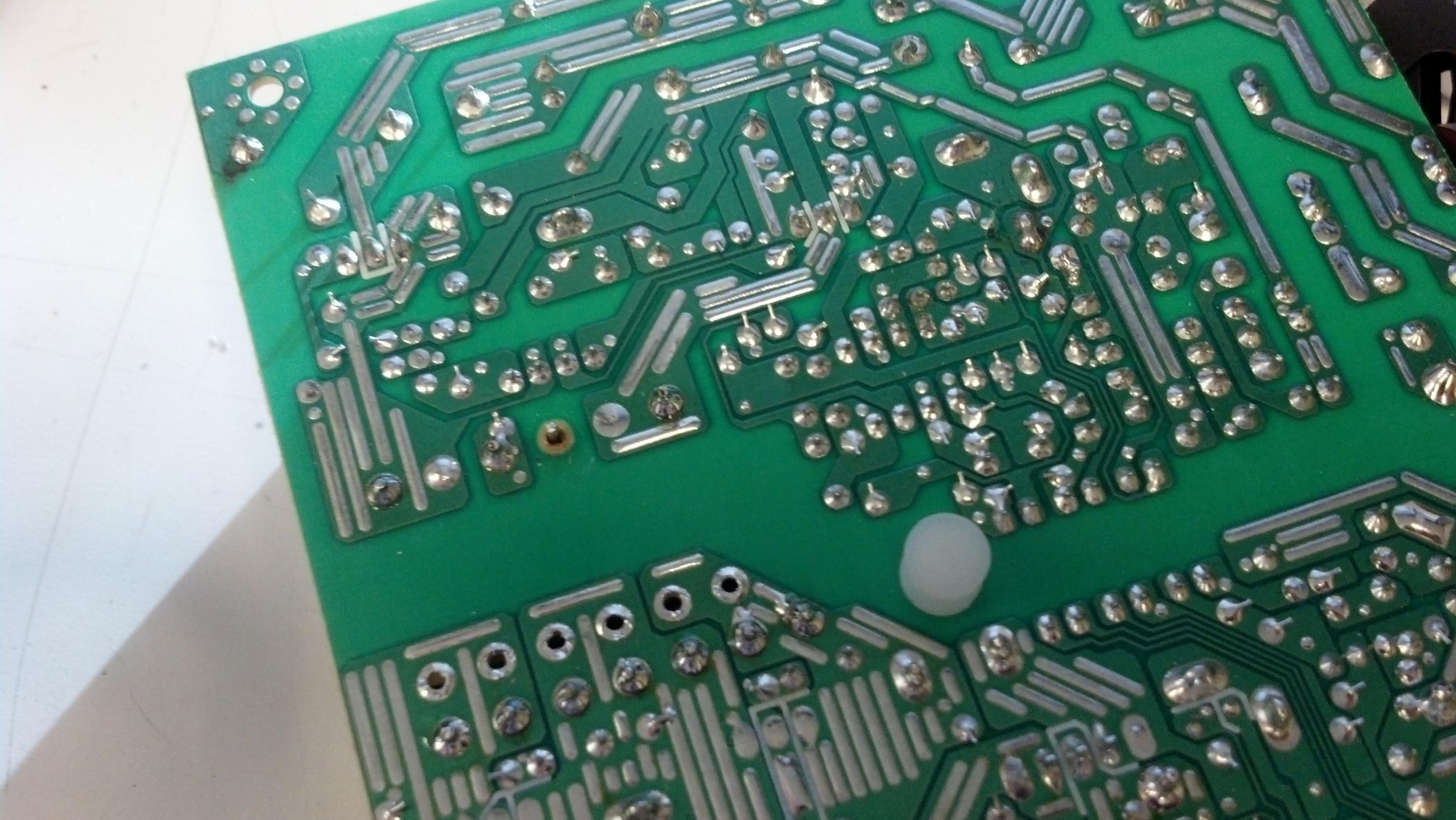

            I cant see a trace from where the pad was - that is why I thought it was just a blank pad - unless there is a trace on the otherside or it is a multilevel board.

              If this is a 2 layer board the trace will be on the other side just solder the component from the top and you'll be fine.
              If it's a multilayer board and there is no trace on the top you're out of luck.

                I'd be willing to guess that this is OK, and this pin doesn't go anywhere on the other side (if this was a through-plated via hole) ... that is, if this is even more than single sided as most PSUs are 1-layer... Is there a wire connected on the other side of the board on that hole?
                You might lose a bit of durability as even if it wasn't connected to anything, it does hold the part on the board... but you probably could have told that the others do much more than enough to make sure the transformer doesn't fall off

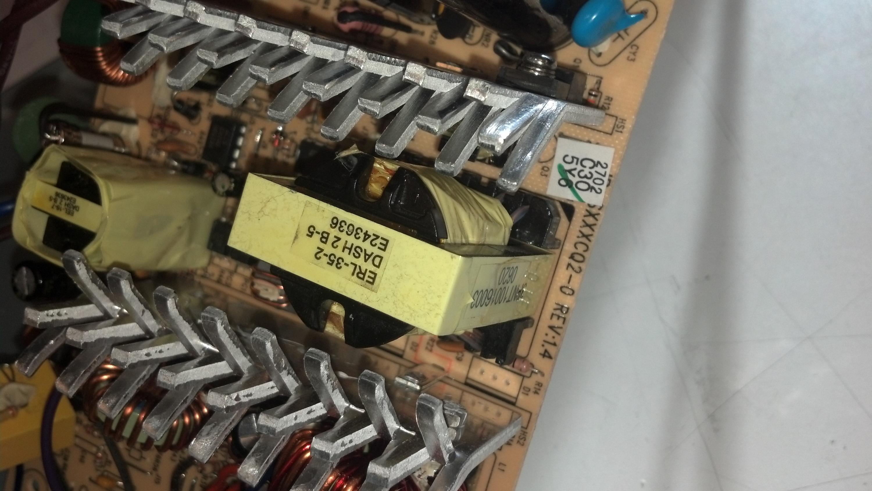

                  It's a PowerMan PSU, here are the pics! Yeah it doesn't look like it goes anywhere but I want to make sure!!! Looking at the second picture it is the 3rd pin from the left

                      Don't worry it's a 'Not connected pad'.
                      Single layer board, with no trace leading to the pad hence it serves no purpose.
                        Re: What to do about missing pad on lead?
                        More than likely there because the winding core had it already or for ease of alignment during manufacture.

                            Hmmm, the power supply didn't turn on at all

                              Yes, well you will need to tell us what you were doing to it and why.
                              Bigger pictures of the whole thing not just parts. What was it connected to?

                                I replaced the 28 size transformer with a 35, and I just did the paperclip trick and plugged in 4 hard drives to give it some load but it wouldn't power on. Hooked it up to a computer and still wouldn't power up

                                  Was it working before you upgraded the transformer?

                                    maybe the transformer is wired differently ?

                                      Yeah it was working, and it's getting 5VSB but that's it

                                        Hmm...transformer "upgrades" are tricky, most of the time you can't swap transformers from one to another unless you carefully check the pinouts of the transformers... where did the new transformer come from? Was it intended for this particular PSU?
