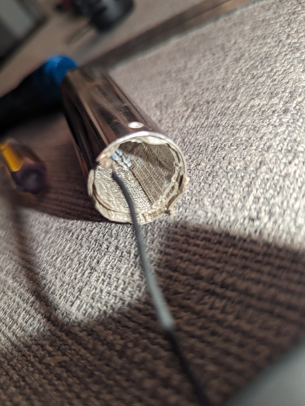

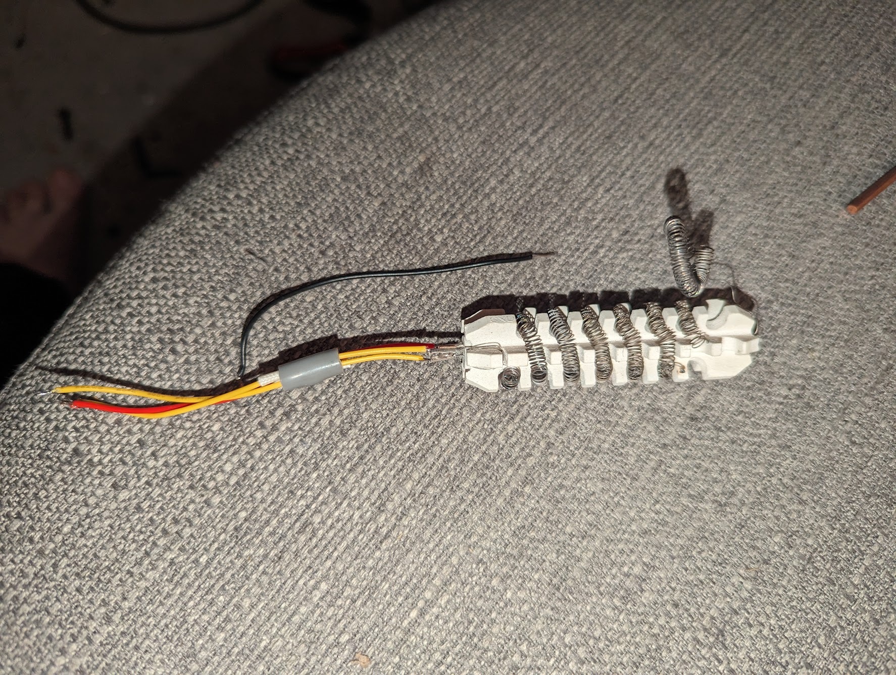

        Lol this piece of garbage made it a whole 3 uses before blowing the element. I need it to limp along another few months til I can afford to replace it with one of the nice KSGER ones. The station is 700W, do I need to replace it with another 700W element or is there any benefit to replacing it with a higher wattage one? Also what's the insulation material, I'm guessing some sort of fiberglass? (E: It's mica paper, probably why my hands are so itchy now lol)

          even if the element shorted to ground it wouldnt blow,
          last time this happened on a forum it was suspected that the guy had been given a 110v element in a 230v unit!
          i have been using a fan-in-handle unit for years without issues.
          the heater is the same as the pump-style ones,
          only the air source is different - and the pumps do fail - probably more than the fans that are similar to ones in laptops
          i had a pump style one first - until the pump failed.

            Ah ok cool, that would make sense - I found a sturdier looking and 220v element so hopefully that will work. The soldering in this handle is piss poor though, going to rework that too.
