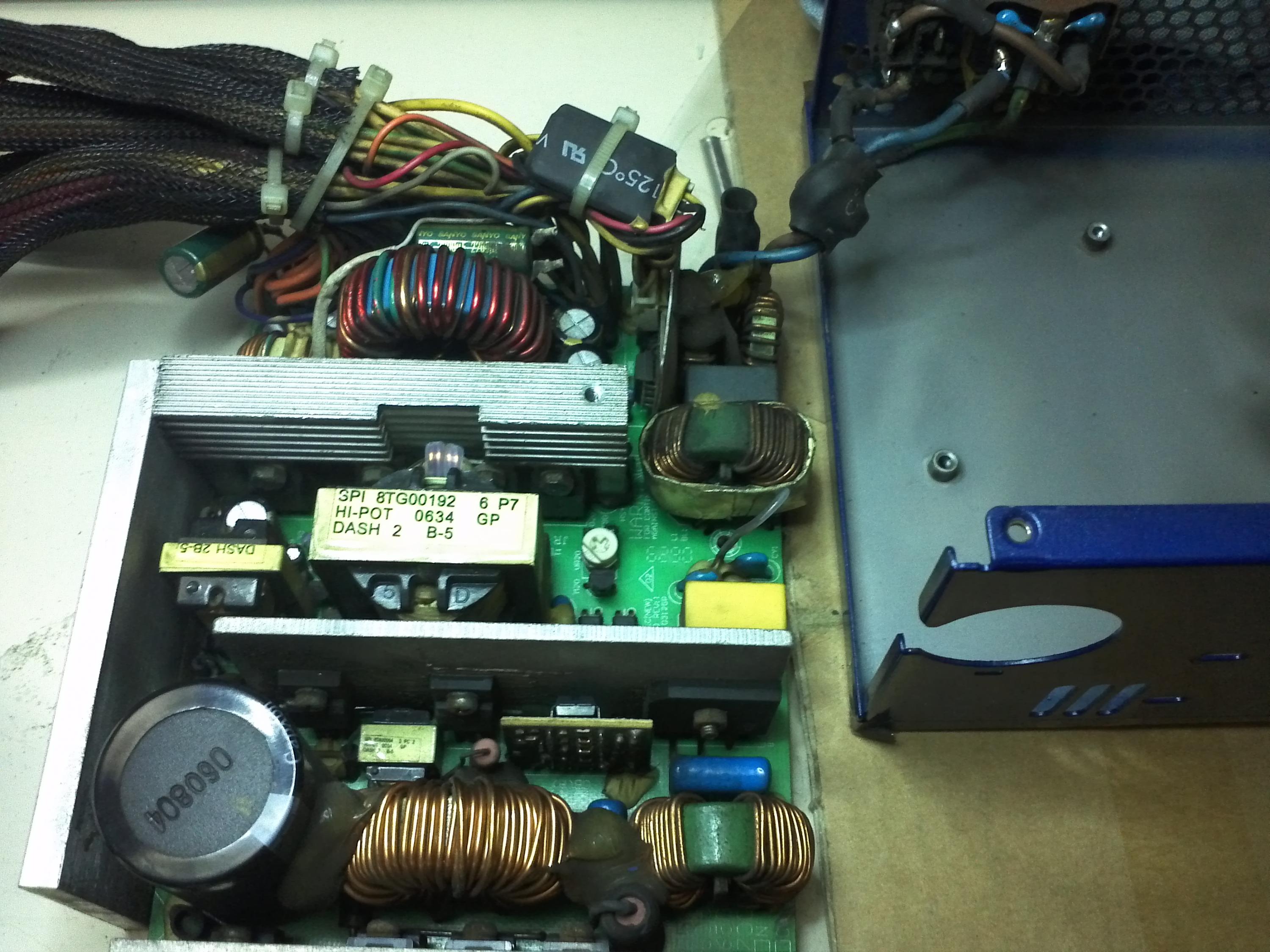

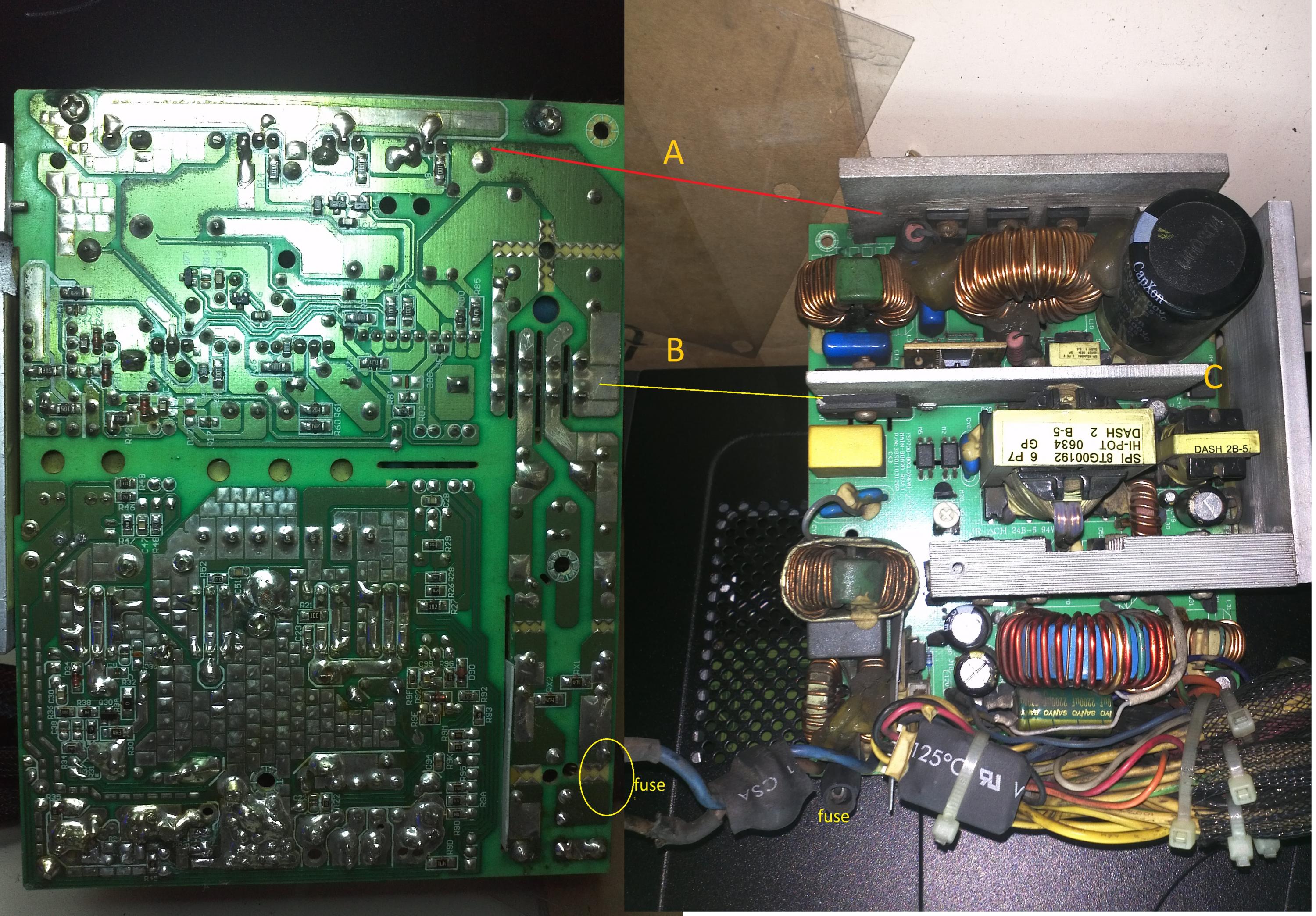

    hi can anyone help me out on which part i should check on what is shorted out or broken?
    already replaced the fuse for the 1st time and
    1. power on switch on psu socket = fuse ok
    2. once psu is switched on via the power on 24 pin the fuse blows
    here are some pics taken
    what else do i need to check and how to diagnose
    thanks in advance for your help

    Post the images here as attachments. Click on Go Advanced and do it if you can no longer edit your post.
    Anyway, the pictures are probably too low quality to figure out anything.
    pics large size : http://img23.*************/img23/6877/img051lp.jpg and http://img341.*************/img341/489/img046rd.jpg
    check the bridge rectifier - it's at the end of the long heatsink. Put the multimeter on diode check and test it (with power supply unplugged)
    This video explains how if you don't know : http://www.youtube.com/watch?v=dqkT6hF0O3E
    You don't have to remove it from the circuit. ps. actually you have two bridge rectifiers there, the ones marked with B. better desolder them both and test them outside the circuit.

        both bridge rectifier are ok

          currently checking the igbt removed the igbt 20n60c3
          seems something is wrong which one is faulty here?
          dmm set to diode
          G C+lead E-neg lead
          no reading
          but if
          G C- E+
          i get a reading of 0.490v
          one of the igbt when on these test gives out 0.007v

            From what I can see, 20N60C3 is a MOSFET not IGBT, so the reading of 0.490 V you get when you put the (-) probe on C and (+) on E (that's actually D and S not C and E since it's a MOSFET) is normal.
            I'm guessing this power supply is either a single or double forward design so check the DRC (diode, resistor, capacitor) snubber network. It's also possible that the high voltage bulk cap on the primary may be bad - there actually have been a few cases here on badcaps.net where people reported those CapXon high voltage caps failing.
            To avoid blowing more fuses testing the power supply, once trick you can do is to wire an incandescent light bulb in series with the live wire going to the PSU. A 60W one is a good start. However, if you do that, you cannot connect a very large load to the power supply (i.e. you can't have it connected to a computer). The largest load you can have is maybe an old hard drive you don't care much about or a bunch of fans. If the light bulb becomes fully lit when you try to power on the power supply, the problem is still there. In that case, do NOT keep the power supply turned on for more than a few seconds to avoid burning out other components.
            Also note that if the hard drive/fans use a lot of power, the light bulb may still remain somewhat lit. In that case, you can switch the light bulb to a higher wattage one. 100 to 150W should be plenty.

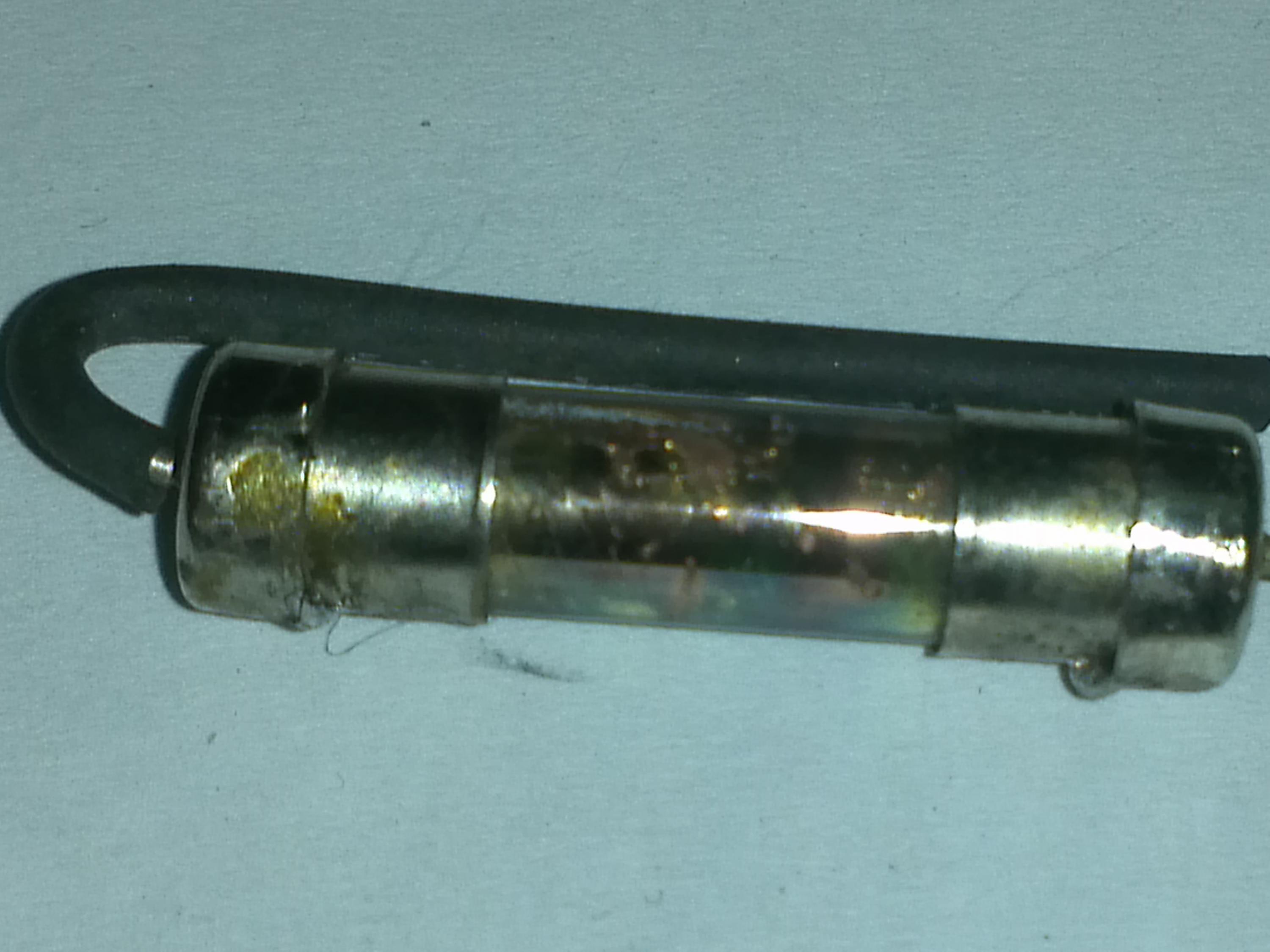

                            btw here is the pic of the blown fuse before
