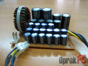

(or simply add a second PSU). Do you ever read about power lead made by OCZ? Many will wonder about its (effective) functionality but i think i's a very smart idea (caps, ceramic caps, and iron core on the end of mollex connector).
I made it a year ago (a laughable design, only caps, led, and small pcb). I lost interest before i attemp to make a better circuit.

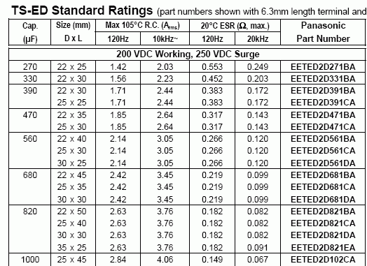

Weird, at that spec (105C 120Hz TS-ED) i see it has 2420mA allowable ripple and 0.219 ohm ESR (20C 105C). Page six where? Maybe on this?

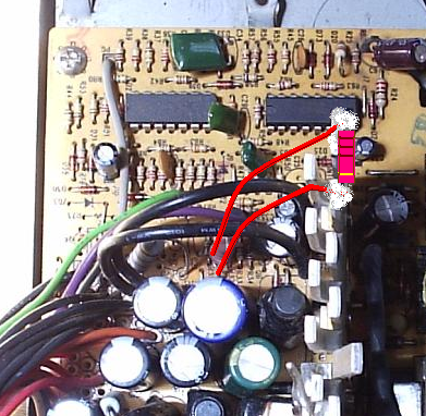

Are those dummy resistor (low ohm high wattage) also responsible for discharging those secondary caps immediately after the system shut off? BTW they are so hot i need to mounted it on the hs, otherwise it will burn the pcb.

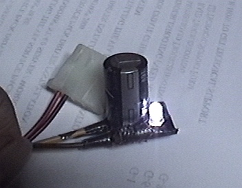

(or simply add a second PSU). Do you ever read about power lead made by OCZ? Many will wonder about its (effective) functionality but i think i's a very smart idea (caps, ceramic caps, and iron core on the end of mollex connector).I made it a year ago (a laughable design, only caps, led, and small pcb). I lost interest before i attemp to make a better circuit.

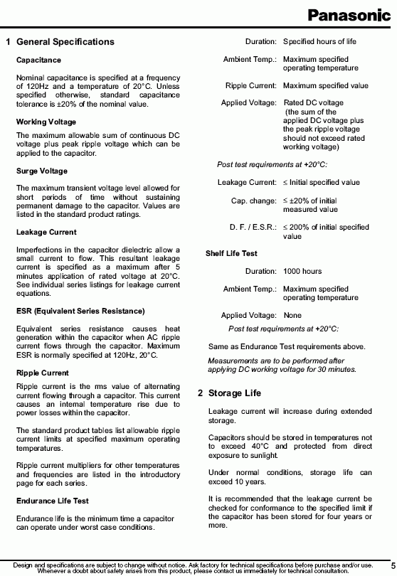

Panasonic TS-ED 680uF 200V r22x45 Load life is 3000h but 105°C and ripple - see page SIX on TWO paged document - so, ripple is unknown and that is all the decision problem I have now...

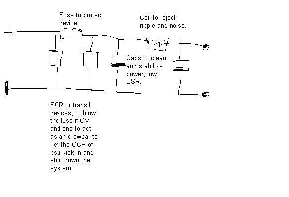

Now the filtering. After my bad experience with the PSU I wanted to make sure that nothing bad will happen again. So, what should I do? Block (bridge) each of the big output caps with 10uF 16V ceramics?
Will that help enought? Or should I also add in parallel 100nF 16V ceramics to this?
