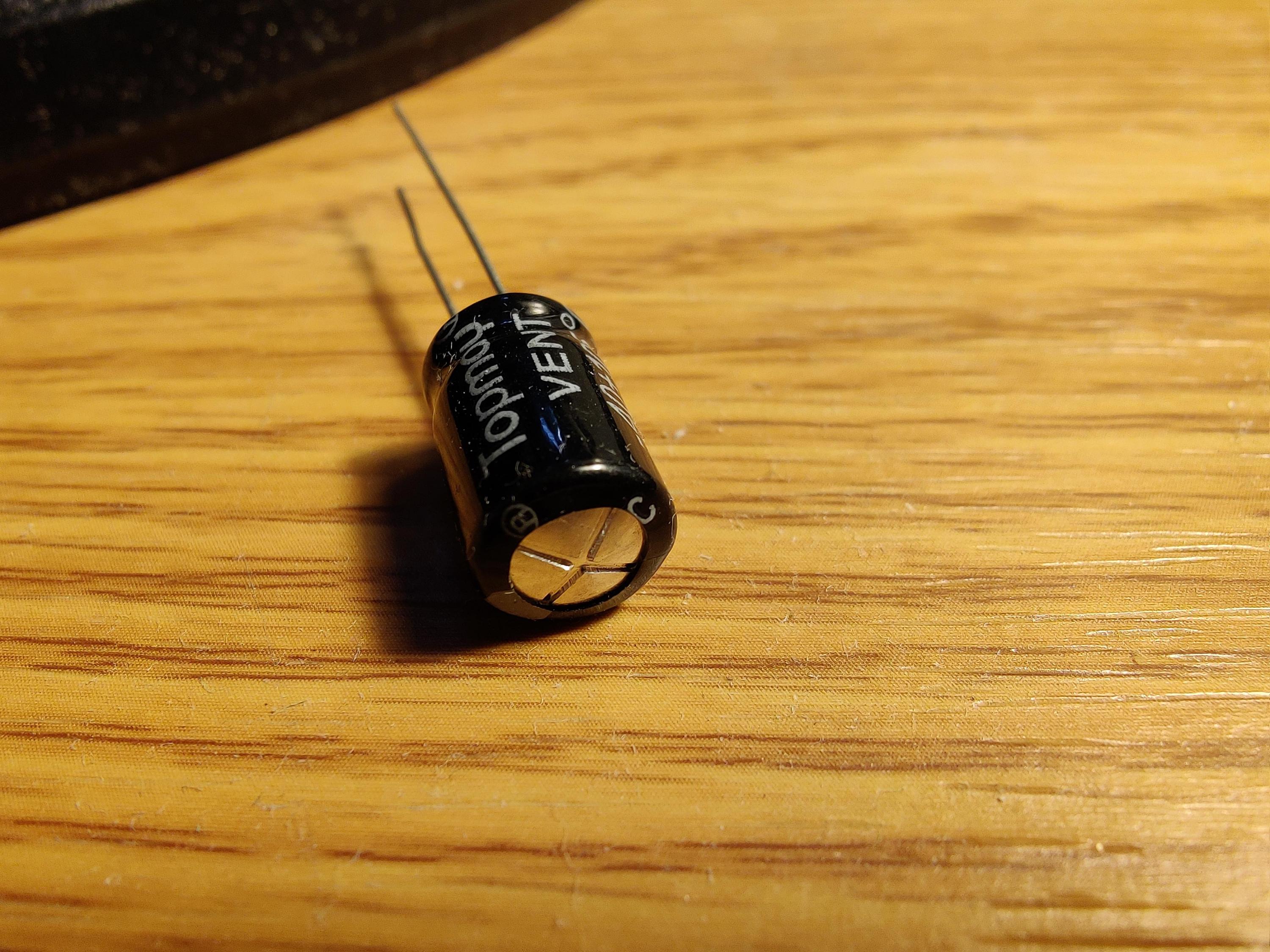

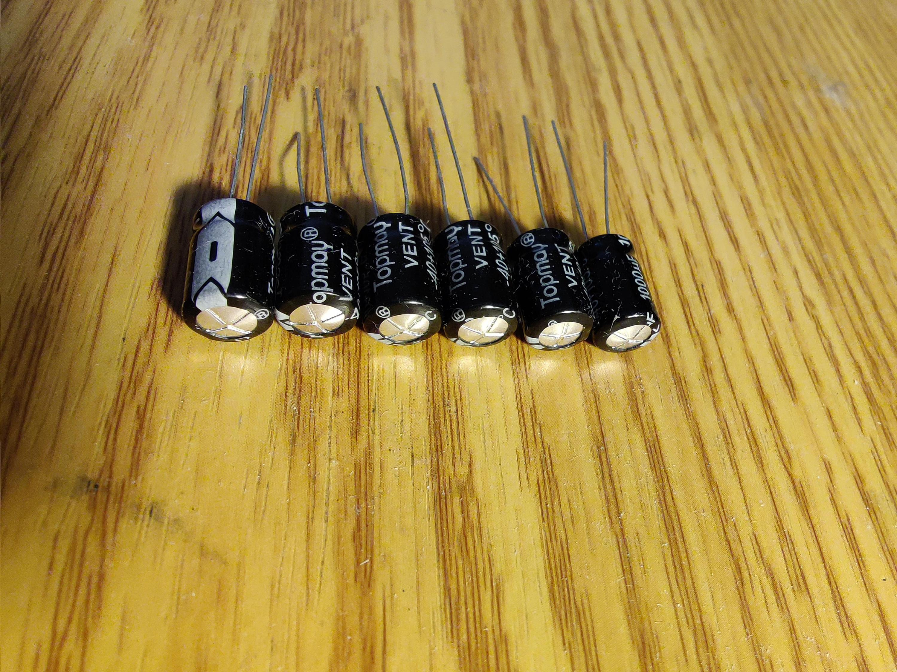

    Are these 1000uF 10v Topmay capacitors from eBay ok?
    I just bought some 1000uF 10v capacitors from eBay to fix my Samsung 2220WM, but it seems like they are already bulging? Are they ok to use? Thanks.

    Re: Are these 1000uF 10v capacitors from eBay ok?
    Lol
    eBay never ceases to amaze!
    Your only source for legitimate capacitors is one of the large serious component stores like:
    Elfa, Farnell, CPC, Mouser, Digikey, TME (in no particular order)
    And to answer the question: they belong in the trash can, even more so when they are bulging but really the same if they where not!
    Maybe you can ask the seller for a refund, though if it was from eBay seller la.tronics with itemid: 182597722384 I guess you got what you paid for, as they are bulging in the store photo!
    But 177 sold batches of 10 pieces and perfect review score, LOL!

        Re: Are these 1000uF 10v Topmay capacitors from eBay ok?
        Suncon? really?
        as for the Topmay caps, you cant really complain because they do say "VENT" on them!
          Lol
          I have bought from eBay before without issue. But I guess I got unlucky this time. I'll definitely try to ask for a refund. Thanks.
                    Agreed.
                    Same goes for most non-Japanese brands anyways, especially the no-name garbage from eBay.
