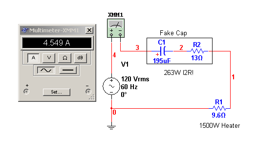

    Fake NCC cap, has a Hermei/Jamicon style vent. Looks pretty horrible, except the bottom of it doesn't look too bad

      Wow that sucker has high ESR.
      Try blowing it up, and video tape it. That vent looks like it wouldn't work that well ... notice the middle of it.

        Seems like made in 1995. Is it possible it jsut went bad?

          That capacitance is still in spec, but yeah, with ESR that high, I'd toss it into a fire and see what it does.

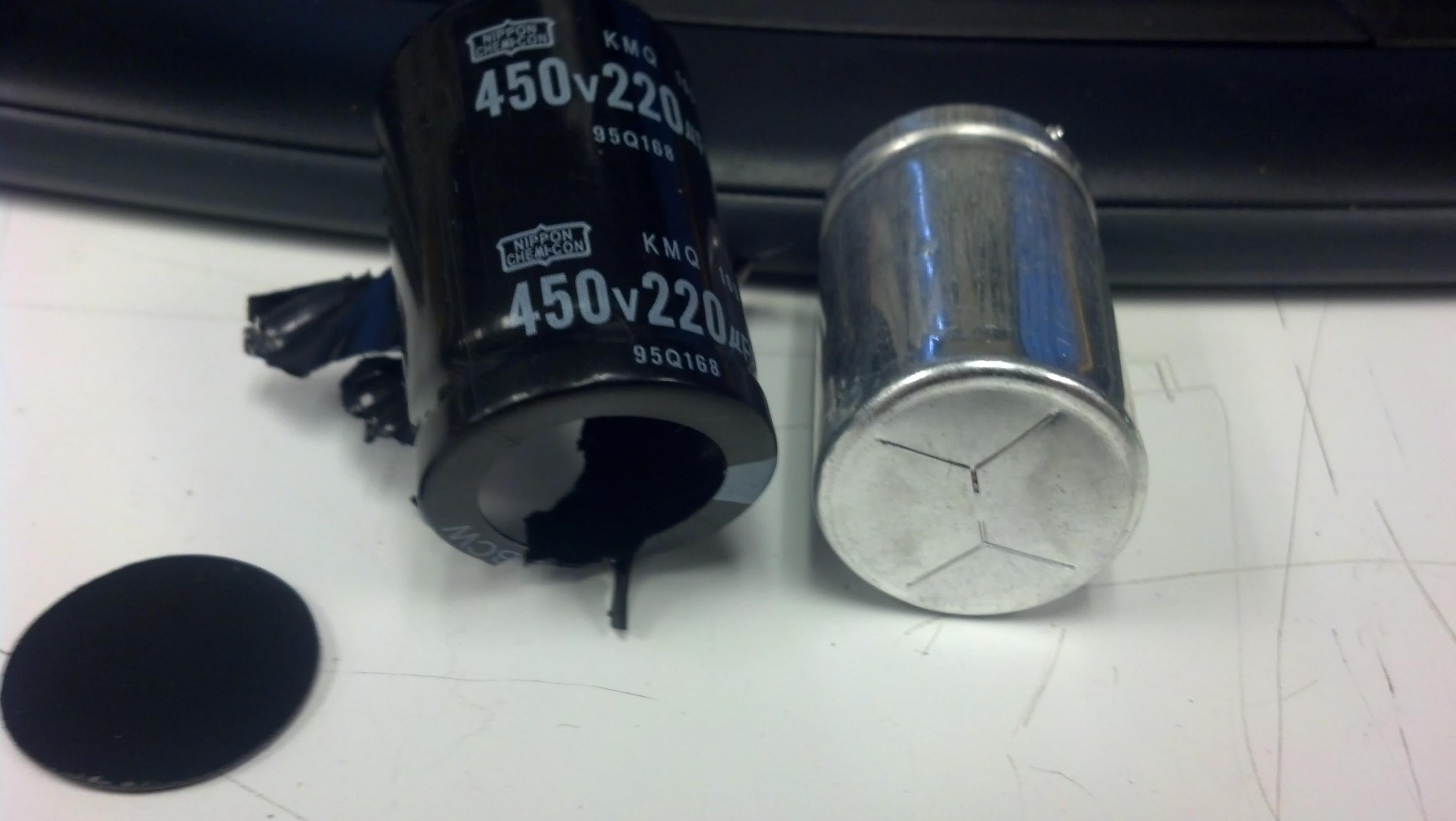

            I bought the cap new off a crap Chinese site because I was curious. Out $1.99, no big deal. Should I blow it up or dissect it?

              Blow it up. It's more fun

                How shall I do it?

                  Like this:

                    that's a HV cap, so it is more tricky. Typically you can bang lytics by overvoltaging them with AC, lets say with linear transformer of 24V and enough amps. I guess this one would explode on AC too.

                      I think you can use transformer welder just fine It passes on "enough amps"
