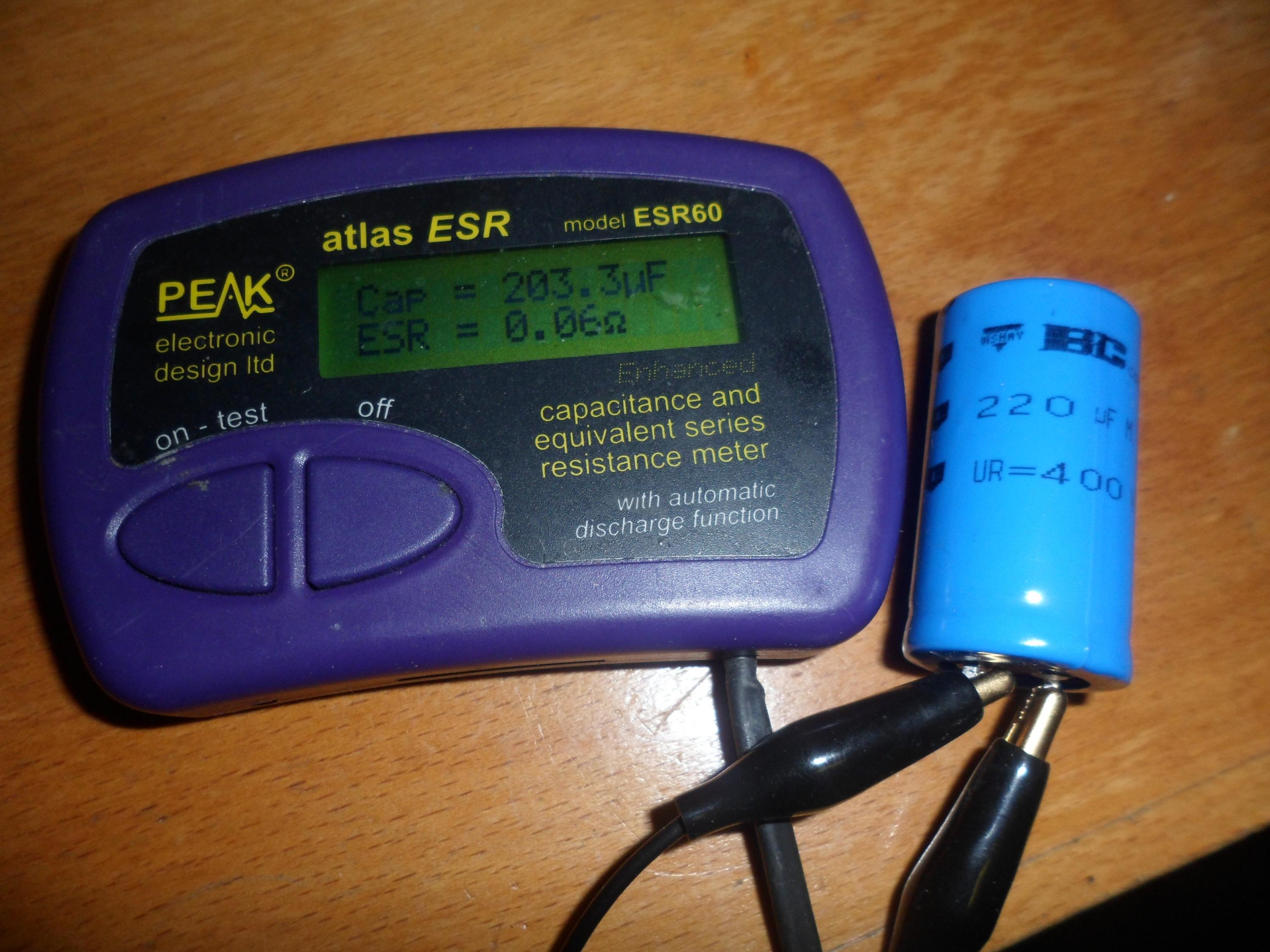

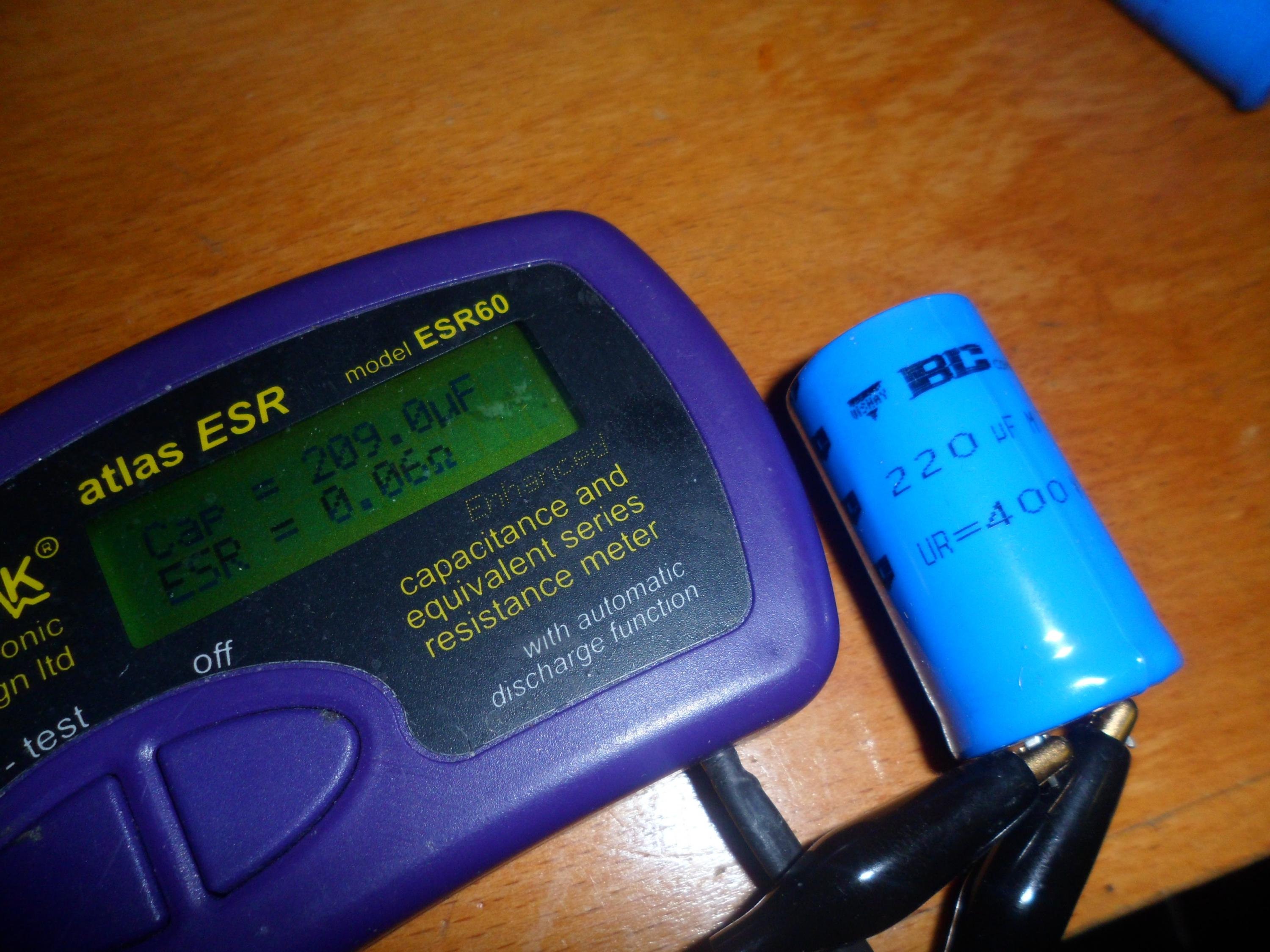

                              Just wanted to quell any arguments on ESR/capacitance meters being inaccurate for high voltage caps. I happen to have some genuine Vishay capacitors (220uF 400V, around 35 or so... for an electric drive-train project.) They measure around 200~210uF, so the meter would appear accurate.

                                I've seen fake Teapo before, wouldn't be surprised. Size wise, it's kinda small for 680uF.
                                The meter is not that accurate with high voltage caps, but it's consistently one step below the value listed on lots of caps and that would be quite a coincidence.
                                  #56
                                  Re: Fake primary capacitors
                                  The capacitors have 20% tolerance, the meter reads them within 5~10%. The meter is perfectly accurate.
