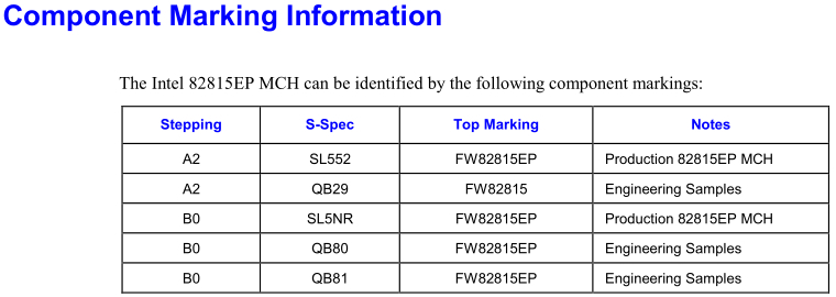

                    Originally posted by momaka
                    Actually, as I was told by another member here (ChaosLegionnaire), this board supposedly supports even Tualatin P3 CPUs out of the box (apparently true if the board has a blue socket or if there is a sticker with a "T" near the CPU socket.)
                    yes. as i may or may not have mentioned before. the surefire way is to remove the nb heatsink and take a peek at the s-spec number printed on the die. hopefully, it uses thermal paste since the heatsink is attached to the board using push pins. other boards may use thermal epoxy to attach the heatsink so no luck with those...
                    if its says SL552, its the 815EP A stepping chipset which supports up till coppermine cpus only. a tualatin socket adapter is needed to get tualatin cpus to work on such a board. if it says SL5NR, u're in luck! its the 815EP B stepping chipset which supports tualatin natively. no socket adapters needed and no pin modding fockery necessary!
