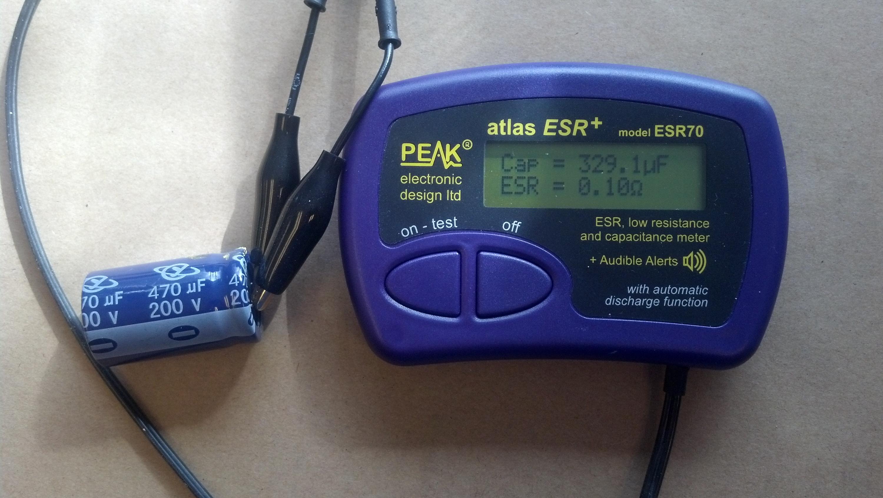

      I know this is an old thread but wanted to share some...These caps came out of Coolmax, L&C, Sun Pro, and Logisys PSU's
        Re: Fake primary capacitors
        Wow, more fakery (is that even a word, btw?). I guess from now on, when I see primary caps from unknown Chinese manufacturer, I will just assume the capacitance is 1 level lower than what is printed on the sleeve. Even though it may not be the case for every cheap cap brand, I think it's a safe assumption regardless.
          That's a good assumption. Unfortunately it depends...Another 470uF HEC input cap that was black instead of blue was actually 470uF. And a CS cap that I figured would be fake was its actual value. I wish they were more consistent!!!

                              The JEE 330uF 200V primaries which came out of this trashed King World ATX-250W PSU measured at 202.8uF and 198.8uF respectively, both with an ESR of 0.07 ohms and a date code of 9828. No doubt they are 220s with a 330uF label, as they are still in tolerance of said capacitance.
                              Same again with Su'scon. The two 470uF 200V LXs I ripped from an L&C LC-230ATX were measured at 312.0uF and 319.9uF respectively; both 0.06 ohms ESR. As with the above caps, they are well within tolerance... of a 330uF capacitor. This PSU was also from 1998.
