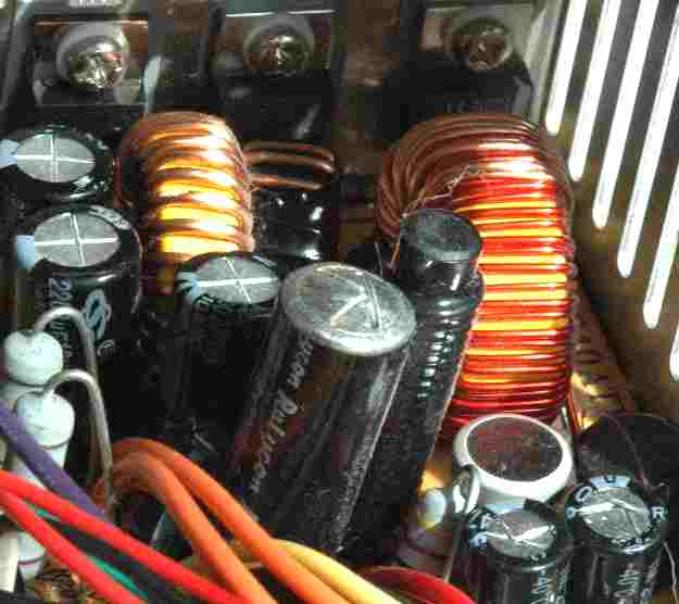

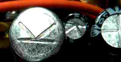

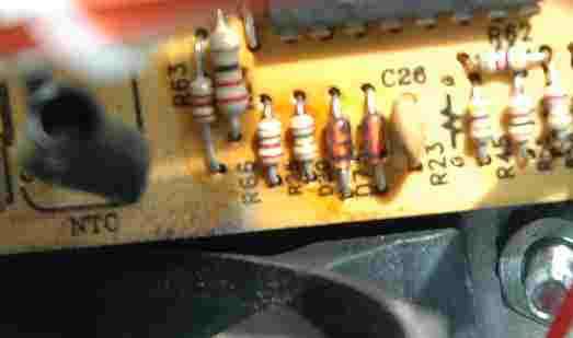

              #146
              Re: Power supply build quality pictorial DISCUSSION
              This morning my Deer DR-250ATX W blew within 5 seconds of powerup; normal minimum loads, no prior issues- pffft & brown stinky cloud- surprise!
              But here's a switch: Rubycon 16 v 2200 uF blew. Did a closeup of a fine crack at the top seam I didn't see at first.
              In the background is the insulation just starting to peel back from the coil. I suspect it wasn't always like that. First time I opened it. '02 probably out of warrentee anyway.
              Diode & resistor area of board by fan looks a little suspect- haven't yanked it out yet. MBoard looks ok.

                #147
                Is it really a Rubycon (not Rulycon)?
                • Shroomie
                  • Apr 2006
                  • 356
                  #148
                  That's a Rulycon right there in Attachment #1. No surprise there.

                      #150
                      This are Rulycon, the IMHO i think the font is the wrong.

                        #151
                        D'OH!! Right. Hats/ visors off to all. ( I know, hard vacuum...) THANK YOU!
                        I'll hang up on myself.
                        here's a closeup of unRuly_CON
                        "Men occasionally stumble over the truth, but most of them pick themselves up and hurry off as if nothing ever happened. " Sir Winston Churchill (1874 - 1965)
