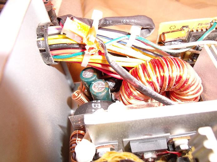

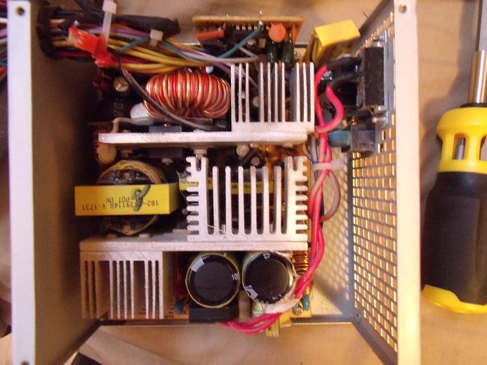

Openend up my Dynex PSU while i was puting in my modded CPU cooler.My Computer.

Looks pretty nice on the inside. Those are some big heatsinks. I would just recap it if you can. It is complete, with a good sized transformer and full input filter.
Re: Power supply build quality pictorial DISCUSSION
yeah just i dont know if i can do that without wrecking it but i do have a BAck up now lol.Originally posted by 370forlifeLooks pretty nice on the inside. Those are some big heatsinks. I would just recap it if you can. It is complete, with a good sized transformer and full input filter.My Computer.
Do you mean those 2 really big caps or the smaller ones?

Originally posted by Phaihnyeah just i dont know if i can do that without wrecking it but i do have a BAck up now lol.
Its a lot easier than you may think with a power supply. The pcb is a single layer (only some high end psu's have more than single layer pcb's), and its a lot harder to ruin the traces because they are huge and they are made of solder. The only thing you have to worry about is the heat of your soldering iron, as those huge traces can suck away the heat so you have to hold it there longer.Last edited by 370forlife; 08-22-2009, 09:40 AM.

I'd say "high power" more than "high end." You get enough power flowing, and you need a dual layer PCB no matter what name it goes by. Topower's a good example... most of their high power units are a far cry from what I'd call high endOriginally posted by 370forlife(only some high end psu's have more than single layer pcb's)

Soldering on a power supply is much easier than on a motherboard for the reason that 370forlife said before.
If you have a junk power supply, try practice some soldering on that.My gaming PC:

Also I think it might be more difficult to do a recap on that Dynex PSU, it's so cramped inside that there would be little room for removing and installing new capacitors.Last edited by Newbie2; 08-22-2009, 10:57 AM.My gaming PC:

agreedOriginally posted by Newbie2Also I think it might be more difficult to do a recap on that Dynex PSU, it's so cramped inside that there would be little round for removing and installing new capacitors.My Computer.

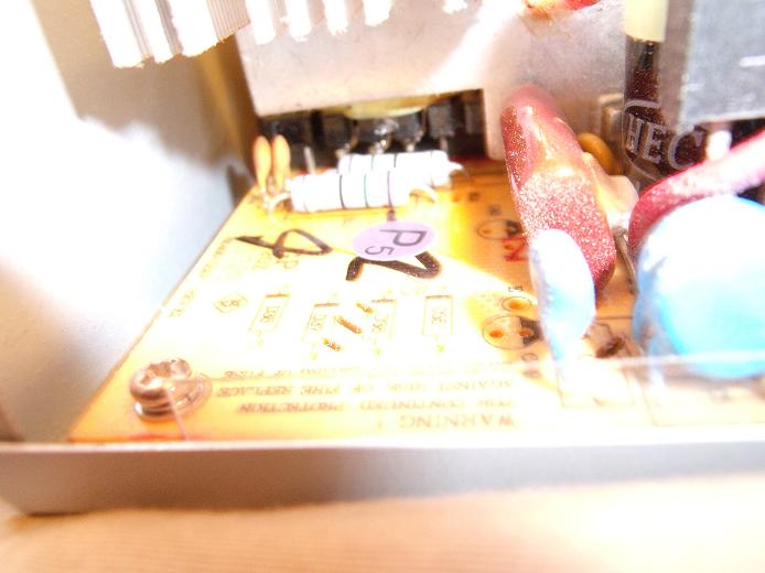

Those are HEC built units. Actually a 300W inside of it, but it will do fine for what you are using it for.
