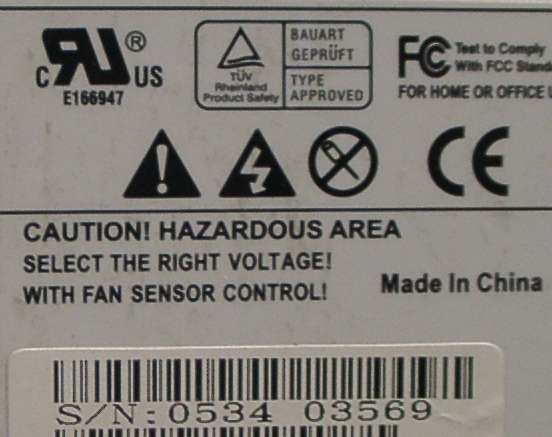

    Re: Power supply build quality pictorial DISCUSSION
    Enhance's UL is E166947.
    That looks like it -might- be what's on the PSU.
    Hard to read from here.
    I'm kind of surprised.
    Enhance usually uses good caps.
      I think PCBonez is right, the UL number does look like Enhace's. The model number (ATX-2035FA) is listed on their UL page as well. I noticed something weird though - Bestec also has a PSU with the same model number. Coincidence?
        From what I can see the UL is E166547, which is nothing,
        Hard to read from here.<<
        I think your right. I believe that is a 9, not a 5.
          Yes, it is E166947.
          Here is a close up crop.
            So it is definitely a real enhance, why does it have bad caps?
            The one enhance I have has a mix of UCC and Teapo in it.
            Maybe someone else who had it said "UCC? These are crap, I'll put some good YC caps in it."

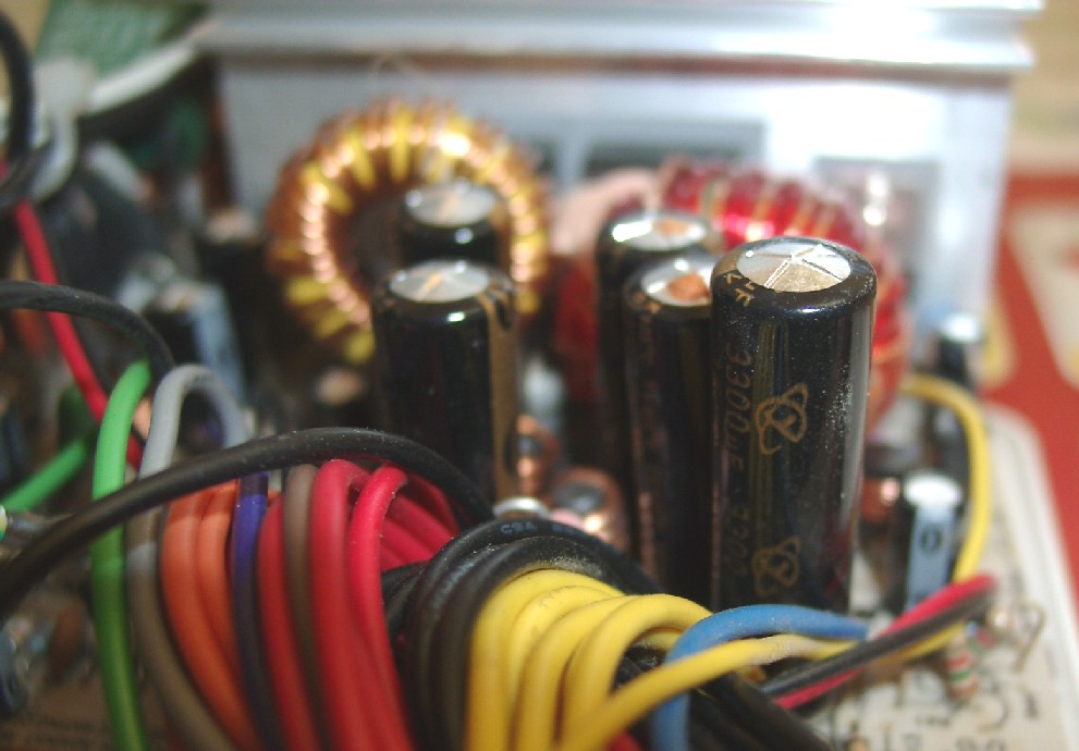

                OK, I removed the board out of the chassis.
                I don't recognize this brand logo. They are all marked 105°C TK and are black with gold lettering
                Tallest is 3300uF/16V (10mmx38mm)
                2 are 3300uF/10V (10mmx30mm)
                2 are 3300uF/6.3V (10mmx30mm)
                On the original pix, the two smaller caps (both swelled):
                1000uF/10V and
                470uF/10V (black colour)
                Recommendation on replacement caps?

                  • PCBONEZ
                    Grumpy Old Fart
                    • Aug 2005
                    • 10661
                    #249
                    = YC = YANG-CHUN ...
                    It's a Y and a C with a band around it like the planet Saturn.
                    Like this:
                    Really goofy logo as logos go.
                    Mann-Made Global Warming.
                    - Dr Seuss

                      Rosewill likes to use those in their lower end ATNG's and higher end solytech built units.
                      Though i've never seen another ATNG built unit with YC caps.

                          I am having trouble locating any specs for these YC caps.
                          I need to find a replacement for 3300uF/16V. It is only 10mm diameter.
                          Can I use UCC EKMG160ELL332MJ40S?
                          It is available from Mouser.
                          • PCBONEZ
                            Grumpy Old Fart
                            • Aug 2005
                            • 10661
                            #253
                            I haven't found datasheets for YC yet. There probably aren't any available.
                            KMG is probably not adequate.
                            3300uF 16v 10mm is one of those hard to find sizes.
                            I would order some Samxon RS series from badcaps.net for those.
                            The RS 3300uF 16v is 10mm and RS is perfect for most PSU caps.
                            https://www.badcaps.net/pages.php?vid=22
